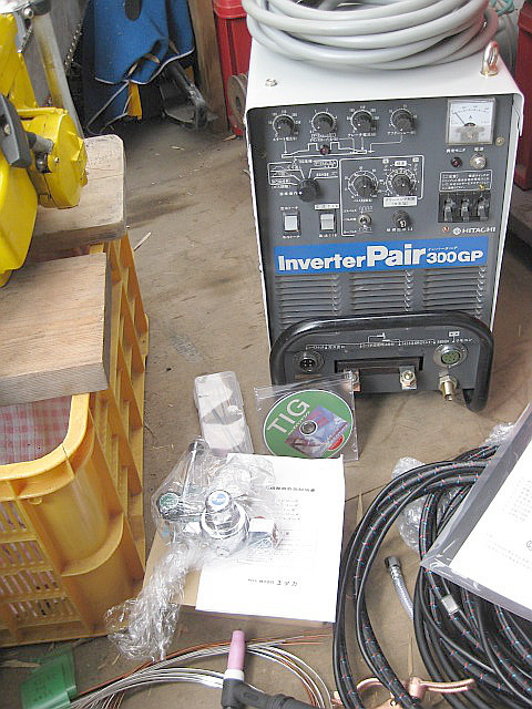

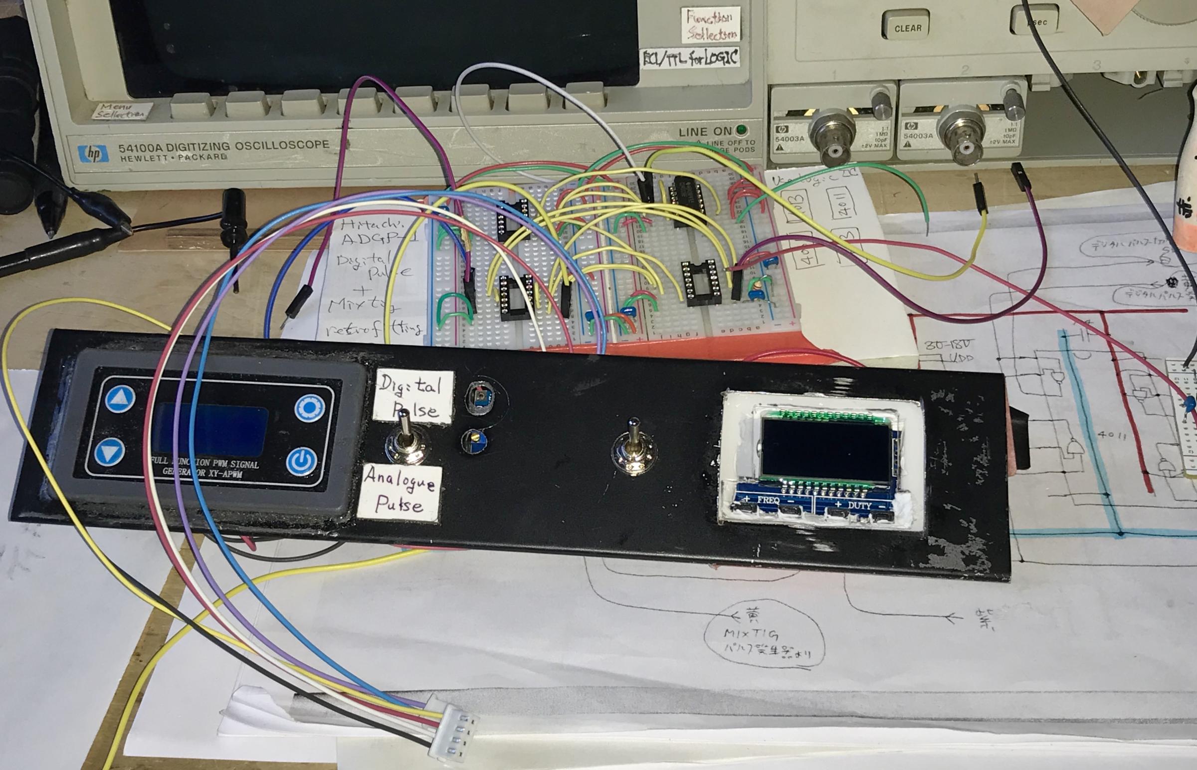

Set up a couple of digital generators to my old analogue TIG welder this spring, in an attempt to optimize its wave forms of welding current, to help my self when I make some butt-welding to thinner aluminium sheets.
Attachment 35939
Here showing my old TIG welder;

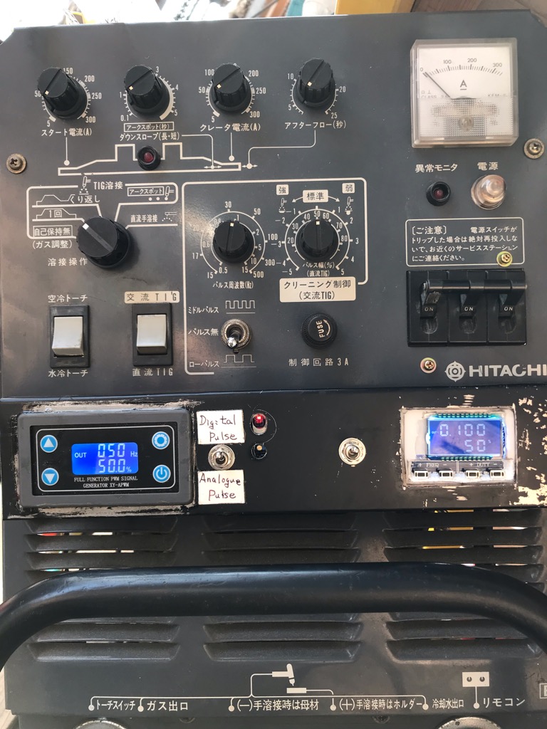

Attachment 35940
The digital unit above is set up on the front panel;
Attachment 35941

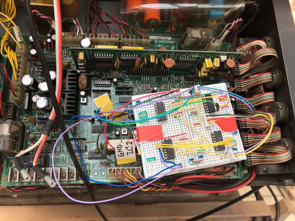

Several logic-chips are placed on a small additional board, and is placed on the main circuit board of the welder;
Attachment 35942

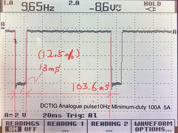

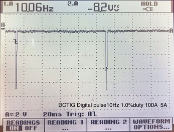

The default setting only provides the minimum duty ratio of welding pulse as 12.5%
Attachment 35943
but I wanted smaller duty as small as down to 1.0% for each welding pulse frequency,
showing one sample I got after this retrofit;

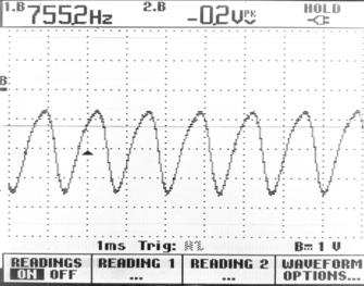

The arc sometimes wonders when the welding amperage is set low, like 30A for welding current and 5A for base current.
But I feel like this problem has nearly gone since I added this new digital generator by applying DC welding pulse frequency higher than 750Hz;
Attachment 35945
with this frequency the arc shows somewhat better stability to the aimed point.

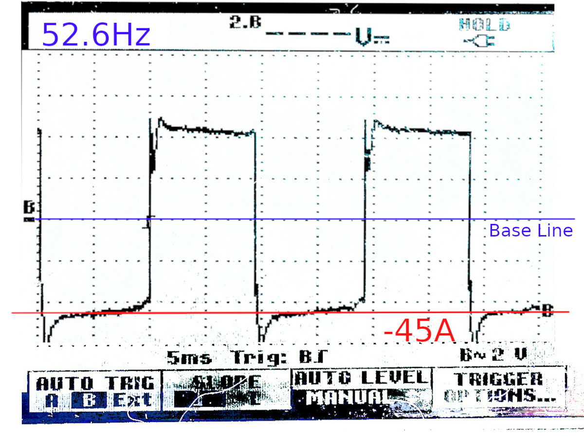

Below is a default wave form of Alternative Current welding, aluminium for example, showing the minus peak as 45A besides overshoot.
Output power is set to 50A for welding;
Attachment 35947
This shows the real welding power is a tad lower than the setting value.

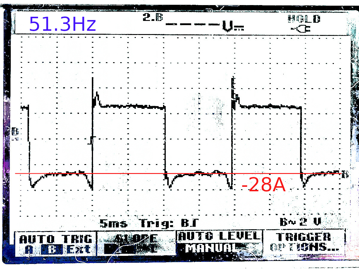

Here is another wave form attained with the same setting but the output power was set to 30A;
Attachment 35948

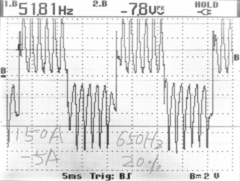

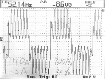

Now I'm going to replace the rectangular wave forms of the both sides (of plus and minus domains), with a couple of pulses of arbitrary frequencies given by this new addition;
Attachment 35949
Replaced the rectangular wave with 650Hz pulses, setting power 150A for welding.
Attachment 35951
also with 700Hz pulses, setting power 170A.
