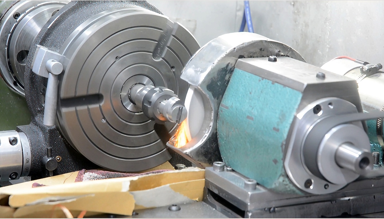

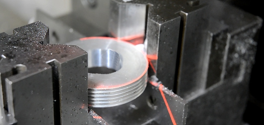

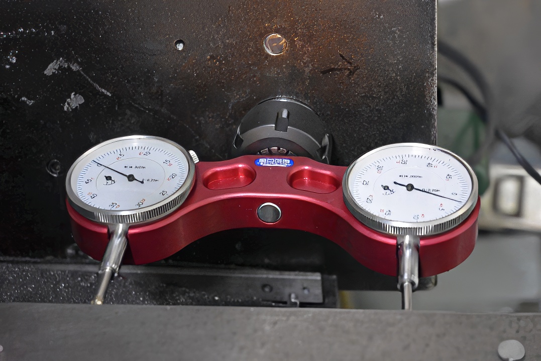

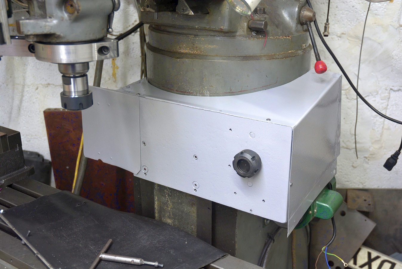

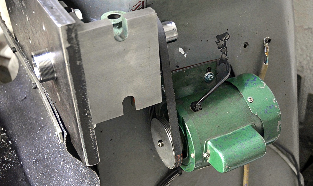

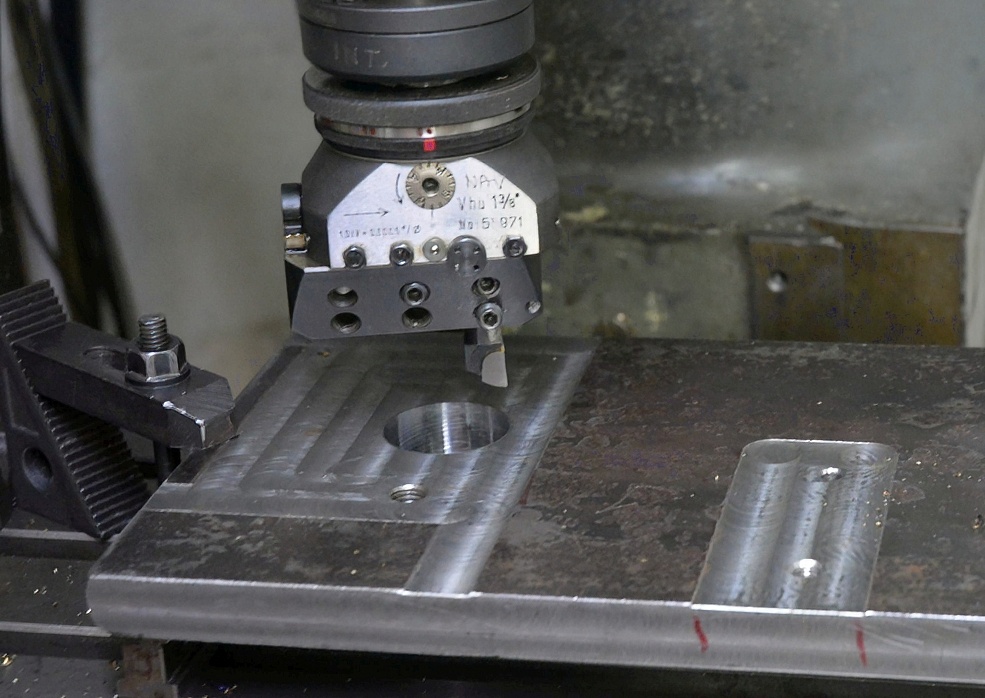

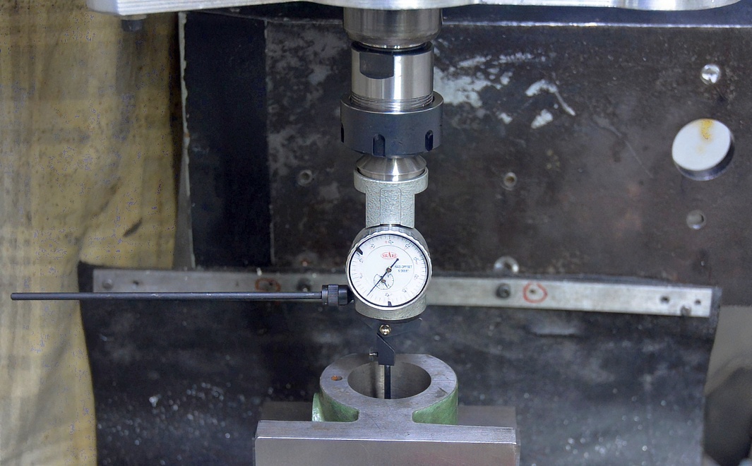

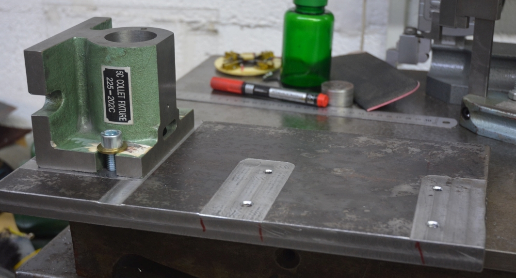

A little while back I made a post here showing how over six decades ago I converted a horizontal mill to a vertical machine, see https://www.homemadetools.net/forum/...404#post237038
This time I did the opposite. i.e. I added a horizontal spindle to a vertical milling machine. This time it was done during last week not decades past. Although I did this on a Bridgeport base the same techniques could be used on many other milling machines. I attach a PDF file with full details of the work. Included here are some photos without explanation, to pique your interest. Explanations are all in the PDF file.
Attachment 48526 Attachment 48527 Click images for full size.
Attachment 48528 Attachment 48529
Attachment 48530 Attachment 48531
Attachment 48532
