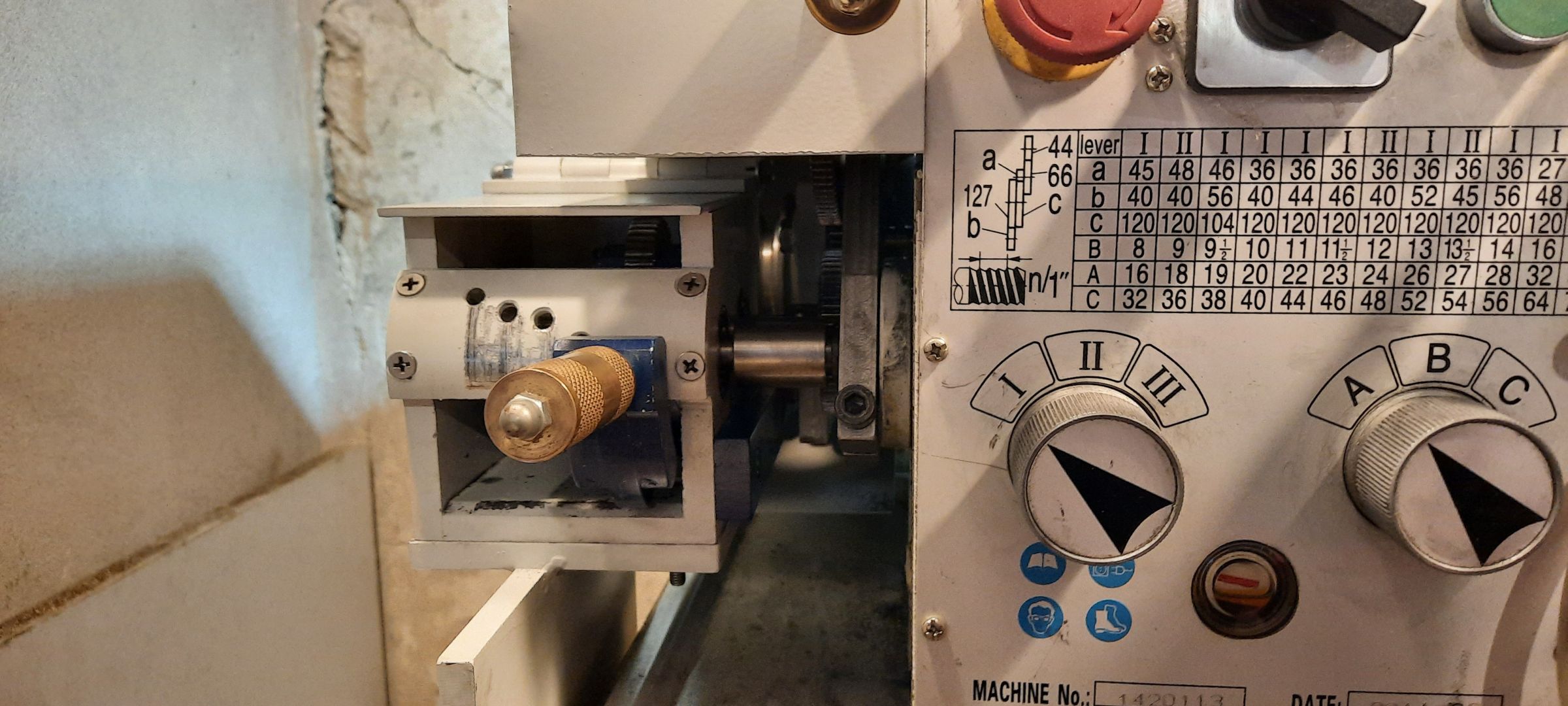

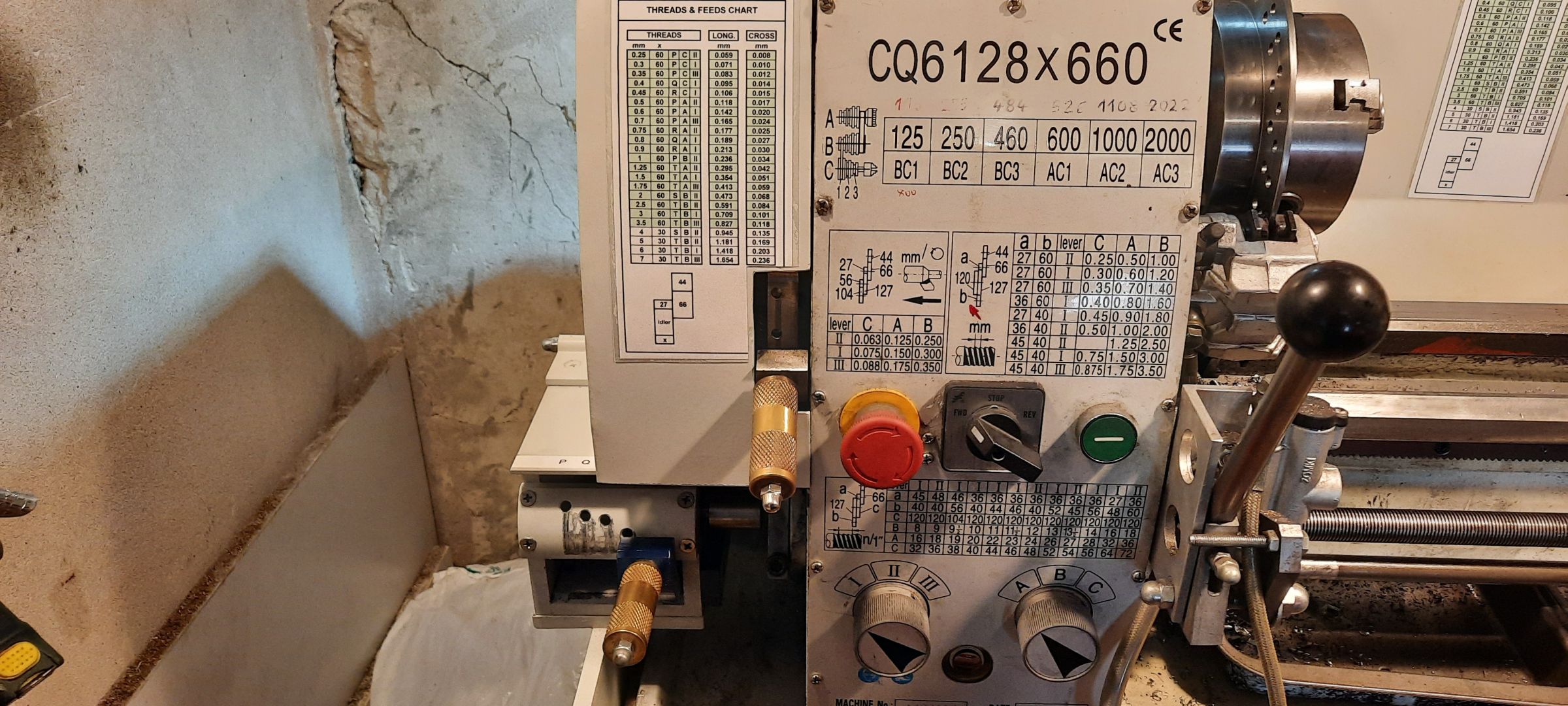

    Finally made this very important lathe modification.
    This lathe (G0602 type) already has a built-in gearbox for all metric pitches from 0.25 to 3.5 millimeters. Also all imperial pitches in the range 8 to 72 TPI, but I don't need them. But to do that and also to change to power feed pitches it is required to use change gears. Not too complicated, but it is time consuming.
    27-tooth and 60-tooth change gears is the option which gives the finest pitches. Nine of them. Combined with 5 different pitches from new gearbox it makes 45 pitches. As it can be seen from threads @ feeds chart there are all metric pitches in the range 0.25 to 3.5 mm available without use of any tool. Pitches can be changed in a few seconds
    Materials used:
    steel plate 10mm, 12 mm
    steel round pipe 3" dia
    various gears 45# steel
    stainless steel shafts dia 14mm
    6201 ball bearings
    4 washers (made from 1 HRK coins) spacers between gears
    Aluminum 6061

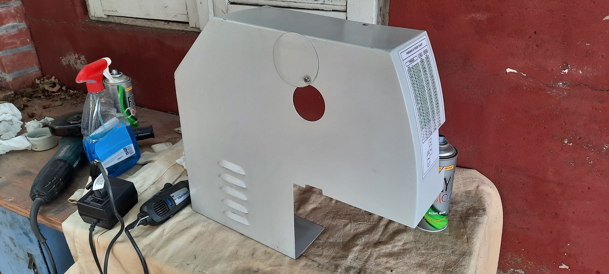

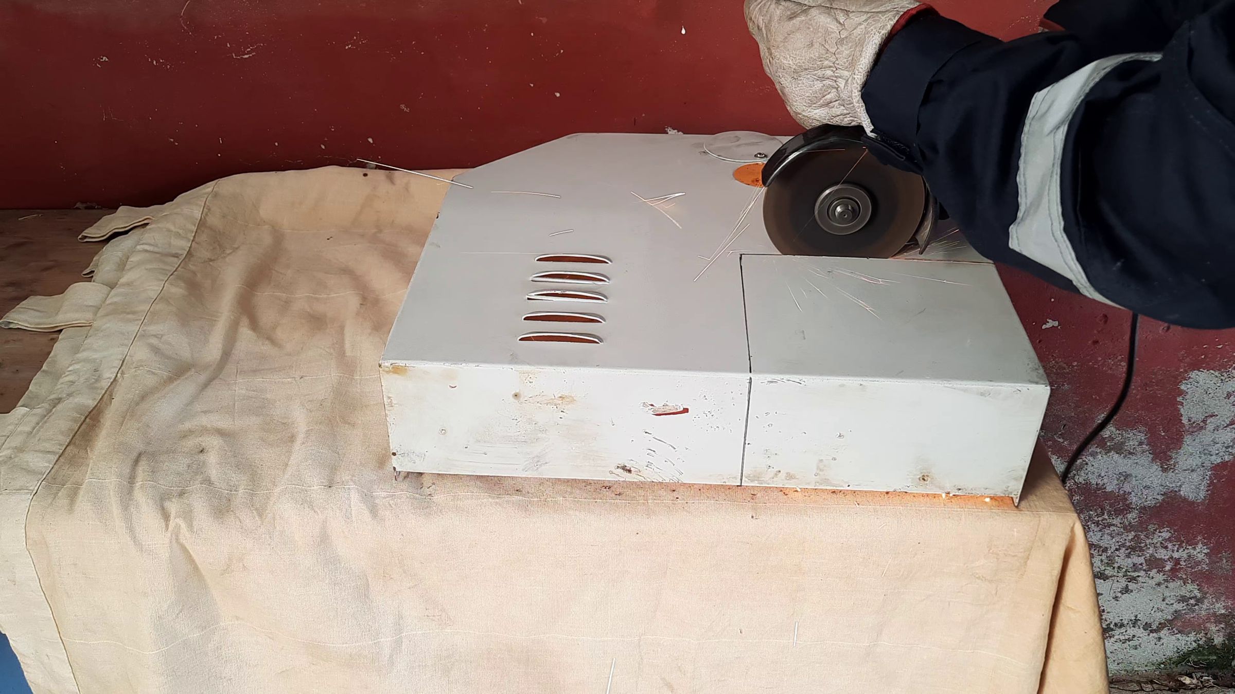

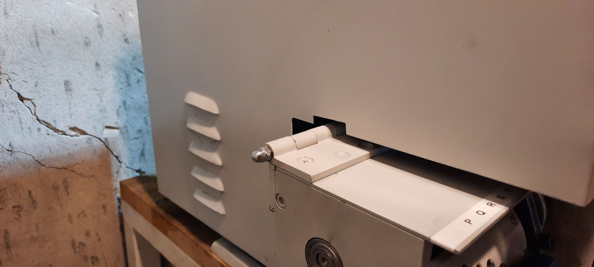

    Last moment update
    Attached Thumbnails Attached Thumbnails Additional screw cutting quick change gearbox-01.jpg   Additional screw cutting quick change gearbox-02.jpg   Additional screw cutting quick change gearbox-03.jpg   Additional screw cutting quick change gearbox-04.jpg   Additional screw cutting quick change gearbox-05.jpg
