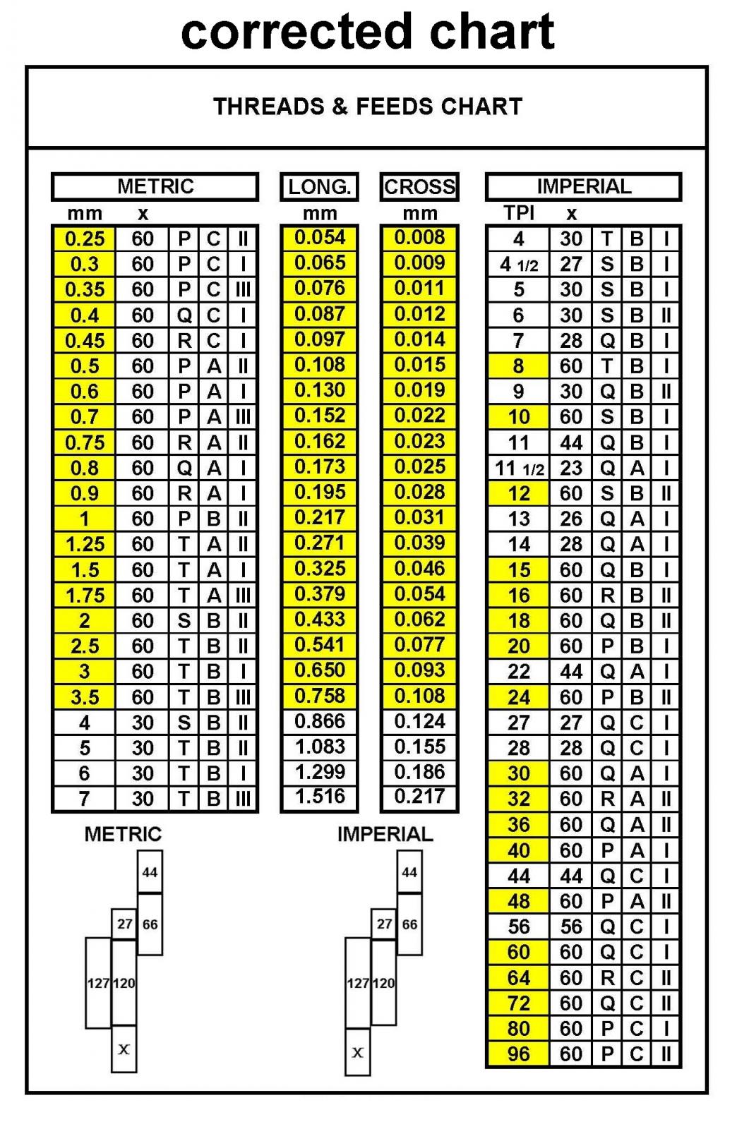

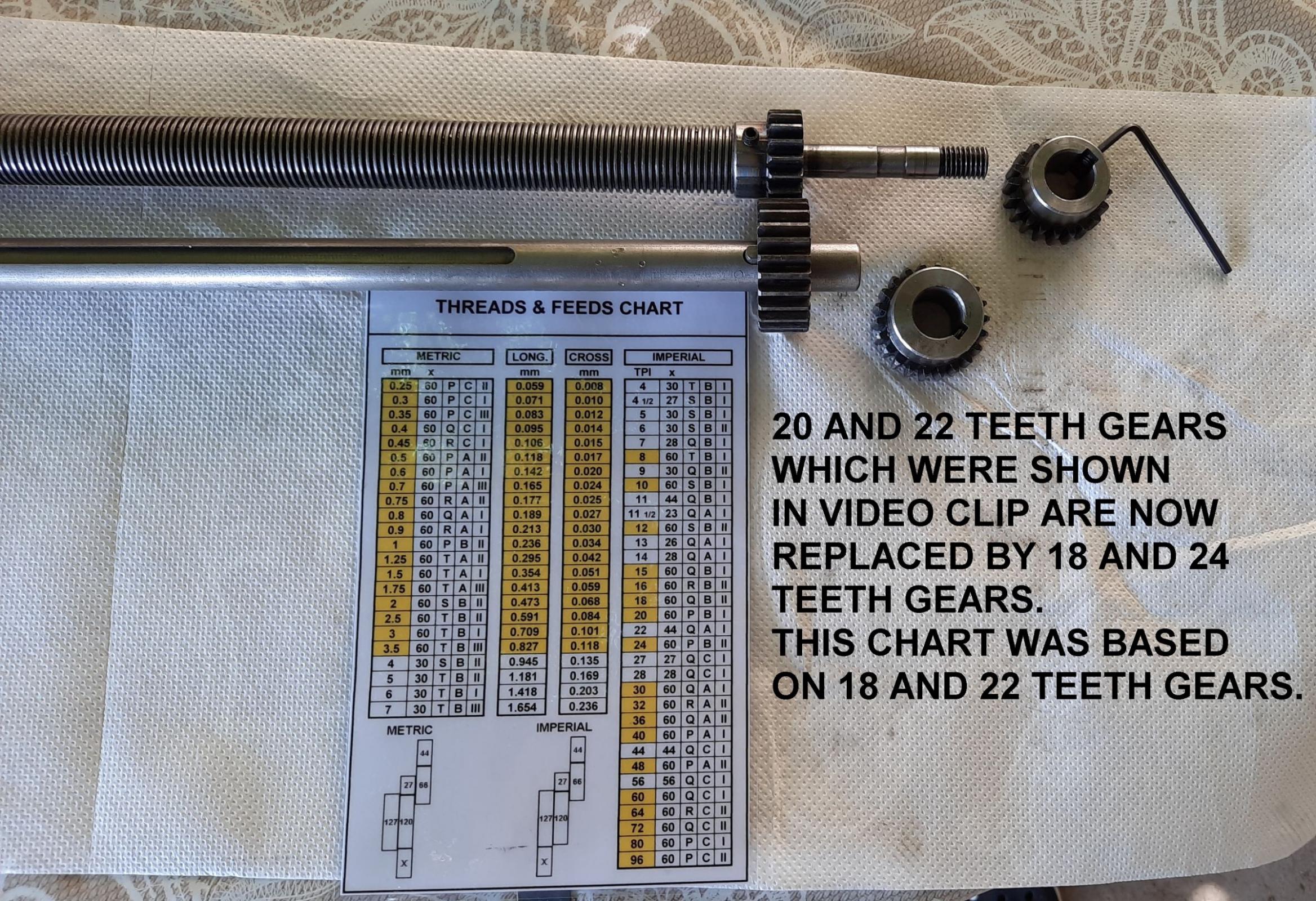

    UPDATE
    I originally planned to install tumbler for connecting gears on lead screw and feed shaft. These 2 gears were supposed to be 18 and 22 teeth gears. But never made it and found that it wasn't necessary at all. That's why I used 20 and 22 teeth gears without tumbler. Today I found another gears; 18 and 24 and installed them.
    Also prepared new Thread and Feed Chart, which still needs to be printed and laminated. But anyhow this chart will be posted once I complete my next project: Additional Screw Cutting Gearbox (Norton type).
    Few pictures attached.

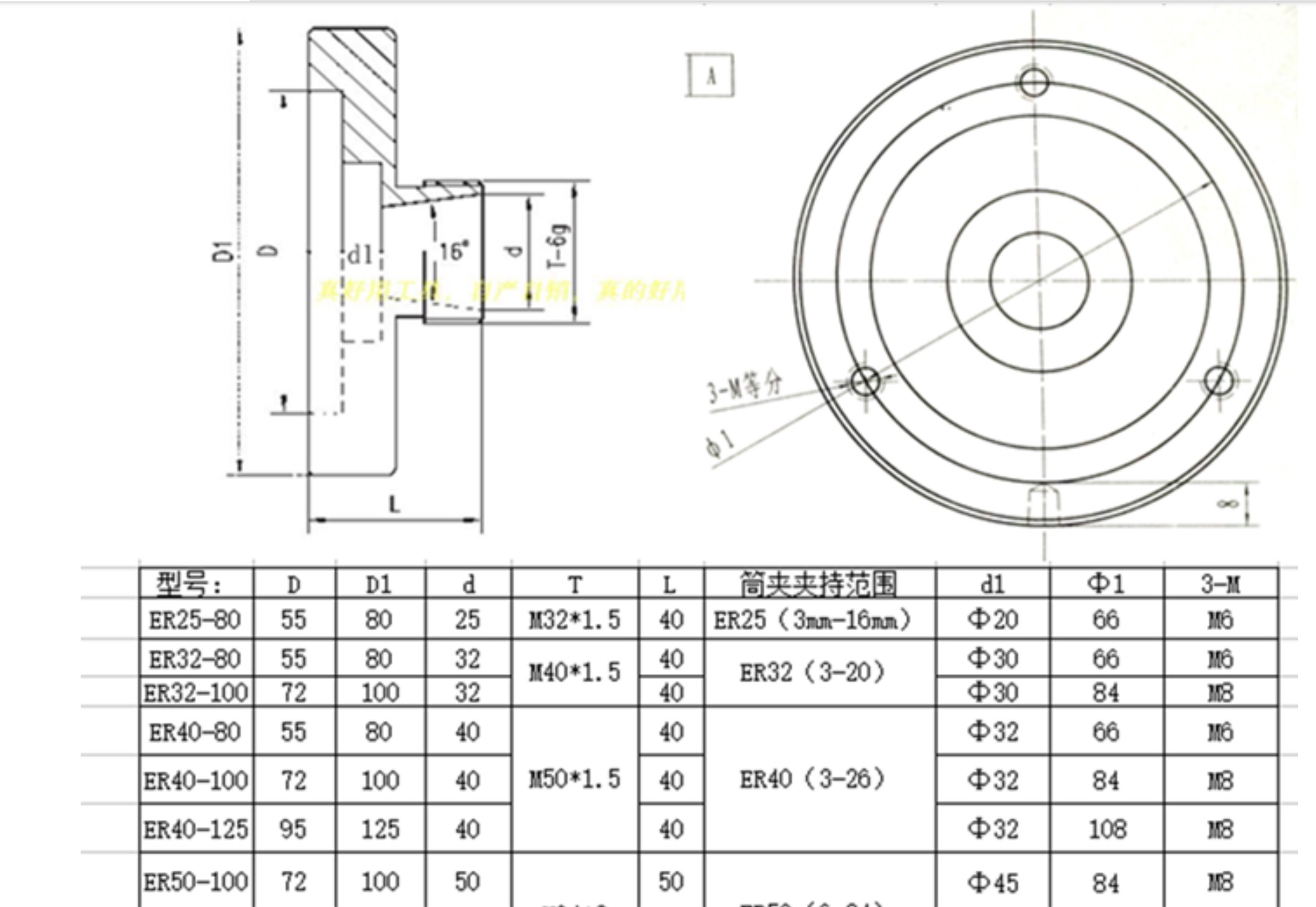

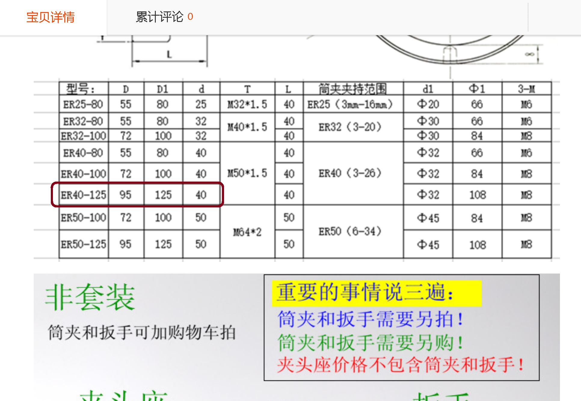

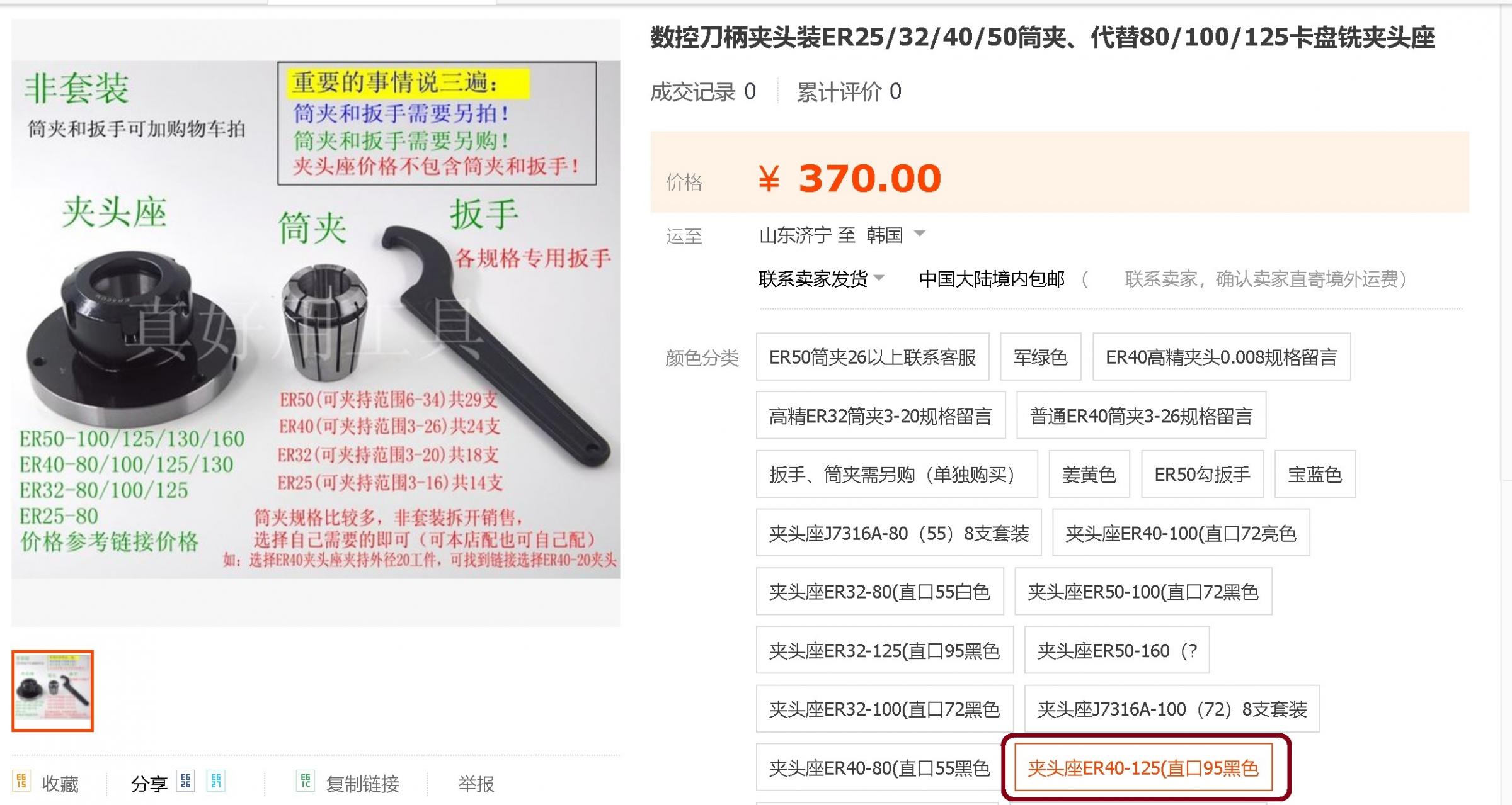

    I almost bought ER40-125 (95) Collet Chuck. That one would fit my back plate. It was quite cheap in China, but heavy and I already had more than enough steel in my suitcases. In the meantime I installed motorcycle brake at my chuck, actually to back plate and then it wasn't an option at all. Here are couple of pictures of this collect chuck. But if I have to install it, I will only buy ER40 - A clamping nut and ER40 collets. Would fabricate collet holder in situ, so TIR (total indicated run out) would be almost zero.
