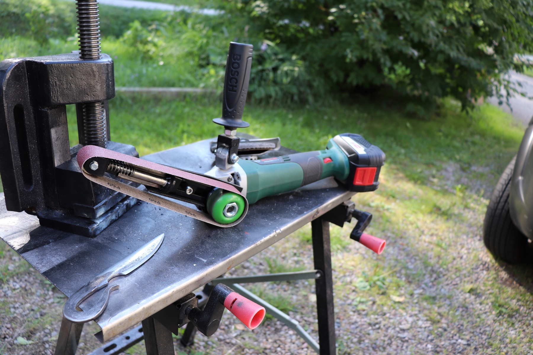

    Examples of use:

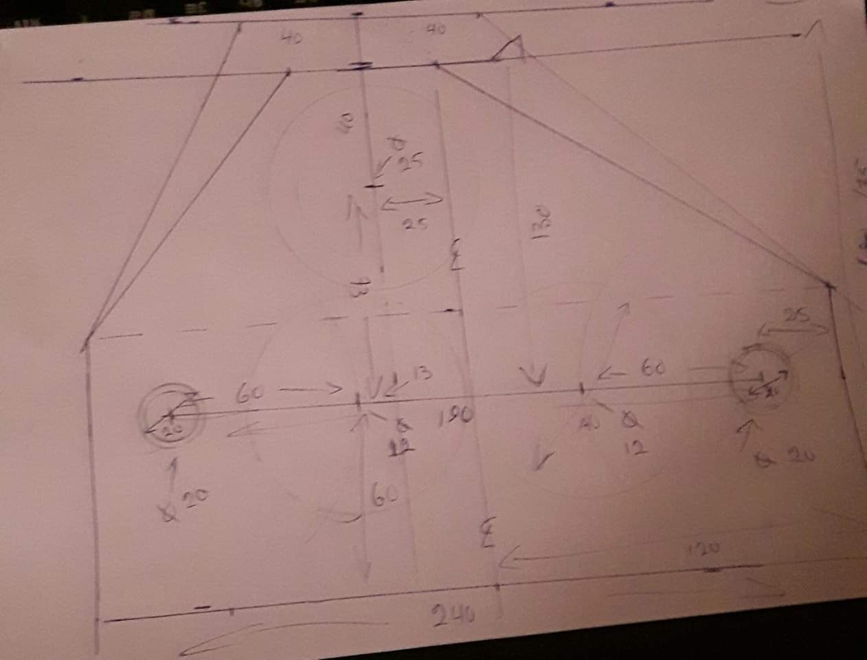

    Btw.. people asks plans from me sometimes.
    Here's my plan for the ring roller that i have been building atm.
    Angle grinder pipe sander attachment. - quick mount --fb_img_1540478801217.jpg

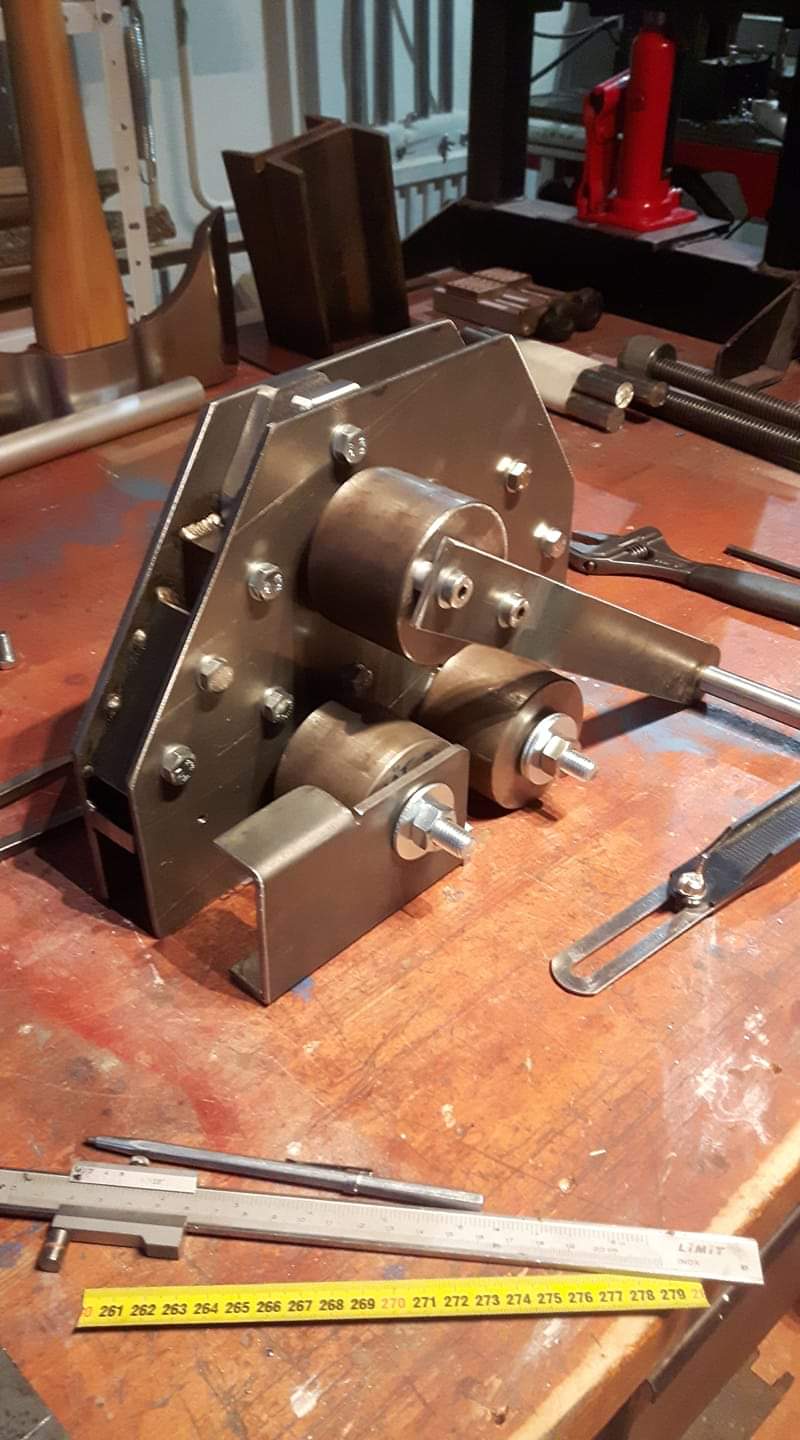

    And here's the build atm..
    Angle grinder pipe sander attachment. - quick mount --fb_img_1540465542157.jpg
    I just make notes for myself, from measures need to remembered etc... I think those ain't very usefull for others.

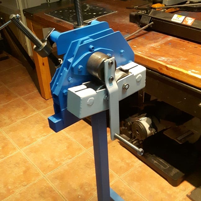

    Finished ring roller.
    Angle grinder pipe sander attachment. - quick mount --img_20181108_140115_257.jpg
