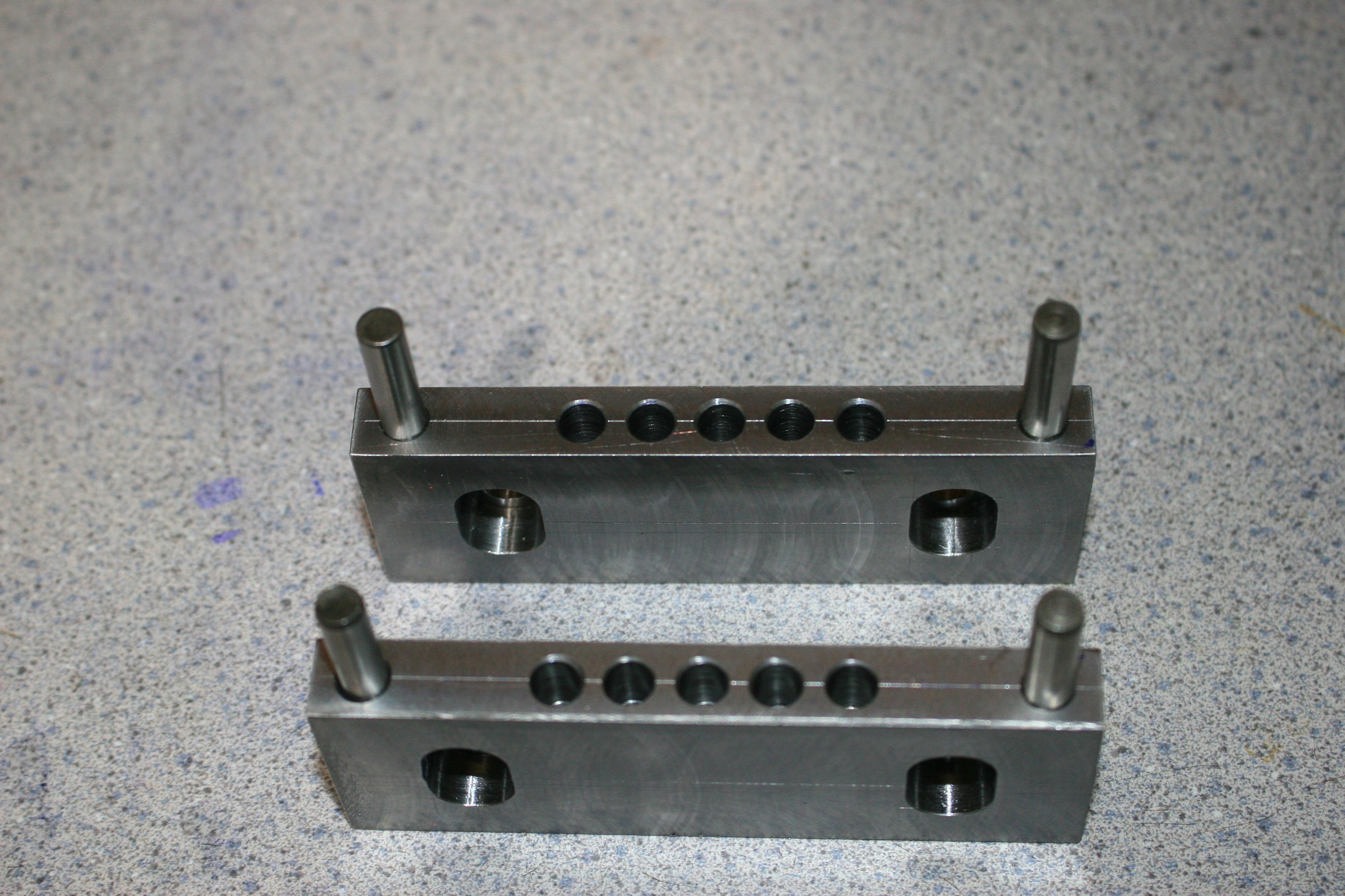

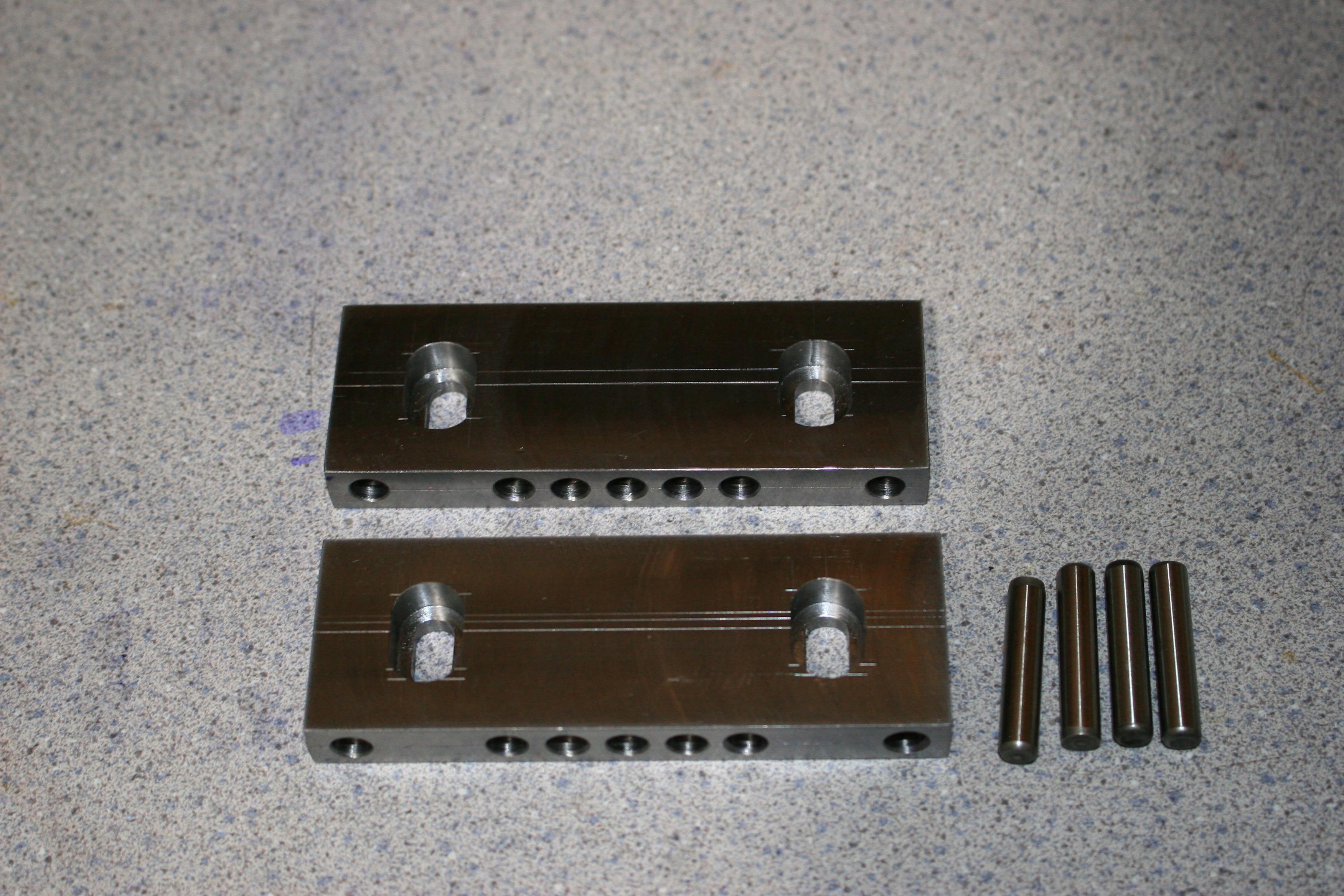

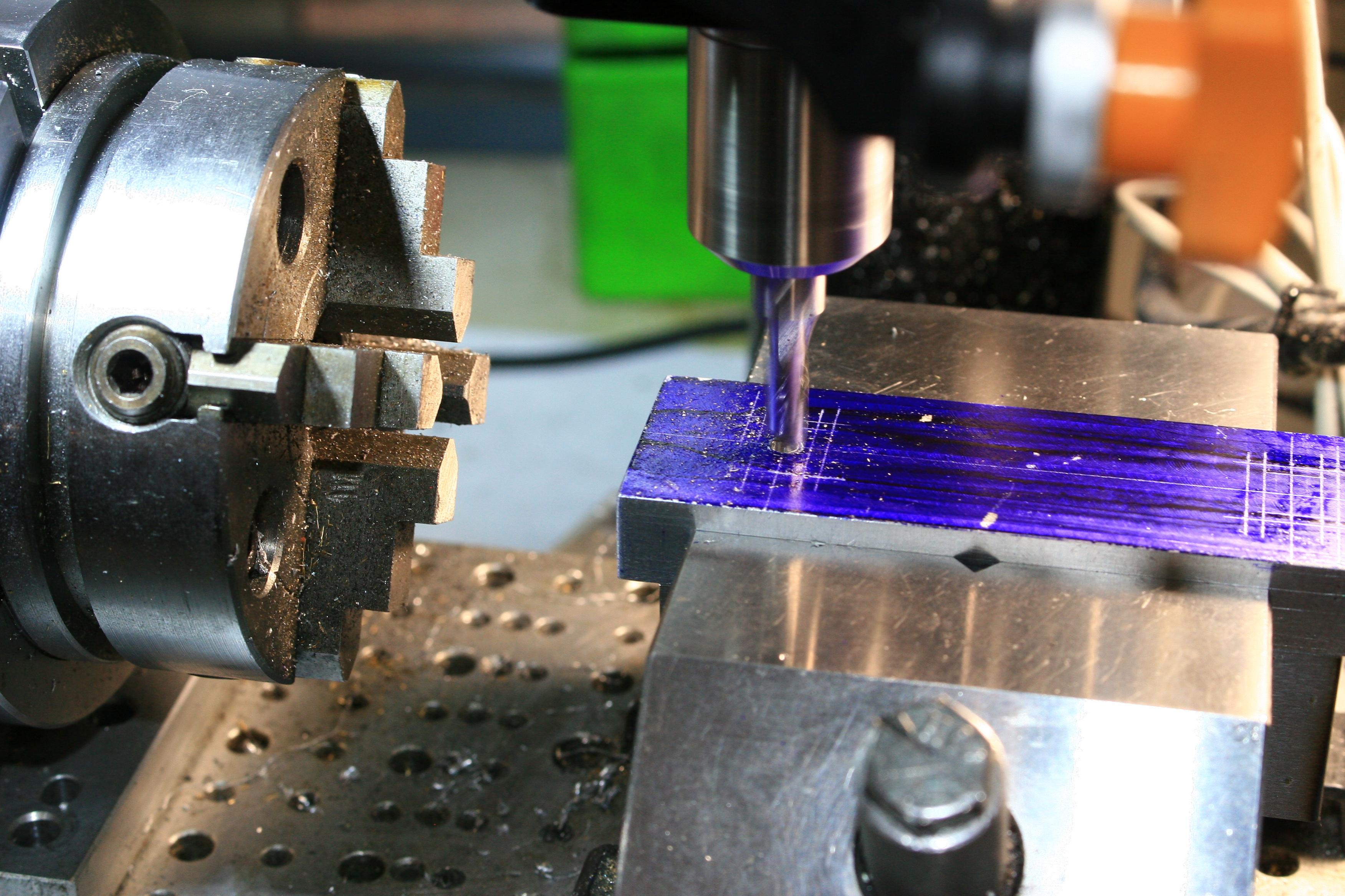

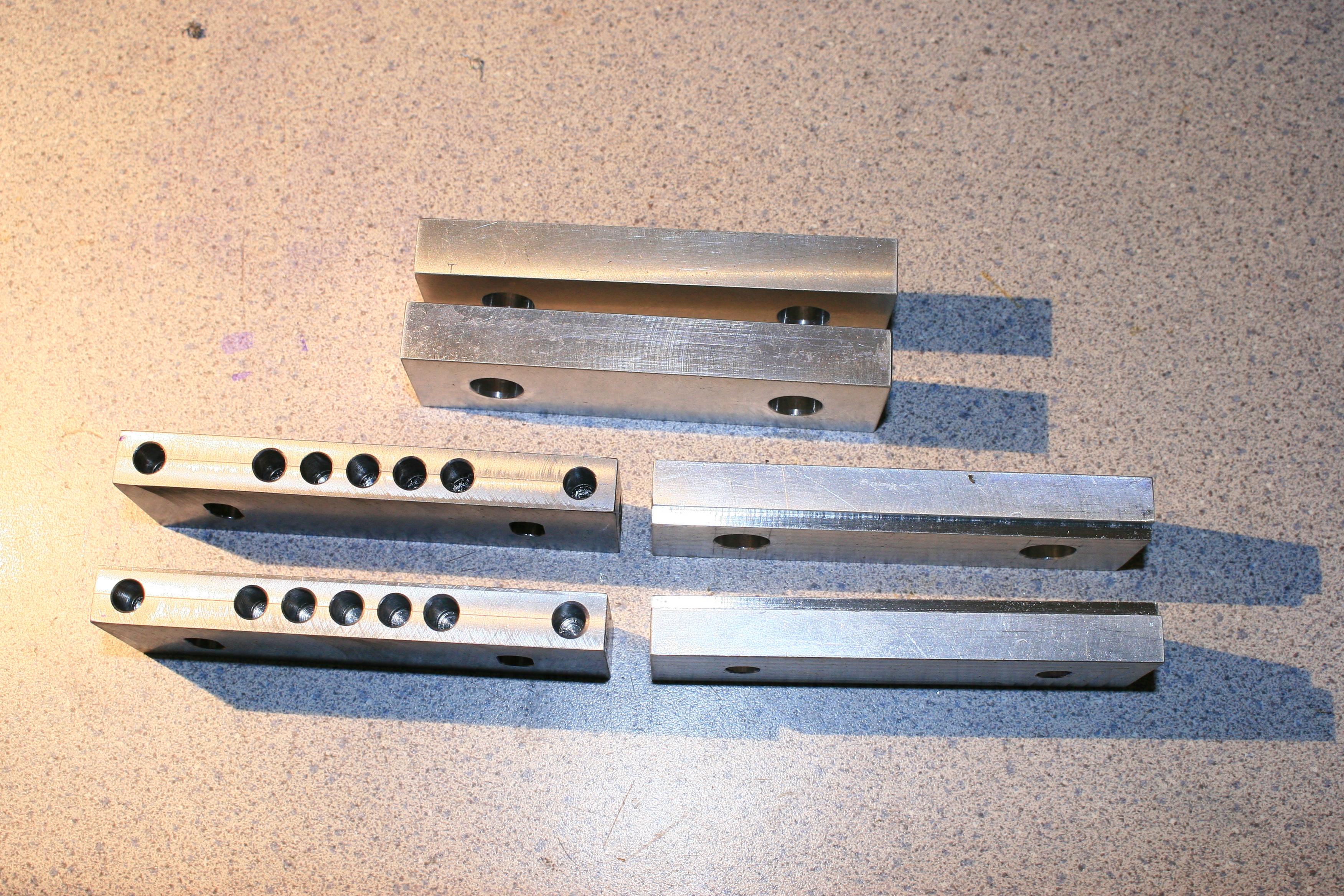

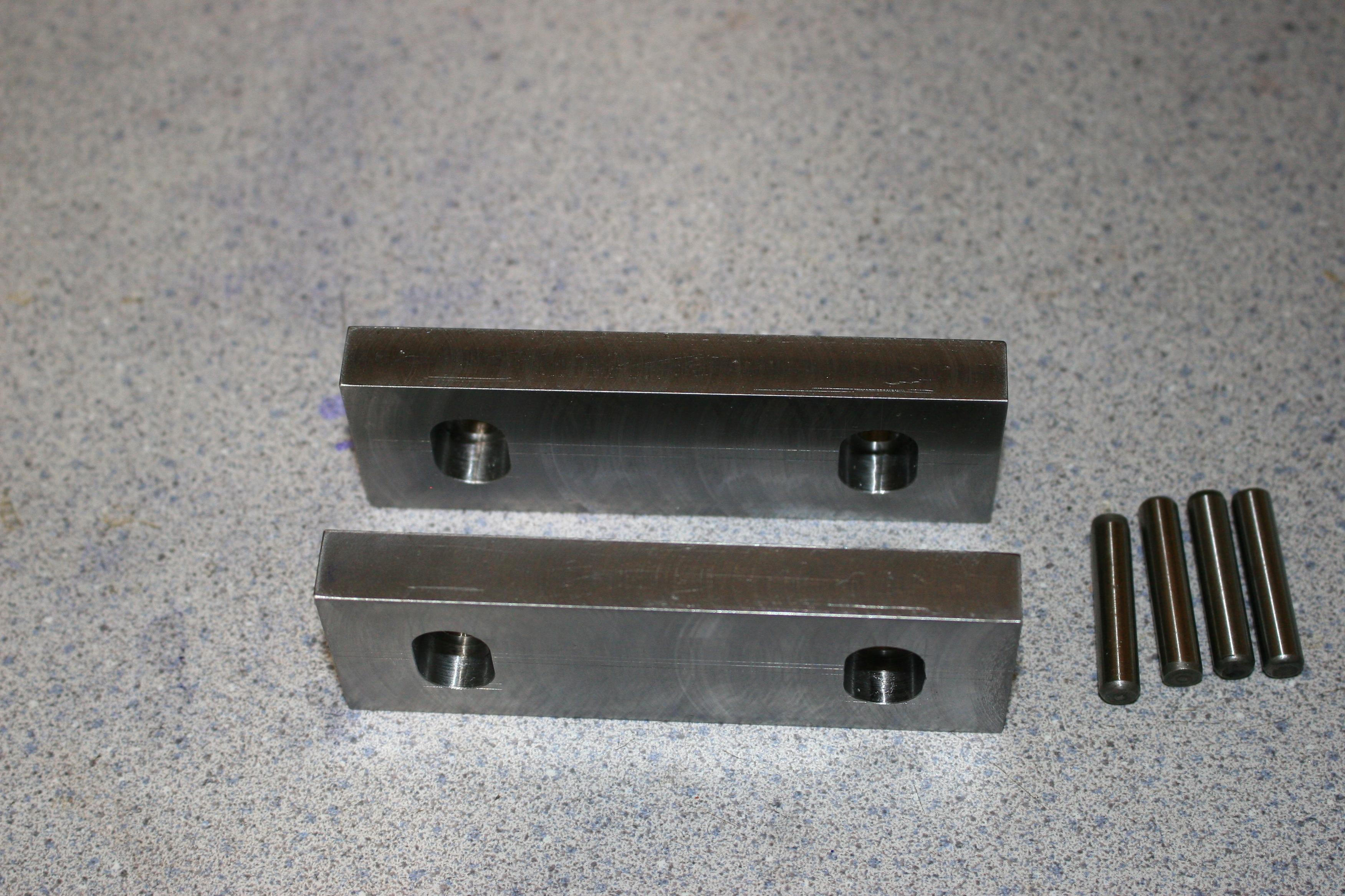

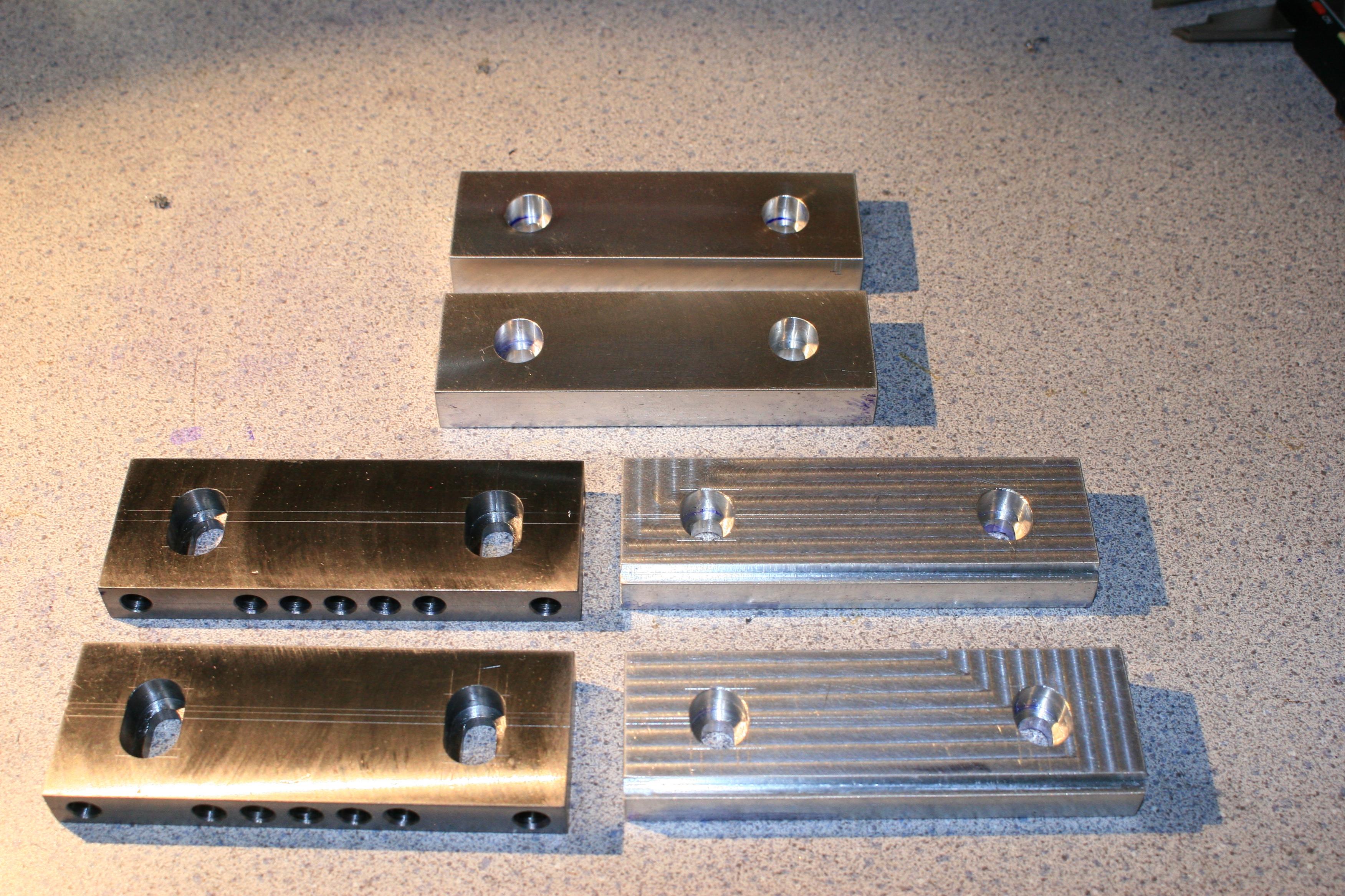

    The dimensions of these jaws are for an Import Kurt Style 4" Milling Vise.
    The original jaw can only fit in one position since the mounting holes are not centered.
    I wanted to be able to use both the top and bottom of the jaws for different purposes.
    The jaw mounting screws are 6 mm on my vise so I slotted the mounting holes to fit.
    Several versions are shown.
    Original
    Soft for future milling as necessary.
    Soft with built in "parallel" function.
    Steel with 1/4" pins for odd and circular shapes.
    Each of the jaws can be used on either the top or the bottom as needed.
    Cheers, JR
