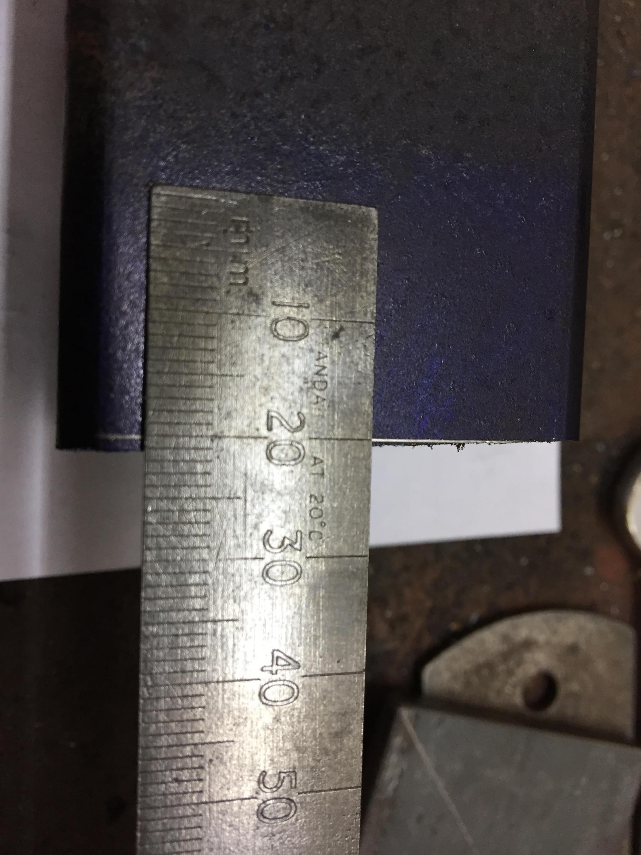

    Found a small metal band saw at a pawn shop.
    Old, but does not look like it has worked too hard.
    Paid R800 for it ($70, £50 , €55)
    Seems I might have found why it is so cheap. it is cutting skew in the saw axis plane.
    I have watched all You Tube videos in the topic and have cleaned, deburred the slots Bandsaw cutting skew - HELP-cuttingscew.jpgand replaced the worn washers with thick new ones, but still...about 1.2 mm on a 50mm cut.
    Any suggestions?

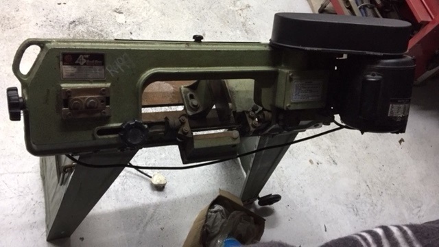

    It seems my first task is, to get a new blade.
    Currently I have a 14T blade, Is this generally the most universal blade to buy?
    I will be cutting predominantly Mild Steel with the odd piece of SS or Aluminum.
    The roller guides are adjusted properly. When I got the machine the previous owner did not clean them and there was evidence of wood, plastic and steel. I cleaned then and adjusted them to the blade and the whole carrier as per suggestion on You Tube. I still need to replace the rollers behind the blade as they show evidence of where the blade's back is touching them.
