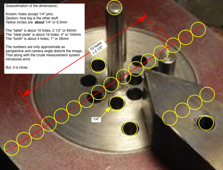

    Found this thread while looking for some bender ideas. In order to begin work on mine, I did some estimating of sizes from Marv's images. I shared them here for anyone who may be interested. They may not be exact, but should be close.

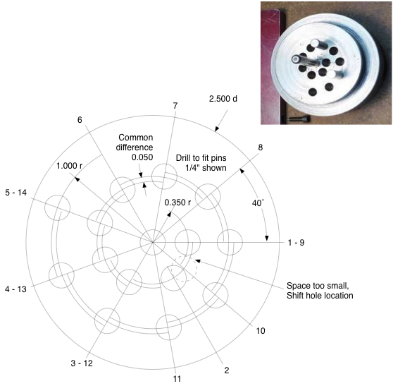

    This hole layout is not an actual Archimedean Spiral. It is simply a geometric construction for a set of holes varying in distance from a center point.
    It is to scale so if you print it so the main circle is 2 1/2", the rest will be correct.
    Just beginning the project, will provide details on the completed project in a new post at a later date.
    I wanted to give credit to Marv for the inspiration.

    I get this message...
    Invalid Attachment specified. If you followed a valid link, please notify the administrator
    on each of the attachments.
    Regards, Marv

    does it work now?
  5. #25
    LA, CA, USA
    3,720
    376
    Thanked 7,192 Times in 2,348 Posts
    mklotz's Tools
    does it work now?
    Yes, both illustrations now show inline in the article. Thanks for the fix and good work deriving the dimensions.
