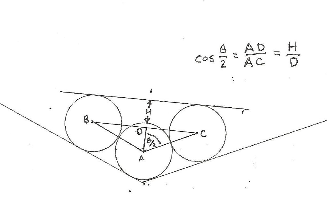

    There's an old trick for measuring angles that might be applicable to this problem.
    If three rollers of the same diameter D, are placed in the bend and the two upper rollers pressed by a flat surface until the distance of that surface from the middle roller is H, the resulting angle is theta.
    In the measurement problem, H is measured and theta is derived from the equation shown. For the bending problem, one would calculate the required H from the desired angle, theta and press until that H was achieved. Perhaps, making a spacer of the desired H would simplify the process.

    The problem with air bending or bending metal using any method is all of the mathological calculations in the world will not yield the true finished angle of the metal after bending and released each and every time, due to whats known as spring back. Even the softest of metals with the lowest tensile strength will have a certain amount of natural tendency to try and remain straight. the thicker and higher the tensile strength the mode it spring back there will be
    Sure this can be calculated into the final equation and will yield close results but if one takes 4 square pieces of metal cut from the same sheet careful not to turn or flip them then mark each one so you will know the front from the back and the edges A.B.C.D. then bend 1 piece face up bending edge A &C bend 1 piece face down bending edge A&C then do the same again for the remaining 2 pieces this time bending edge B&D making all bends with the same amount of pressure and to the same stop each time you will have 4 different bend angles every time. Albeit minor the angles will be measurable particularly if you use Marv's vary accurate way of measuring angles
    Using Rick's method of predetermining the desired final bend angle will work quite well and yield repeatable bends for general purpose bending providing the exact same bend pressure is used each time higher pressures will cause thinning of the bend at point of contact between the punch the intended part and the stop gauge

    I was wondering when someone would raise the issue of springback.
    Of course, a little experimentation will quickly reveal how much greater the bend angle must be to result in the desired final angle after springback.
    I've never yet encountered a situation where the bend angle had to be better than the usual TLAR standard.
