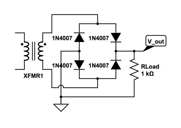

    I am trying to build a pyrography machine and need some help. I need to know how to convert the ac output from the transformer to dc power.

    I am using a 230v transformer with a 24v 100va output. Di I need to use diodes to convert the power to DC.

    I believe that if I were you. I would first try just connecting a pair of High temp leads to the output then silver braze a bent piece of nicrome wire to them. you can find this in the heating elements of an electric radiant heater. It needs to be silver brazed instead of regular solder due to the high temperatures the tip of the nicrome will develop.
    since this will be pure induction current AC voltage will probably be just fine. if not then here is a typical layout of a bridge rectifier
    you would size it up or down according to your requirements
