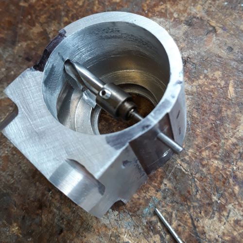

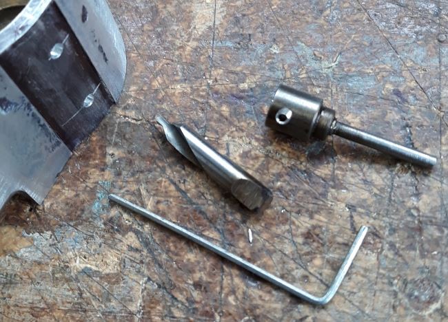

    I needed to countersink a hole inside the case of a model engine so that I could fit a bracket. The only way I could think of doing it was to make an extension for the countersink with a small drive shaft - by default the countersink head is bigger in diameter than the hole it is countersinking. Even with holes opposite each other this would be a difficult problem to solve.
    in action
    or nearly in action as I ended up driving it with a small hadnheld electric drill.

    There are tools made to countersink the otherwise inaccessible back side of a hole but such tools would have been expensive overkill for your problem.
    Your solution of constructing the needed tool inside the obstruction is an ingenious technique that should be in everyone's mental quiver of unusual solutions. Good on you.

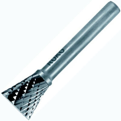

    At my workplace, we use tungsten carbide cutters and die grinder.
    Like this:
    Also ones that are shaped like car valve.
    Those are cheap and easy solution.

    Another possible technique is a cutter with an inverted cone shape, i.e., the cutting end flares outward from the shaft at the tip, major diameter at the very end of the tool (picture a router dovetail bit, only much smaller). If the diameter of the cutter is small enough to pass through the hole and the angle of the cone matches the required countersink angle, then insert tool through hole and move around in small circle to cut the countersink. Recenter to withdraw from hole.
    The geometry works but I sure wouldn't want to be the guy tasked to make it work in practice.
