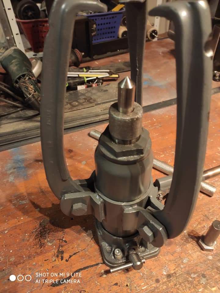

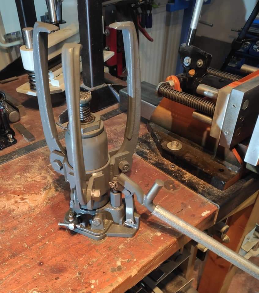

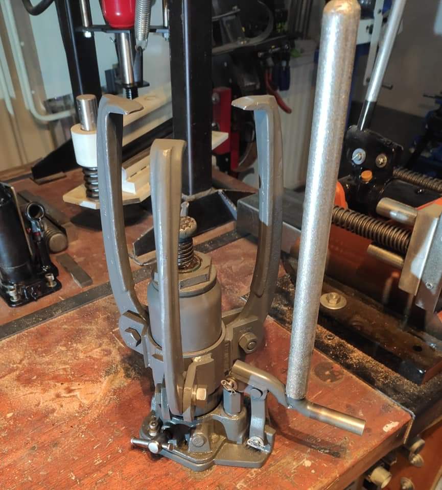

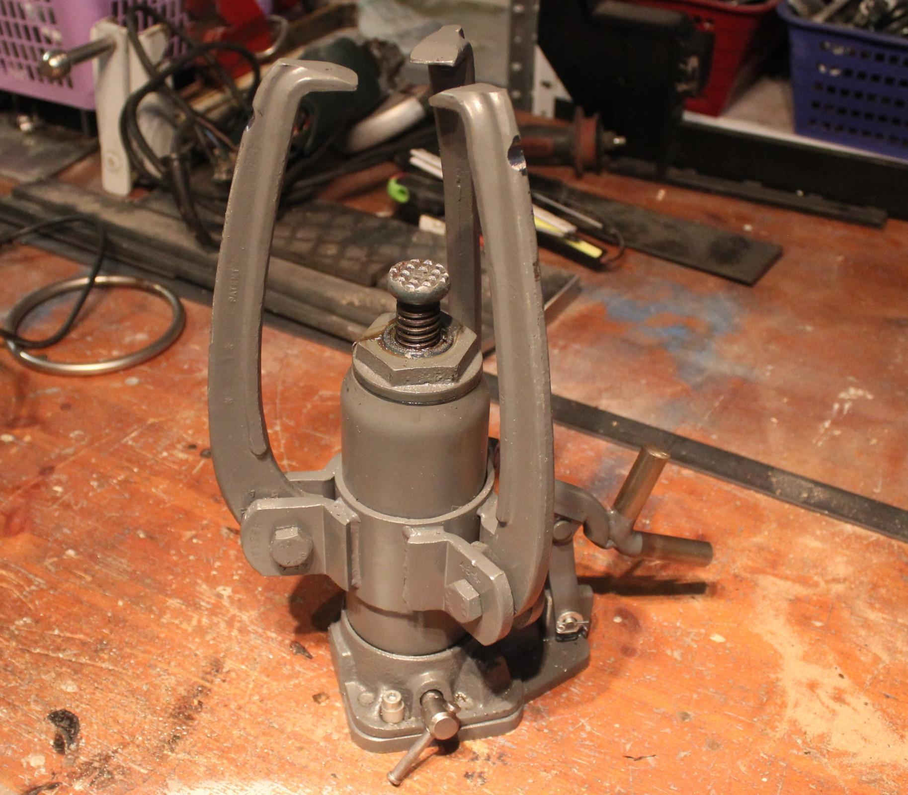

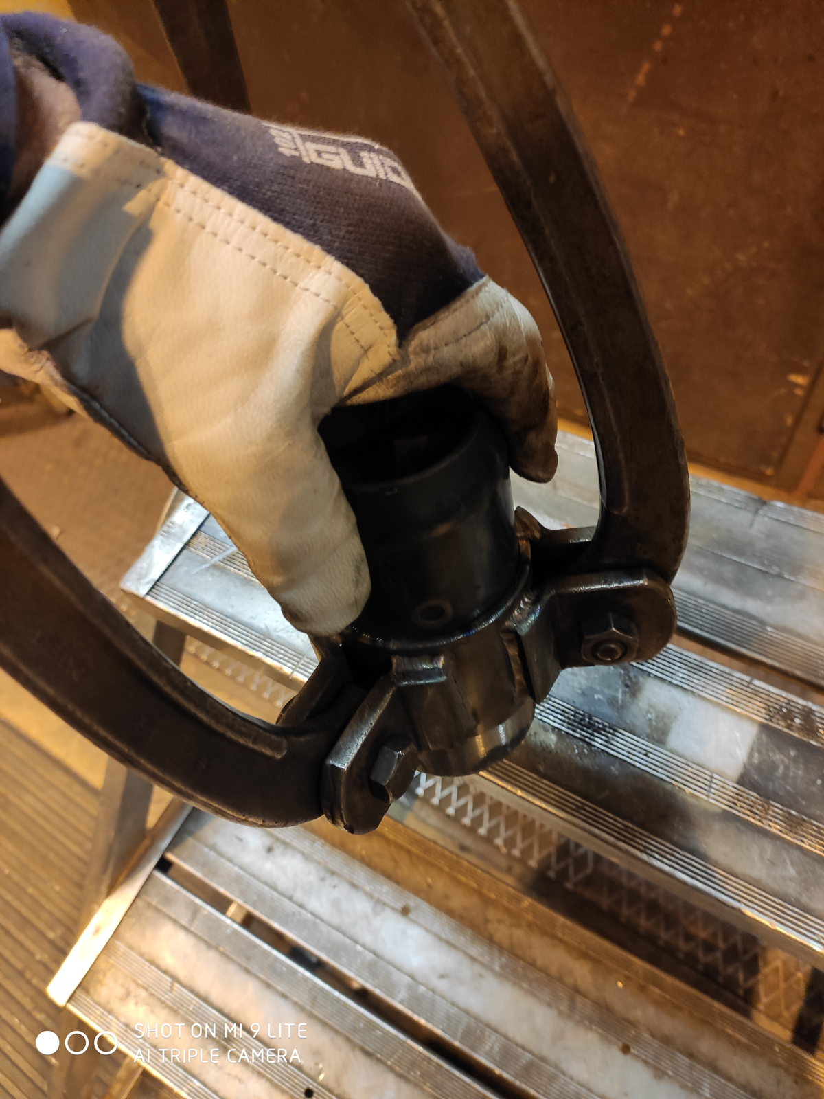

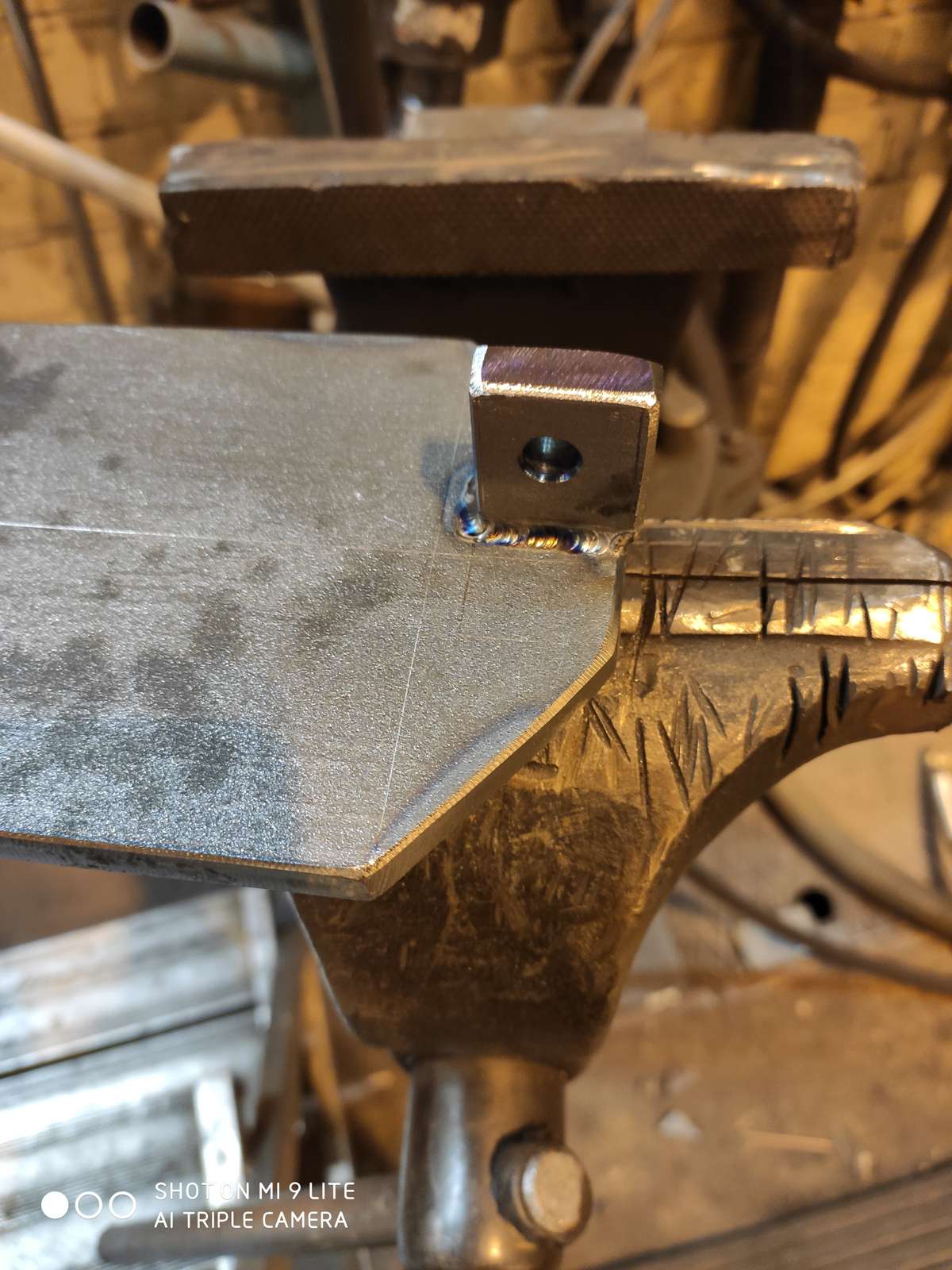

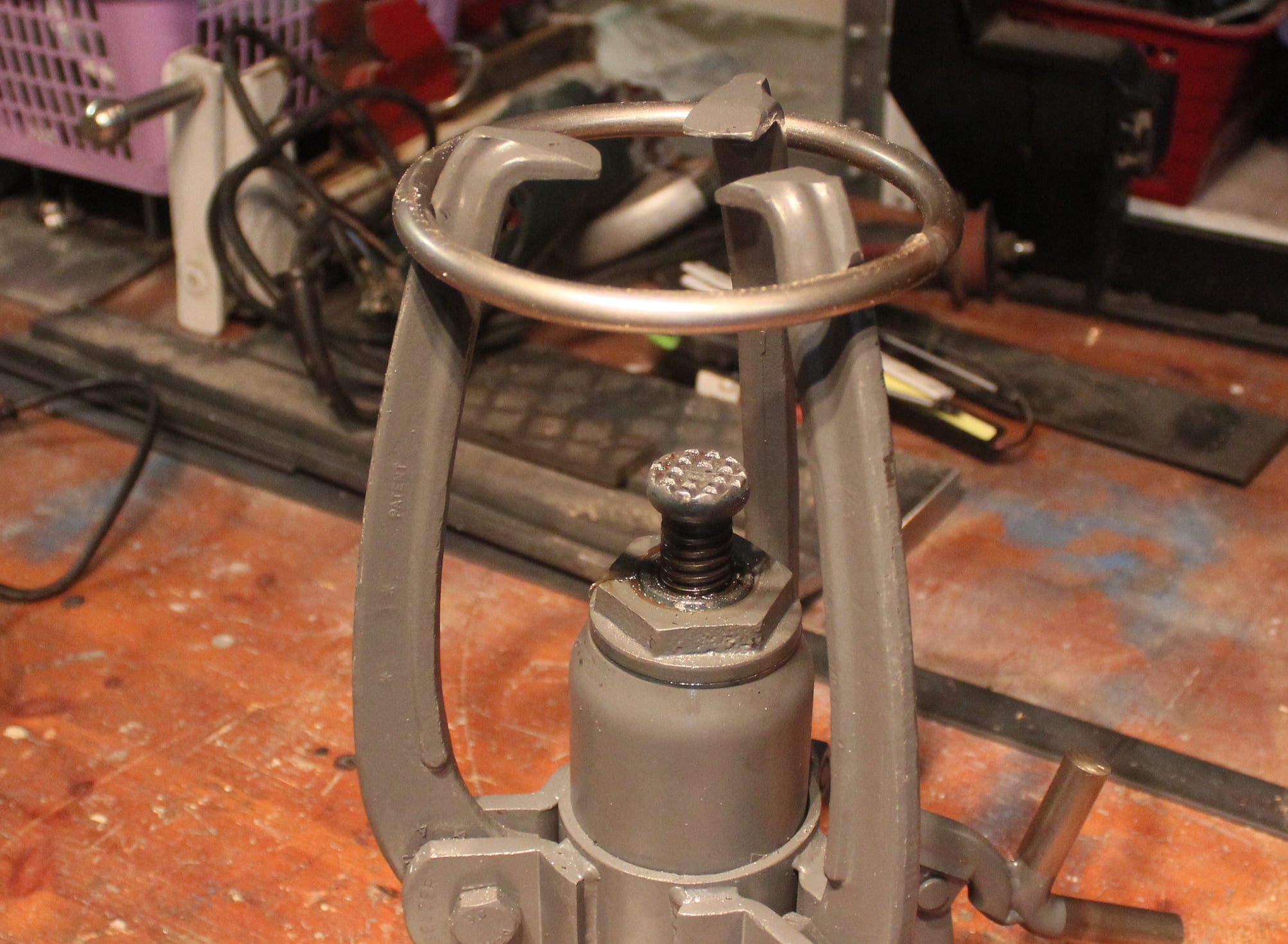

Made my version about the diy hydraulic bearing puller.
I have seen some videos about making one, but i wasn't convinced about the presented structures.
So, i made my own version.

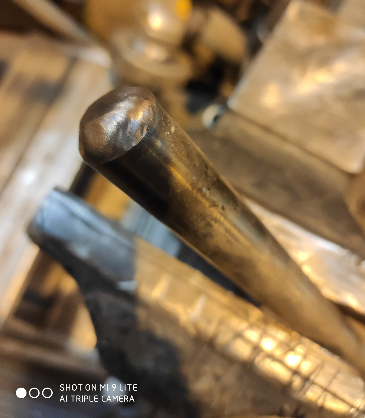

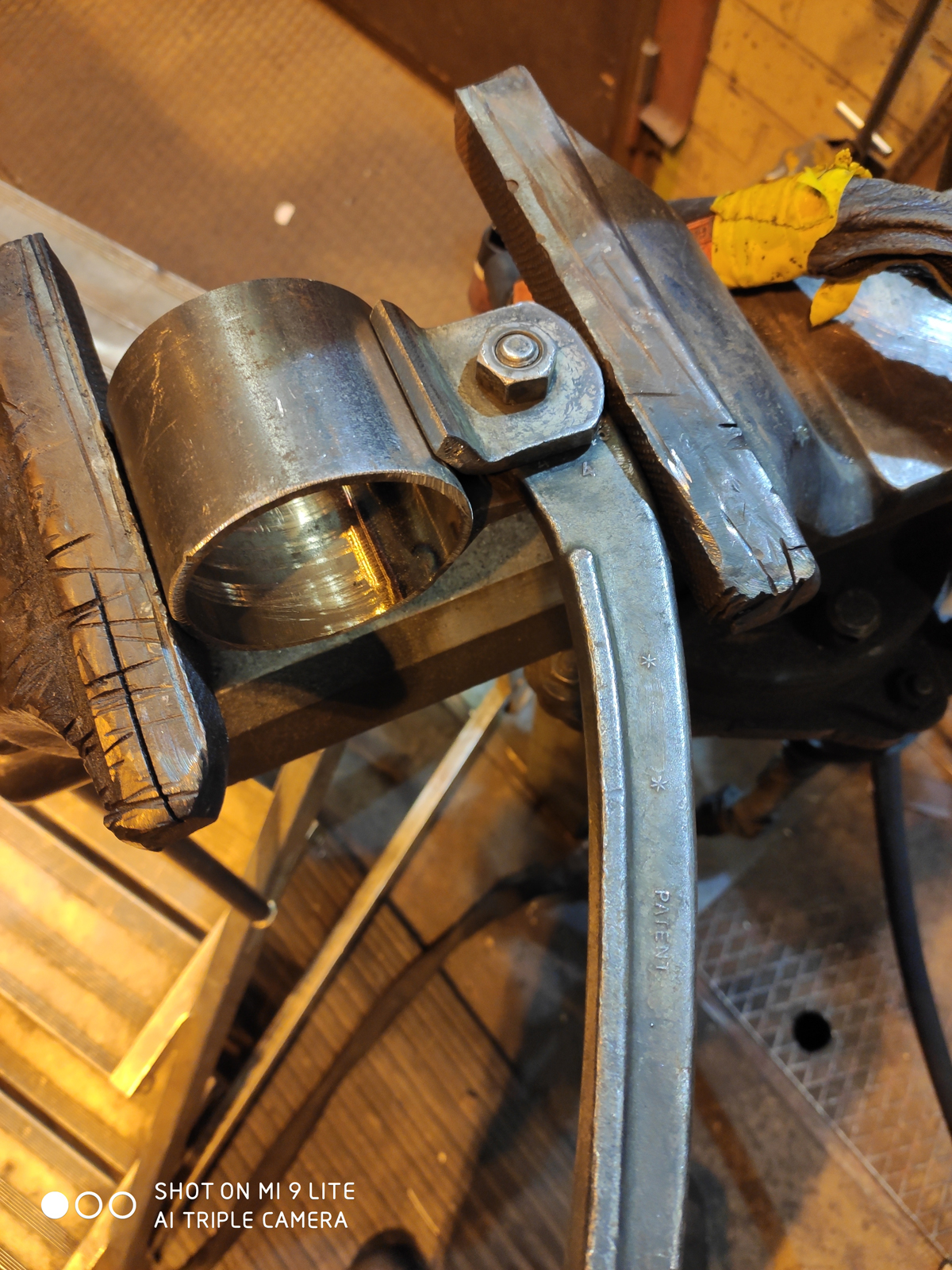

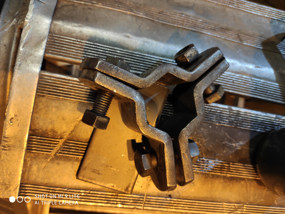

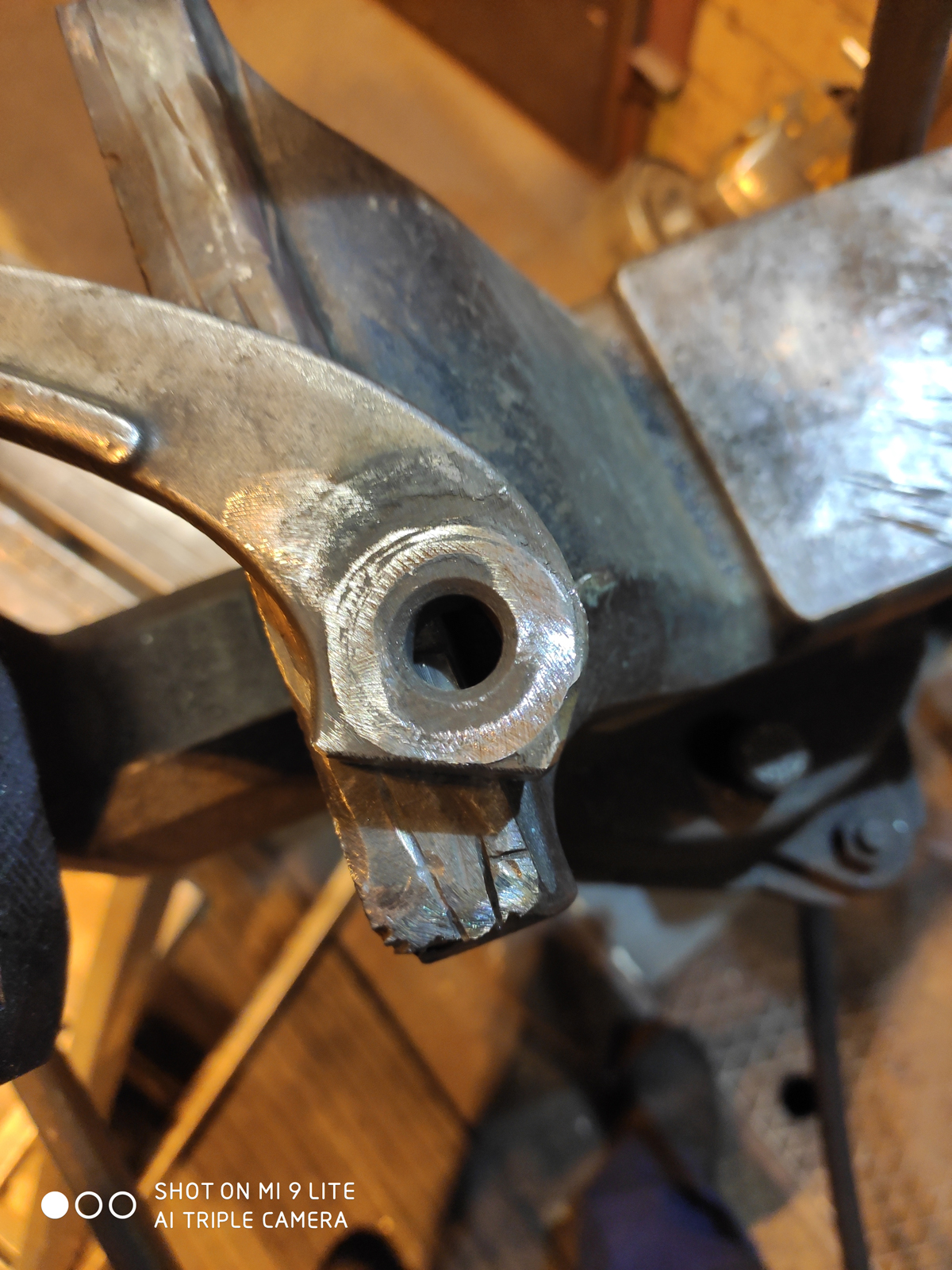

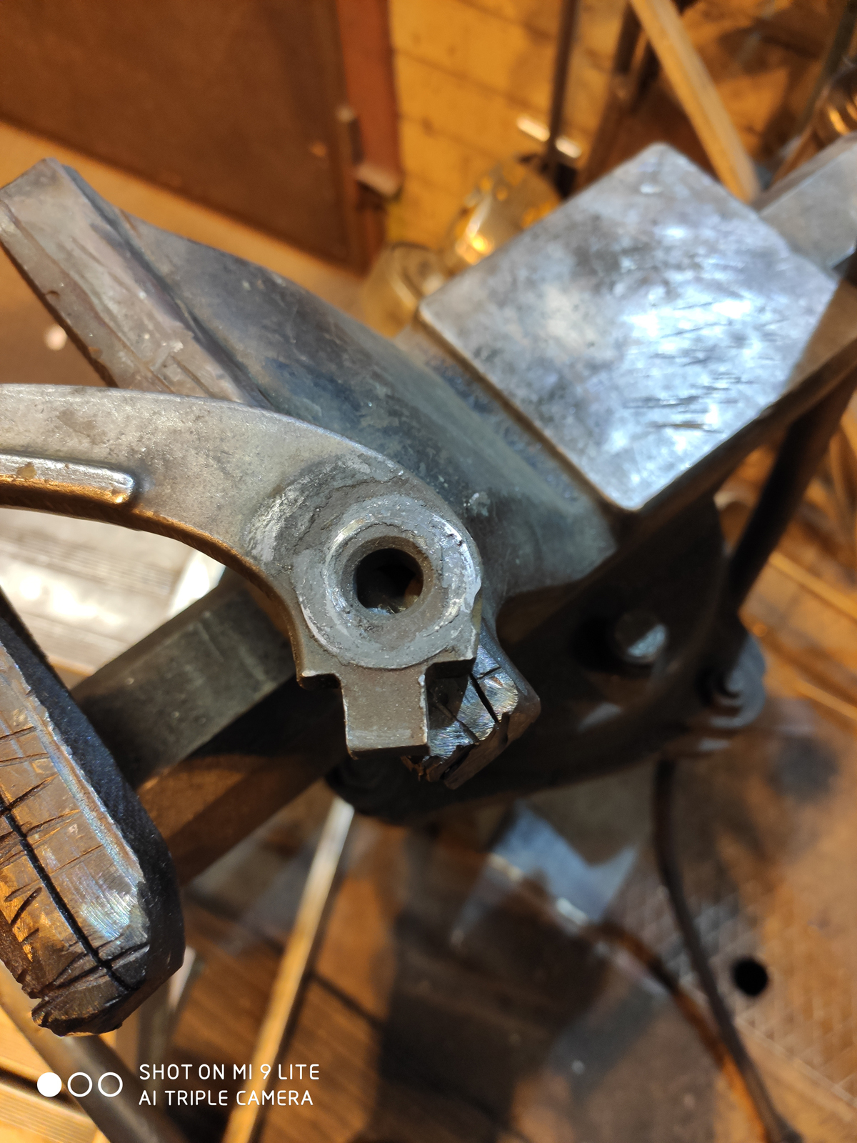

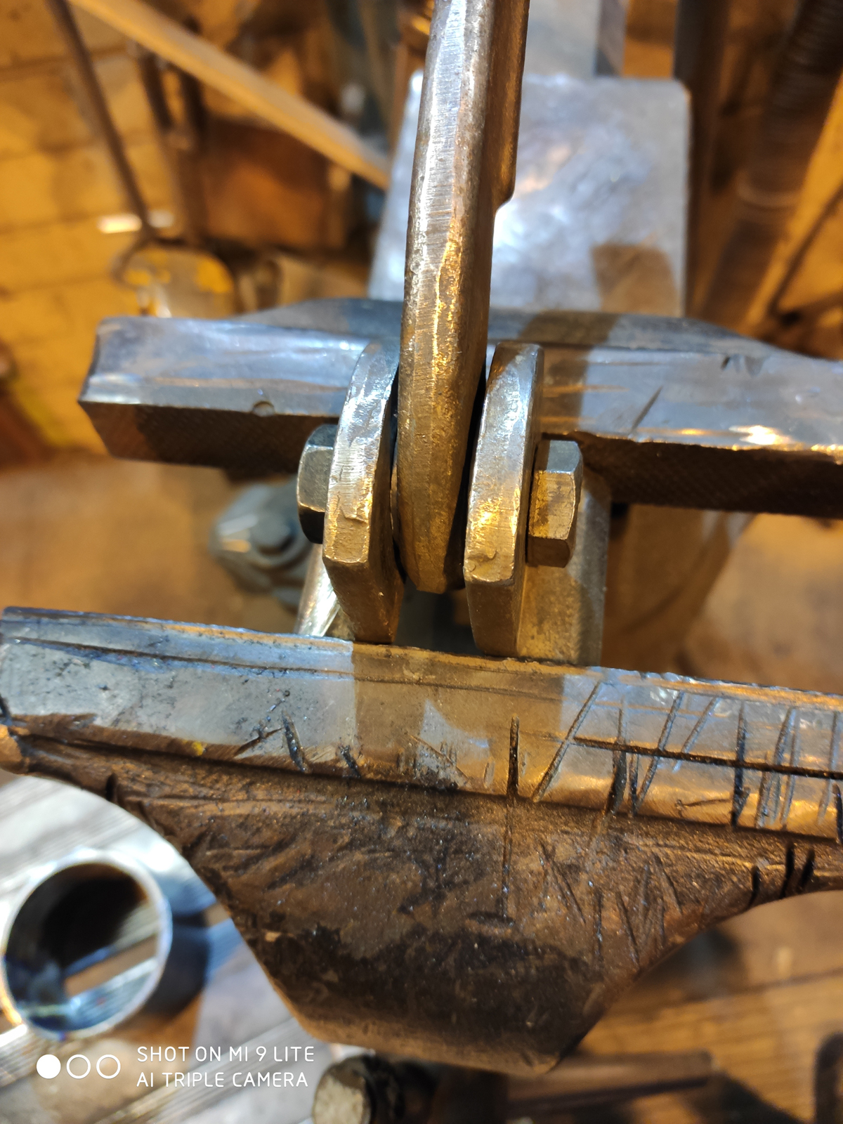

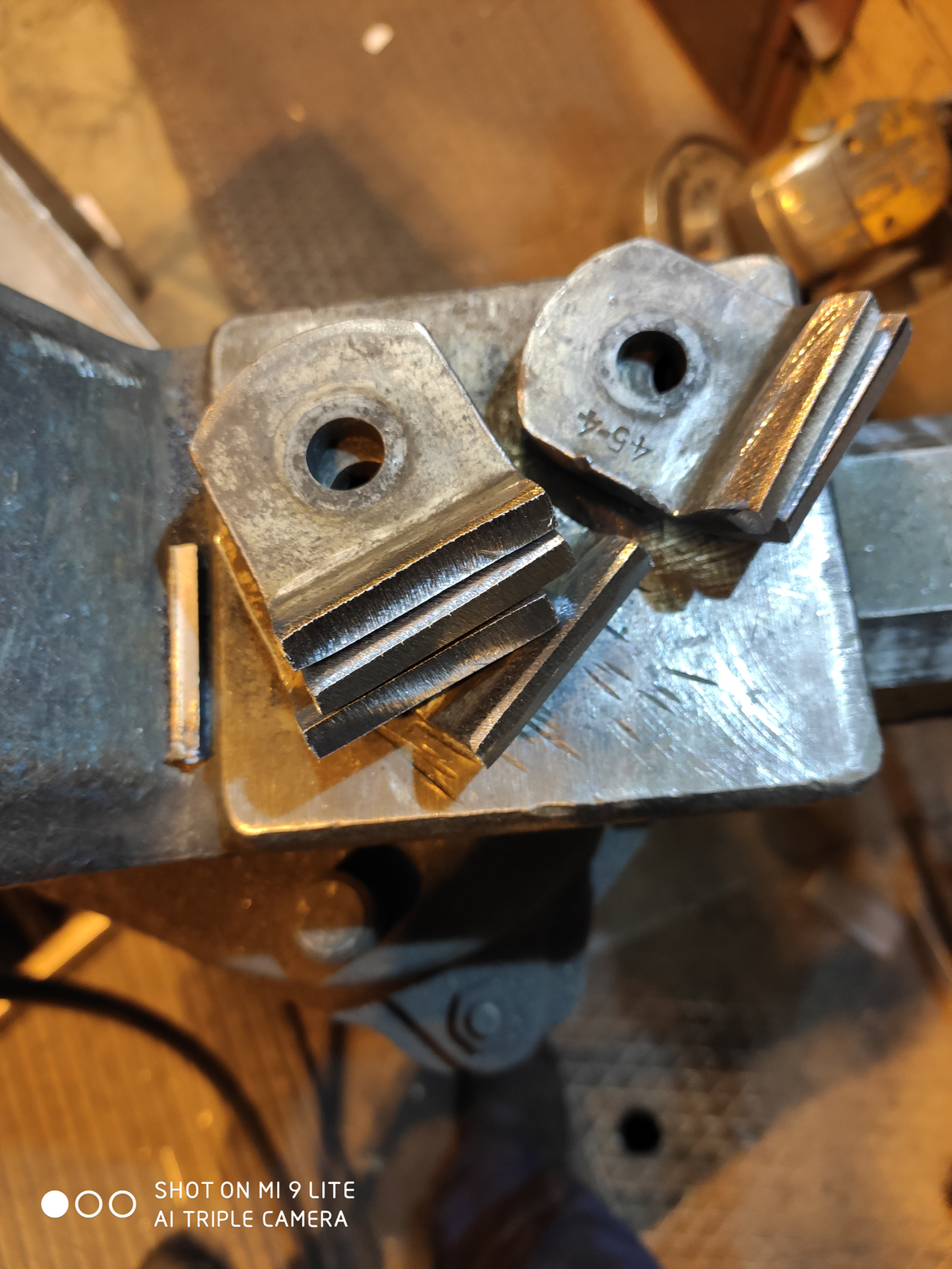

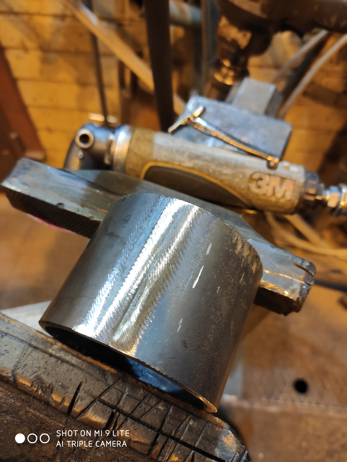

Used 5 ton jack and forged claws taken from old broken puller. ( broken threads )

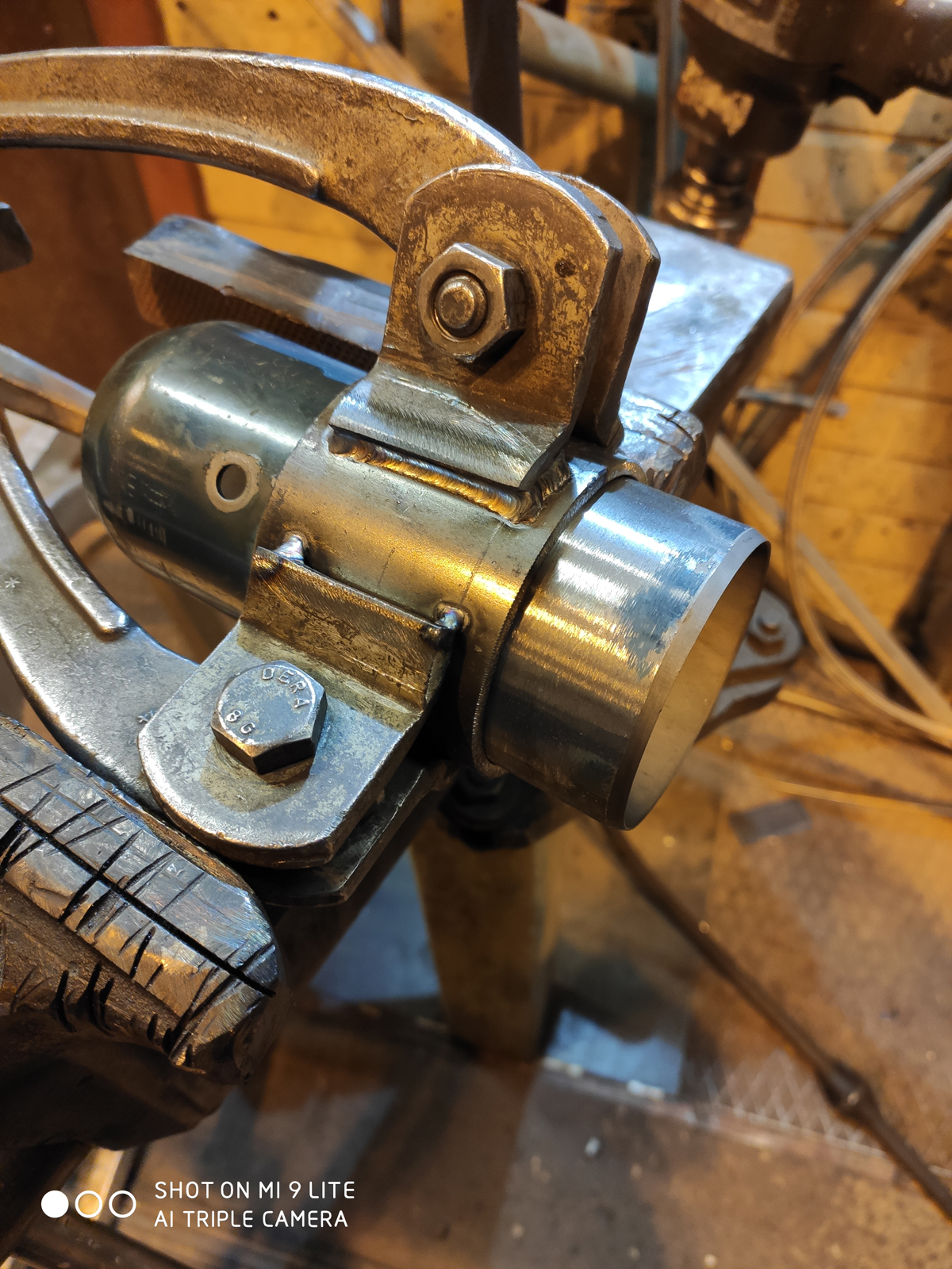

Because wall of the jacks oil chamfer is only 2mm thick.
Connecting claws directly to it, isn't very strong solution.
Therefore i made a support ring around it from 5mm thick pipe.

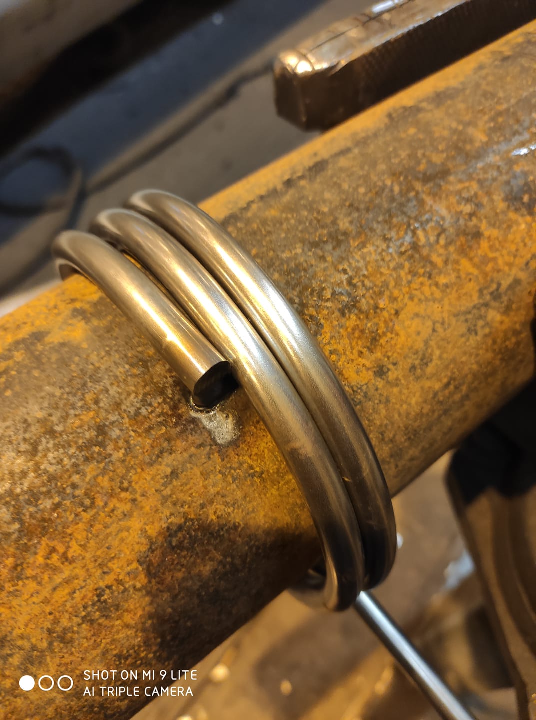

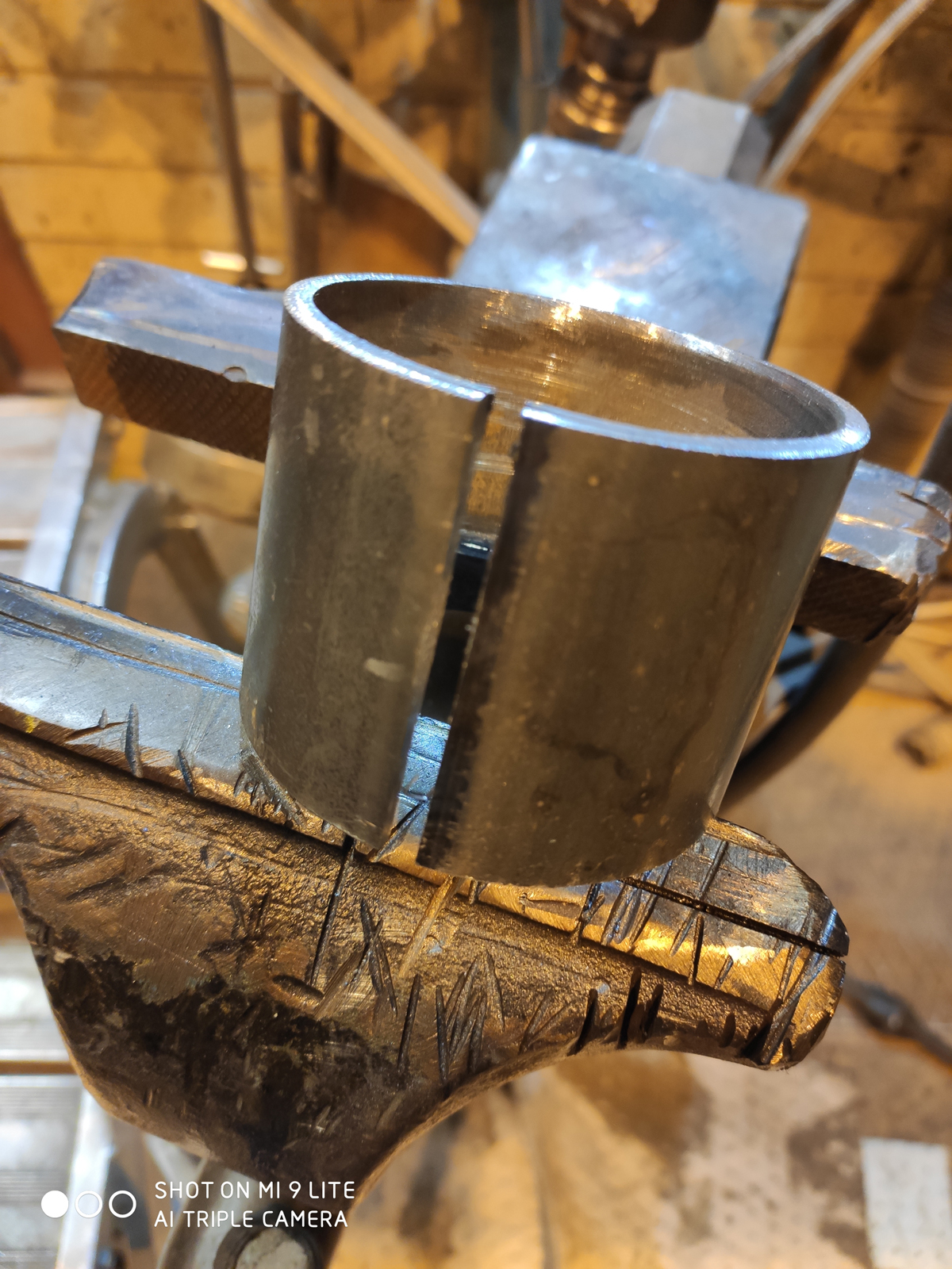

Claws we're connected to this stronger pipe.
I adjusted the diameter of the pipe with suitable thickness steel plate. To get firm connection between pipes.
Attachment 36643Attachment 36644Attachment 36645
Attachment 36646Attachment 36647Attachment 36648Attachment 36649
Attachment 36650Attachment 36651Attachment 36652Attachment 36653

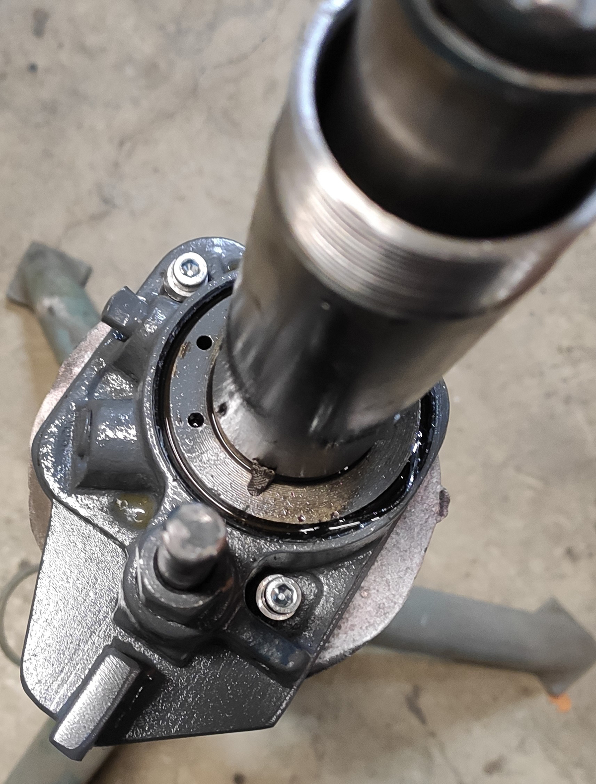

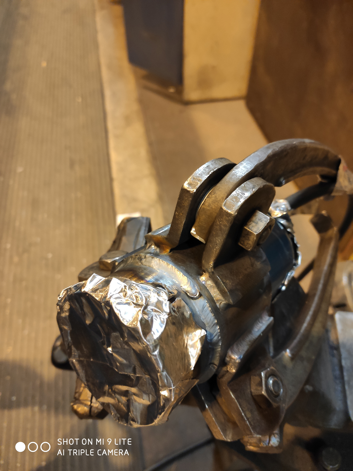

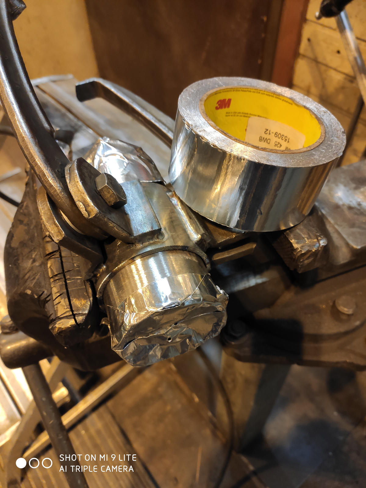

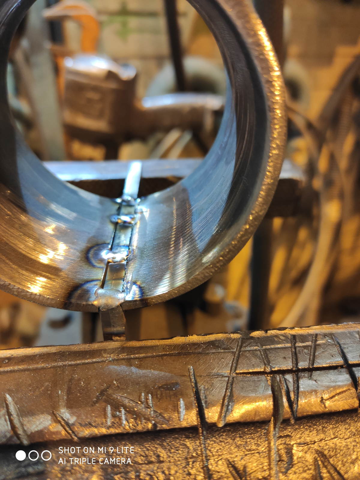

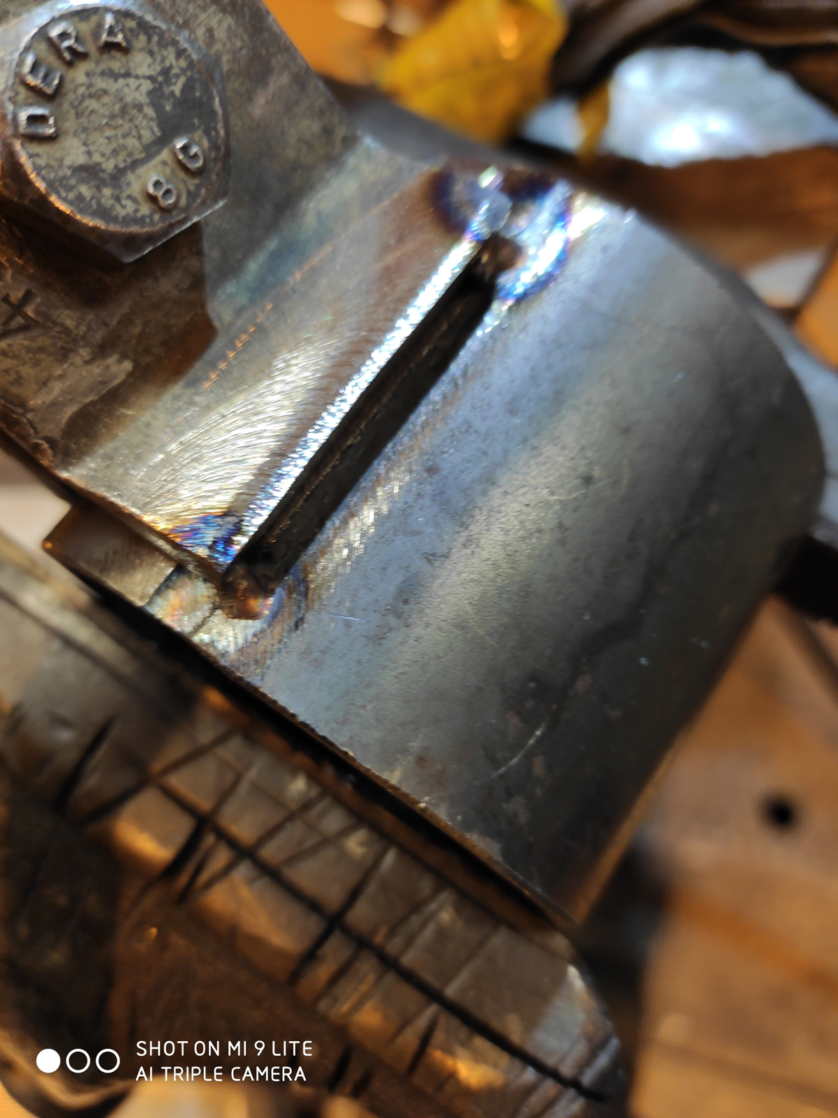

Before welding the claw holders, i placed oil chamfer inside the support ring.
Welding shrinks metals when welds cool down.
After welding connection was very tight. ( Too tight to get oil chamfer inside it afterwards )
Attachment 36654

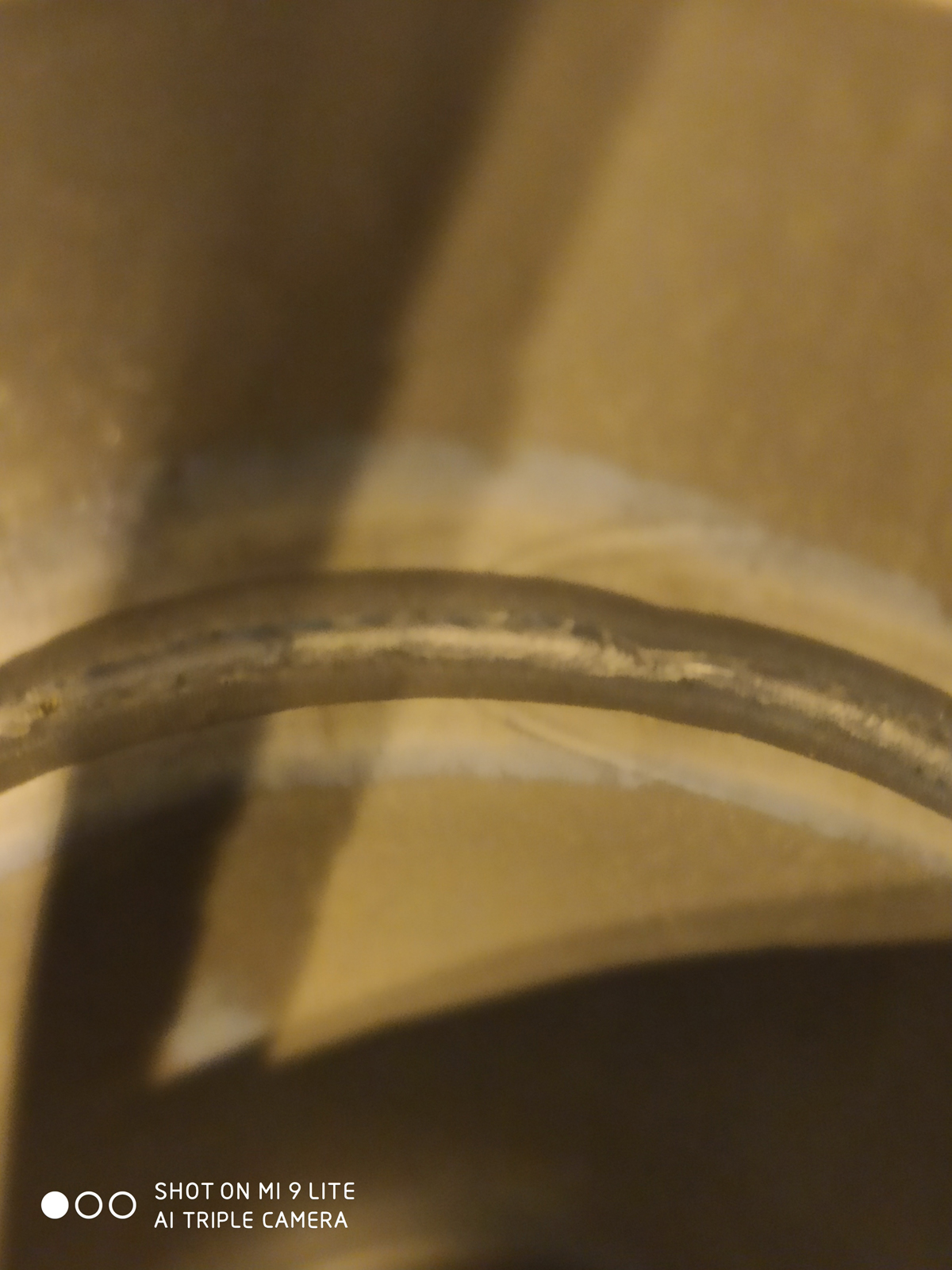

Then i welded oil chamfer and support ring together, from The bottom edge. ( this sequence gives minimal distortion )
Before welding, i filled oil chamfer with shield gas, to get pure, weld trough connection.
Attachment 36655Attachment 36656Attachment 36657

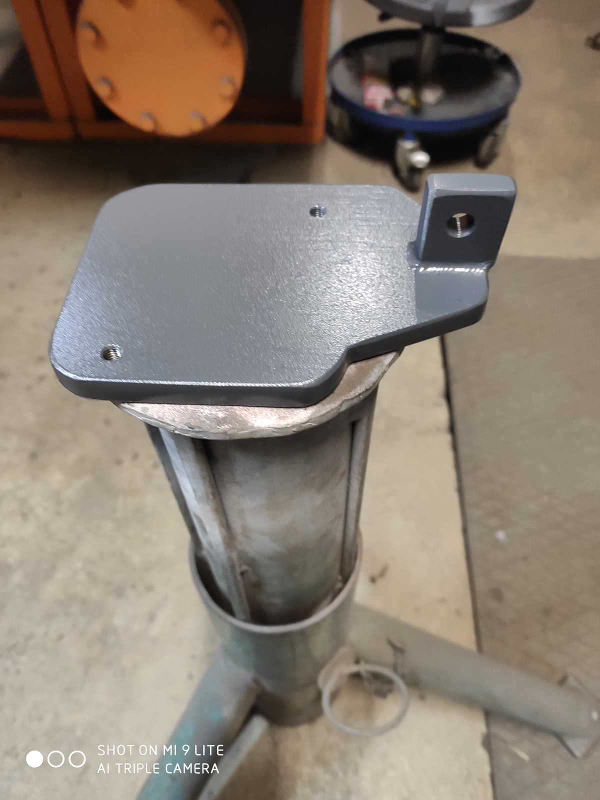

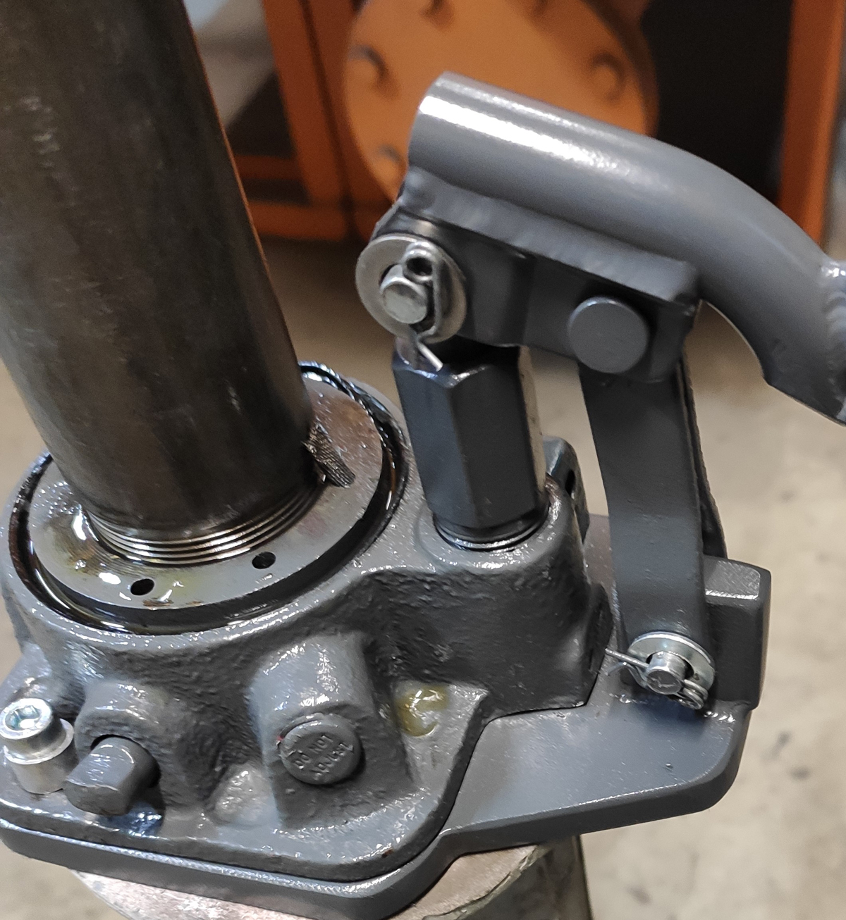

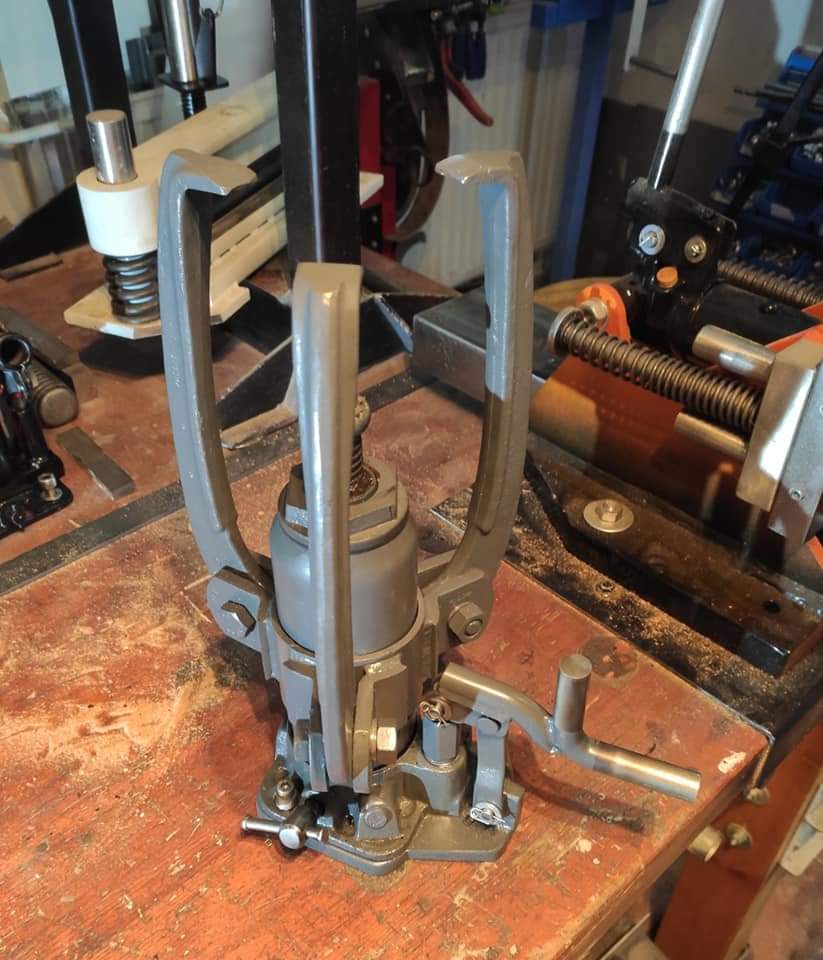

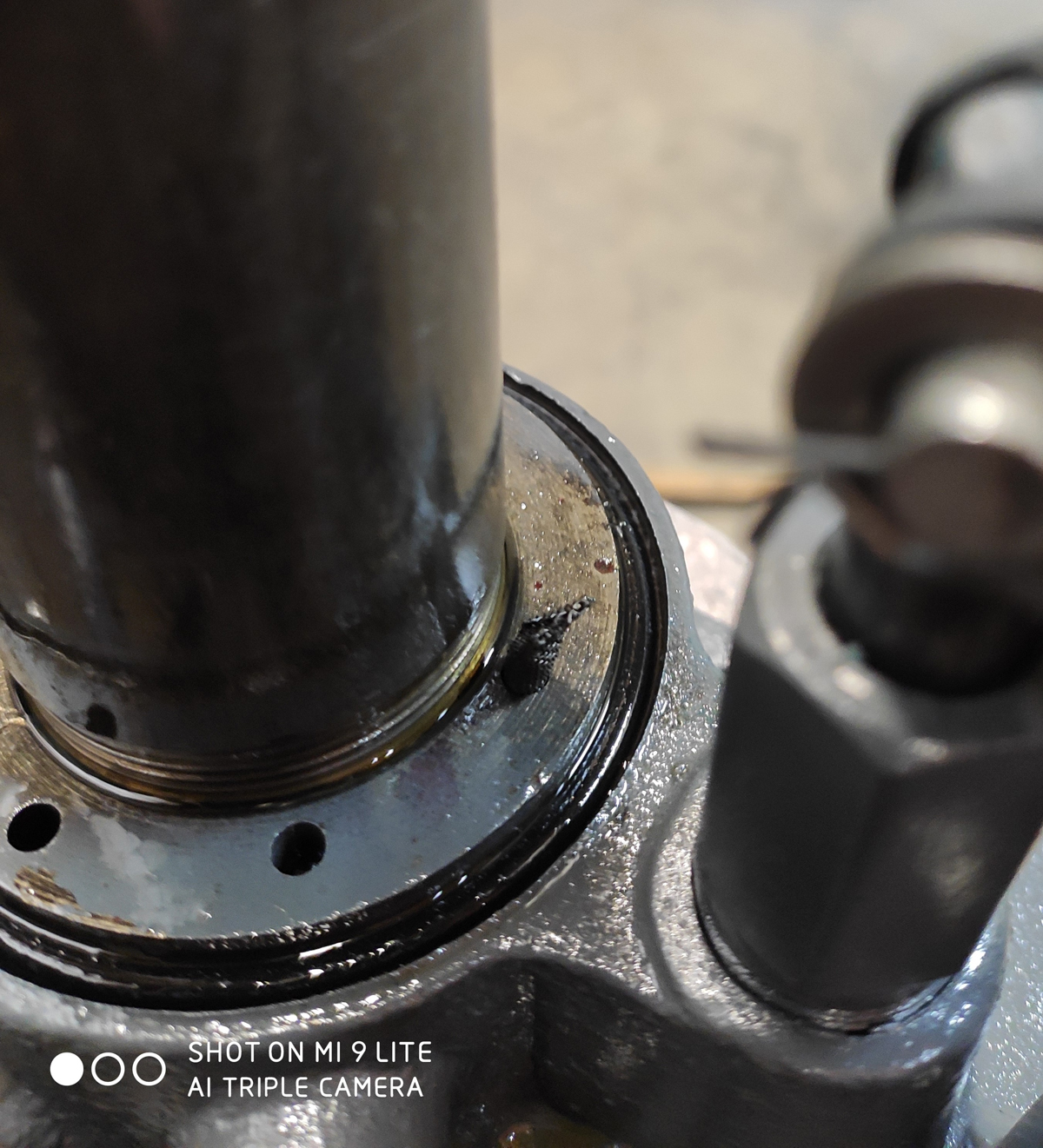

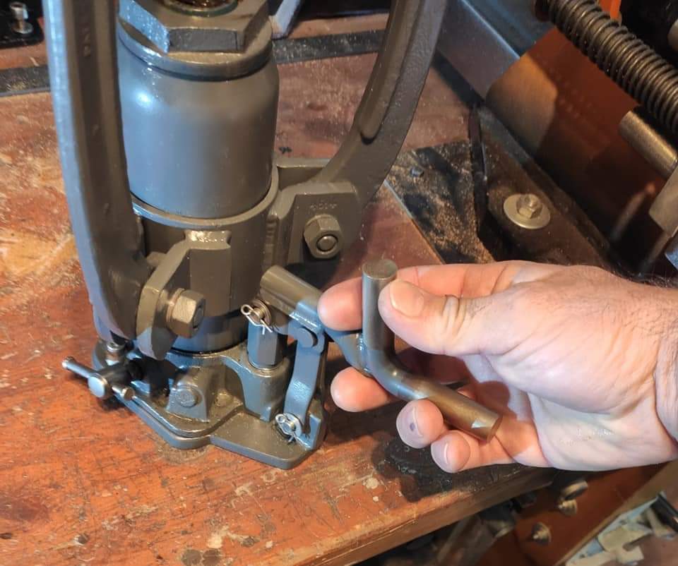

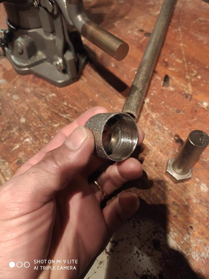

Tilted the pump mechanism 90 degrees, and shaped handle connection for better usability.
Attachment 36658Attachment 36659Attachment 36660Attachment 36661Attachment 36662

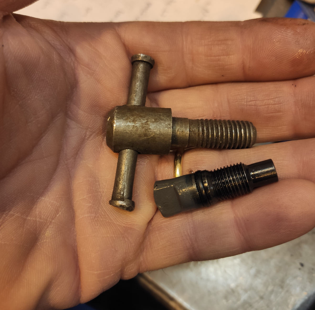

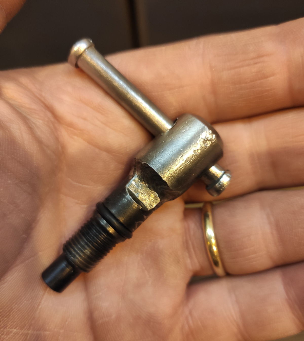

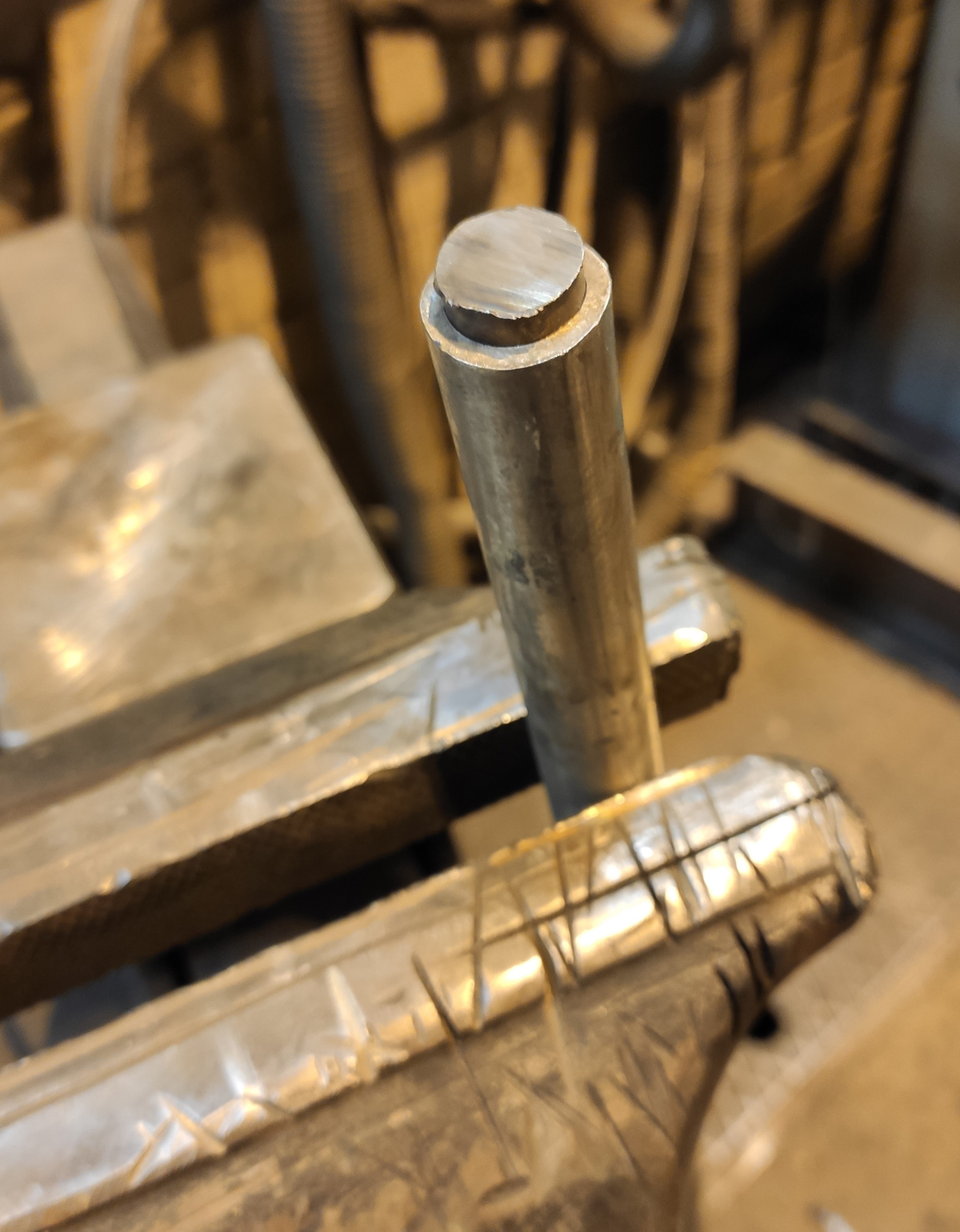

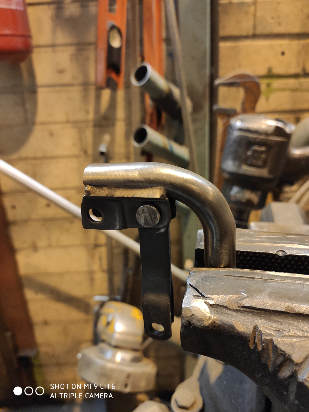

Handle for the valve, and for the pump.
Attachment 36663Attachment 36664Attachment 36665Attachment 36666

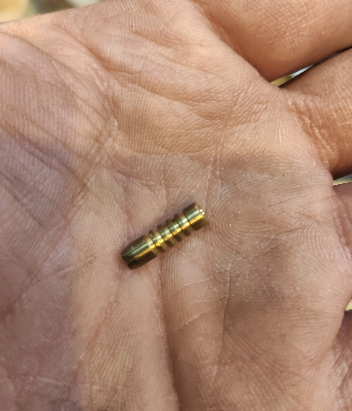

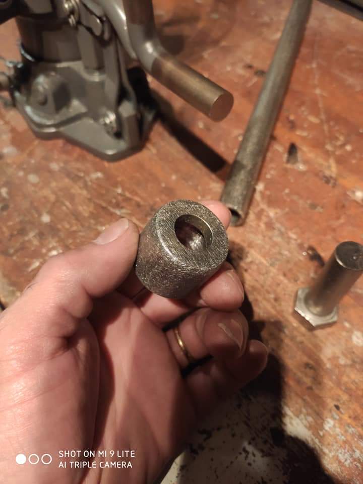

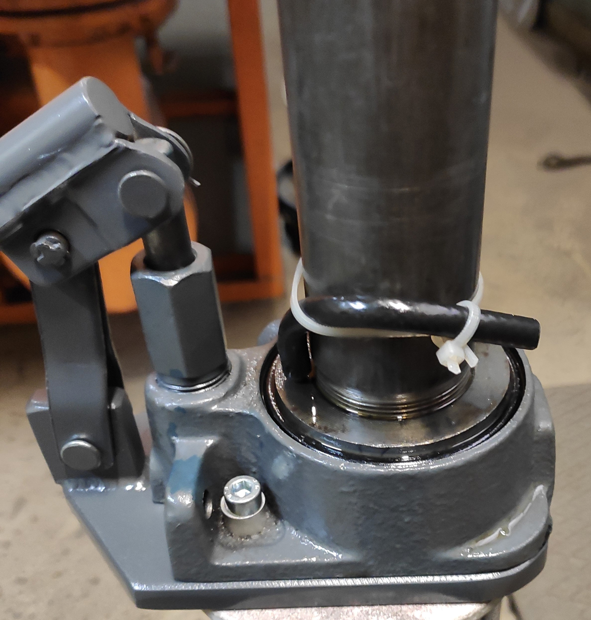

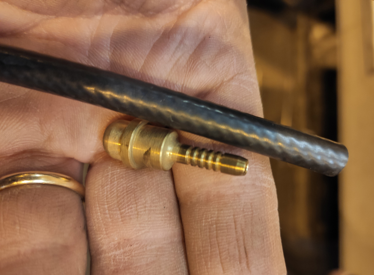

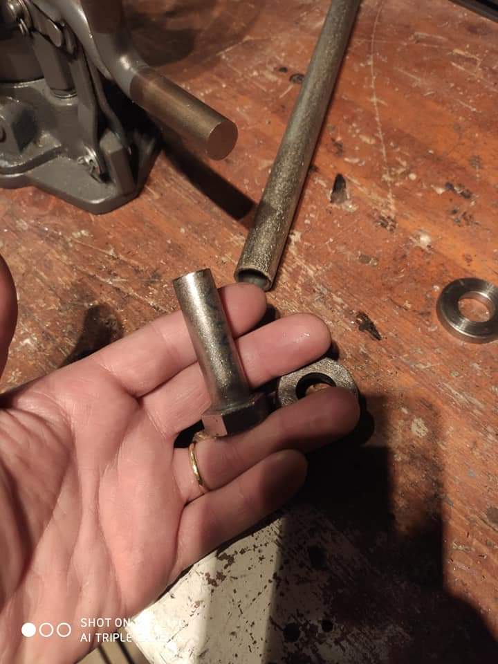

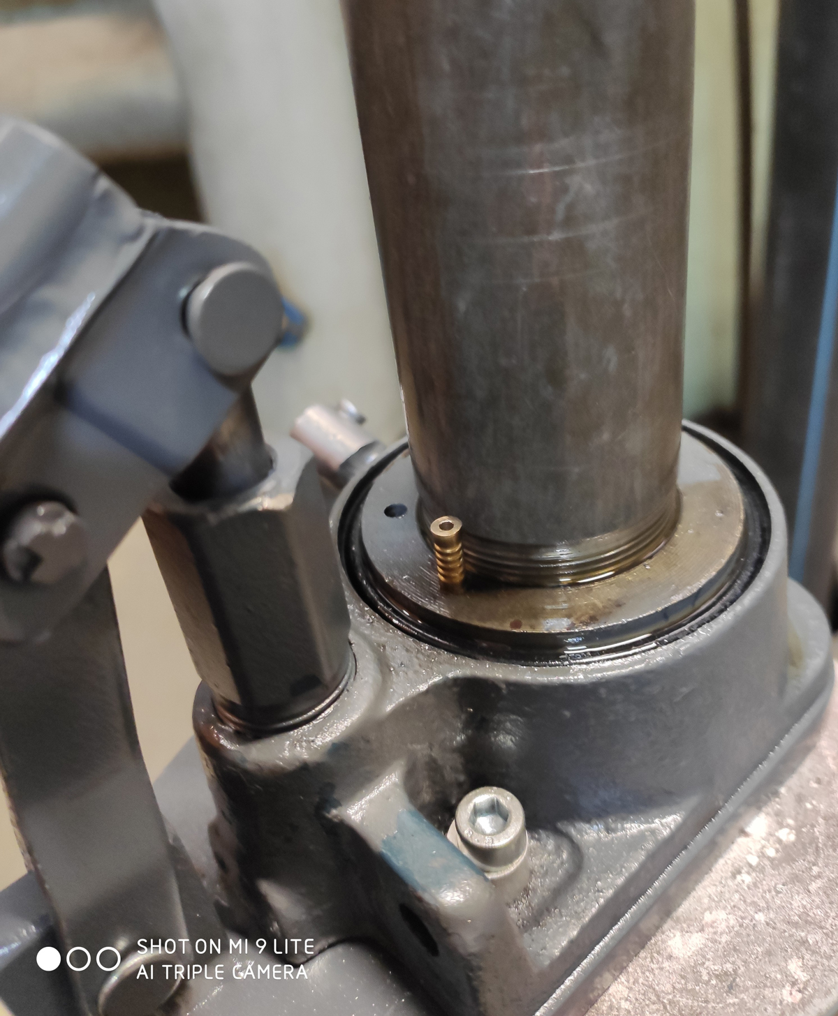

Brass pipe fitting and a piece tube, are used to get jack to work sideways too. ( or upside down, if wanted )
Fitting is hammered to its place. Brass is softer than cast steel, so it doesn't crack it easily. But gives tight connection
Attachment 36667Attachment 36668Attachment 36669Attachment 36670Attachment 36671

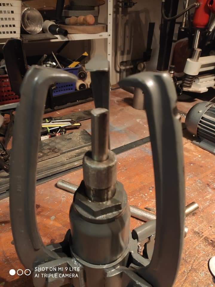

Finished
https://youtu.be/FgjRuMA4PFE
Because you can't actually know.
How tight those bearings we're.
I also decided to demonstrate the use, with a task that you can know that it requires some force.
