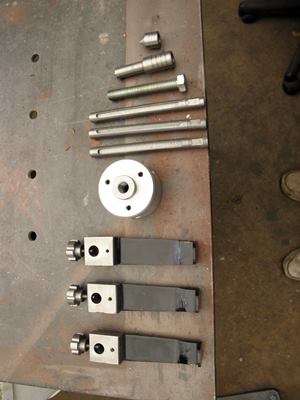

    DIY Machine Pulley Puller

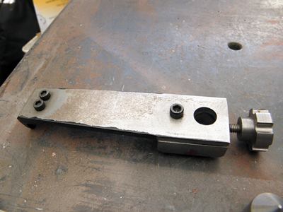

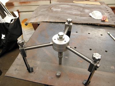

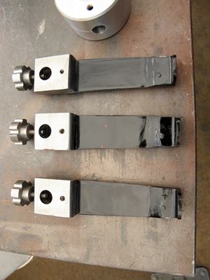

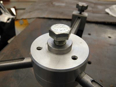

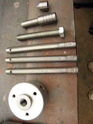

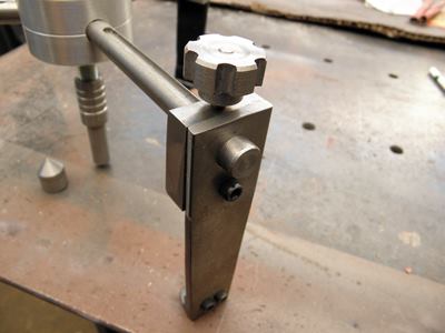

    Adjustable DIY Machine Pulley Puller
    This is made of Cold Rolled steel,aluminum on the lathe and mill.
    DIY Machine Pulley Puller-031.jpgDIY Machine Pulley Puller-032.jpgDIY Machine Pulley Puller-033.jpgDIY Machine Pulley Puller-034.jpgDIY Machine Pulley Puller-036.jpgDIY Machine Pulley Puller-037.jpgDIY Machine Pulley Puller-038.jpg

    hi this looks great! is there any drawings i can use? Thanks
  9. #8
    Jul 2014
    San DIEGO, California
    1,097
    496
    Captainleeward's Tools
    No drawings but I can give some basic measurements.
    center aluminum with metal insert is 2 inches dia. the center bolt is 1/2 inchs 3" long.
    the three round connecting rods are 1/2 inch x 6 inches with grove of 1/4 inch wide and 1/4 inch deep.
    the claws are made from 3/8 inch x 1" steel tapped and screwed to the 1/8th inch extension that have the claw, the rest you can get from the photos. ENJOY>......:O)
