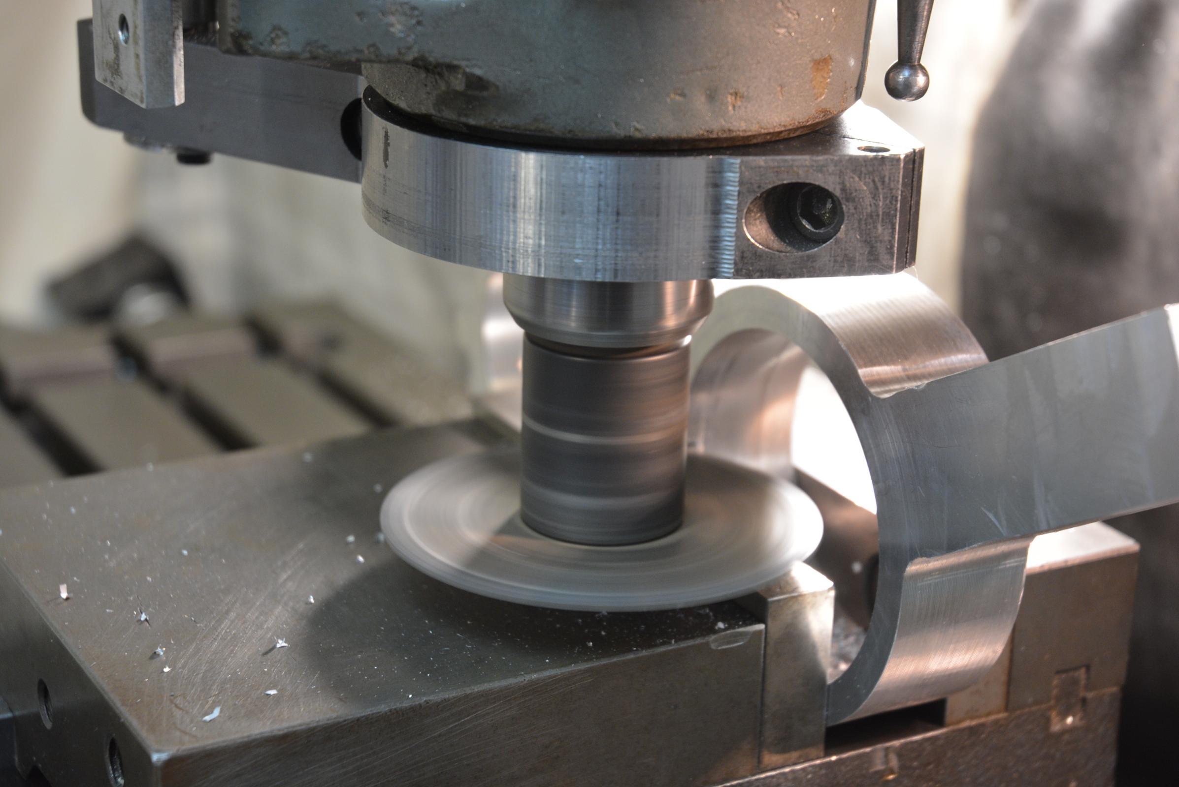

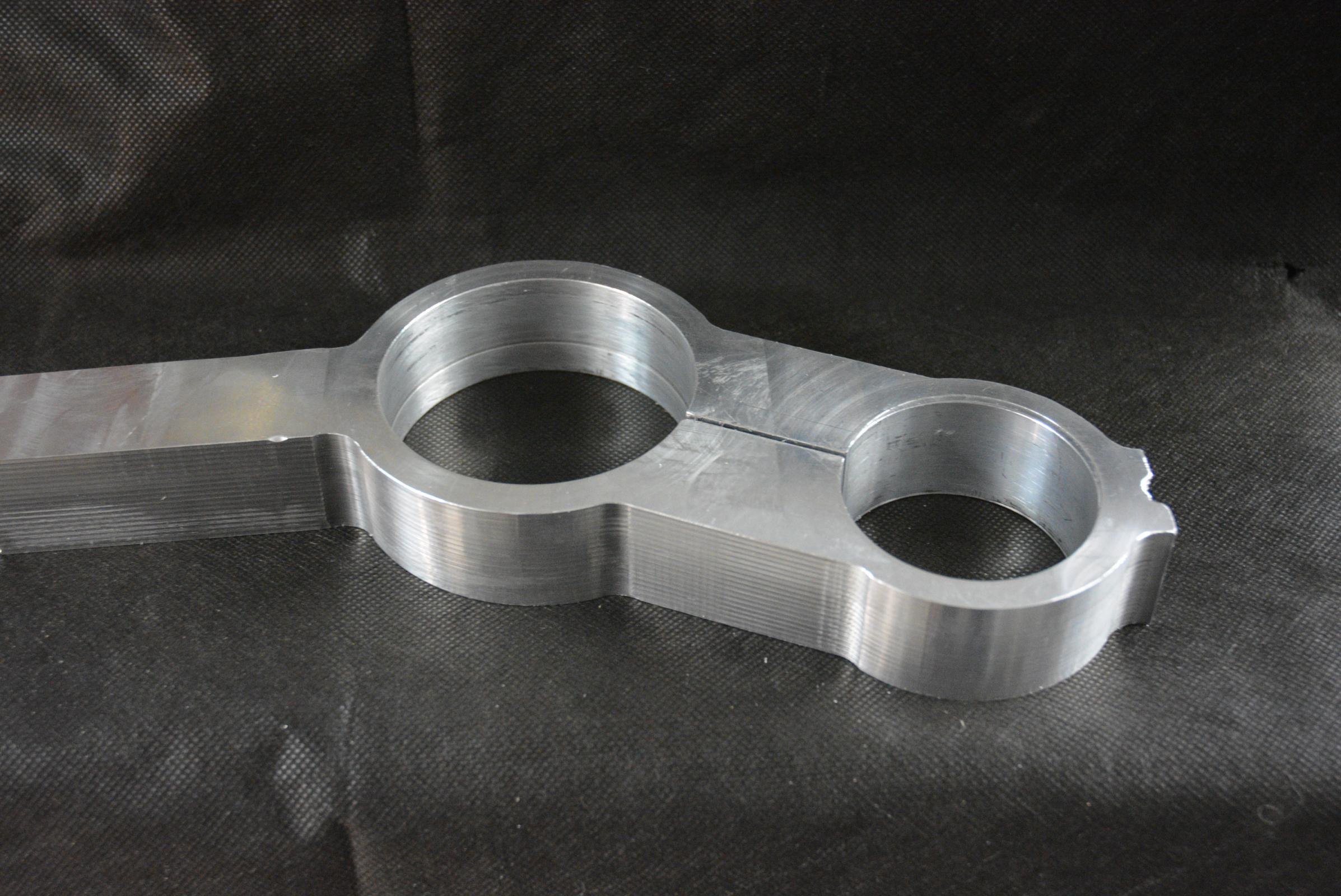

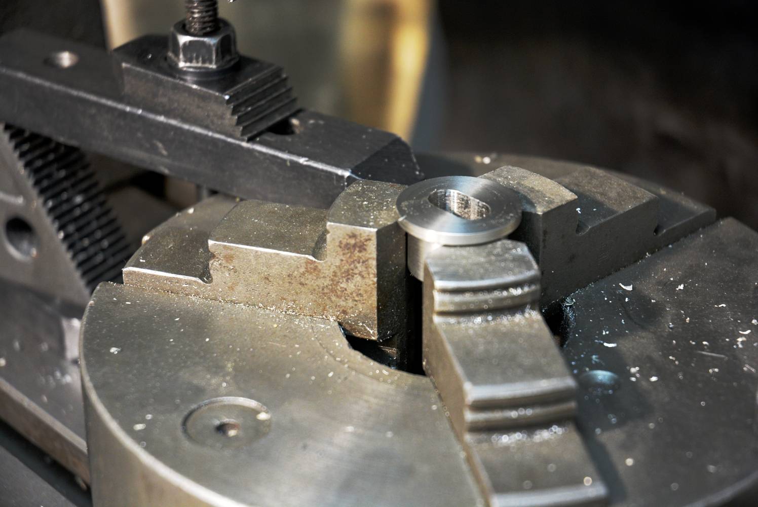

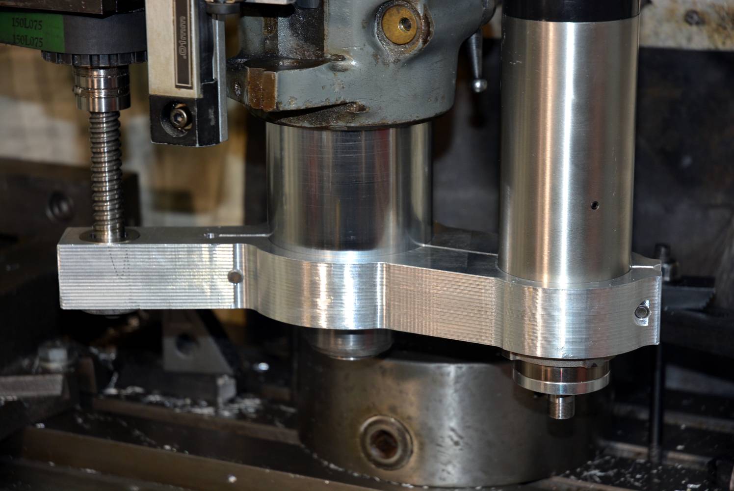

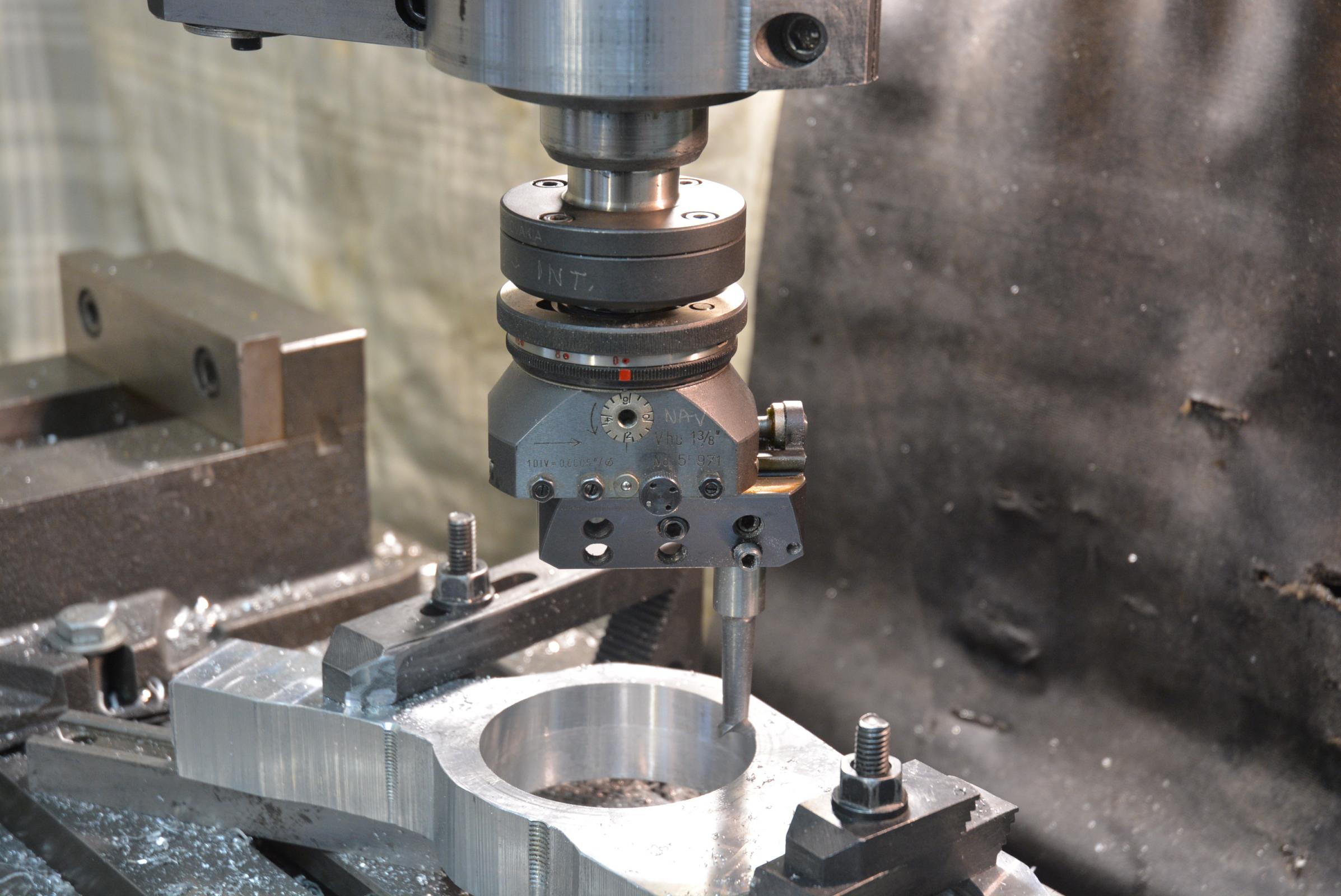

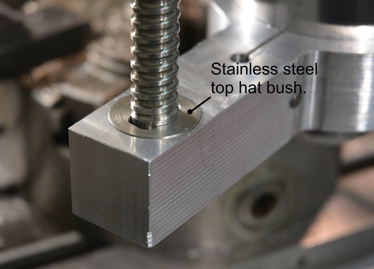

    Making clamps for a mill or drill quill or a high speed spindle etc. would seem to be a subject hardly worth discussing, but I have often come across designs which are sadly lacking in some area. I have made a 17 minute video which looks at the good and bad aspects of design and manufacture.
    Here are a few photos to wet your appetite:
    The Do's and don't of making circular clamps.-dsc_1988.jpg The Do's and don't of making circular clamps.-dsc_1967.jpg The Do's and don't of making circular clamps.-dsc_1986.jpg Click images for full size.
    The Do's and don't of making circular clamps.-dsc_1975.jpg The Do's and don't of making circular clamps.-dsc_1972.jpg The Do's and don't of making circular clamps.-dsc_1991.jpg

    Tony, I made a fixture for a Dremel for my drill-mill quill from plywood also with the Dremel placed eccentric wrt the quill. But the angular play of the quill made accurate work impossible. In your set-up the CNC ball screw fixes that problem. I am in progress now to make a centric fixture for the Dremel.

    Cylindrical clamps with bad form are rather common. That shouldn't be the case, maybe accountants are in charge making band blades available. While extreme slitting isn't guaranteed bad, it can weaken an otherwise secure fit.
    Personally I bore size-for-size too, but the clamp is prepared differently. Often this entails drill/ tap of bolts, rough bore, separating the halves, milling the joint flat, reassembly with shim occupying what will be the finished split, then completing the bores. Yes, bit more labor intensive, but I rarely can tie up a machine tool for g-jobs. This helps breaking any process into shorter steps.
    Tony's video features just about if not all considerations of successful cylinder clamp mechanics. Aspect being offset, would make [my] milled joint tenuous without CNC or careful trigonometry.
