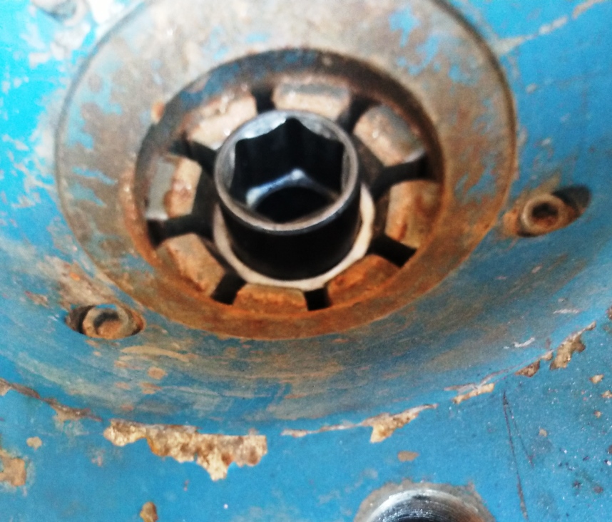

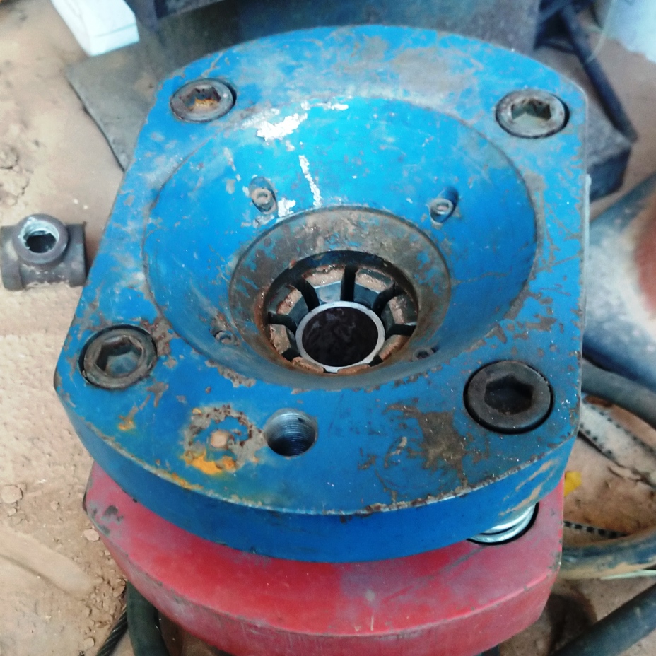

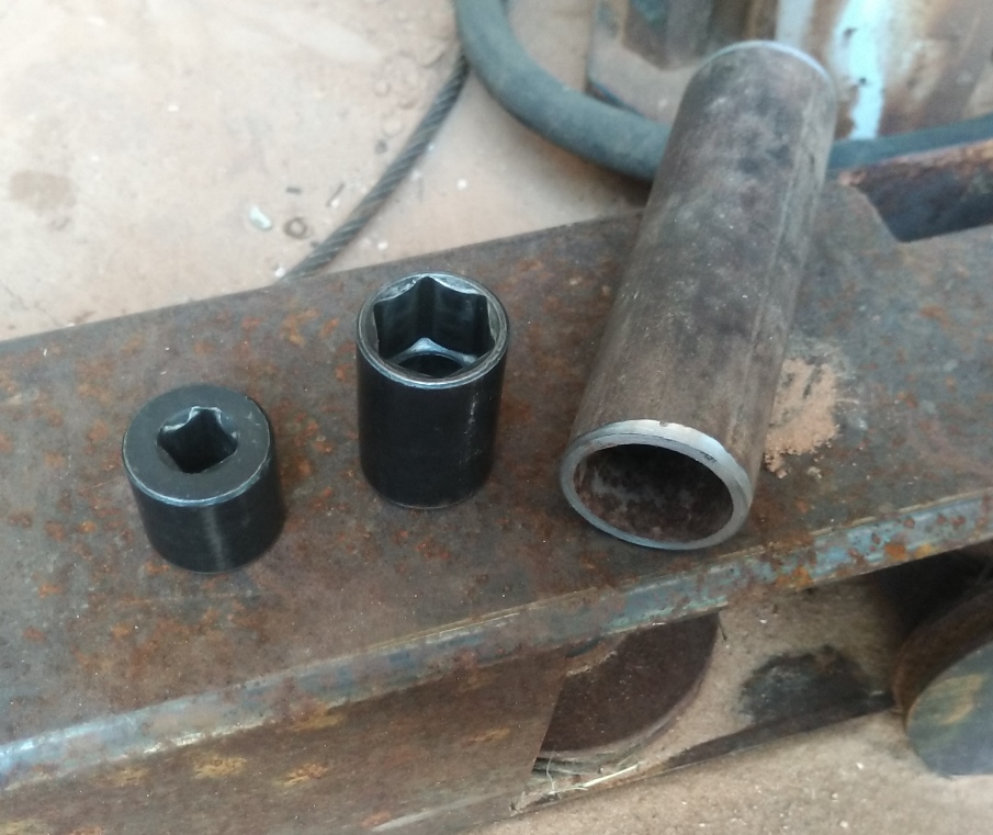

The U bolts securing a headache rack to the frame of a semi truck are almost always a lot longer than needed with several inches of thread My deepest deep well impact socket was about 3 inches too short, so I made a special extended depth socket, by cutting one in half then welding a tube between the 2 pieces
Attachment 43844

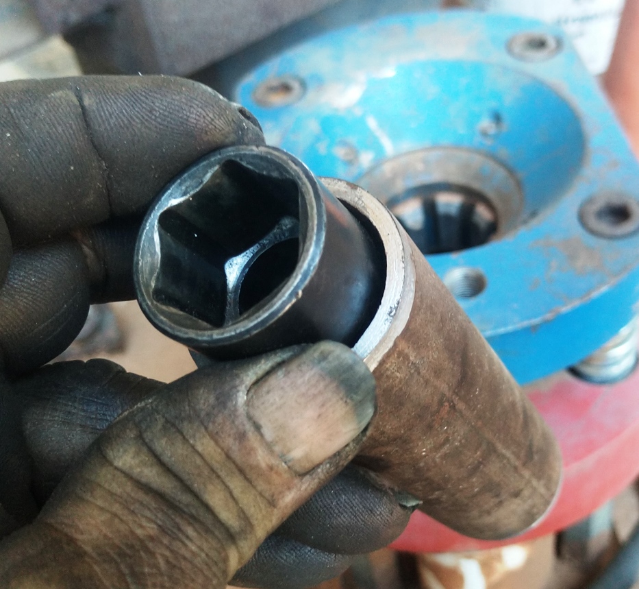

The ID of the tube was much larger than the OD of the socket

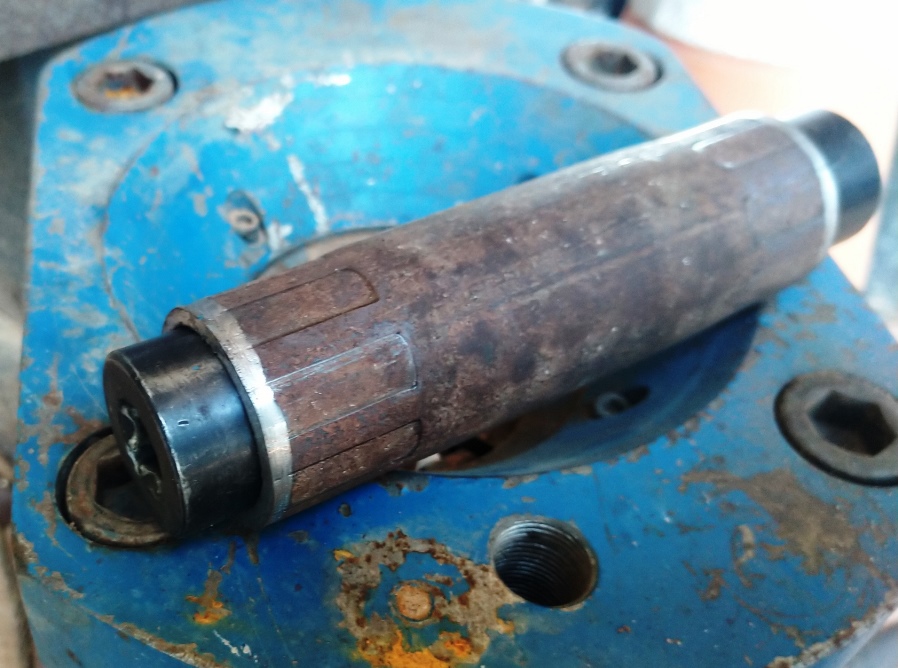

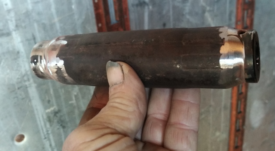

To solve this I used my hose press to crimp the pieces together
Attachment 43846
Attachment 43847
Attachment 43848
Attachment 43849
