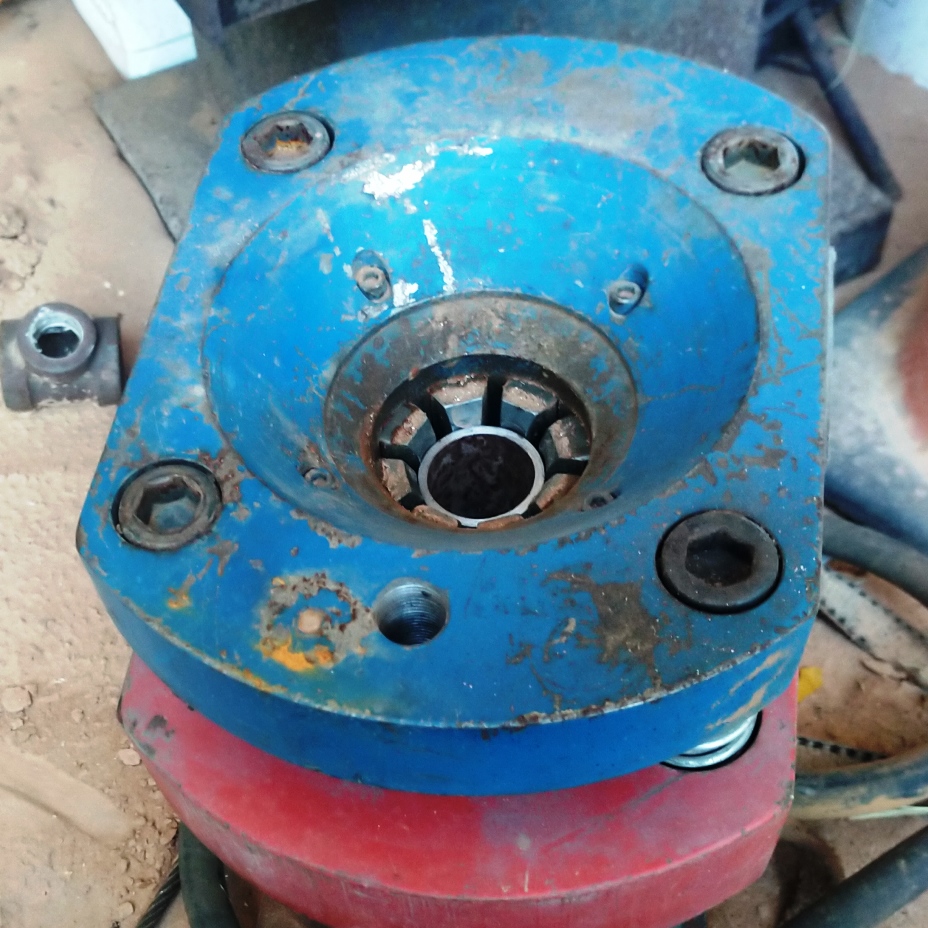

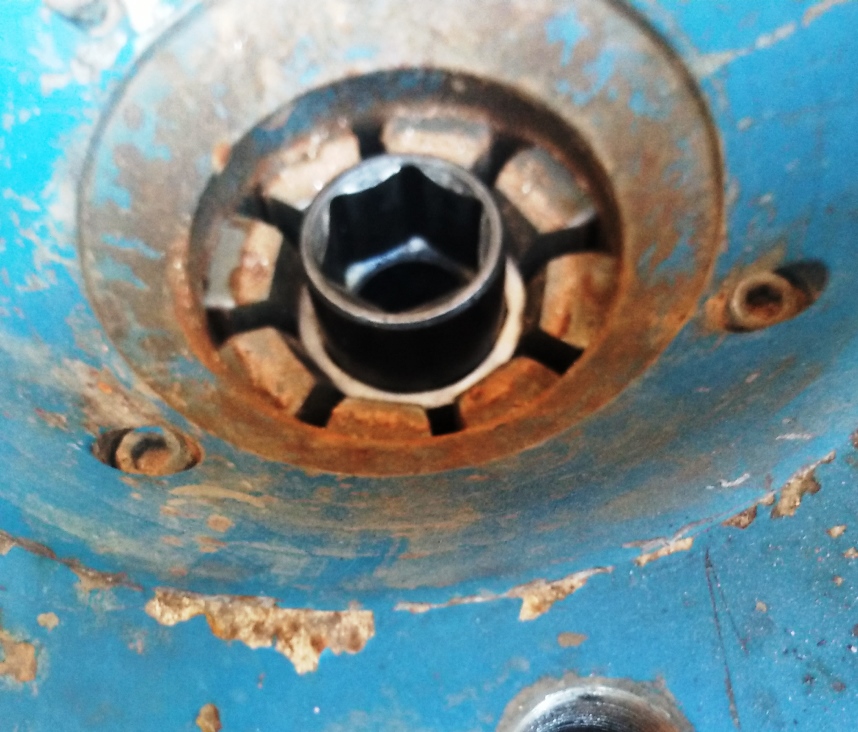

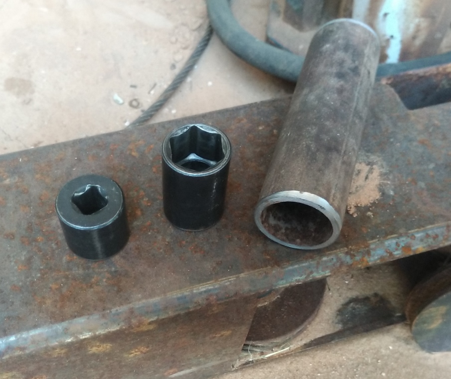

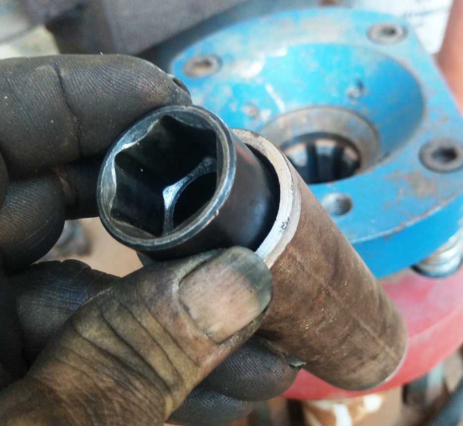

    The U bolts securing a headache rack to the frame of a semi truck are almost always a lot longer than needed with several inches of thread My deepest deep well impact socket was about 3 inches too short, so I made a special extended depth socket, by cutting one in half then welding a tube between the 2 pieces
    Double extended 15/16 socket-img_20220926_143010soc.jpg
    The ID of the tube was much larger than the OD of the socket
    Double extended 15/16 socket-img_20220926_143041soc.jpg

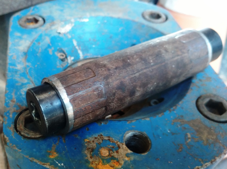

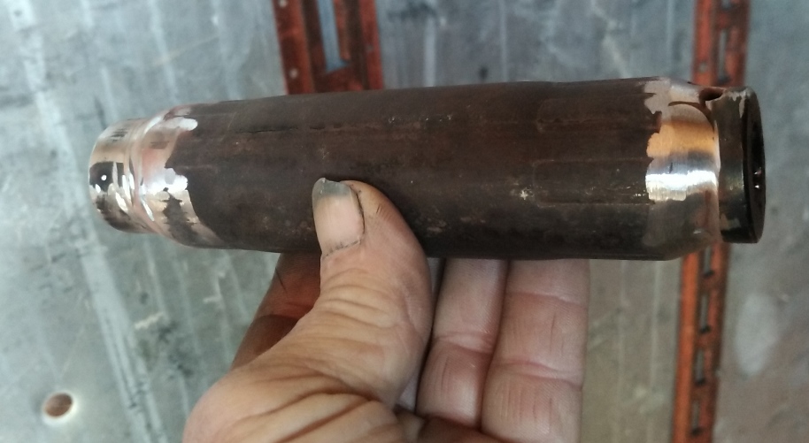

    To solve this I used my hose press to crimp the pieces together
    Double extended 15/16 socket-img_20220926_143132soc.jpg
    Double extended 15/16 socket-img_20220926_143215soc.jpg
    Double extended 15/16 socket-img_20220926_143408soc.jpg
    Double extended 15/16 socket-img_20220927_095255soc.jpg

    I have a set of pass through spline drive sockets but the largest stud which will pass through one of those is 1/2" probably why the set only goes up through 3/4"& 19 mm Its a nice set even has a 3" hollow extension, but nowhere near large enough for the ubolts
    I used to have a 15/16 Snap-on extended deep well impact socket that might have come close to being long enough but I haven\t seen it in probably 20 years.
    Reed mfg makes a really nice set of extended depth sockets but expect to pay over $300.00 for a set of 6 sockets ranging from 7/8 through 1 1/4"
    For that money I am perfectly happy to make my own as I need a different size

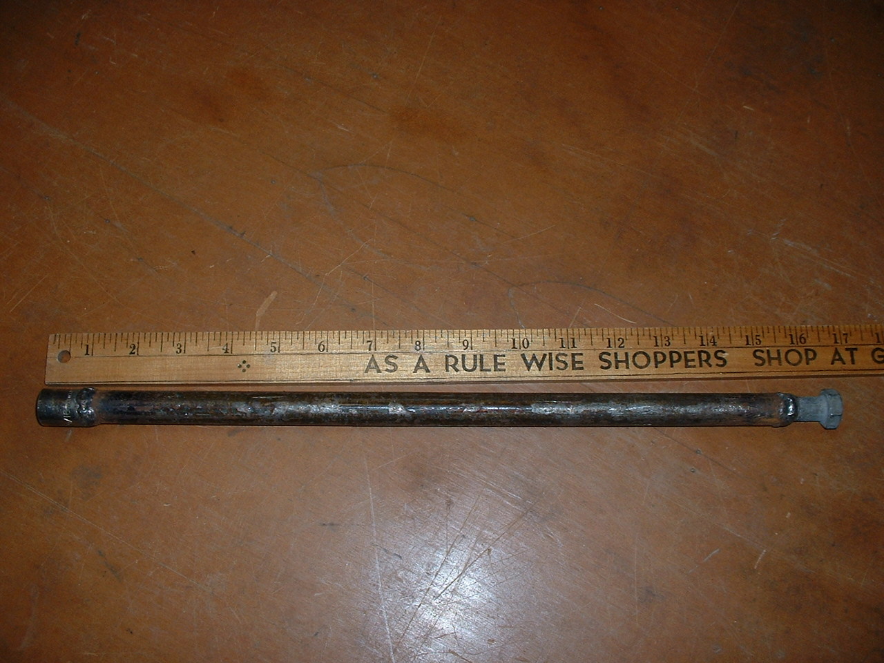

    Heres one I made a number of years ago, a 9/16" socket, a piece of 3/8" pipe and a 1/2" bolt.

    Quote Originally Posted by katy View Post
    looks like that would be handy for running nuts down on long threaded rods

    It was made for removing the nuts off of long bolts holding a gas tank on. It didn't need to be that long, I just used a piece of pipe that I had, left it long instead of cutting it. It could always be shortened if needed.
