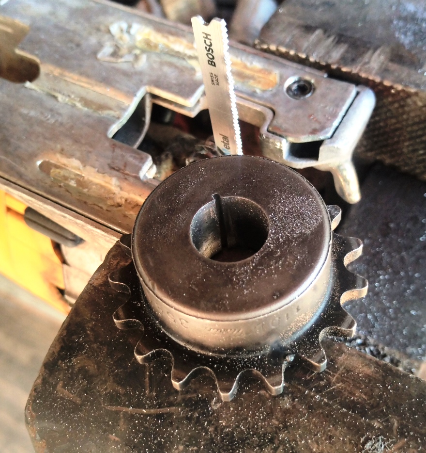

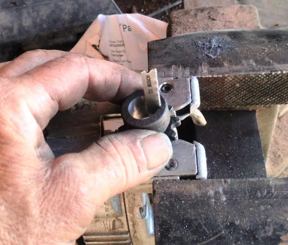

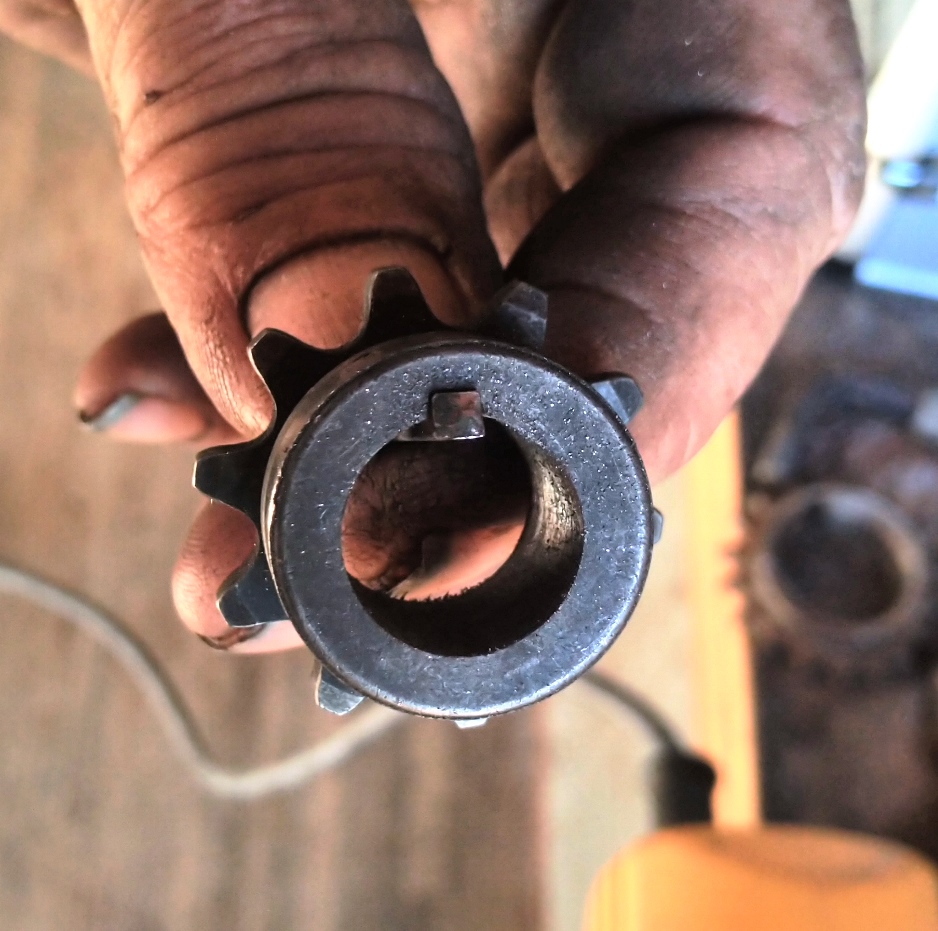

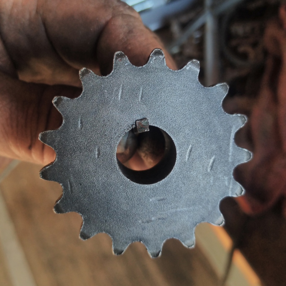

    Totally the wrong tool for the job, but I found myself not having anything small enough to cut a keyway with in a 5/8" bore other than to cut them entirely with a file. I clamped the foot of my saber saw in a vice then used it like a die filer to rough cut the small keyways in several sprockets then finished them off with a file it really saved a lot of arm motion.

    funny thing is I could have saved myself a lot of trouble had I just ordered the sprockets bored to size with the keyway already in them. it was a 4 week lead time and 4 times the price. a real no brainer there
