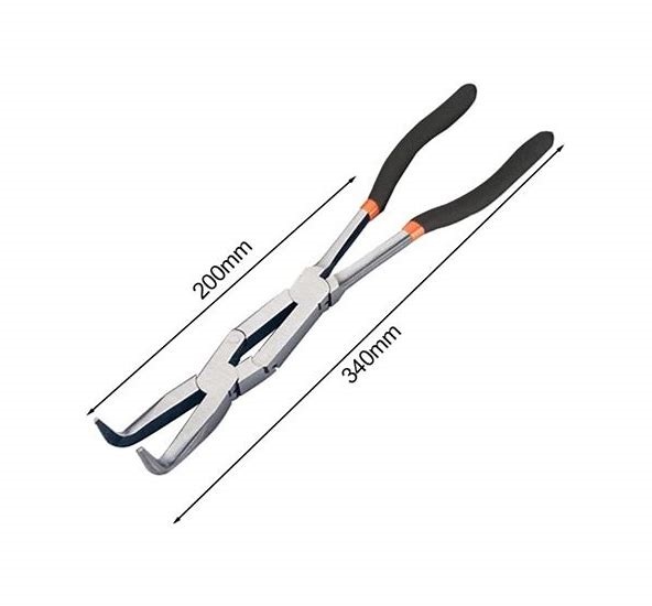

    Works, but if you can reach in there with a piece of all thread, you can probably reach in there with a pair of long needle nose pliers holding the nut as well. If it is too deep, then you would not have enough swing on the wrench to tighten it.

    I have a couple pair of these they work really well for work like this
