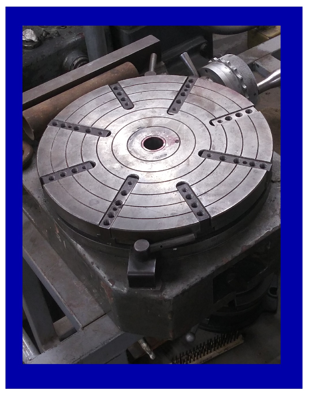

Speaking of elongated Tee-nuts....
Made these about 3 years ago, for a pump shop I help out periodically. Tomorrow, a flange is coming in needing modifications, these are almost certain to help out.
Some advantageous features, of the eight slots, four shorter than other four, have no reasonable explanation as to why. Realizing every part varies, and Tee slots are generalizations, these (in set of four) not only have differing tapped hole sizes, they aren't symmetrical to the length. If turned end for end it re-spaces the 'bolt circle' about 1.5 diameters, allowing more selection of best positions. In other words, they embody all positive attributes contained in this entire thread and various illustrious contributors.

When using these elongated multiple holed "T" nuts there is one other significant advantage particularly on a slotted flat rotary table they all for greatly expanding the useable diameter. If a dog point grub screw is inserted into the inner most hole and snugged down when you then use the hole that is outside of the table diameter or outside of a slot on your drill table as your clamping position, you are not nearly as likely to break out the end of the slot
