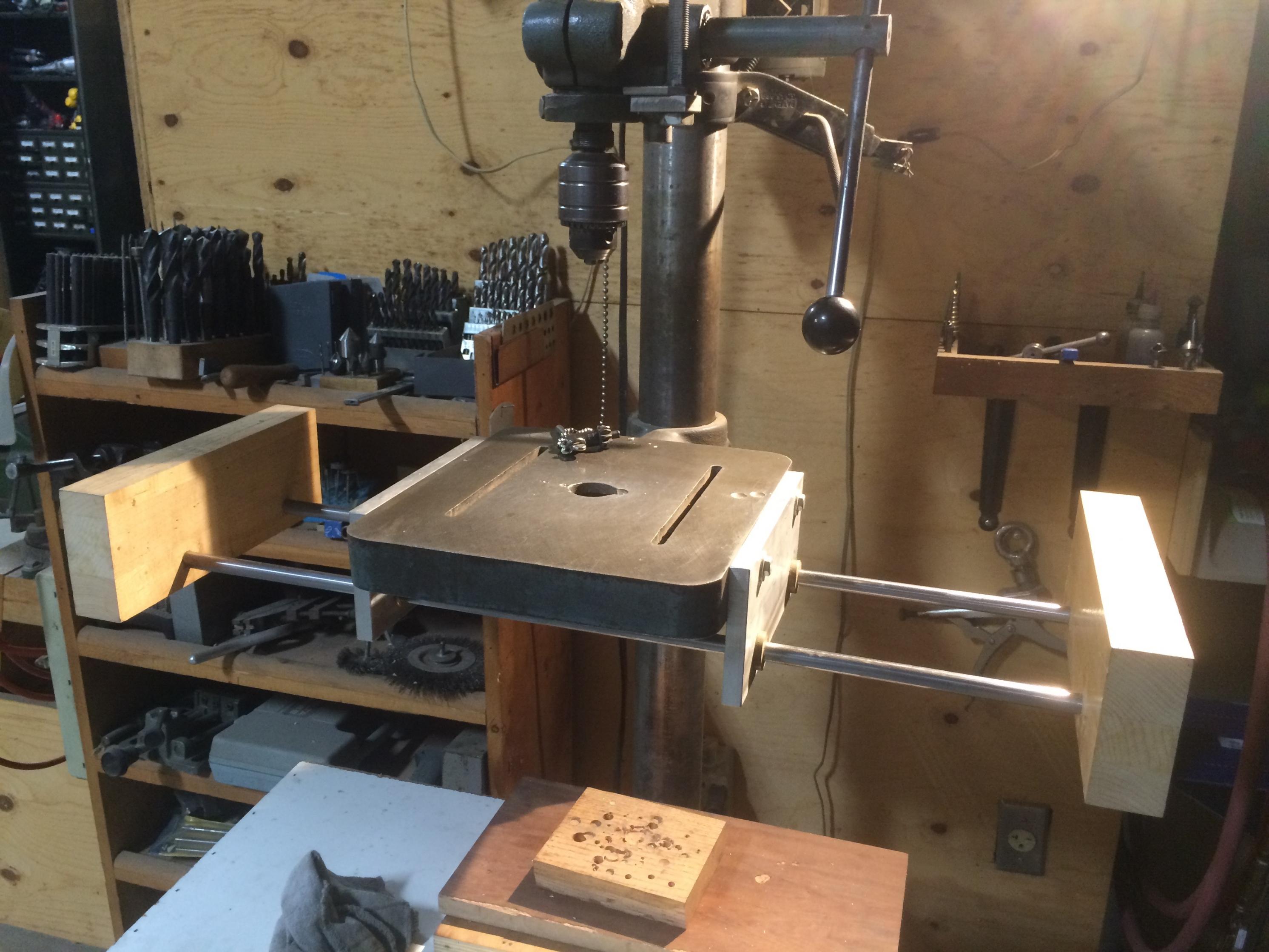

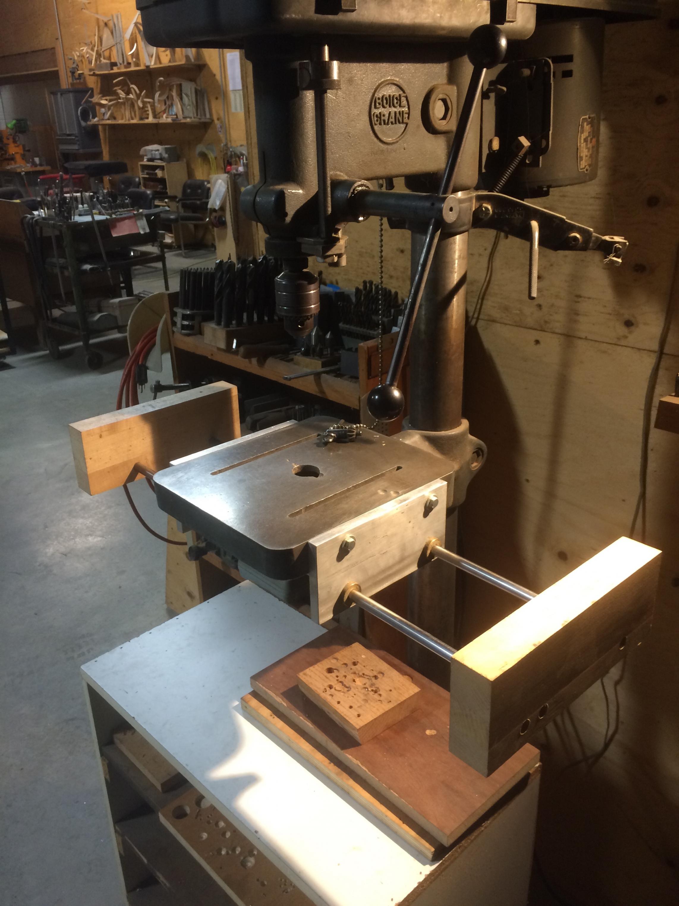

    After years of dragging a support roller over to the drill press, it finally dawned on me there was an easier way.
    Fortunately my drill press table had parallel sides so making the support only took a couple hours work with metal from the scrap bin. I have been using this for about 8 years and never had to remove it because it got in the way.
    Drill press work support-img_2200-1-.jpgDrill press work support-img_2202.jpg
