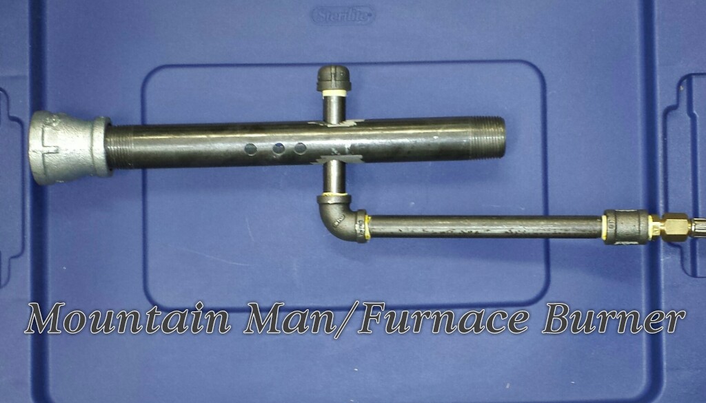

    Well I fired it up today and it worked pretty good. Below is the link to the video of it in action. I did have some yellow flame so I believe my air/fuel mixture is off. It's going to work just fine for my mini furnace. Let me know what you think,
    Dave

    Looks like it's working good. Thanks for the video.

    Looks like a good plan to me. I'll be anxious to see it in action and to hear your commentary once you have put it into use
