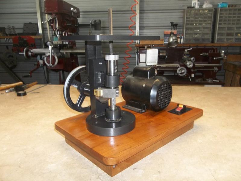

    Hi,
    I fully agree with the choice,
    What I especially love, in addition to the technical excellence of the machining and design, is the good looking aspect and the presentation.
    I (off course) appreciate the nice cherry wood plate, it gives the ensemble a final touch that makes it a real piece of museum.
    Thanks and congrats !

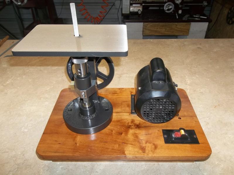

    That is an awesome tool! That would be a big help for me when I do folders. I think if I did more folders I'd have to invest in building one. Great presentation as well. Thanks for sharing.

    Wonderful build the only thing missing is the bell shaped cone under the file mount to keep the fine metal out of the bearings.
    Very nice set up.
