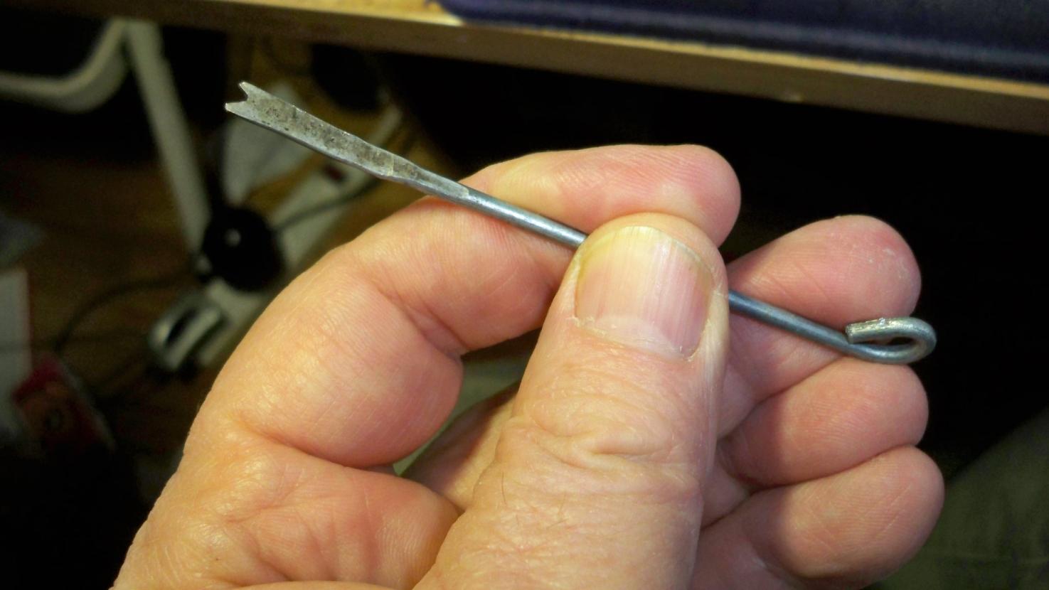

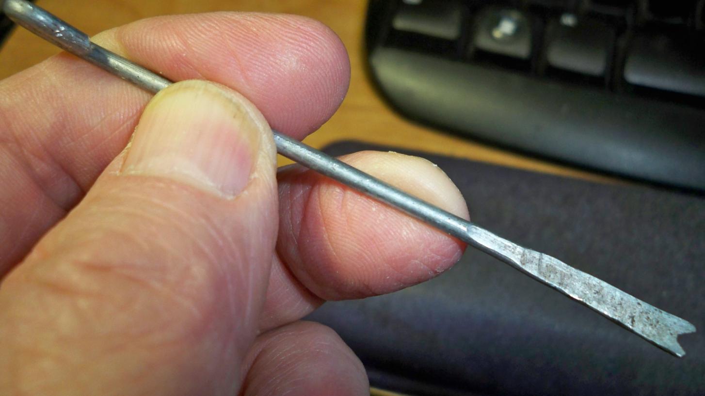

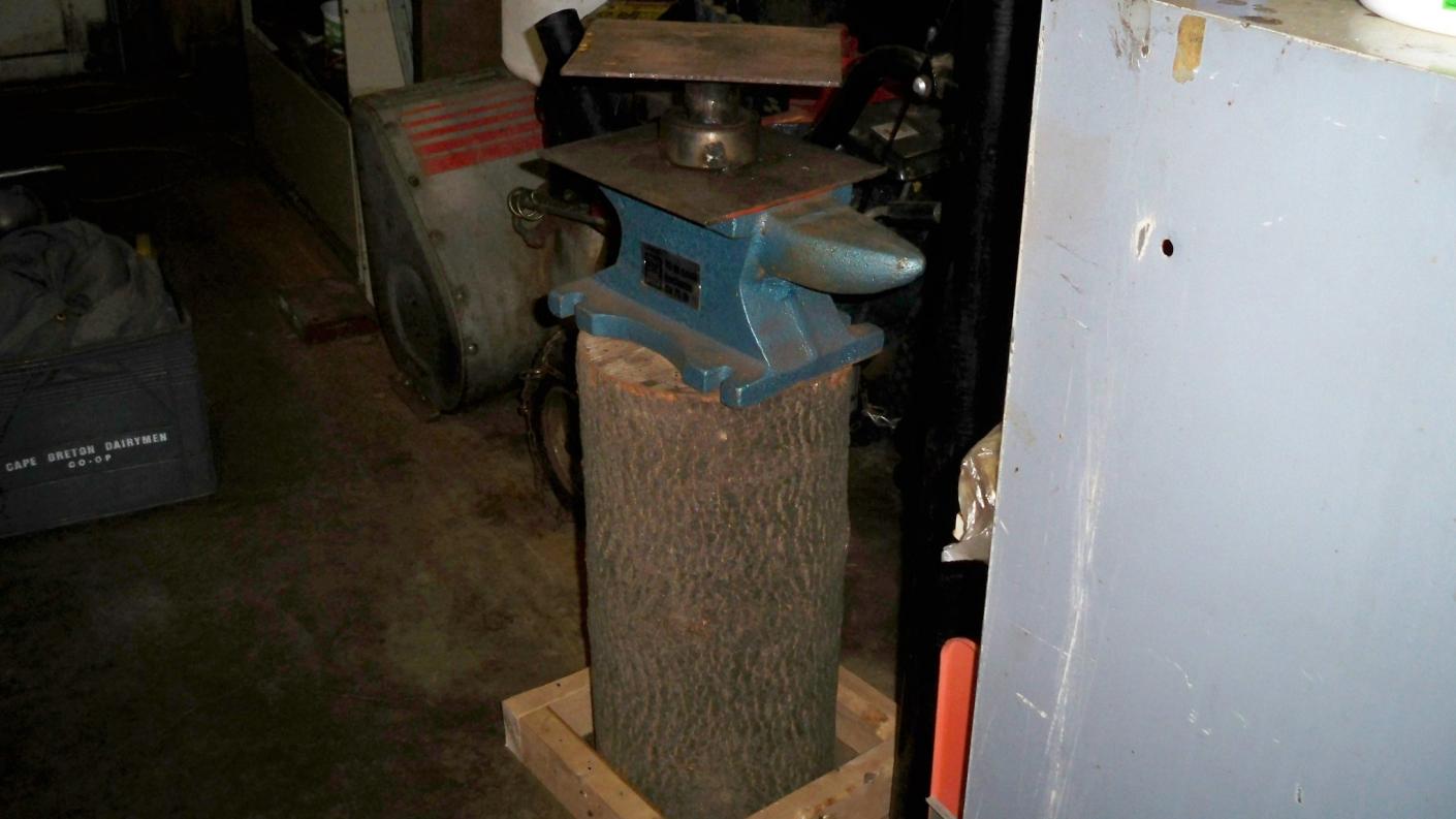

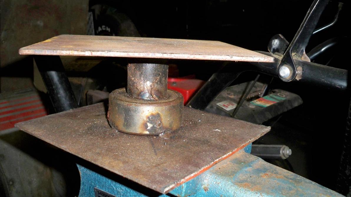

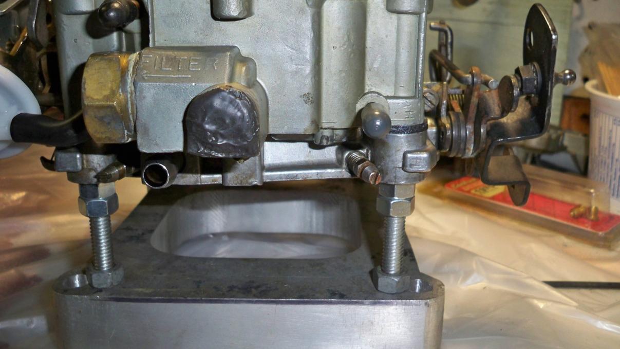

    garage tools-100_3764.jpggarage tools-100_3763.jpggarage tools-100_3765.jpggarage tools-100_3767.jpggarage tools-100_3769.jpg First two pics are simply a repurposed piece of a wire coat hanger ,flattened and notched to assist in "guiding" a very small spring on a carburetor into its proper position. Second is a piece of 1" aluminum cut out on a band saw and sanded,with bolts added to make it a carburetor stand for carb work,also used as a carbureretor spaceron engines.Third is just a few scrap pieces of metal, a piece of pipe and a scrapped bearing,tacked together for a small rotating surface for brazing or welding or painting small pieces on . Lastly is a simple hunk of a tree trunk I cut and added some scrap lumber to for a rudimentary stand for a small anvil.

    Simple and functional. I really like the welding/painting positioner. Thanks for sharing, nortin!

    Thanks nortin! I've added your Spring Guide Tool, Rotating Workstand, and Anvil Stand to, respectively, our Carburetor, Workholding, and Dollies and Stands categories, as well as to your builder page: nortin's Homemade Tools. Your receipt:

    Interesting spring guide you got there, as it reminded me of the days when I worked on carbs. I like your rotating workstand though, as I've been thinking of getting back into modelling, and this would work really well for me.
