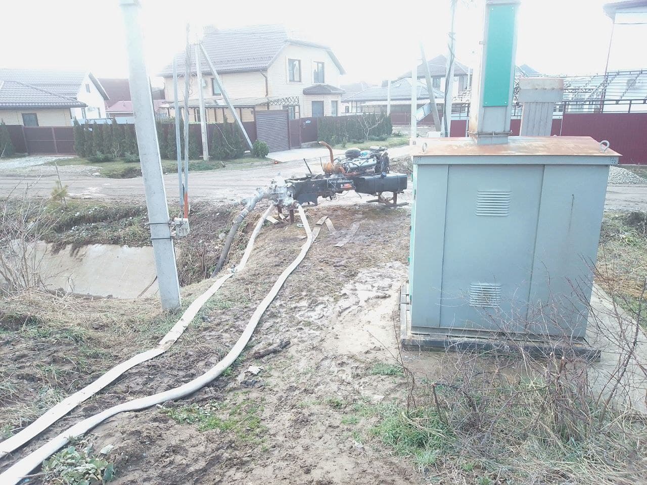

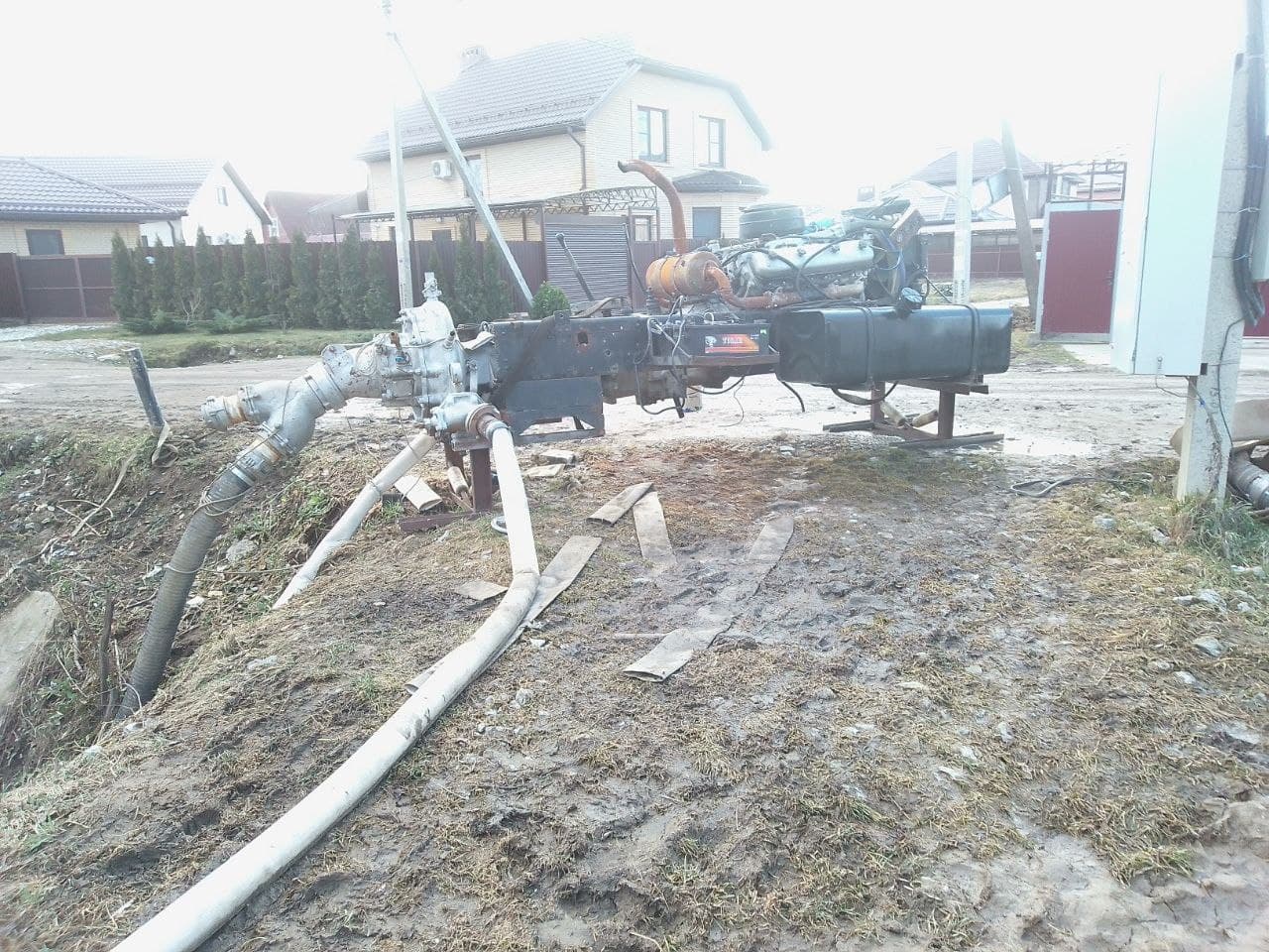

    Went for a walk today and ran across one of the "new" pumps they put in to keep our area from flooding. We've been having abnormally heavy rain and a LOT of snow this year.
    Anyway, it works but "new" is relative. Fits right in with this forum...
    Take one old truck, remove wheels and body (I would have left wheels on for towing), remove rear axel and install pump.
    The reason for the flooding...
    This housing development had been a large commercial fish pond and then a farm. There's a berm all the way around it with a small culvert through and with extra heavy rain it starts turning back into a pond. As some very well off people live here, pumps got ordered.
    There's also an issue of the river rising but that normally only bothers the people who built near it, we're a bit uphill from there.

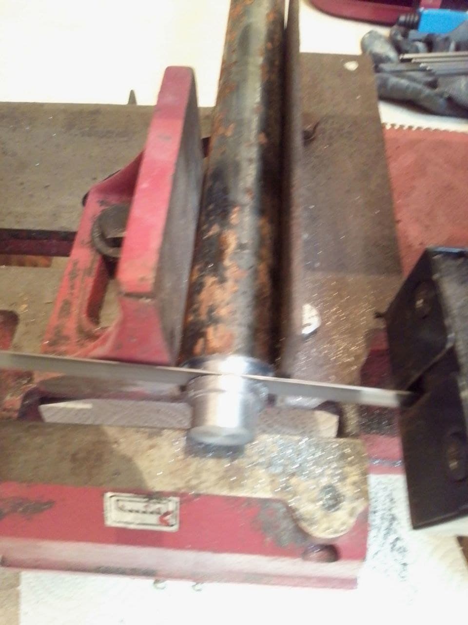

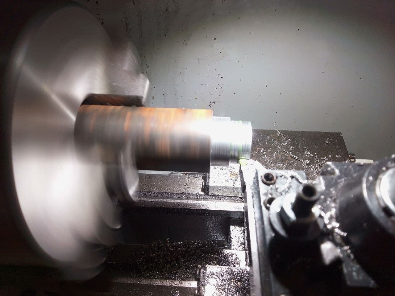

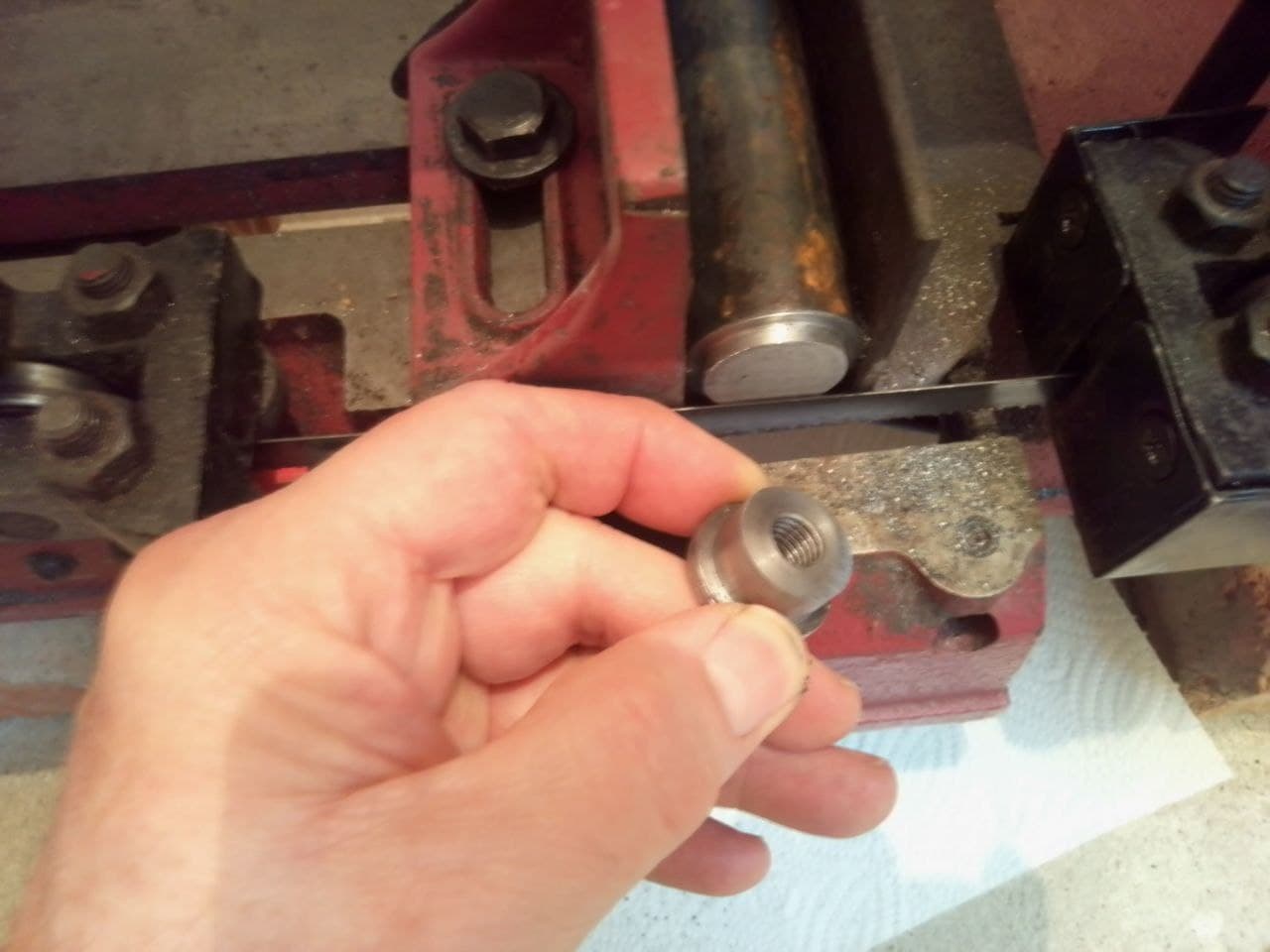

    Here's a piece of 32mm hot roll I bought (it was that or tiny). Turn it down to 25mm and 20mm

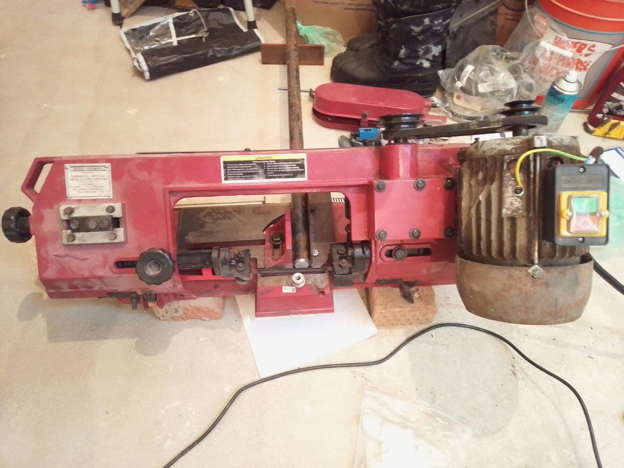

    Whack it off
    This picture is from the first one where I threaded it first.

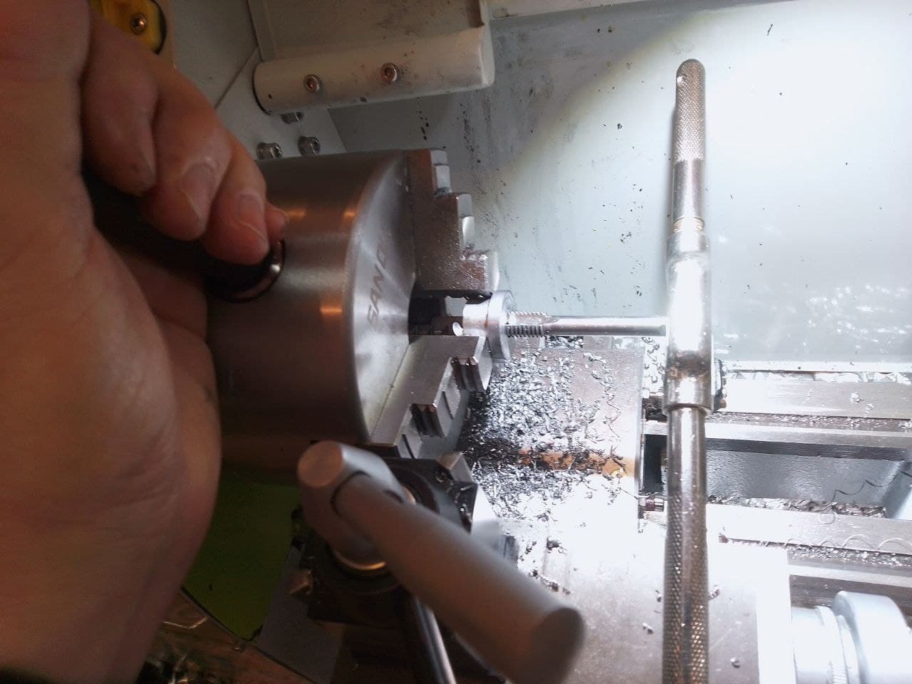

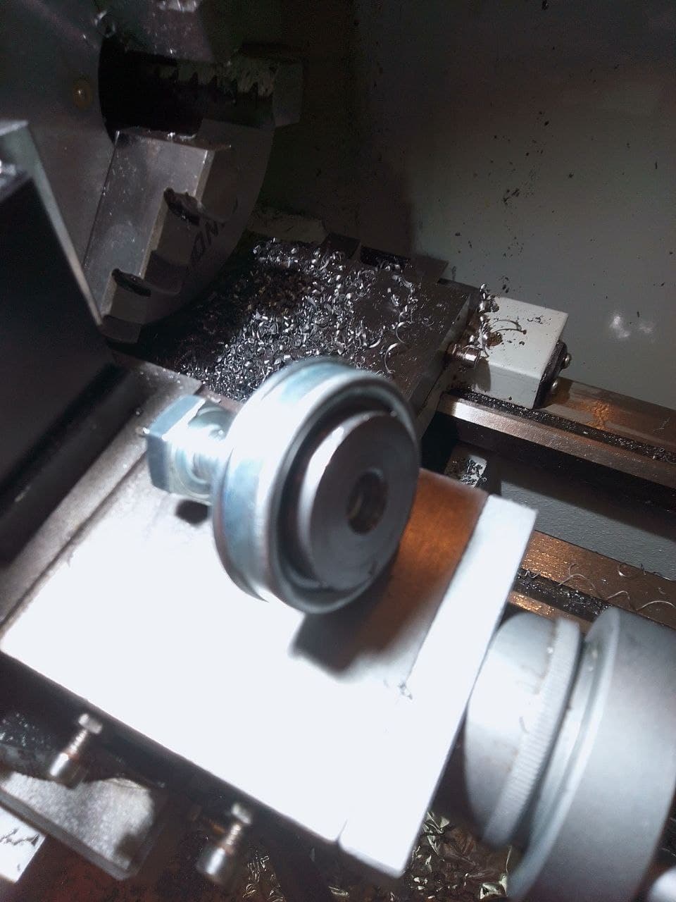

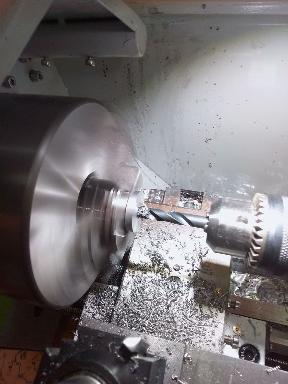

    Drill and tap. Funny thing, I couldn't find my taps so while I was buying bolts I looked for taps. Found the M10 taps come two to a package. Oh well, not expensive and only choice in this store.

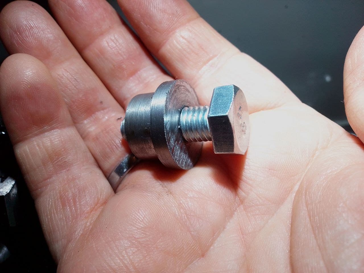

    Turns out one tap is undersized! Bit of a panic. Then I tried the other tap and it's the right size. So, I've started tapping in two steps, the undersized one and the correct one. Easier cutting deep threads that way.
    Both taps are marked the same, so it's not like this was intentional.
    Finished axel with the bolt in from the wrong end, but it's tapped all the way through

    Welcome to the world of use what you can find and you get what we have to sell not what you need or want.
    I like to make things where the fastener only holds things together, and whenever possible not dependent on shear strength.
    not knowing the design of your trolley or the loads it will see I might have tried if it were possible to machine the axles so they extended into the mounting plates even if only say a 16mm dia, step extending into the plate 3 to 4 mm, unless you are planning on welding the flanged end of axle to the plate making it a stub shaft, then I might have still left a locating boss on that end if it were location critical

    I considered doing that but looking at my metal supply leaves me somewhat wanting. But, I will weld on "bumpers" that hit the stop bolts in the I-beam and will extend almost to the web of the beam. If the wheel fails the trolley will hang from the bumpers.
    Also, the bolts are 5.8 M10 and the max capacity of the hoist is 500kg, so there's a safety factor in there for bouncing.
    Other than carefully lifting the mill, I don't plan on this being heavily loaded in the future. I will also remove anything not securely attached to the mill before lifting, make it as light as possible.
    At least it's not a BIG mill, that would be a problem.

    The hoist came with 4mm thick straps to go over a 50 x 50 beam. The bolts are in tension, M10 8.8
    So, I won't be too far off. If the trolley otherwise works fine I may order some stronger bolts for the axels. Probably order a higher quality flanged bearing too.
    Can't recall who described this earlier, but tap sets described as under and full size seemed commonplace in Europe. Unsure about how those are labeled to differentiate.
