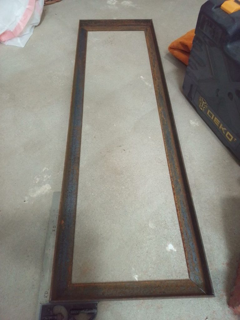

    Finally started building the stands and tables for the shop. First is the bandsaw since it is needed for everything else. It will have a top with a lip to send coolant back to the tank. For now I have the frame for the top and the legs.

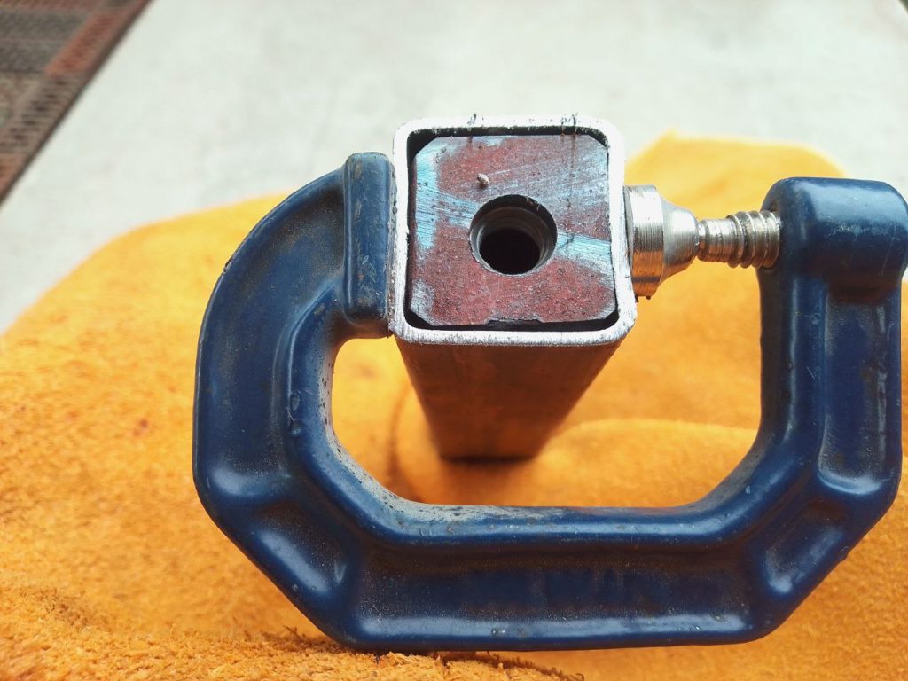

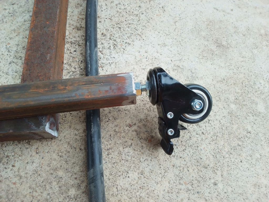

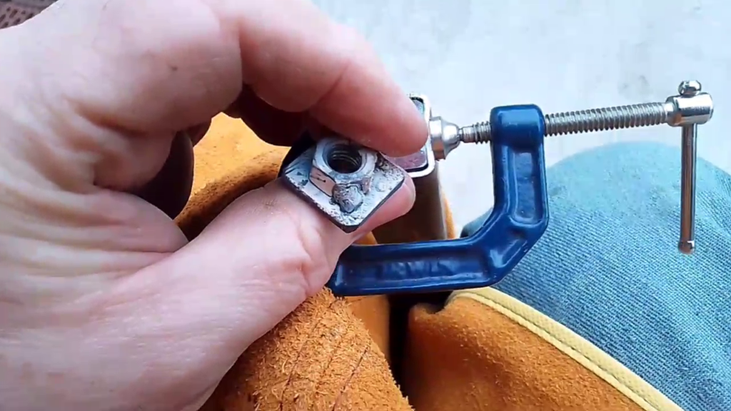

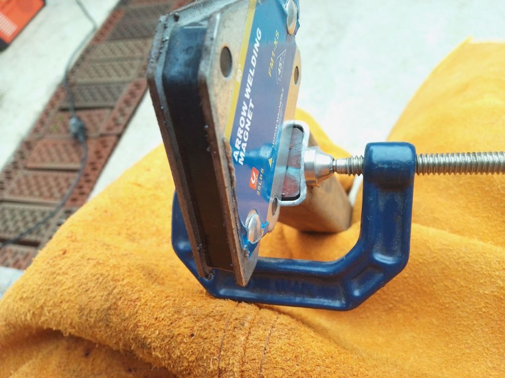

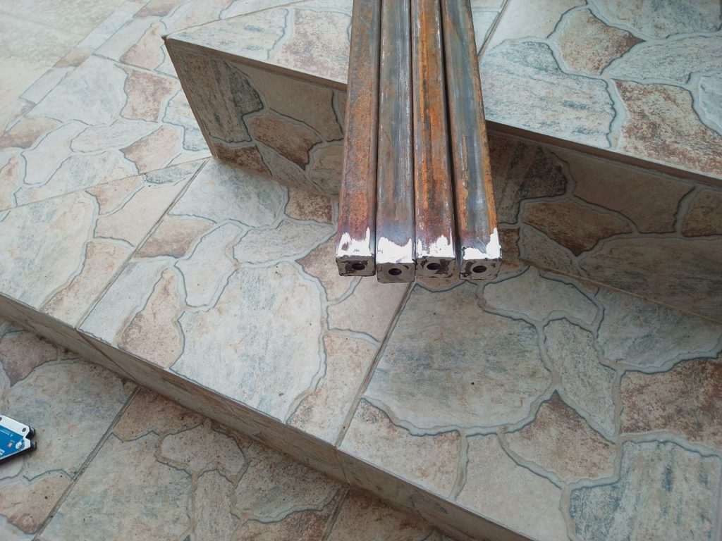

    On those legs, to mount wheels on them I did the normal nut welded to plate and welded to the bottom of the leg. Plugs were cut from 3mm plate from a scrap dealer.
    To hold the plug in place for welding I first used a magnet to position it then bent in the wall of the tube with a C clamp.
    remove magnet, tack, remove clamp, finish weld.
    to be continued...

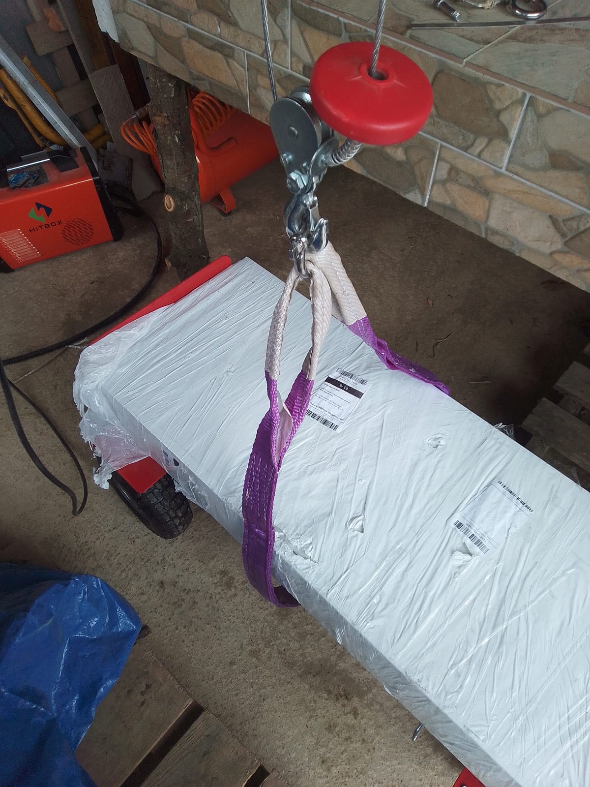

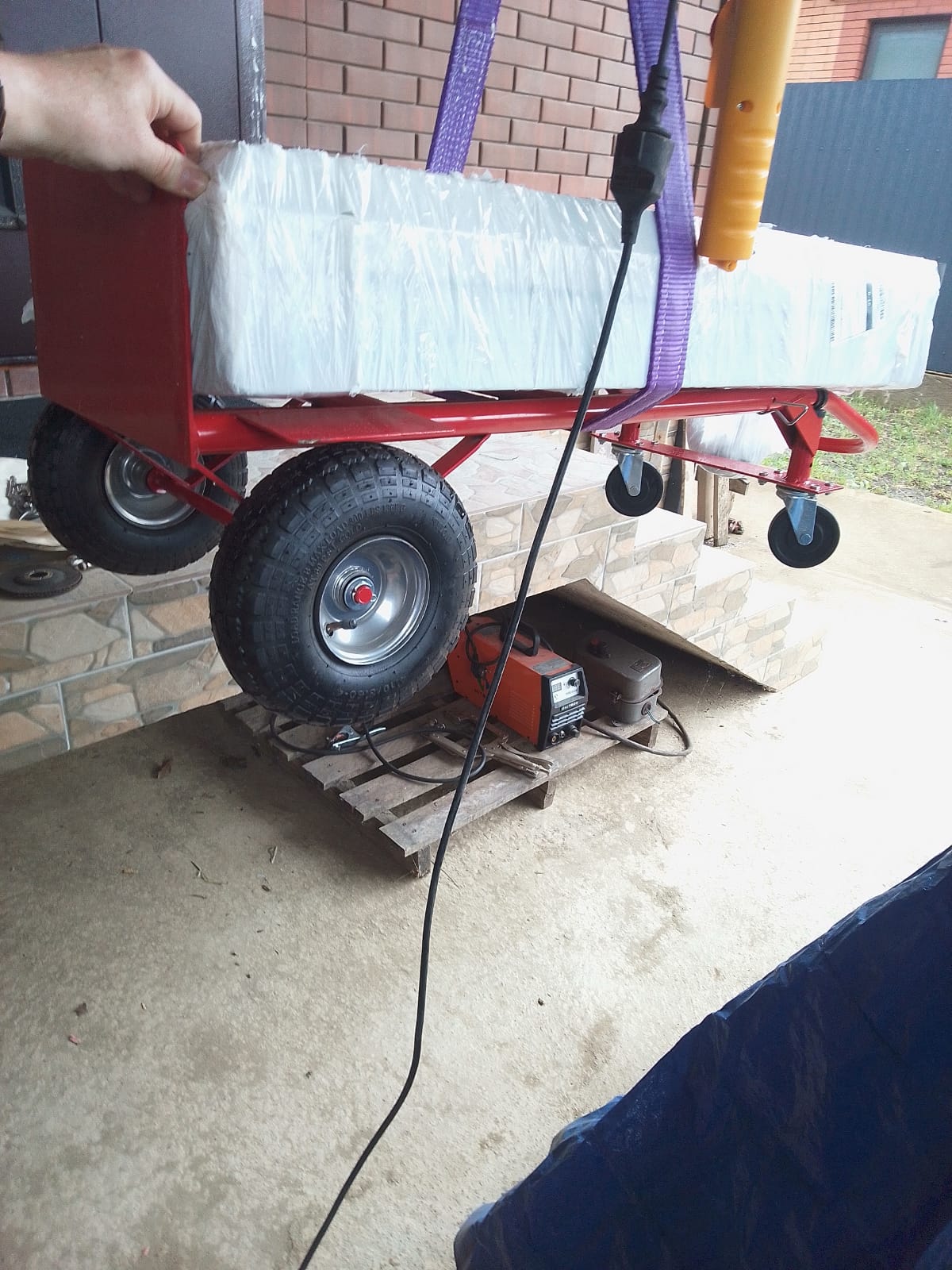

    One of the local steel places has online ordering from their central warehouse. Much wider selection, 5% discount, delivered to our driveway. Time to start a shopping list...

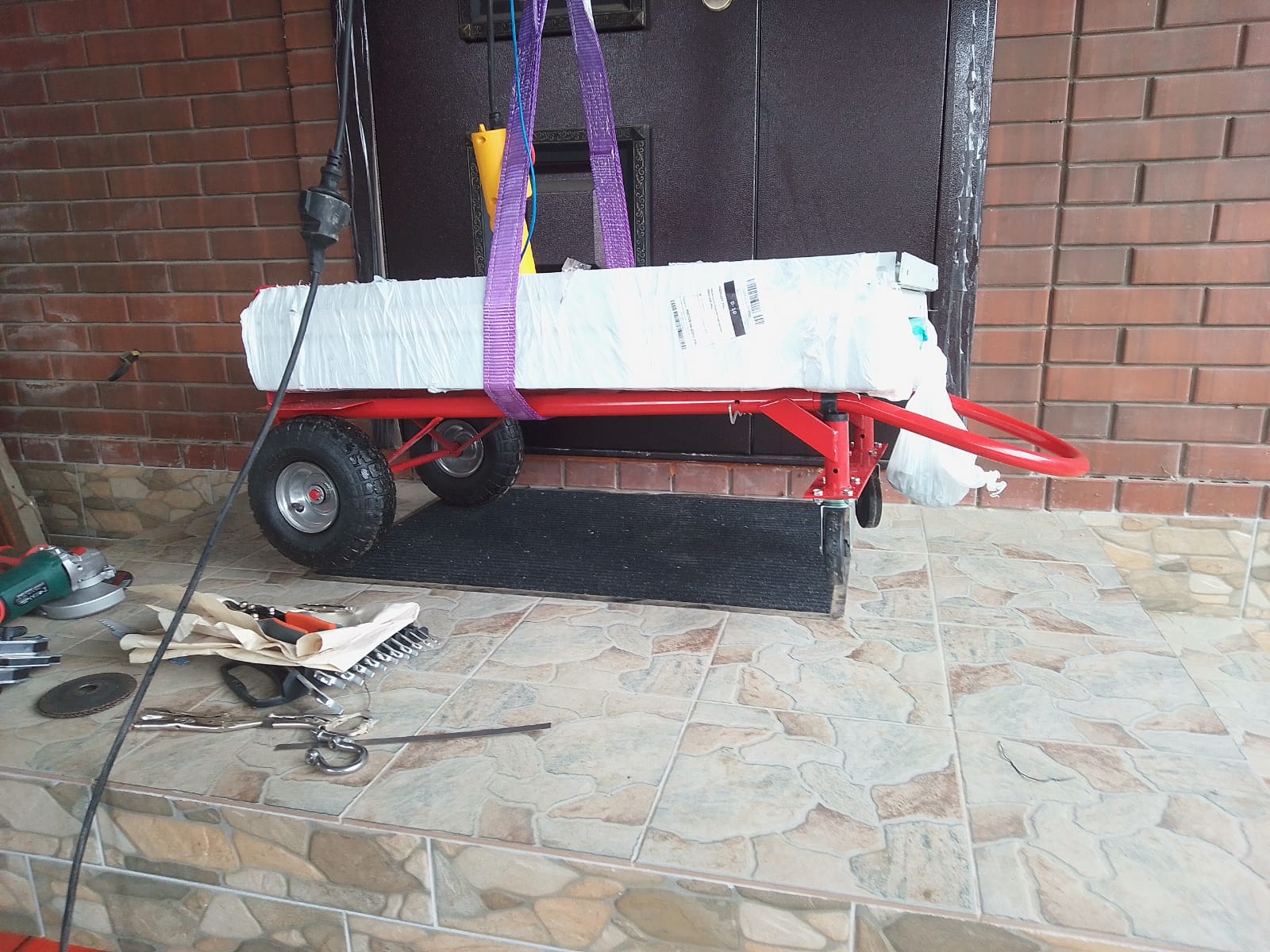

    Picked up a couple of heavy packages today from the Ozon (like Amazon) pickup point. I wonder how many people show up with their own dolly?
    Anyway, hoist works! Rolls nicely but of course this is nowhere near a full load.

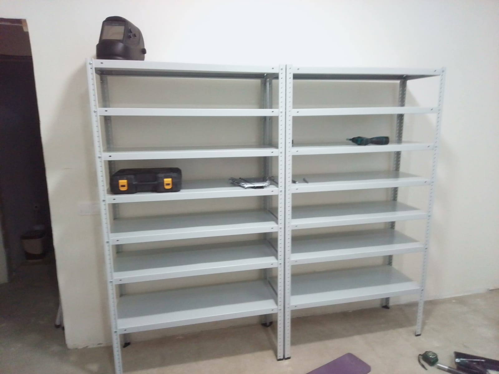

    Today was a fairly easy day, shelves we had ordered for the workshop arrived so we set them up. Now we have a place to put tools and forget where they are.
    Yes, i took the picture before all the bolts were in. Finished now.
