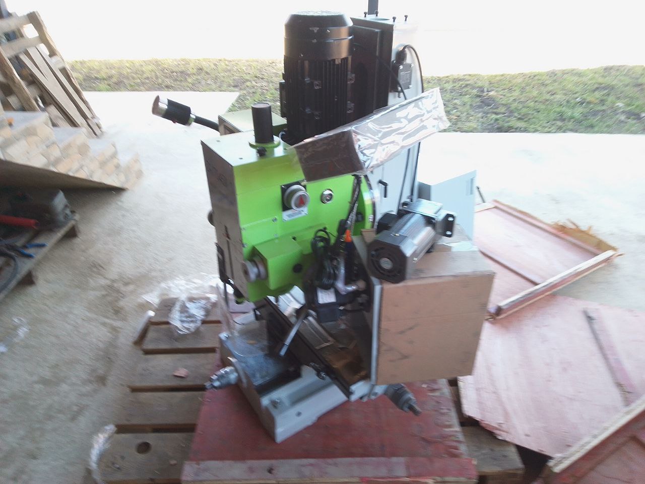

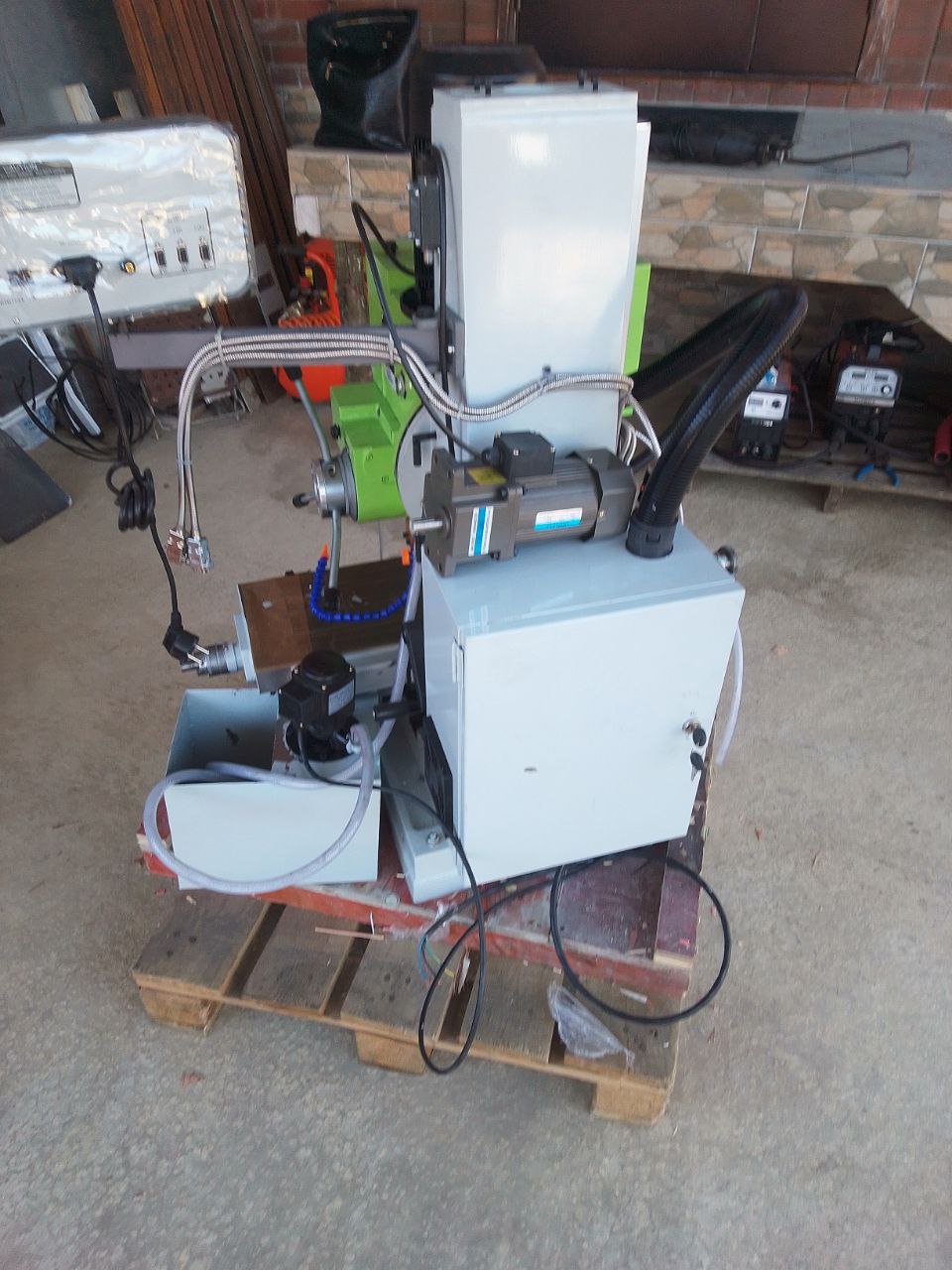

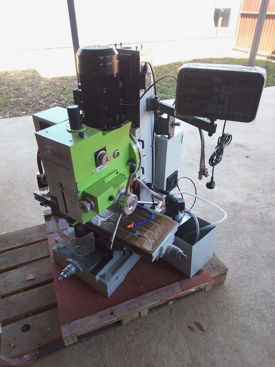

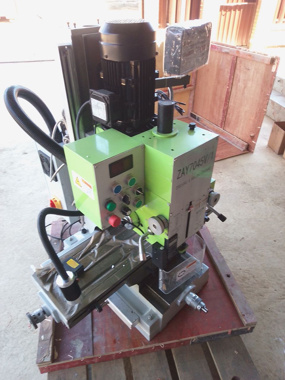

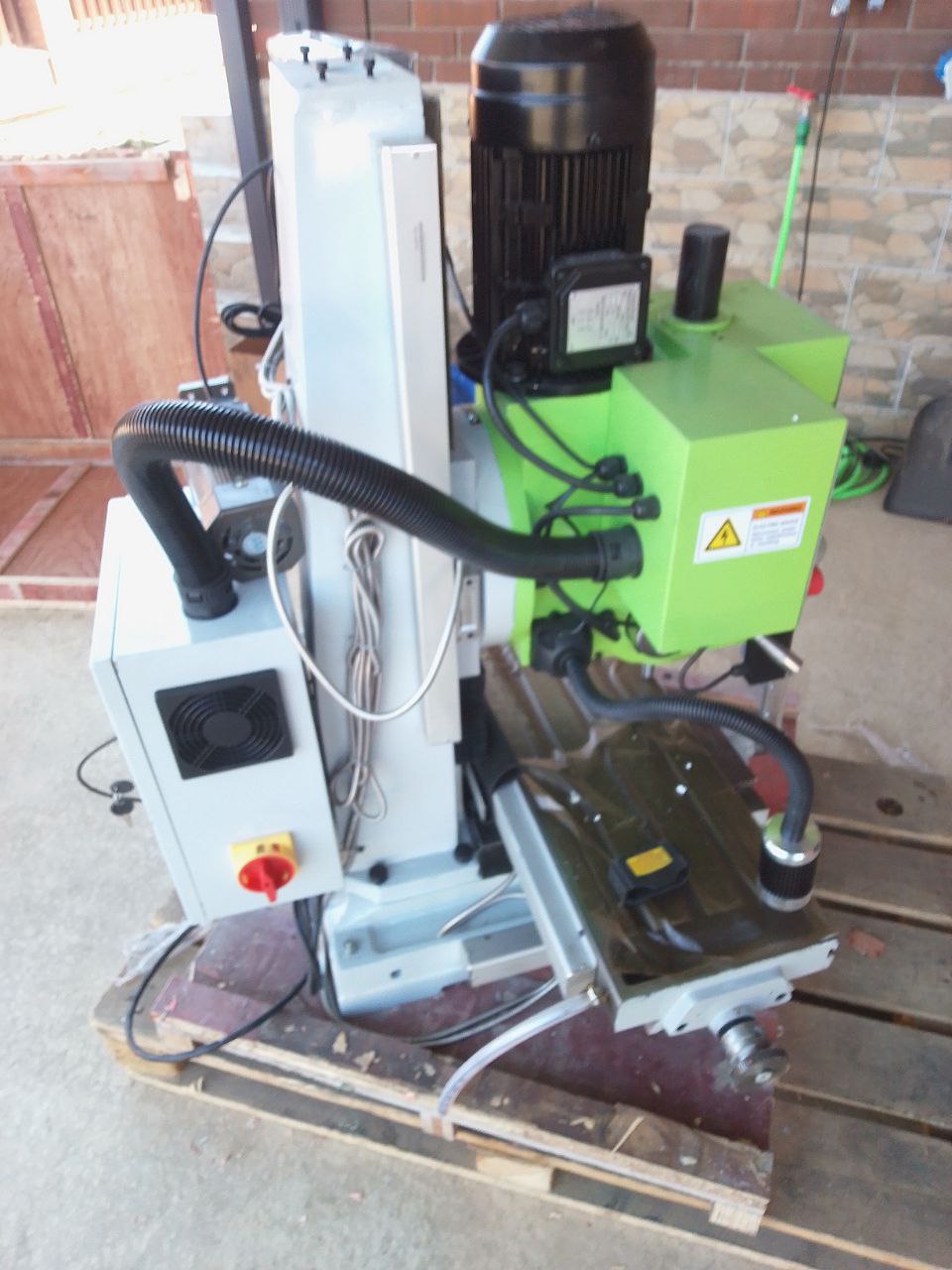

    jdurand's Tools
    Just a status update: We had to take some time to reconfigure our business with all the sanctions flying around. Also PayPal and eBay closed up shop so looking into other payment services, probably use Yandex Money mostly.
    Stores still working normally, my VISA card works fine, and my USA debit card still pays AliExpress for deliveries here. So, for us more paperwork and a delay in shipping products, but otherwise everything is "normal" (нормально).
    Not sure where our milling machine is, a cargo container of machines was arriving in Moscow last week and the mill would be reshipped to us. But the manager is currently out sick with what we had so no word. Hopefully it wouldn't just show up unannounced.
