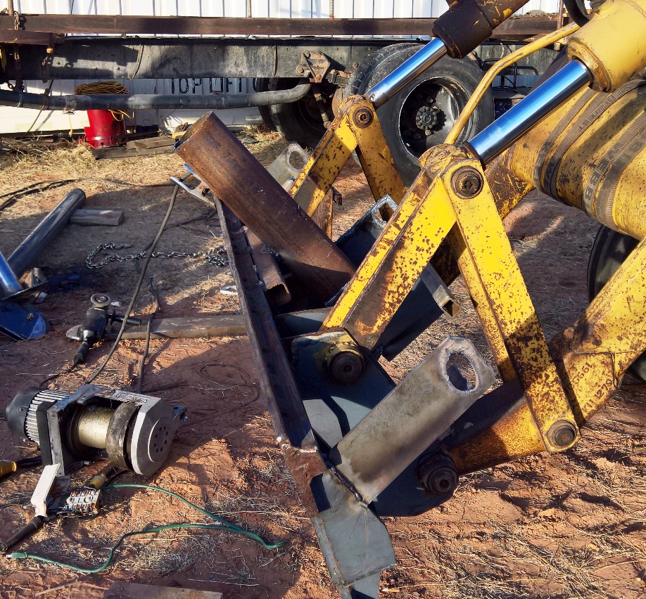

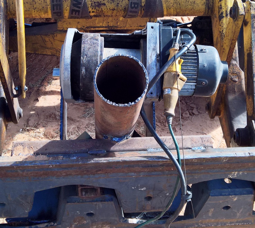

First off I had to repair an old roofing hoist I had in order for any of this to be worth doing.

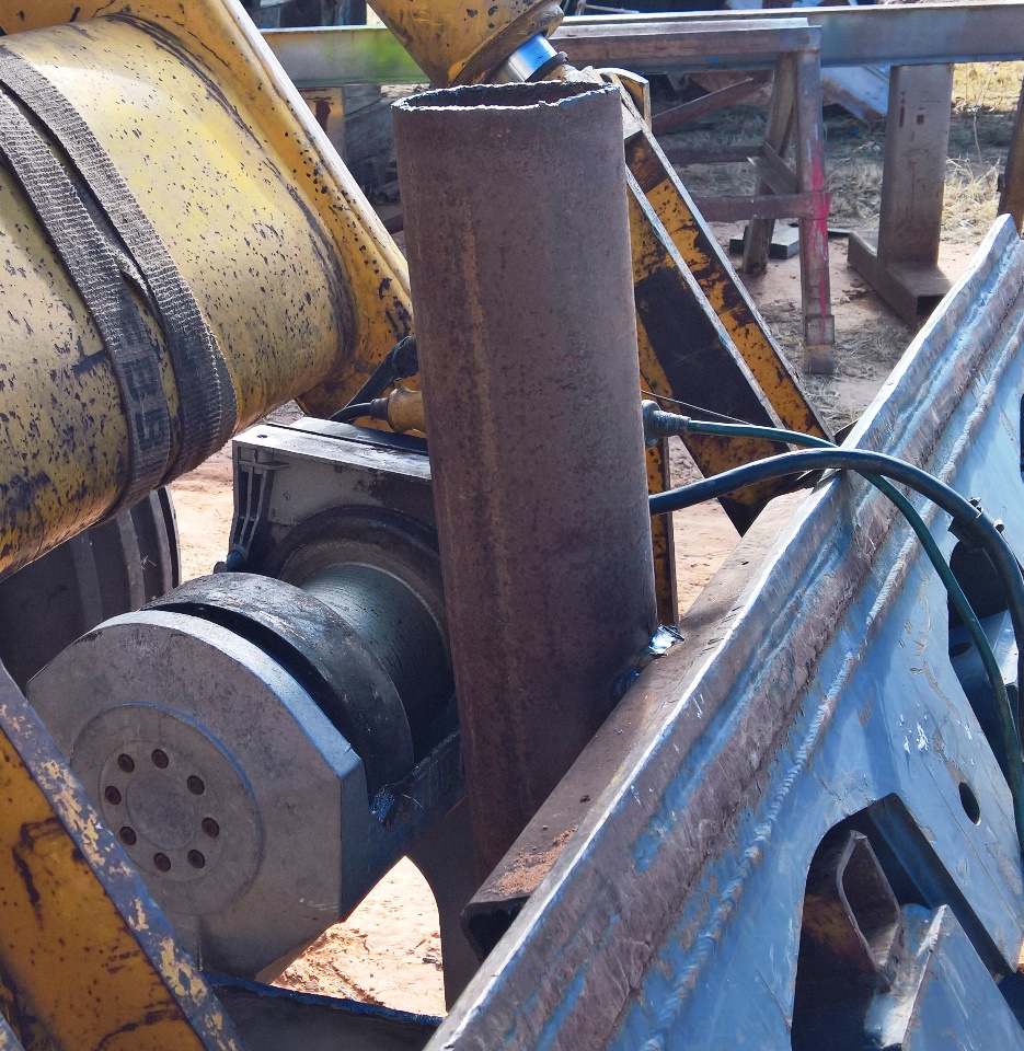

I made a mount for the hoist and a gin pole this will allow me to use any length pole that I can safely pick up with the loader
Attachment 32419
Attachment 32420

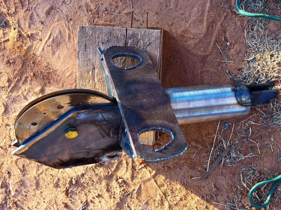

Then I made a pair of chain eyes to use as anchor points for when I am carrying long bulky and otherwise unyieldingly hard to carry loads on the forks, also to use as stabilizing anchors for a Mono gin pole.
Attachment 32421

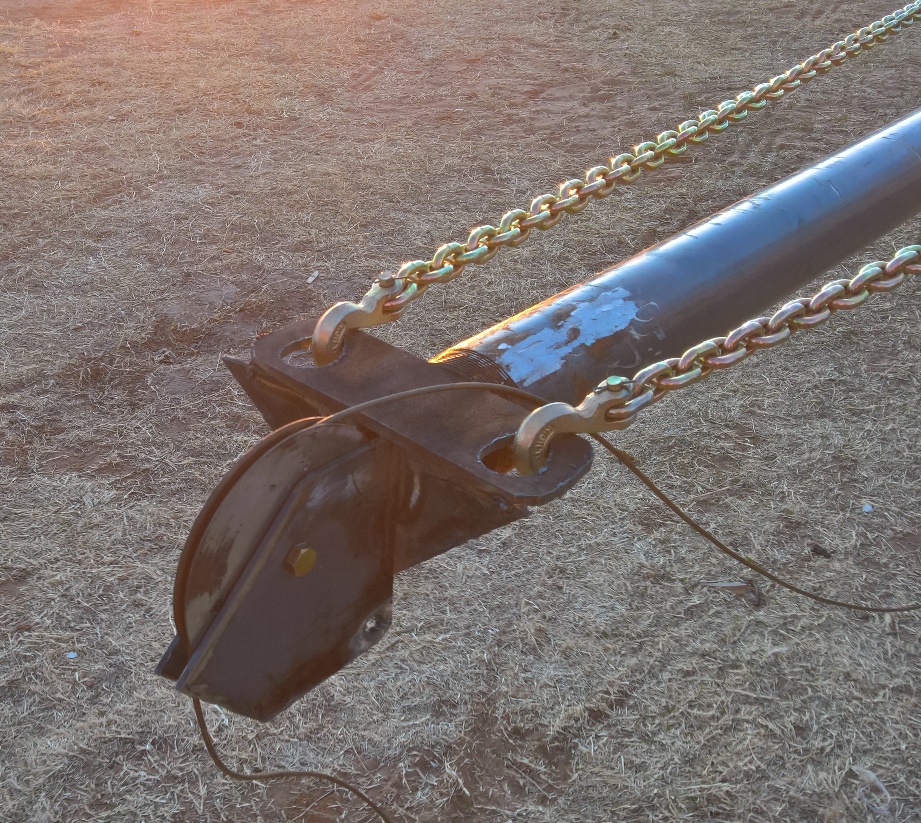

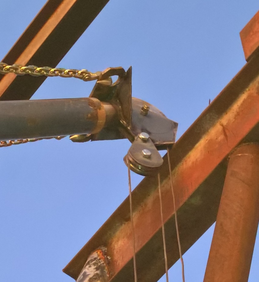

Next I made the top block point sheave to fit on the pole and to anchor the ends of the chains with to give me triangular stabilizers for the gin pole.
Attachment 32422

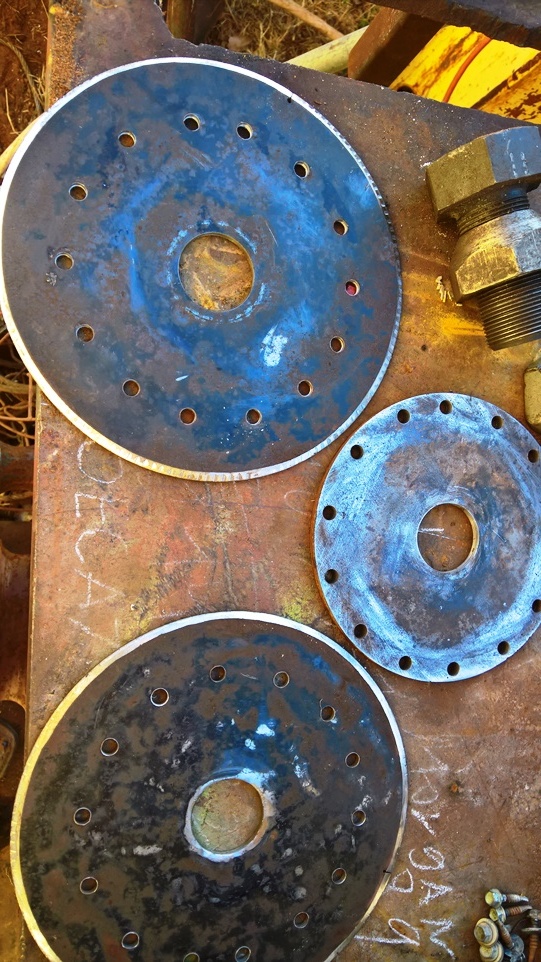

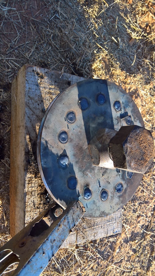

Attachment 32423

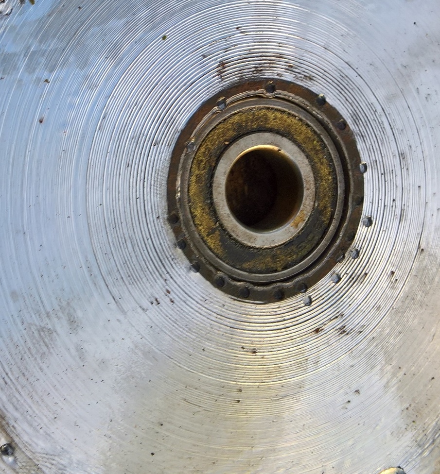

I left a lip on one side then staked the bearing in the sheave.
Attachment 32424
Attachment 32425

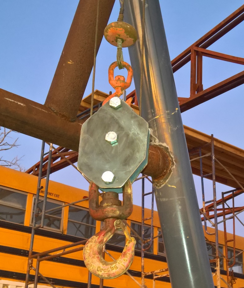

Put it all together with the pipe I used as my spreader bar extension
Attachment 32426

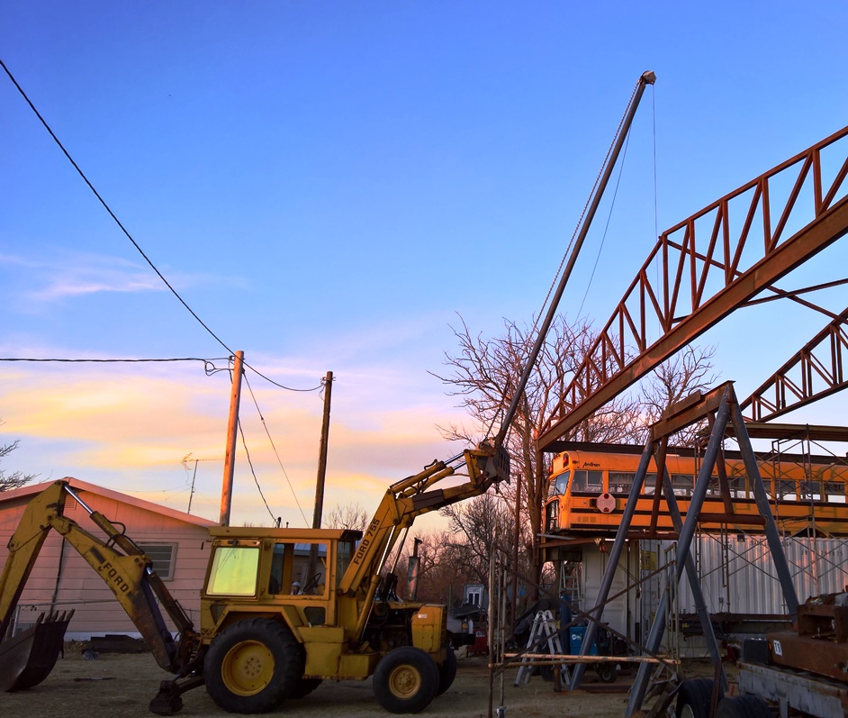

And this is what I came up with
Attachment 32427
Now I will be able to fly the purlins a few at a time then afterwards lift the insulation and the sheet metal
