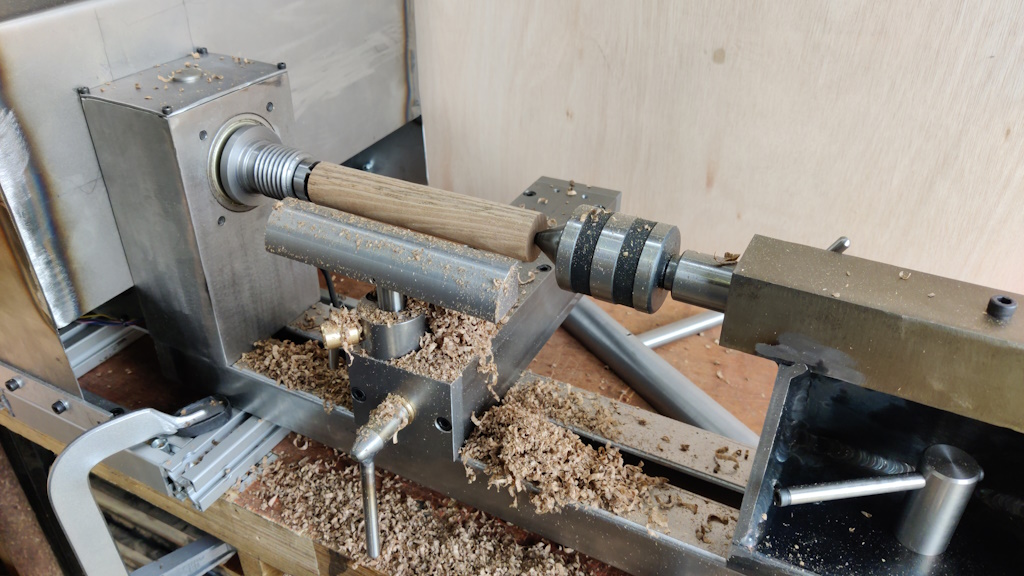

    The lathe has a 128 mm centre height, so can swing a maximum realistic diameter of about 250 mm. The bed is 1 metre long; I haven't measured the maximum between centres distance but I'd guess it's about 700 mm or perhaps a bit less. Both headstock and tailstock have MT2 tapers; the headstock has an M33×3.5 thread for mounting a chuck. I've tried the variable speed drive with spindle speeds up to about 3500 rpm, although I mostly run it much slower.

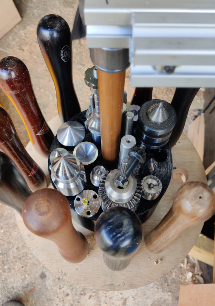

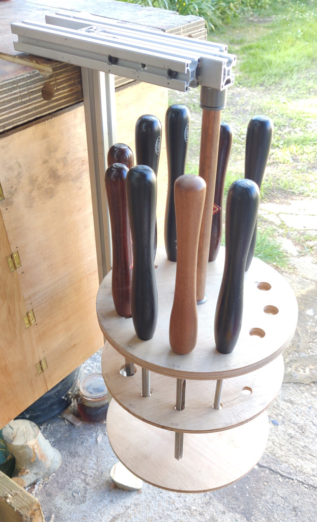

    I also made a simple "Lazy Susan" tool holder, with skateboard bearings to make it rotate freely:

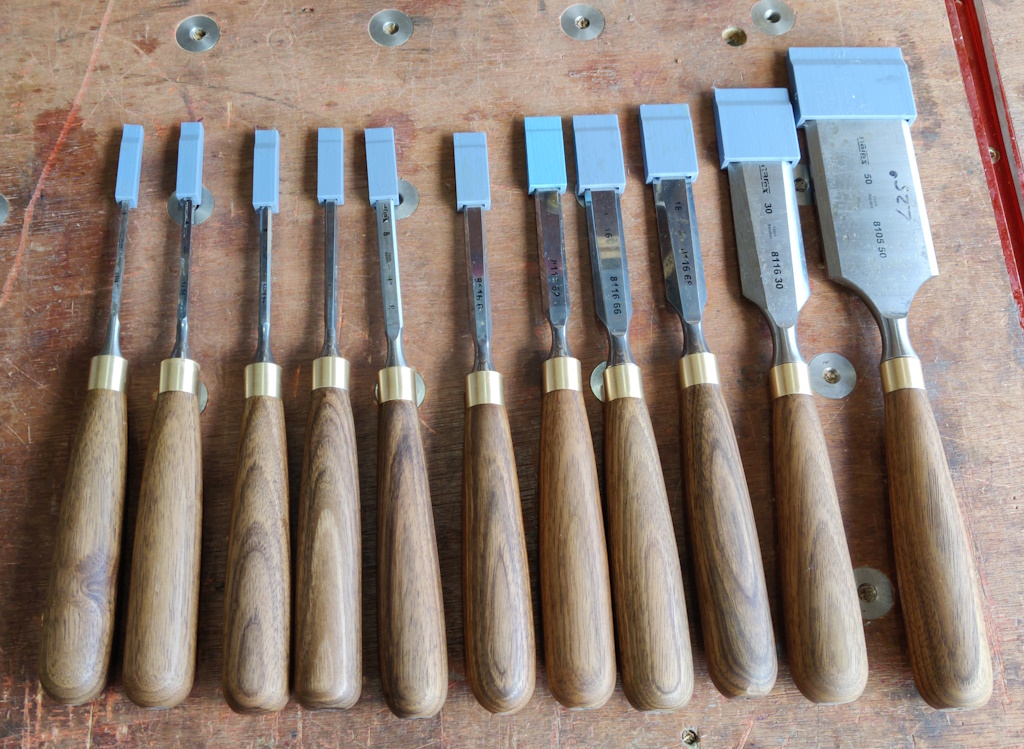

    Some of the things I've made with it so far. Firstly, some new handles for my chisels:

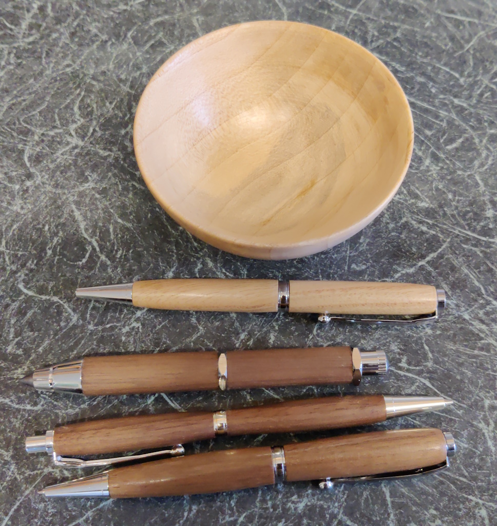

    Secondly, a small bowl and some pens and pencils:

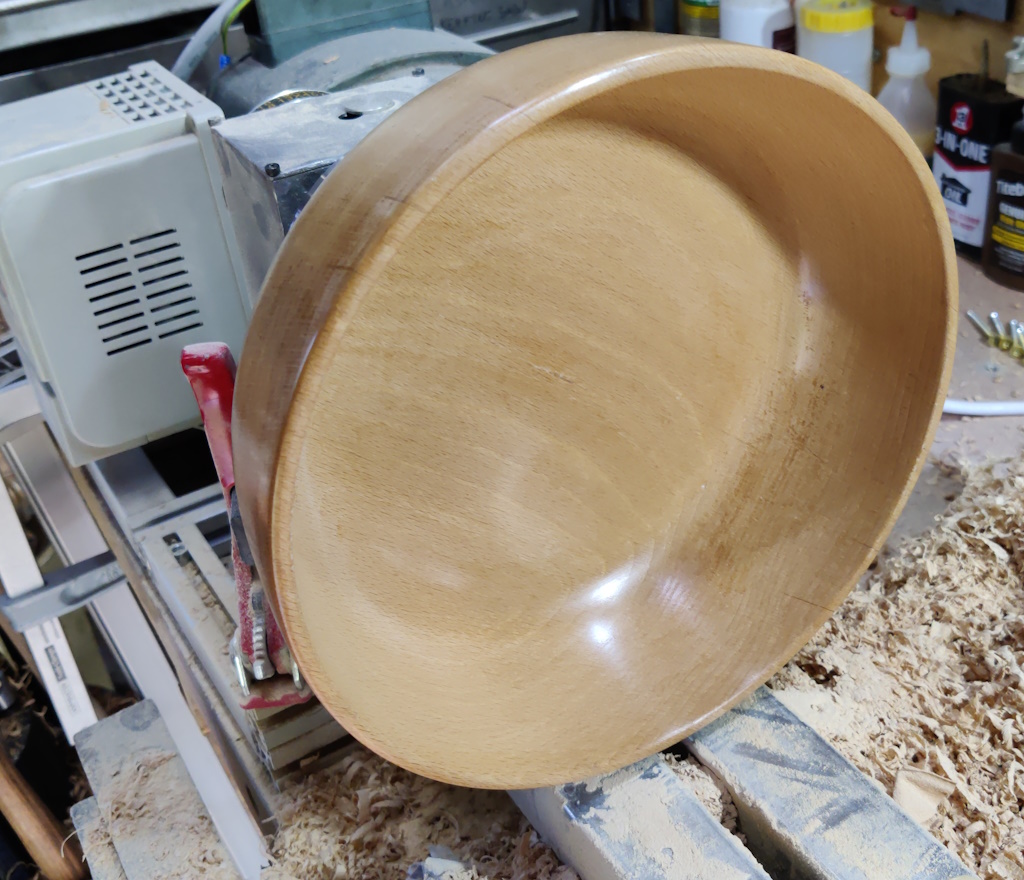

    A big beech bowl (made mostly to try out turning something close to the maximum diameter the lathe could handle):

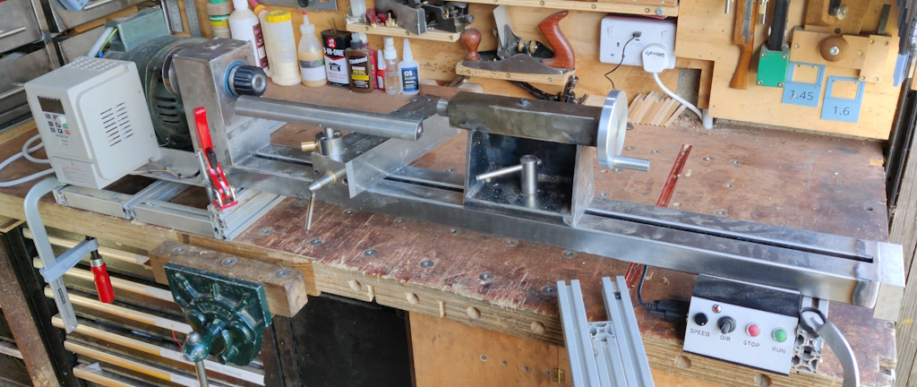

    I made myself a woodturning lathe nearly two years ago, but over the last Christmas break I gave it some fettling, adding a lever-lock to the tailstock and to the tool post and giving it a lick of paint as well as a few other upgrades described below.
    Before:
    After:

    The following photo (taken before I'd made the brass logo/tommy bar cover) shows the dividing method, with the belt guard open for access and a sliding bar pushed into one of the 12 holes in the dividing wheel:
    There is lots more information in the (now 65 page) build process description on my website if anyone is interested.
