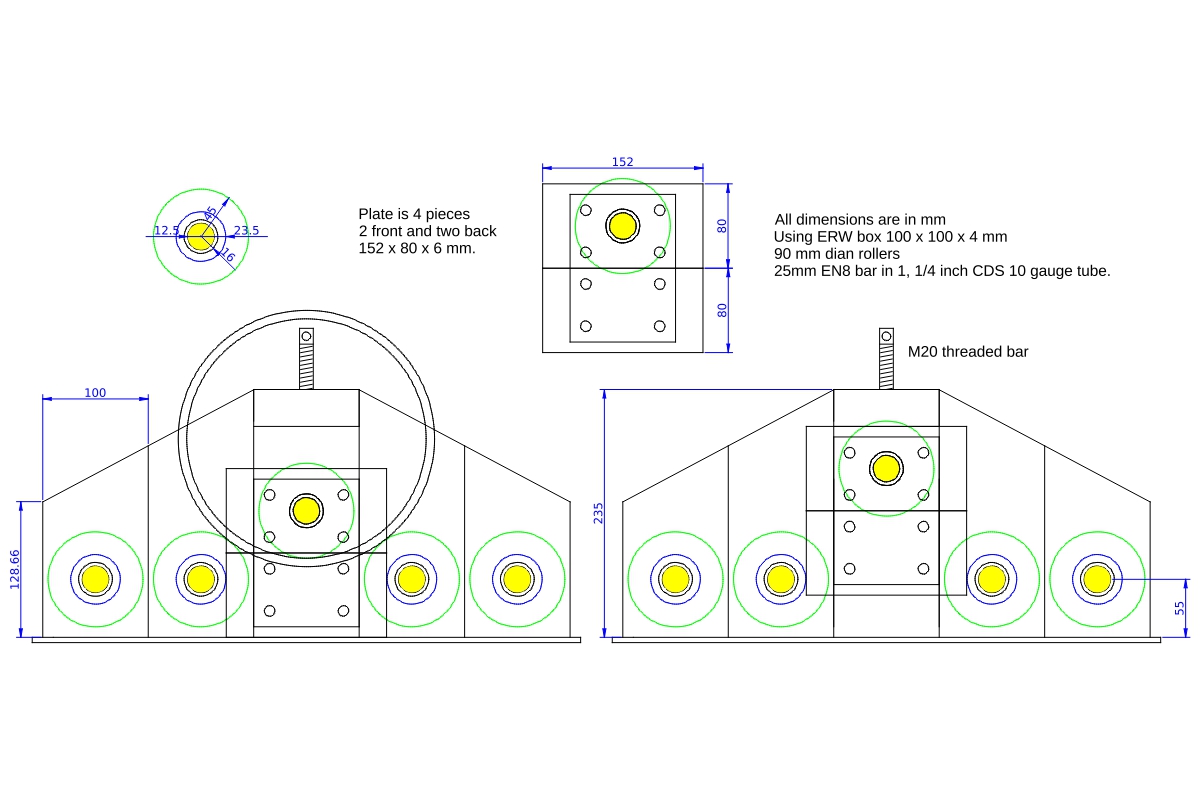

    Made the mistake of pressing the request for plans after I saw that someone
    had clicked it, thought the button may have suggested who wanted them?
    At the beginning of the post I stated that I started these without any
    drawings as basically I was using up what I had around the workshop.
    But I did start to make CAD drawings of the unit, please bare in mind I am not
    CAD proficient and I will try to add to this as, and when I can.
    Adrian

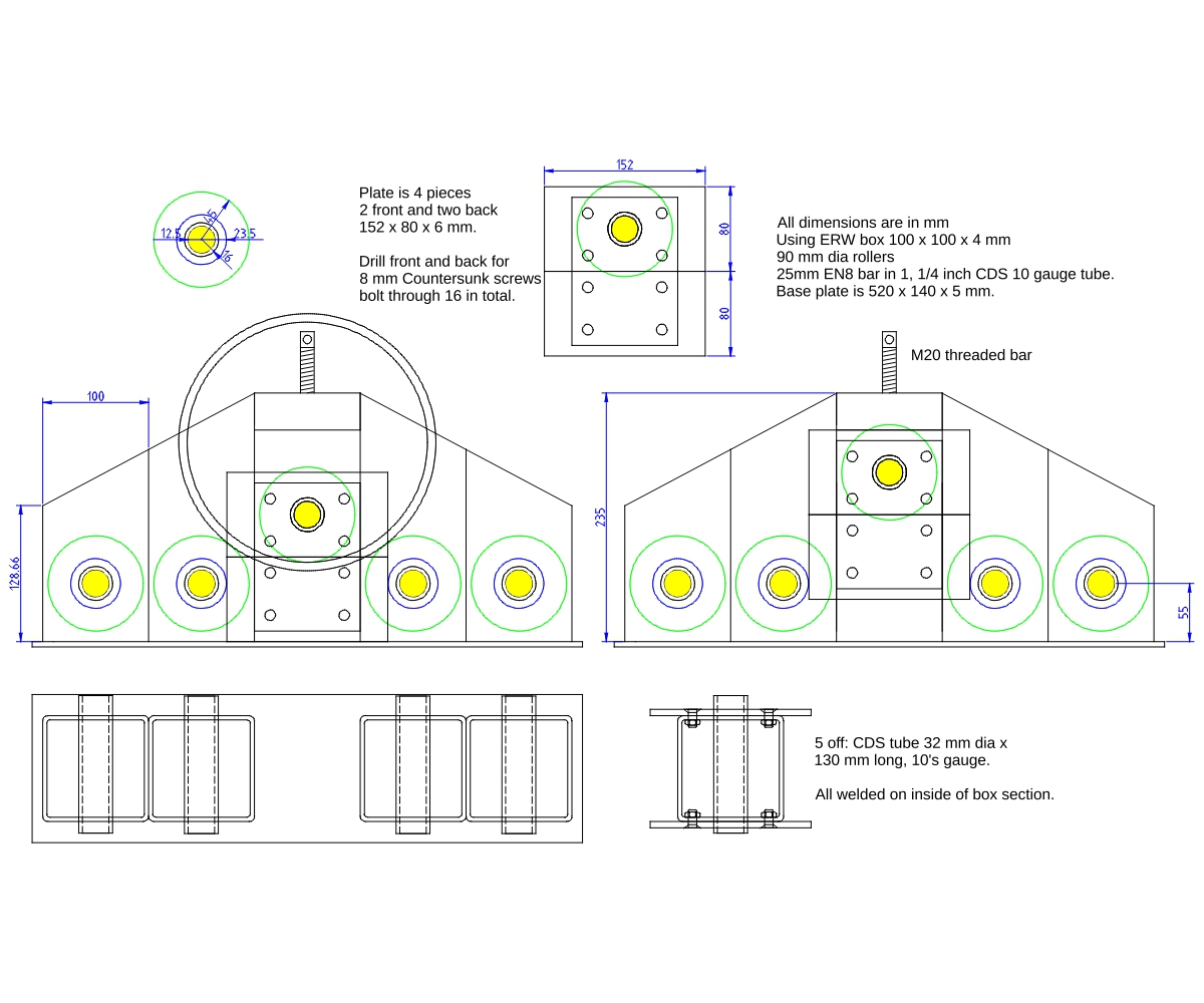

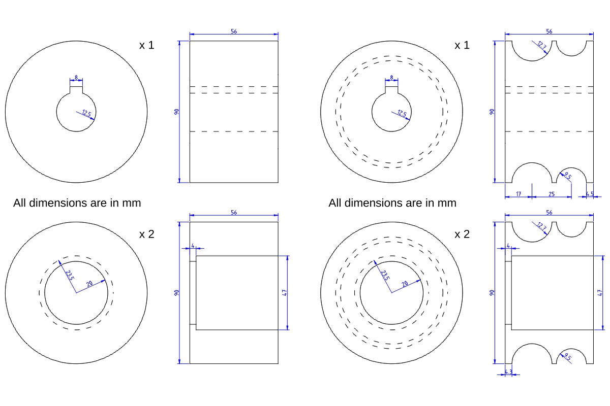

    Looks like a few are asking for plans, well 7. Not sure what else I can add, so here are the rollers:-
    Just amended the other drawing see here.
    I will try to add more as I can.
    If I am meant to do differently then add pictures to the post then please let me know.
    Adrian

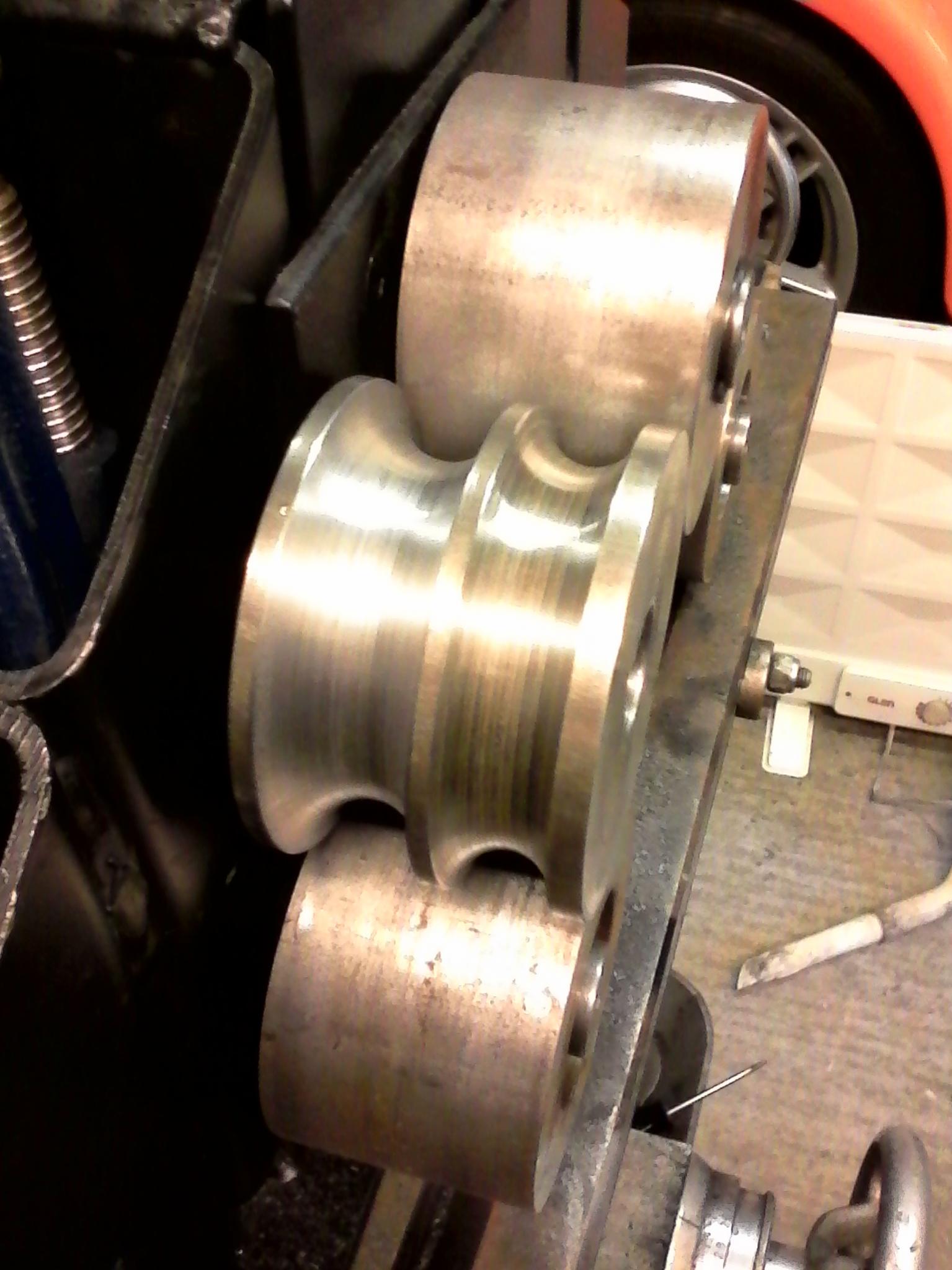

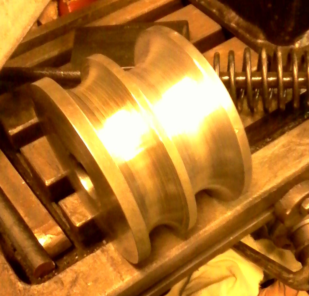

    I cut the second groove in the roller for tube the other day, should now be able to roll inch tube as well as 3/4 inch. I either need to do the idle rollers or make some adjustable guides I have been promising myself.
    Home made ring roller, ongoing.-roller3.jpgHome made ring roller, ongoing.-roller4.jpg
    Adrian
