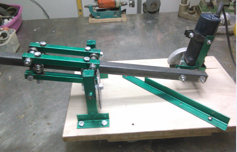

    HOMEMADE RADIAL STAND FOR MY ANGLE GRINDER
    ANGLE GRINDER STAND
    You can watch how to make an easy accessory for your angle grinder. Using the right disc you can easily cut every kind of materials like wood , metal and stone. You can cut for 35 cm length and less than 3 cm thick. You can adjust the angle you want to cut from 0 to 90 deg.
    MATERIALS
    1. Tube 2Χ2 cm 1,5 mm 4X20 cm. Holes 10 mm , κέντραπό 1 cm and 3 cm far from the end
    2. Tube 3Χ3 cm 2-2.5 mm 1X80 cm and 2x16 cm
    3. Bearings Dex. 30 mm - Din. 10 mm 8 mm thick 8 pieces.
    4. Angle profile 3Χ3 cm 38.5 cm .
    5. Angle profile 3X3 cm 10,5 cm 2 pieces .
    6. screw 10 mm περίπου 1,20 m.
    7. nuts Μ 10 about 40 pieces and screws 10 χιλ. 4Χ5 cm.
    8. For the grinder 3 cm X 2-2,5 mm , length 35 cm .
    9. To connect the grinder screws 8 mm with nuts M8 .
    10. Ring 25 cm to tight the grinder.
    11. Wooden base 2,5 – 3 cm 40 Χ 60 cm.
