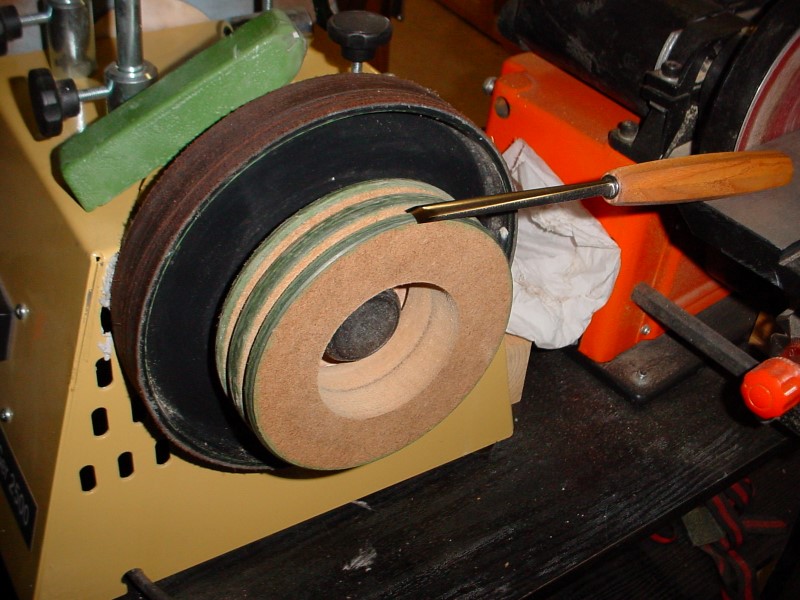

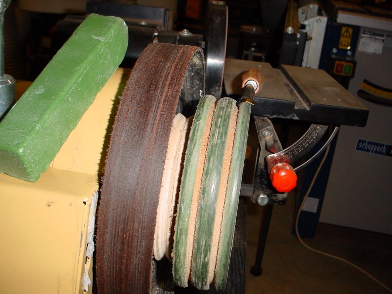

    Here is an extension that can be easily done to the wet grinder :
    It is a wheel with several profiles of different radii, made out of MDF on the lathe.
    The MDF is great for holding honing compound.
    This wheel is simply stacked over the existing plastic wheel, which holds a leather rim.
    So it is used to hone the flute of carving gouges.
    Cheers !
    Christophe

    Interestingly polishing the cut ..
