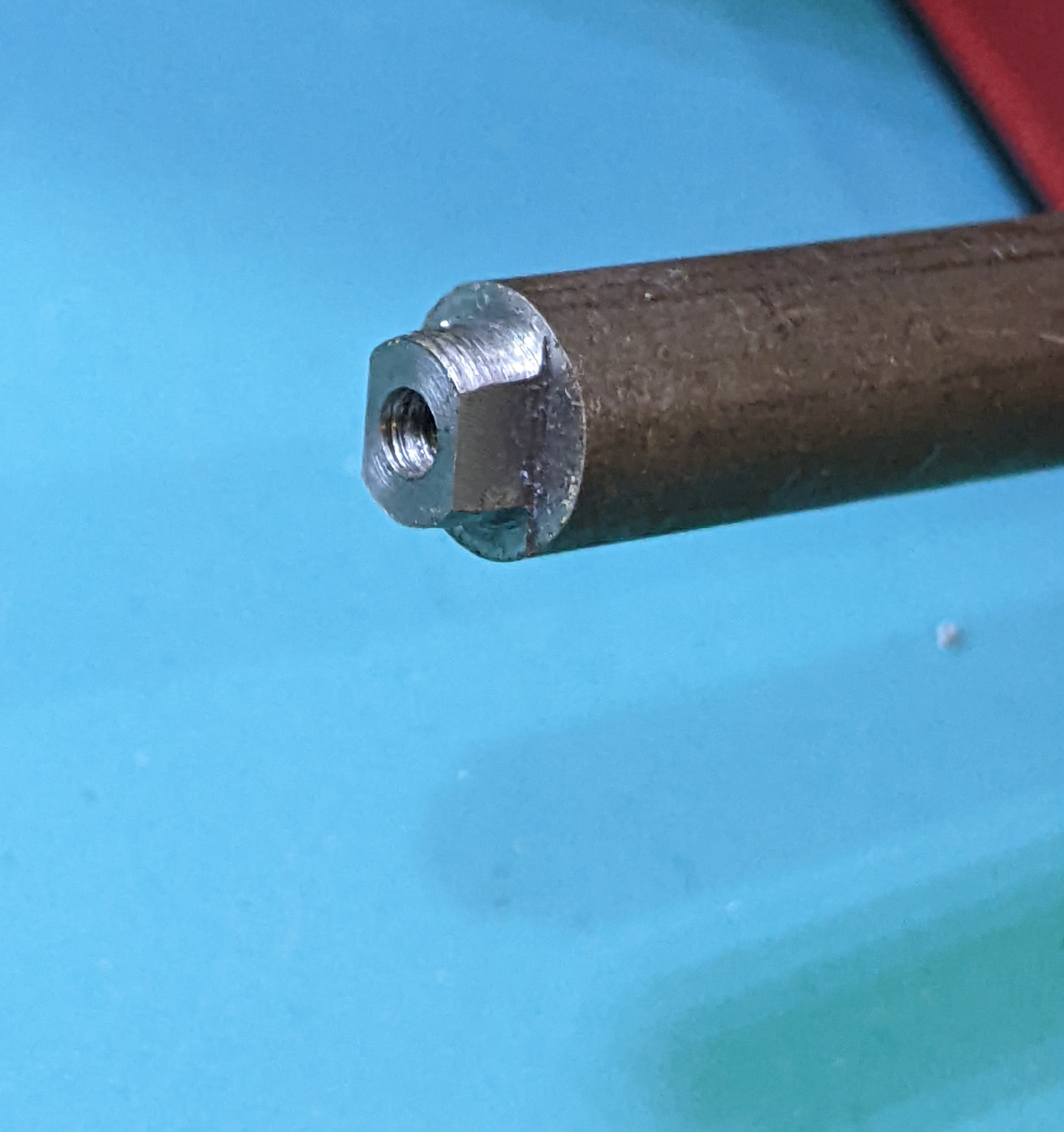

I made a mandrel that resembles the actuating stem of the ball. That was easy peasy, 5 minutes at the lathe and 5 minutes at the mill. Quick ‘n dirty. It only needed to work once.

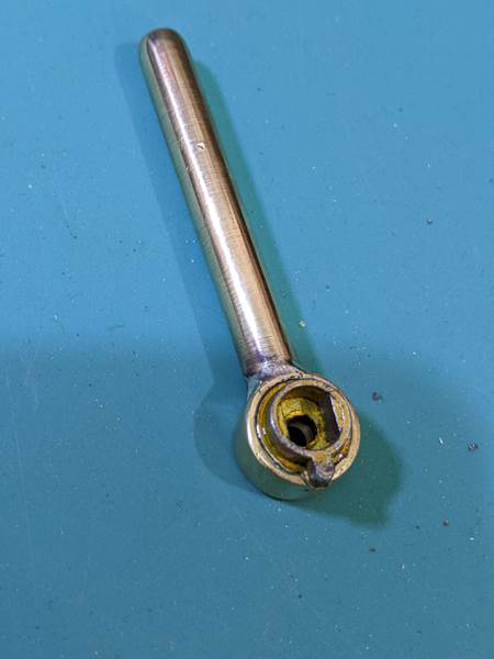

I put what was left of the actuating thing on the mandrel, chucked it up in the lathe and machined off pot metal until all that was left was a round cylinder above the part with the radially protuberant tit that limits rotation to 90 degrees. Then I machined a brass cap from a bit of 3/8” brass bar stock, making a lathe-bored cavity about 0.0015” smaller than the pot metal valve part. I silver-brazed a bit of ¼” rod to the brass cap to serve as an operating lever, and then I pressed them together in the Kurt mill vise that can exert at least a ton of force while keeping faces parallel. The part in the middle looks like brass but it isn’t; it’s brass-plated pot metal.

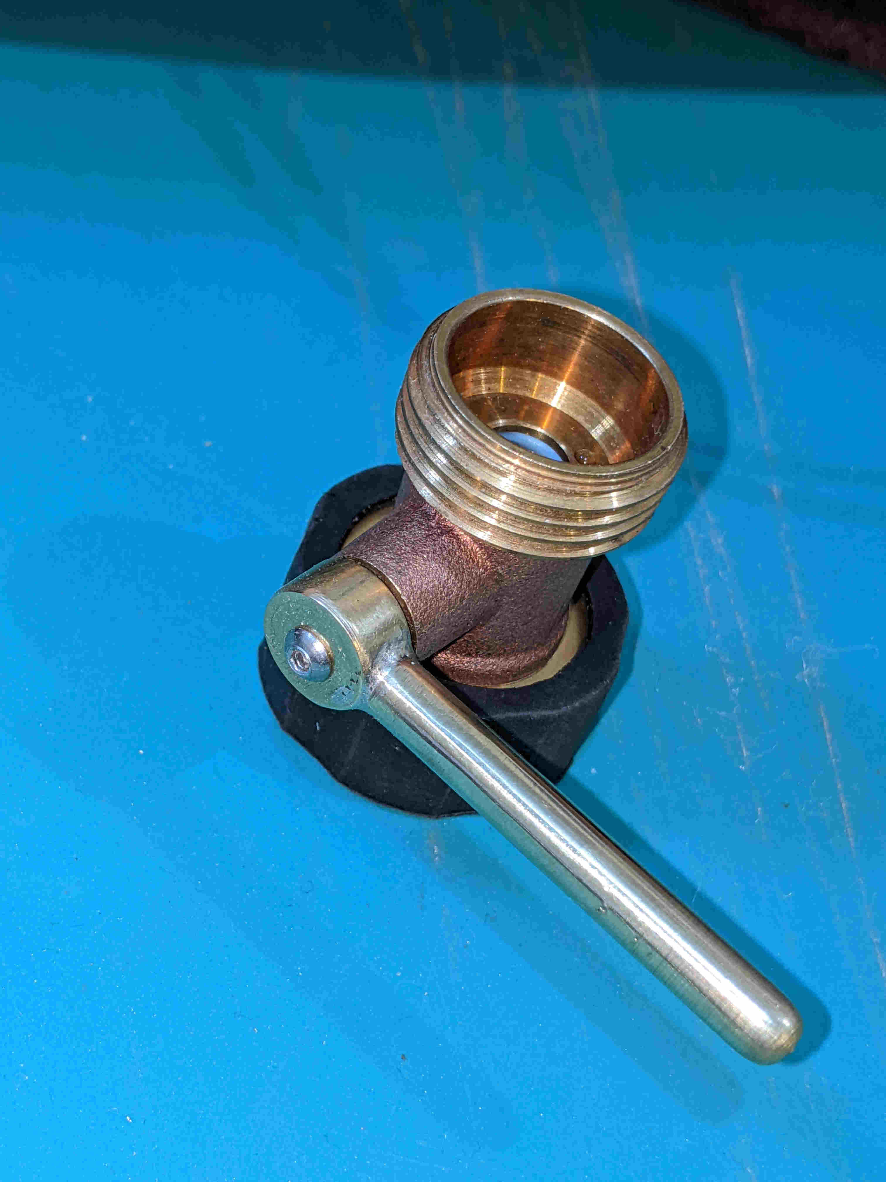

I reassembled it to the valve with a stainless M3 x 0.5 mm metric button-head machine screw and voila: ready to go to work hosing off the fish-cleaning table at da laaaake. It’s very easy to operate without getting hurty fingers. I hate getting hurty fingers.

The joint is just a butt joint. I made a concave curved face on the end of the rod with a ½” end mill, butted the brass parts together at the bench and silver-brazed them. The rod would bend before the joint would fail. A good silver-brazed joint can be stronger than the parent metal. And besides, ya can’t weld brass but silver brazing works very well.
