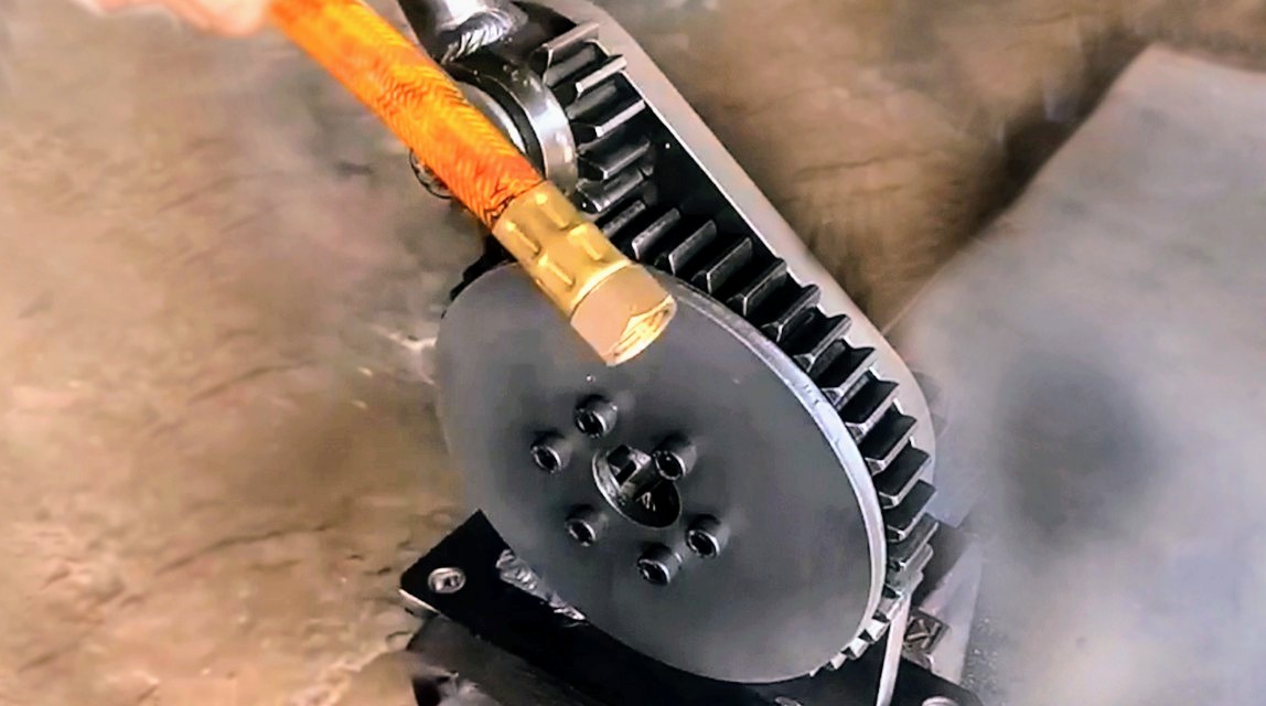

    How to make a Pipe end pressing machine at home
    Watch video for detail
    https://zalonvtn.blogspot.com/2022/05/blog-post.html
    Attached Thumbnails Attached Thumbnails How to make a Pipe end pressing machine at home-pipe-end-pressing-machine.jpg

    Well done, can I suggest a not so sharp point on the dies? Many/most/all internally reinforced hoses can be structurally damaged by point-loading, hydraulic hoses are an excellent example of this as are PTFE. Skives/sleeves need to hold the hose firm on the tube but not crush the hose. Do you have a stop fitted or go by feel?
    Loved the use of keysteel for the dies, leaves options open for cheap changes and sizes.
    Thanks for your suggestion. Somethings will be changed for next ones
