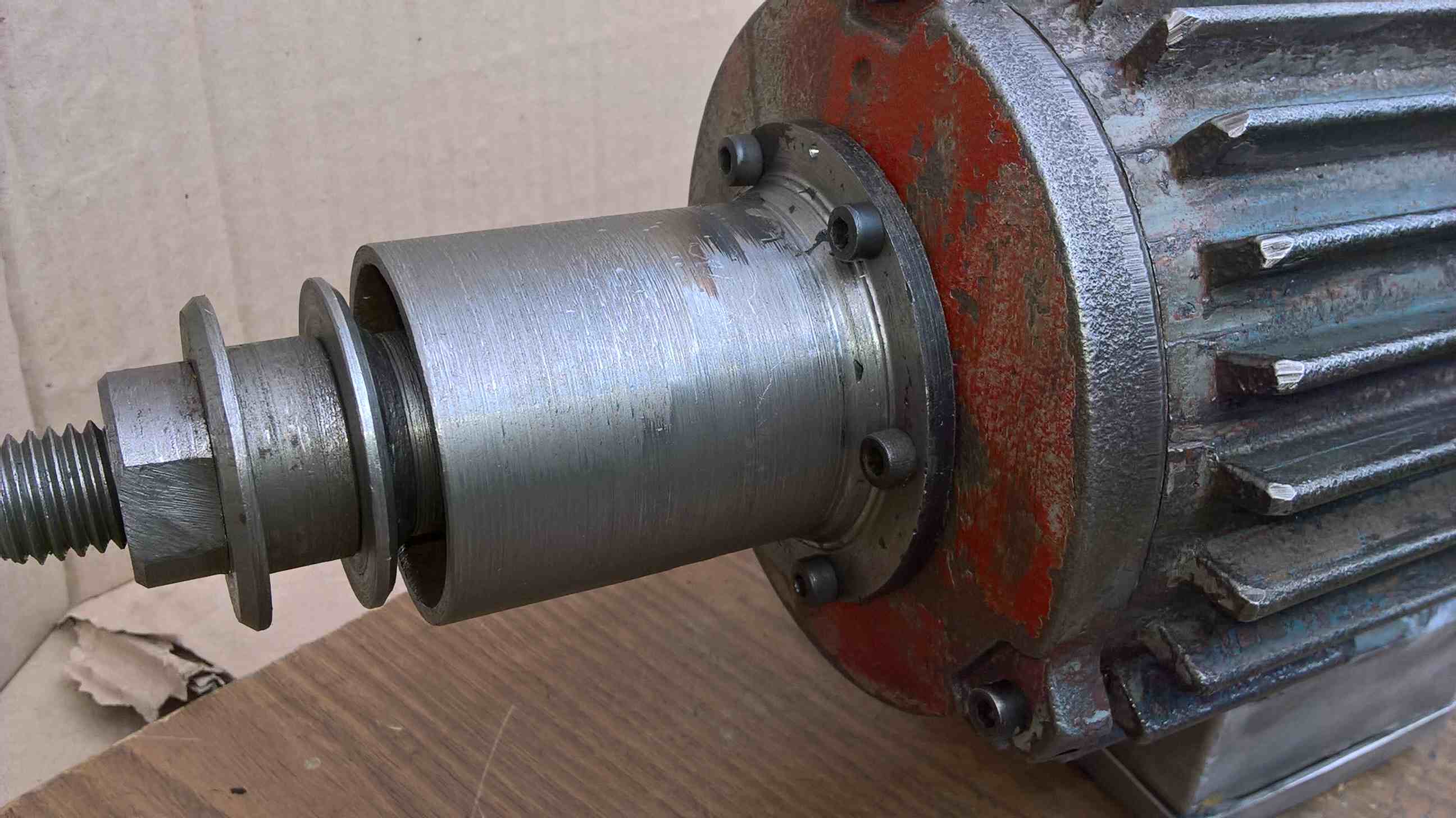

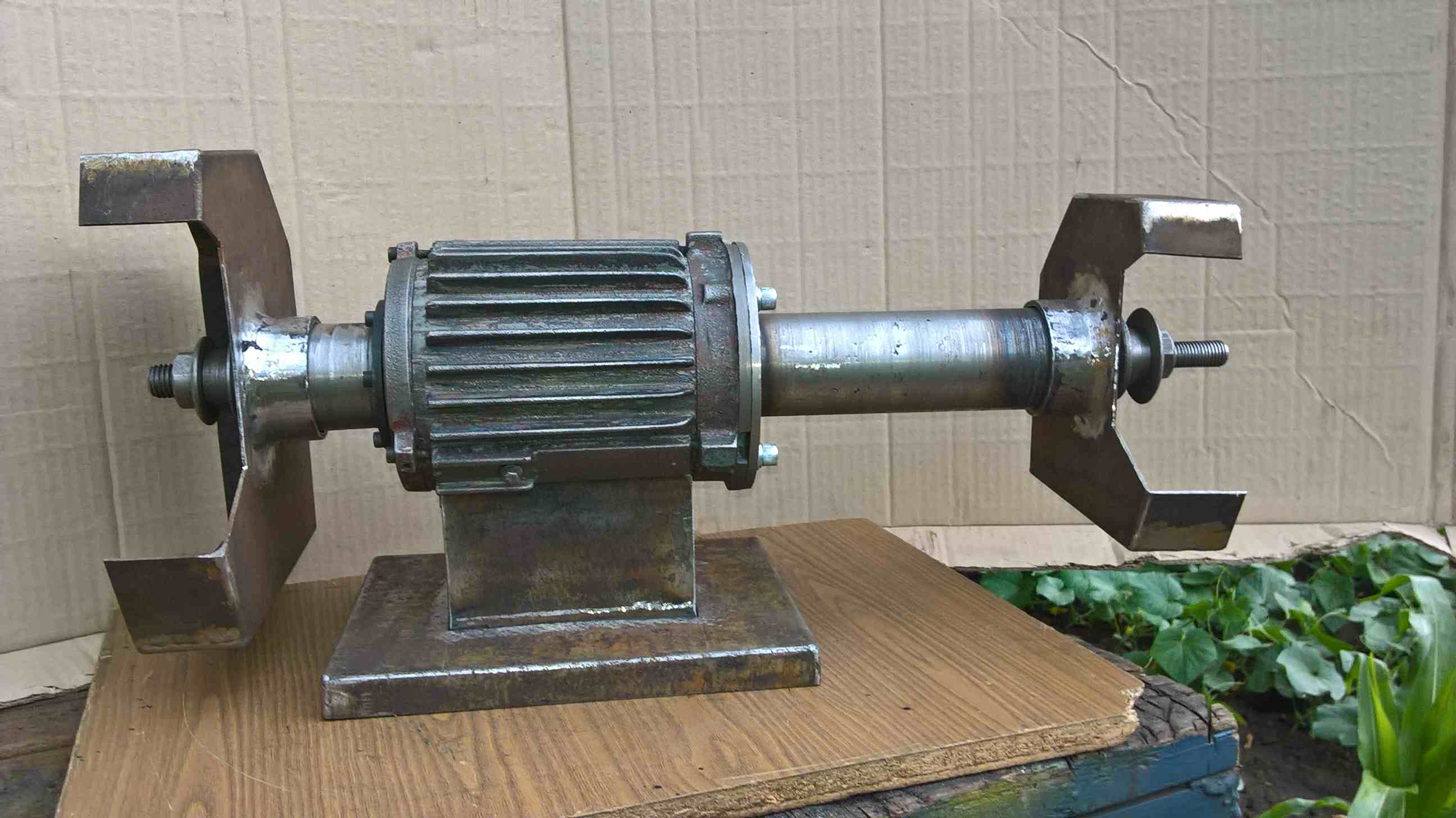

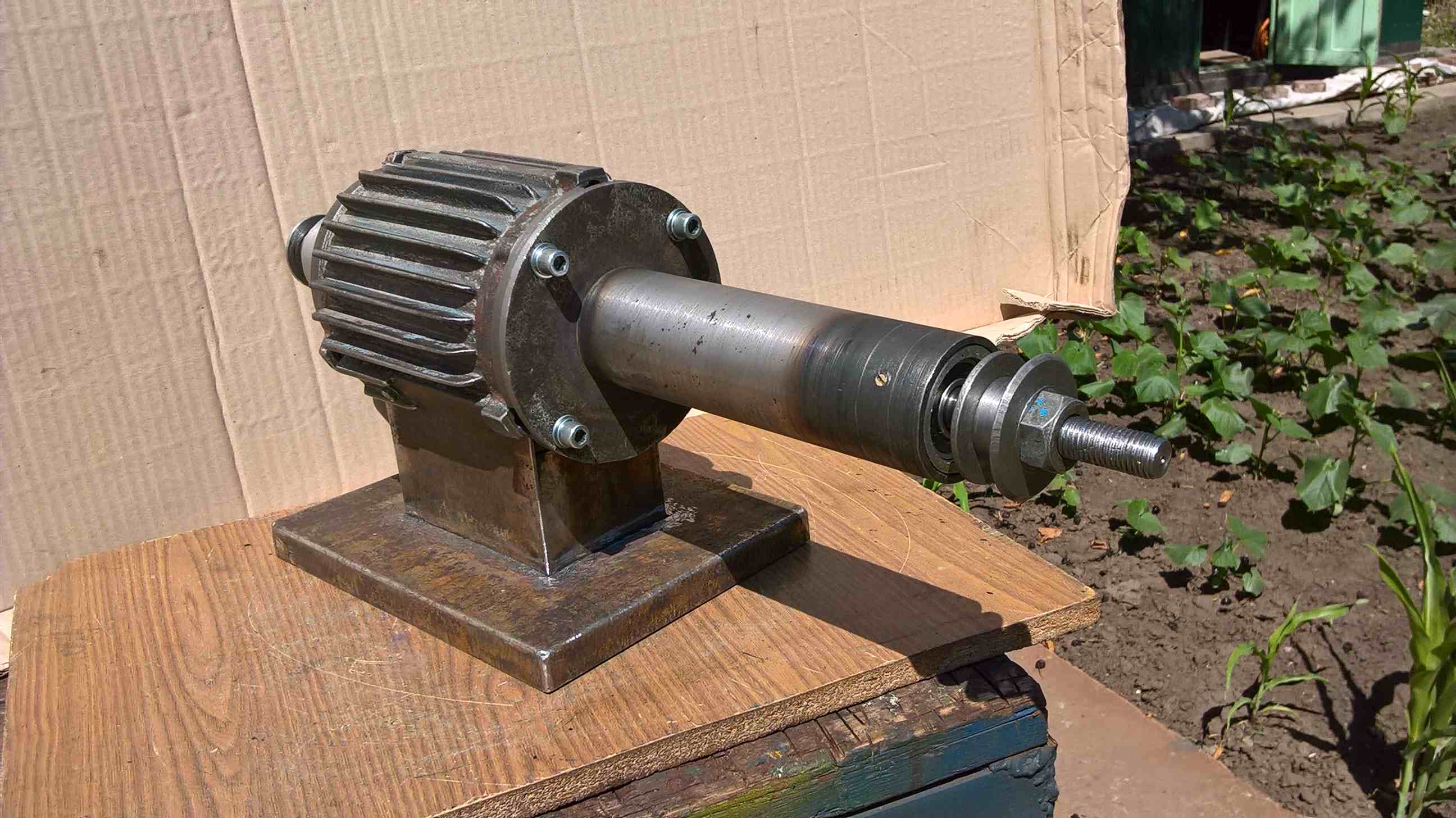

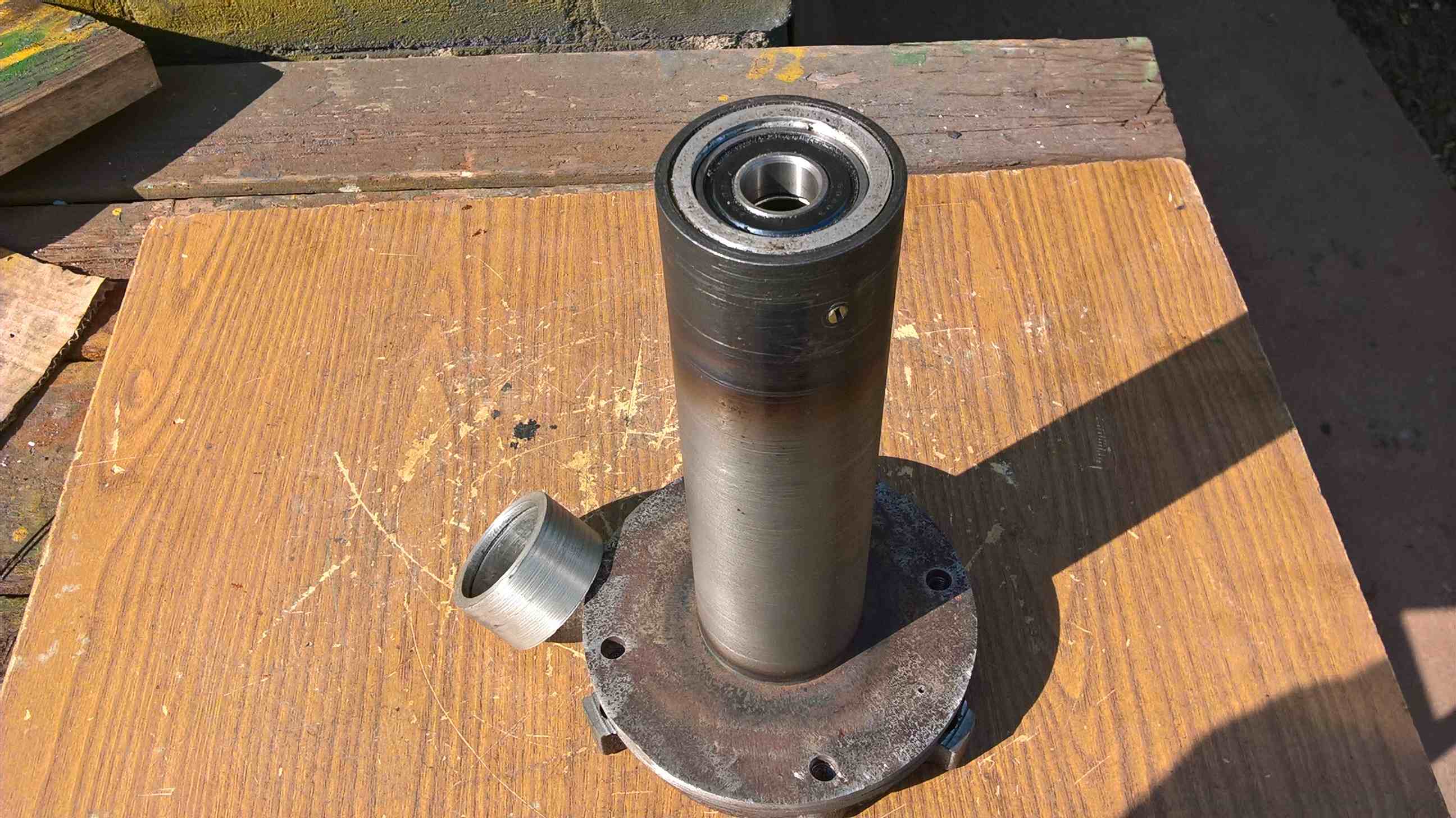

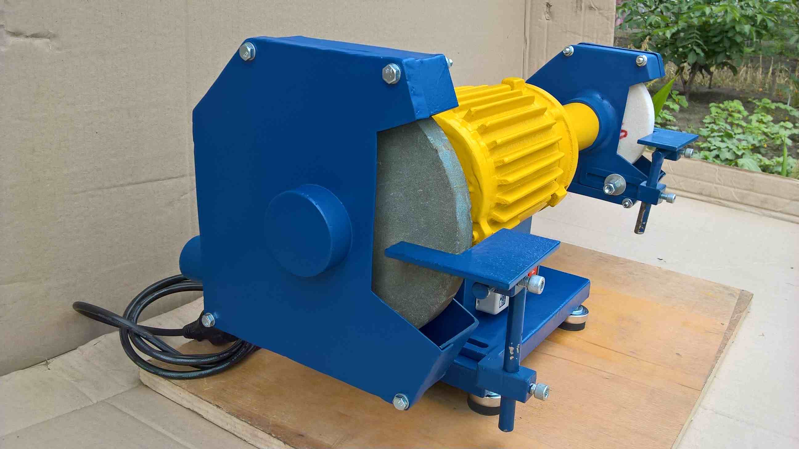

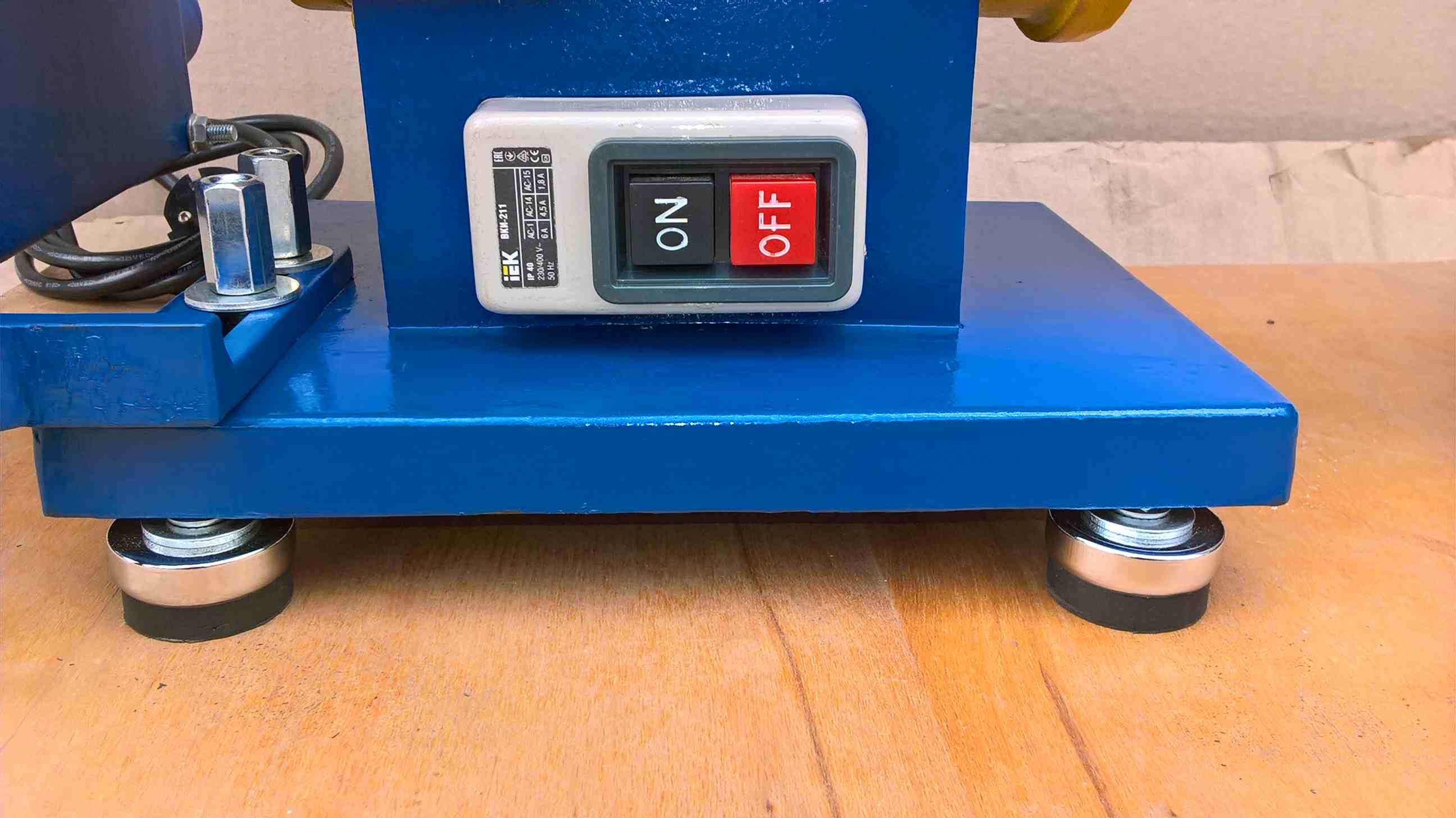

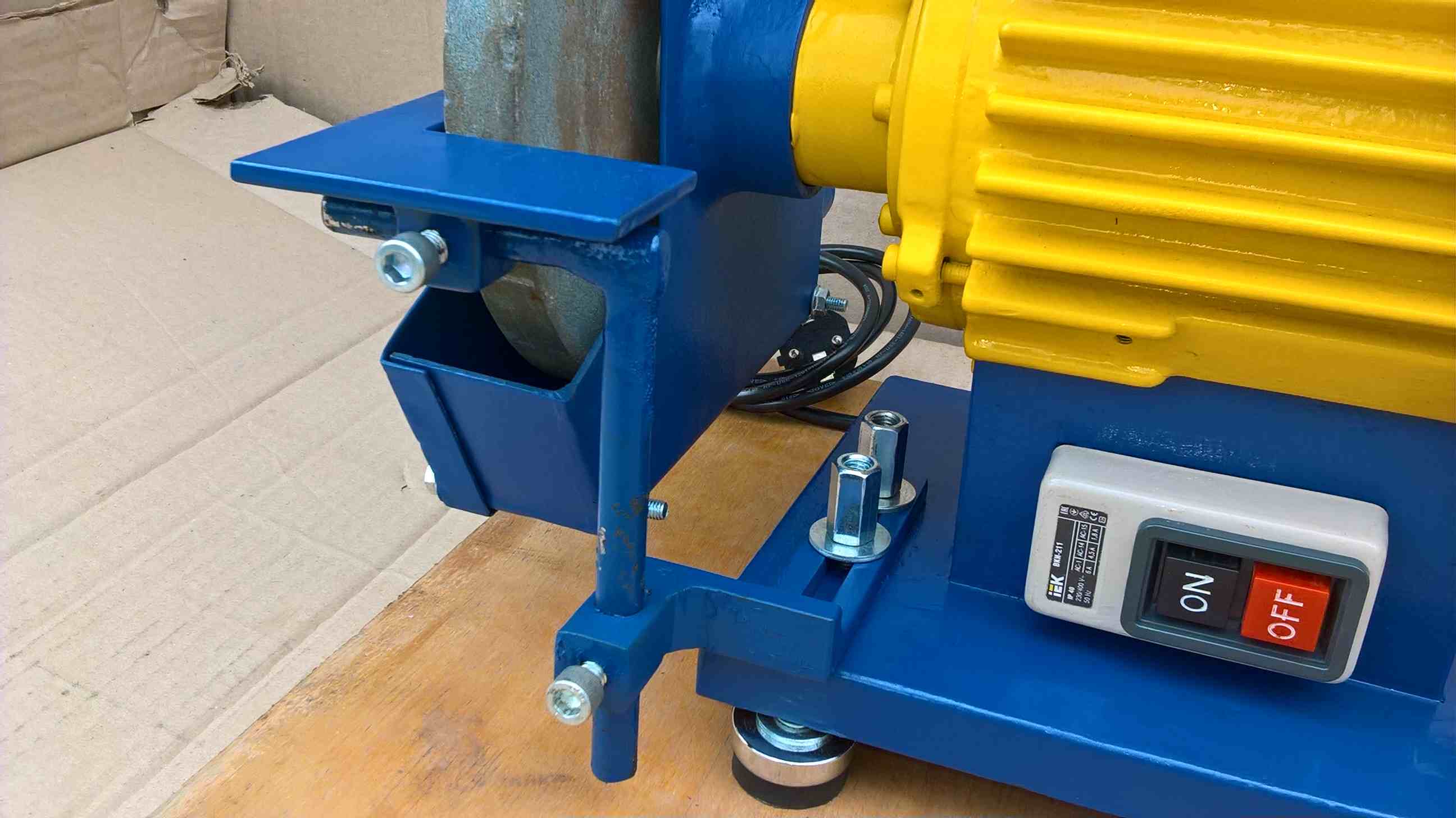

    I began to do this.
    I like to do bench grinders-bench-grinders-profi-_001.jpgI like to do bench grinders-bench-grinders-profi-_005.jpgI like to do bench grinders-bench-grinders-profi-_006.jpgI like to do bench grinders-profi-_001.jpgI like to do bench grinders-profi-_002.jpg

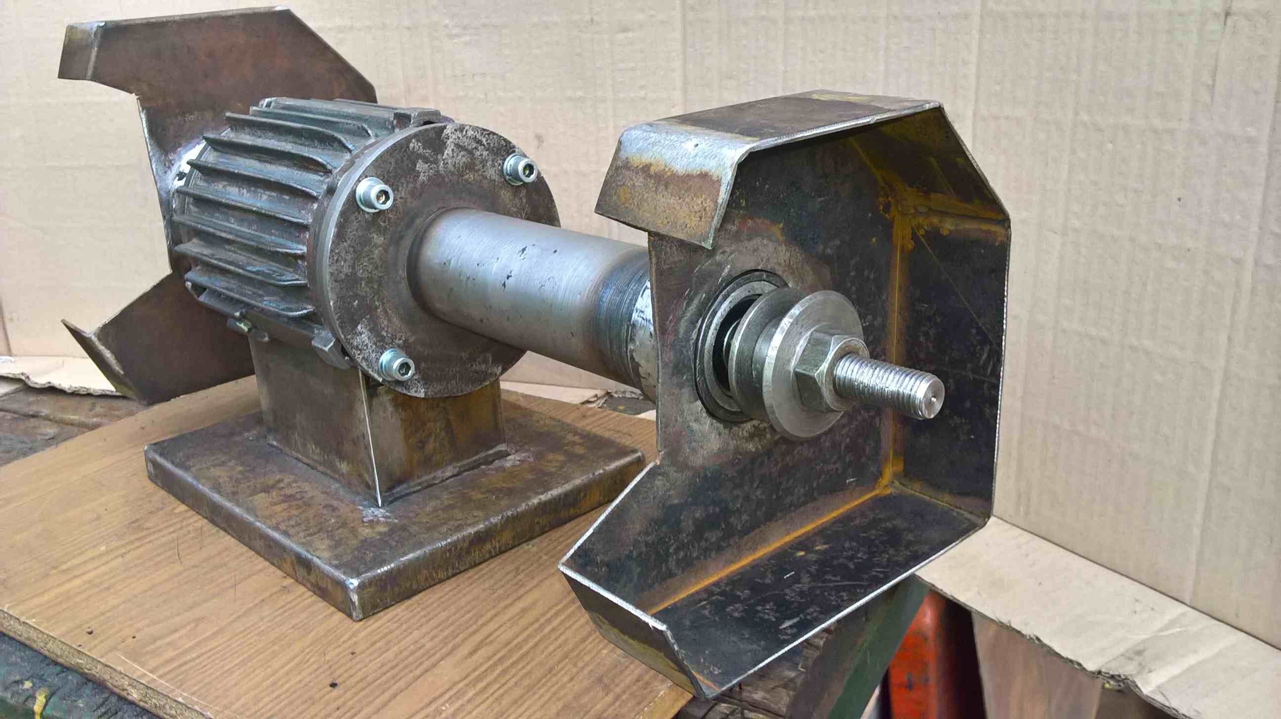

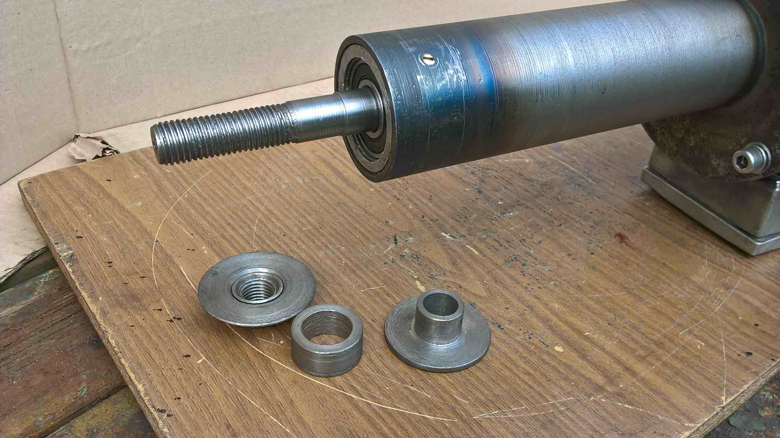

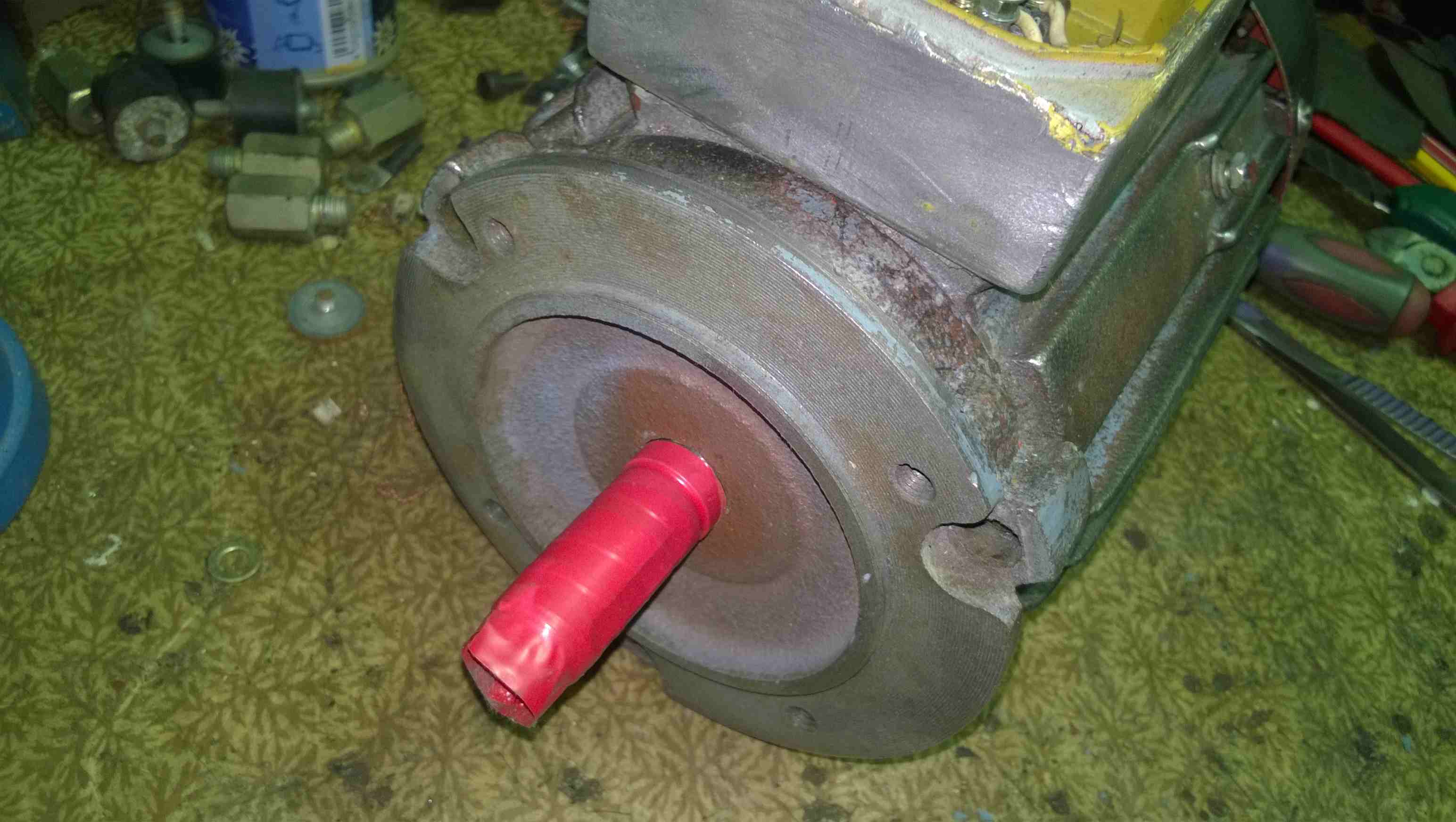

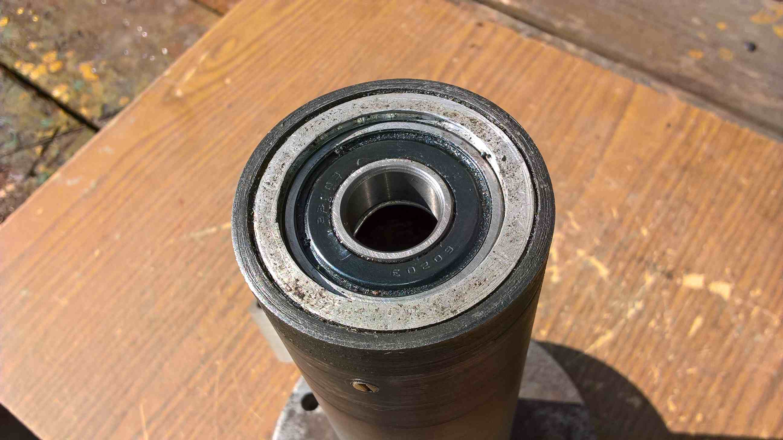

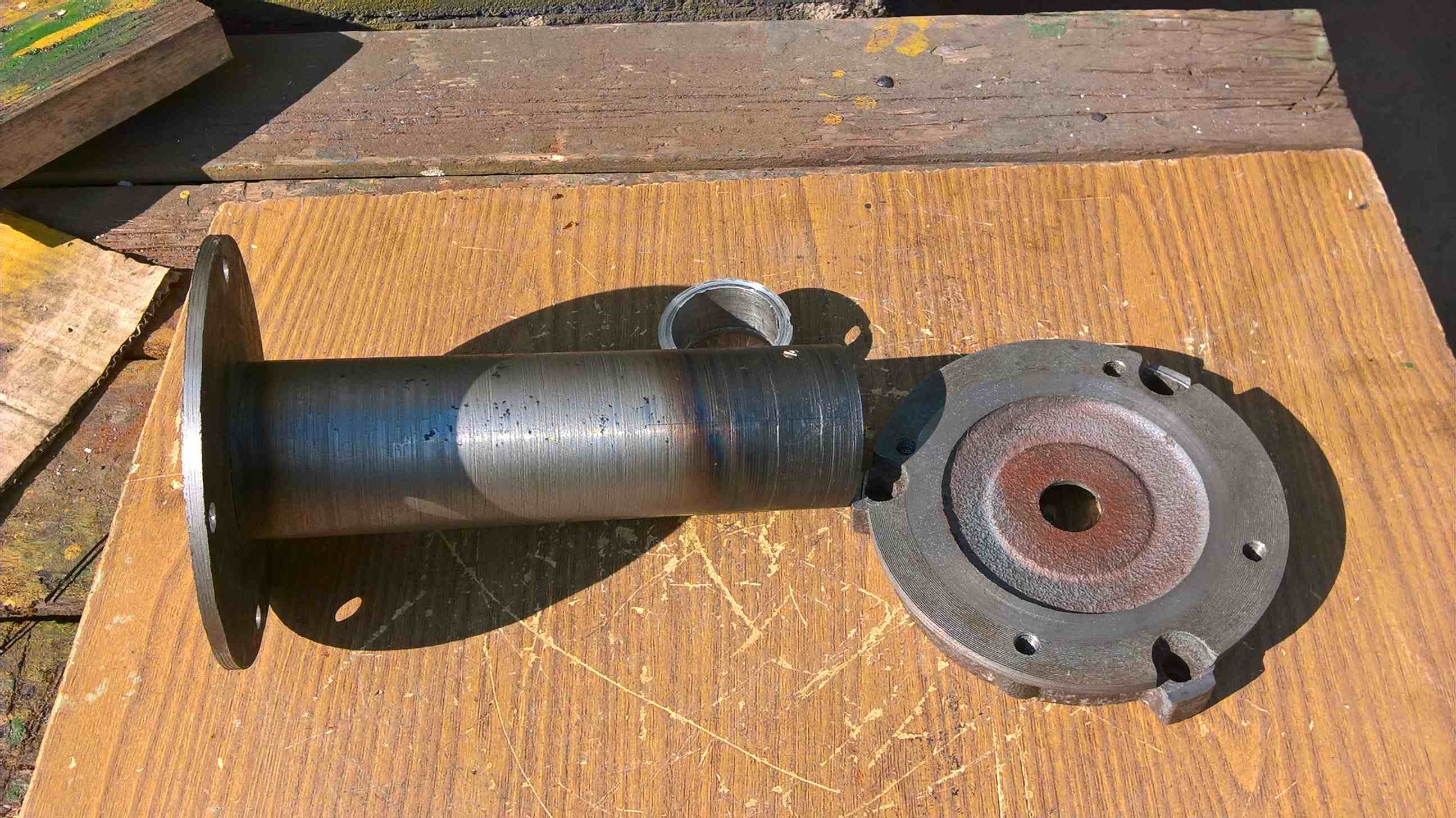

    Continuation of the photo.I like to do bench grinders-profi-_004.jpgI like to do bench grinders-profi-_019.jpgI like to do bench grinders-profi-_049.jpgI like to do bench grinders-profi-_054.jpgI like to do bench grinders-profi-_066.jpgI like to do bench grinders-profi-_092.jpgI like to do bench grinders-bench-grinders-_-profi-_009.jpg

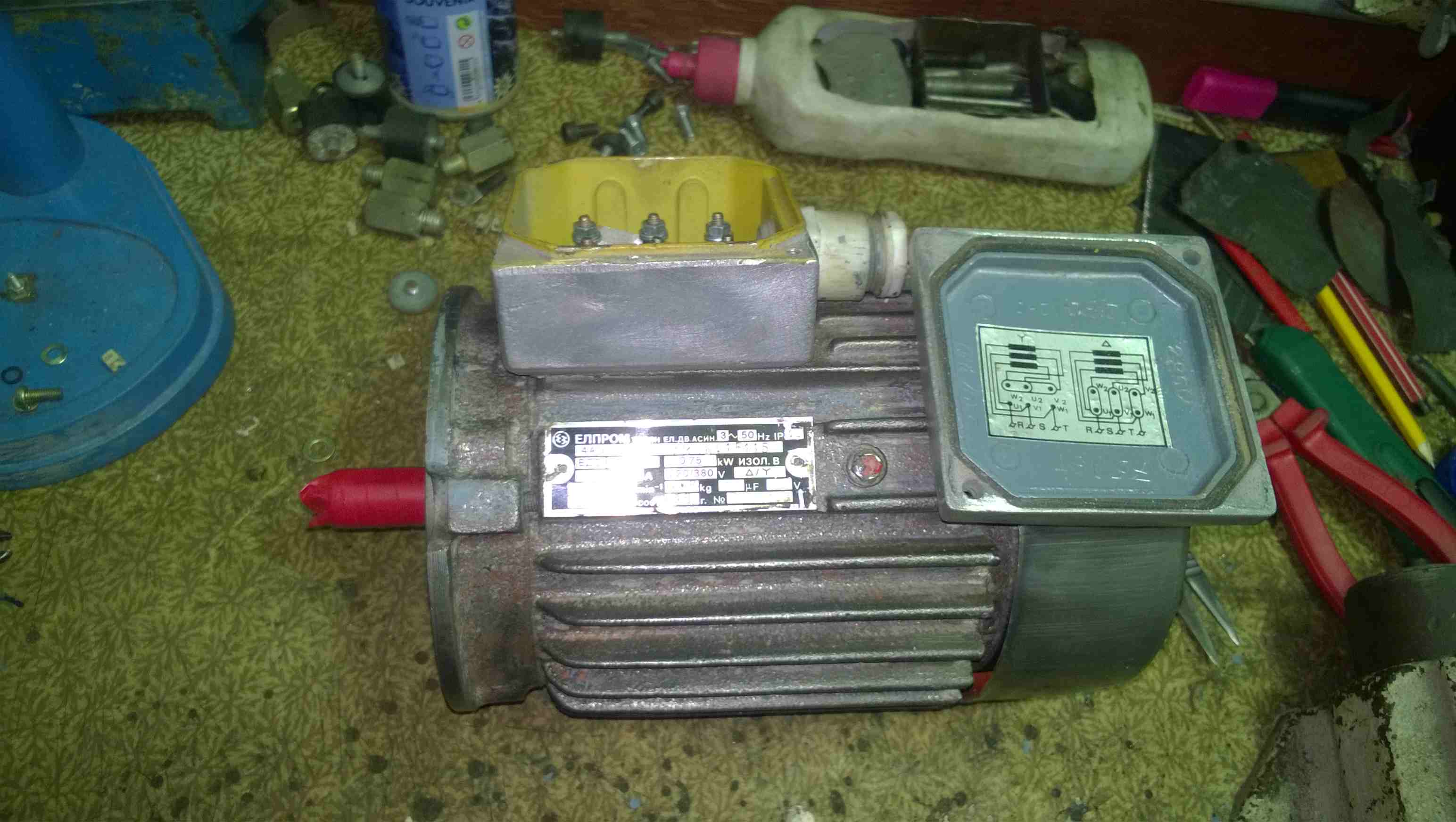

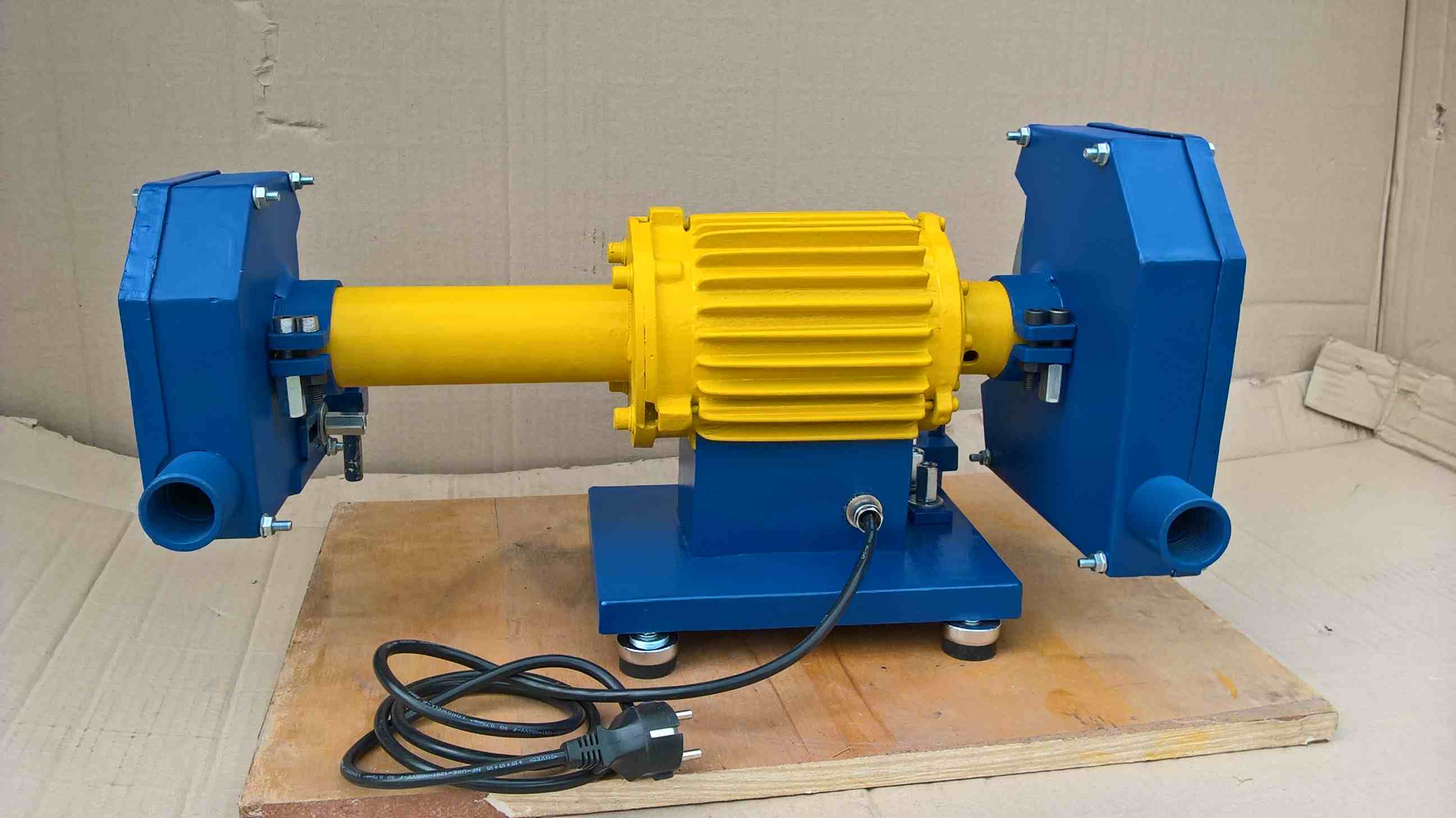

    ComplementaryI like to do bench grinders-bench-grinders-_-profi-_033.jpgI like to do bench grinders-bench-grinders-_-profi-_024.jpgI like to do bench grinders-bench-grinders-_-profi-_030.jpg

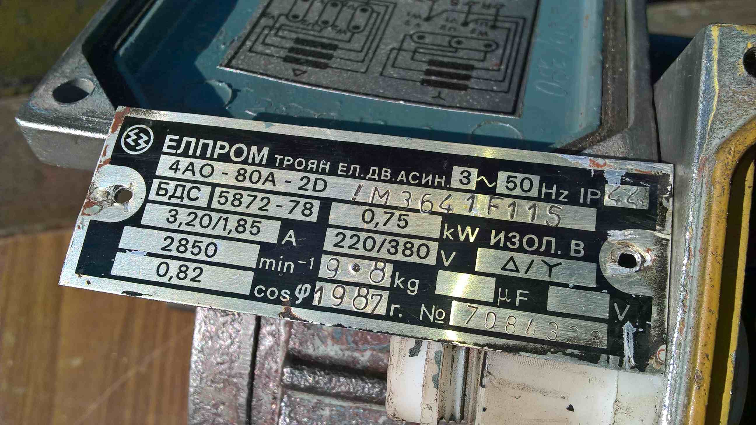

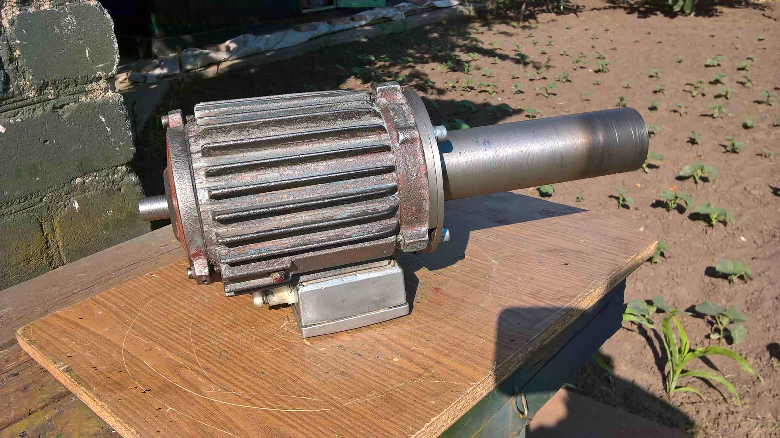

    That motor case looks very strong. Is the electrical voltage 220 volts where you live? In the US we have 120 volts for most of our electrical needs and very little 220 volts for home use. It would be nice if our country went to an all 220 volts systems. When I was an industrial mechanic, I worked mainly on 220 volts and 440 three phase voltage. I prefer 220 volts.

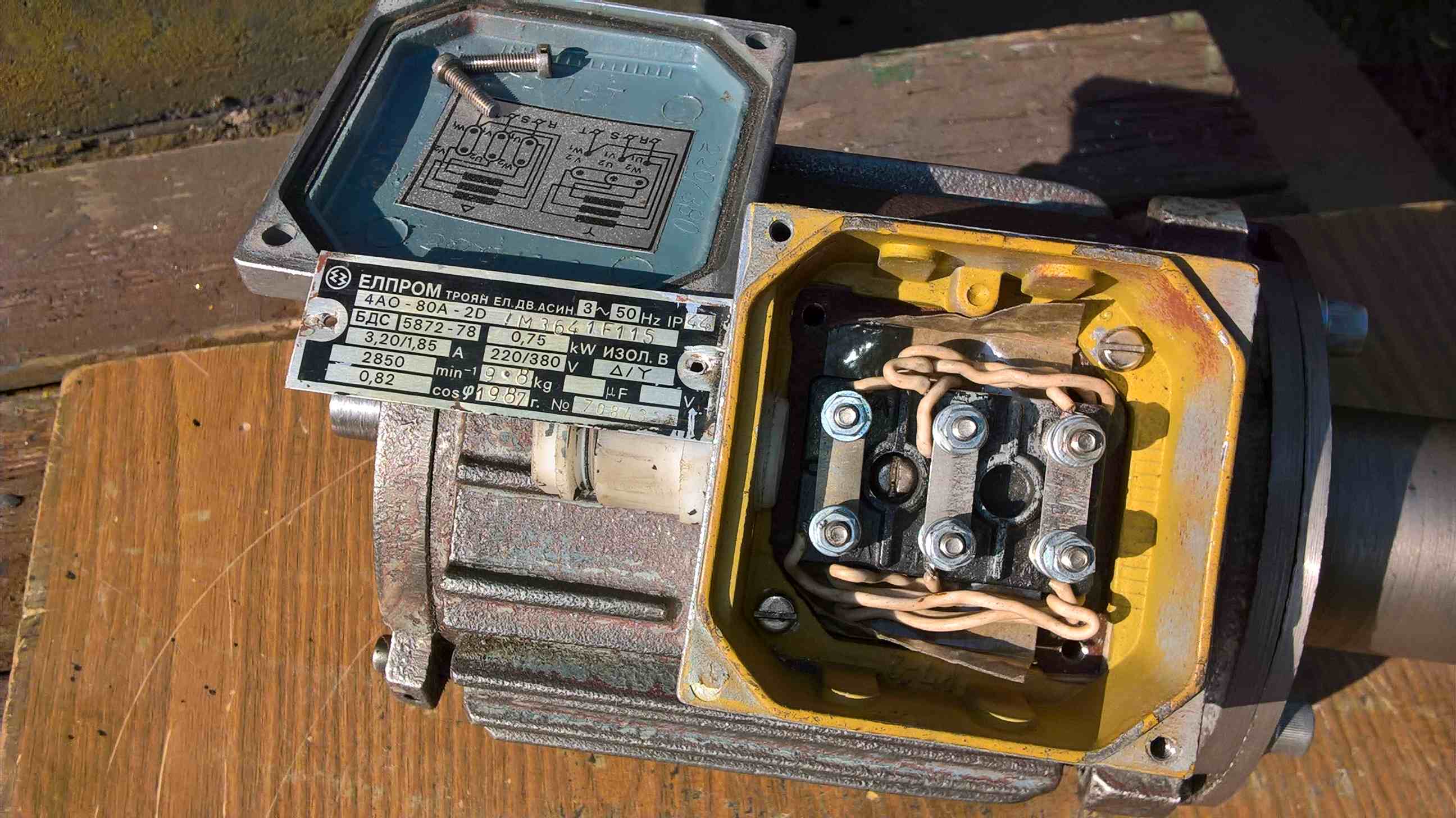

    I live in Ukraine in the city of Krivoi Rog.
    We have a domestic voltage of 220 volts one phase.
    In production in the industry, mainly 380 volts, three phases.
    This is an industrial electric motor.
    I will connect it to the 220 volts network at the bottom of the phase through the capacitor.

    This electric motor.I like to do bench grinders-107.jpgI like to do bench grinders-107.jpg

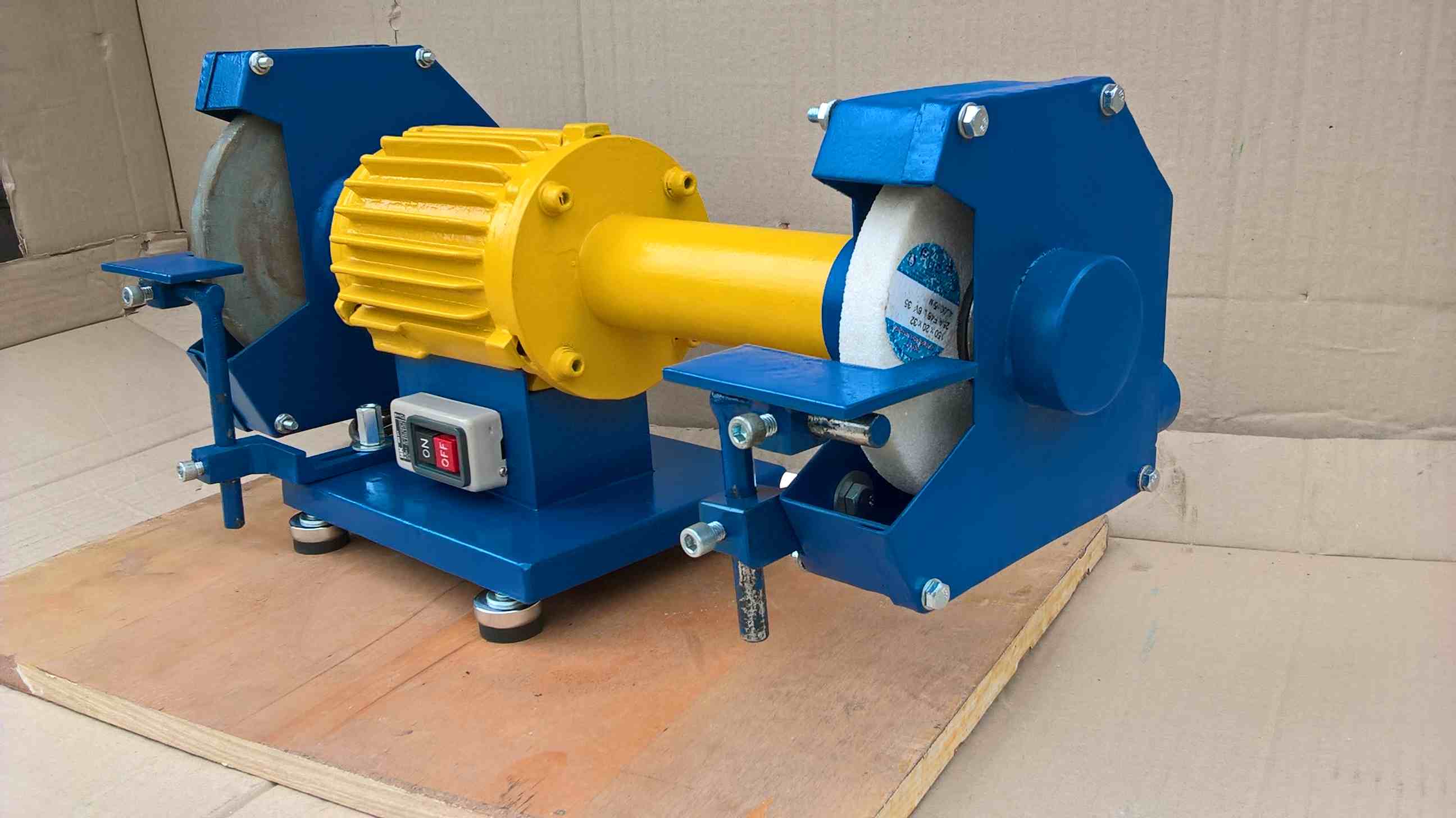

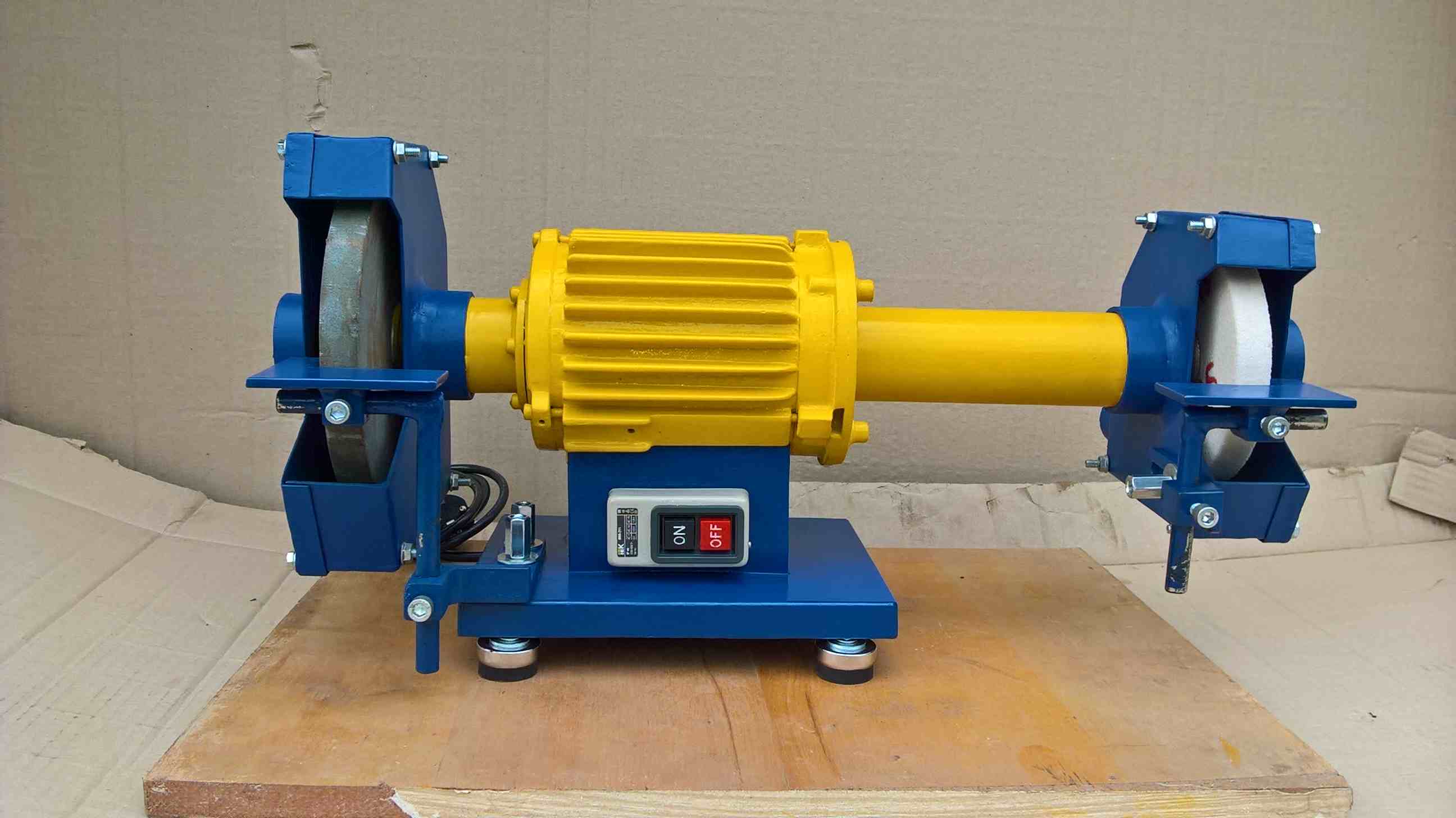

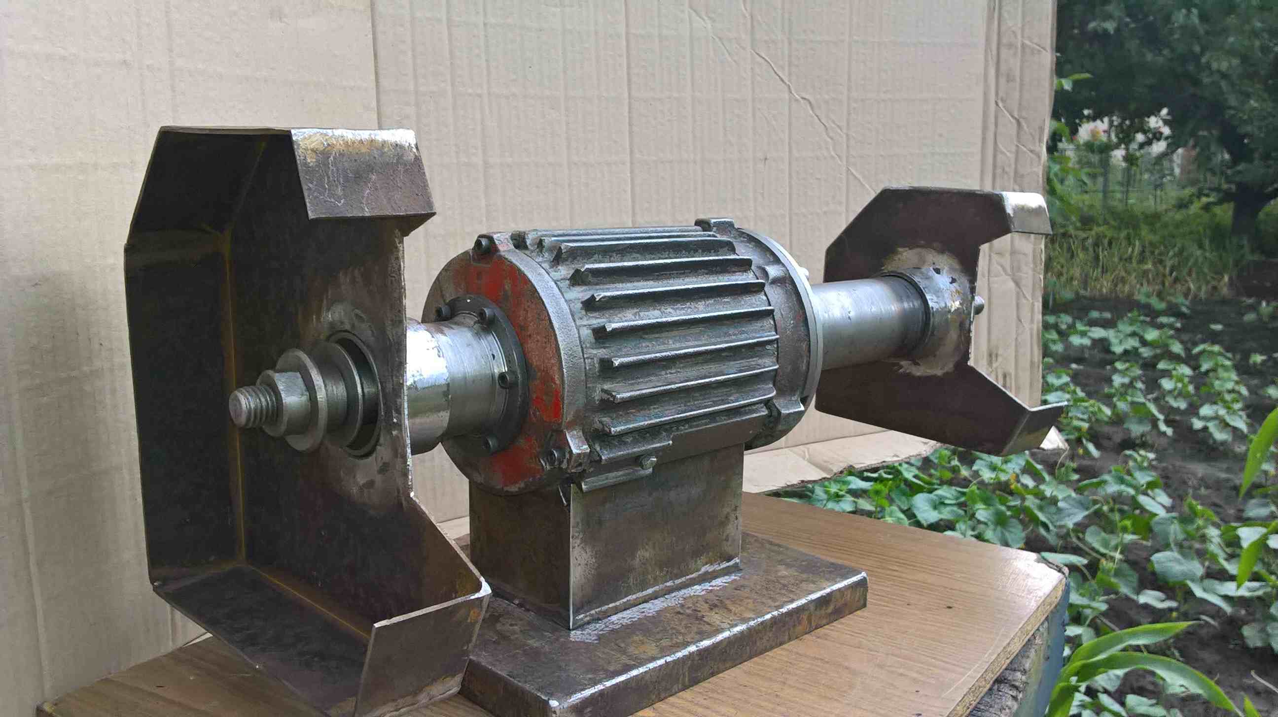

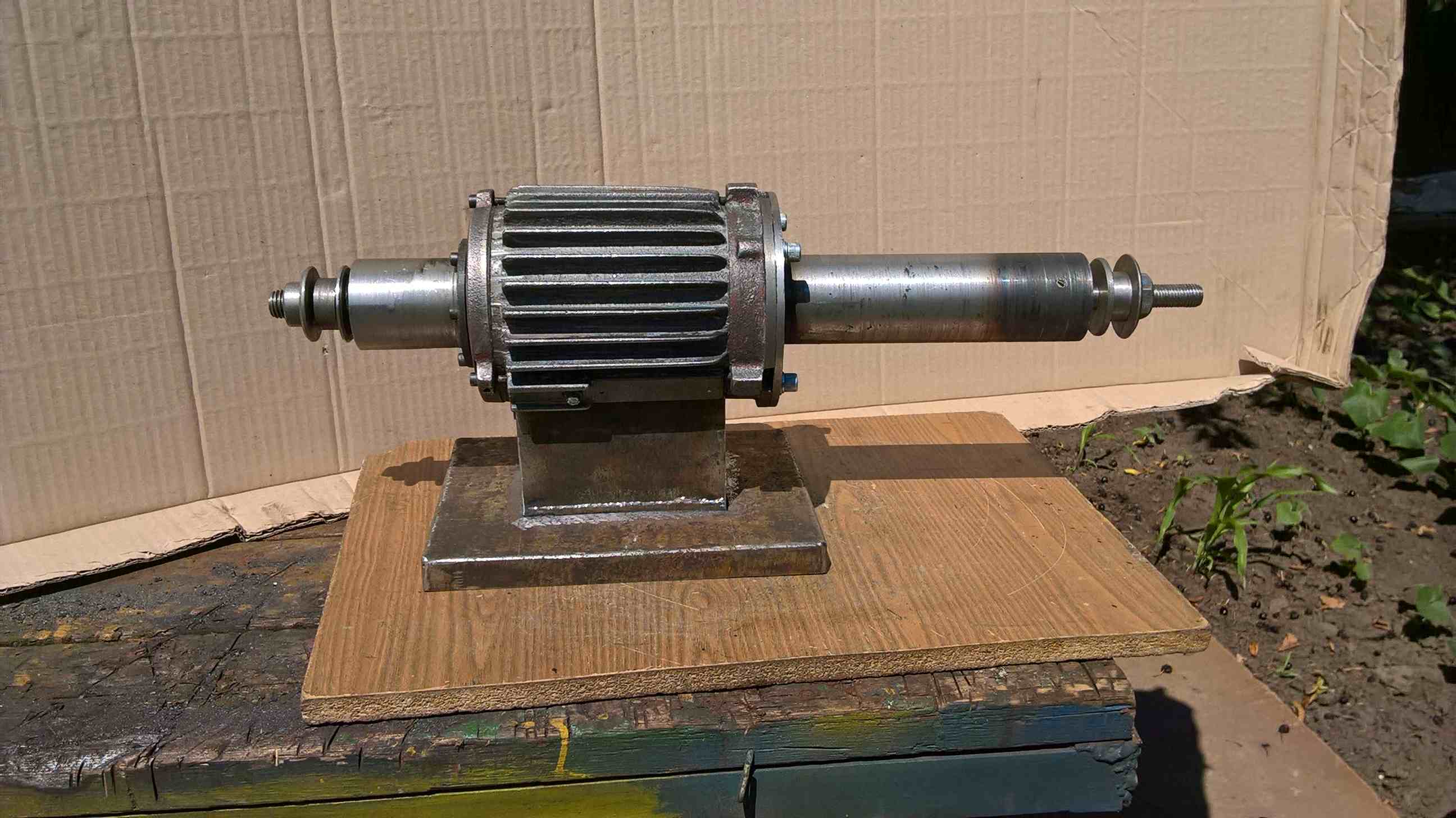

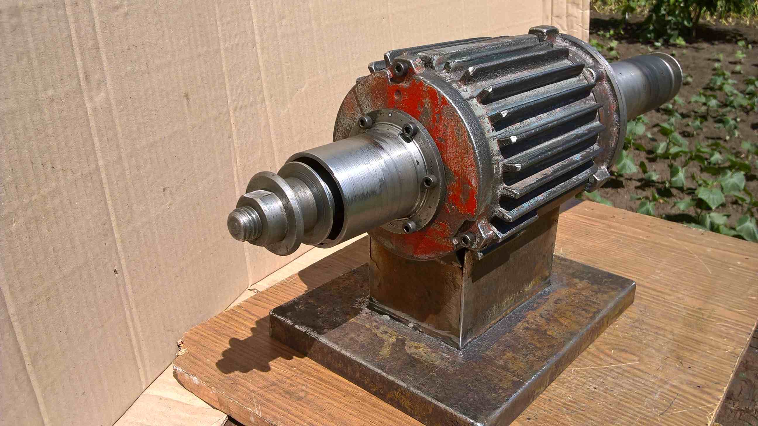

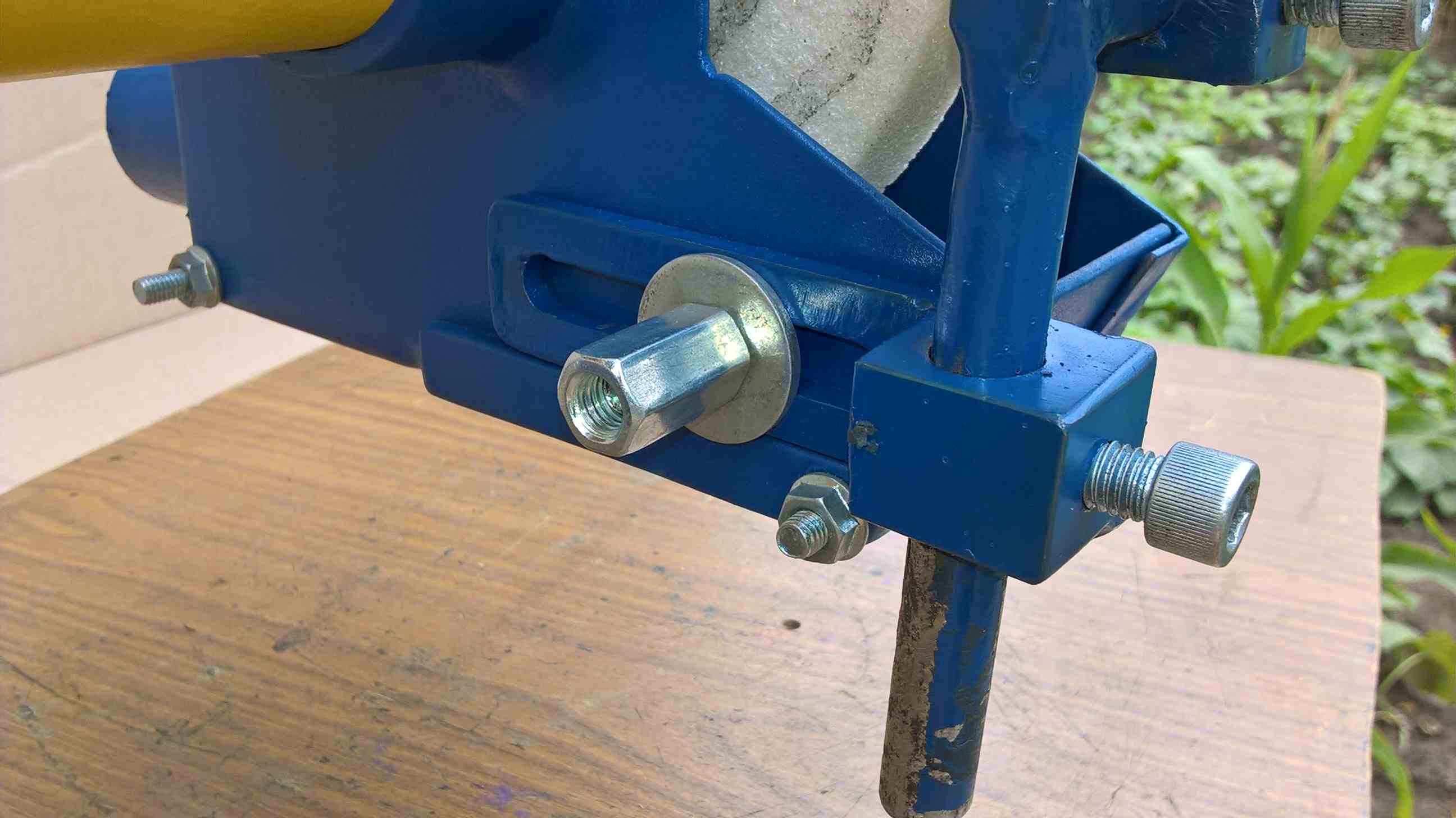

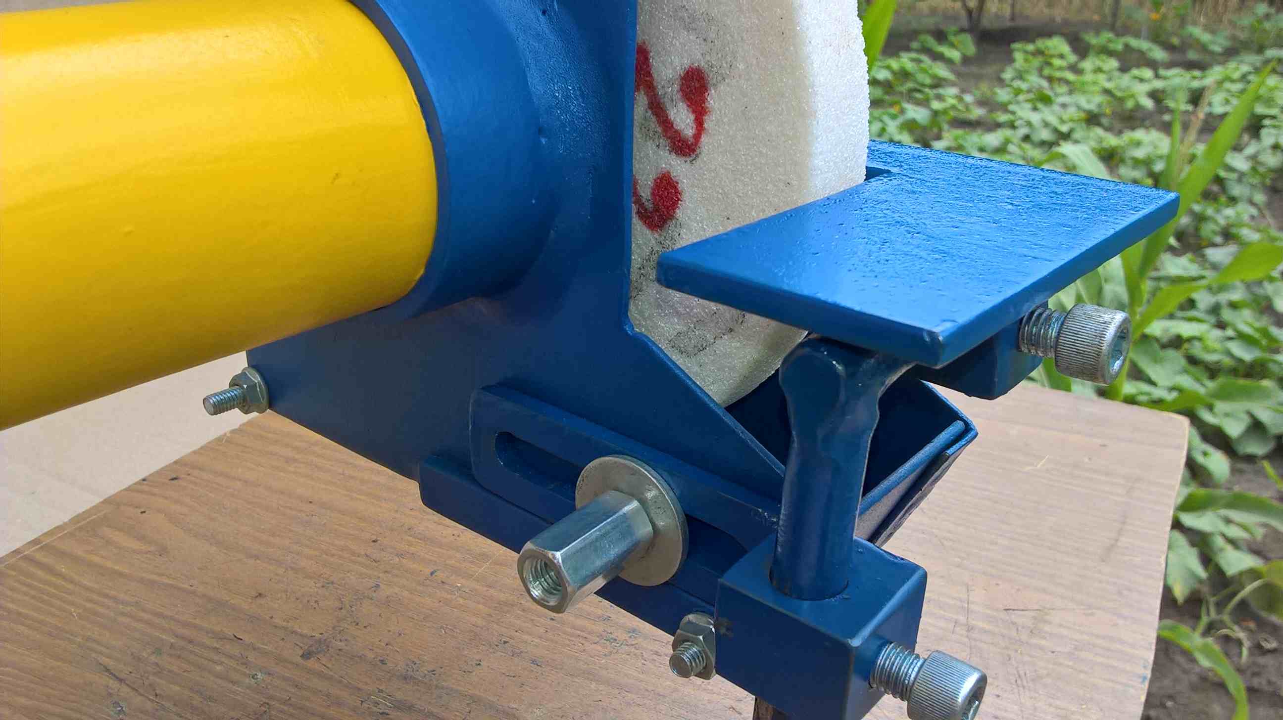

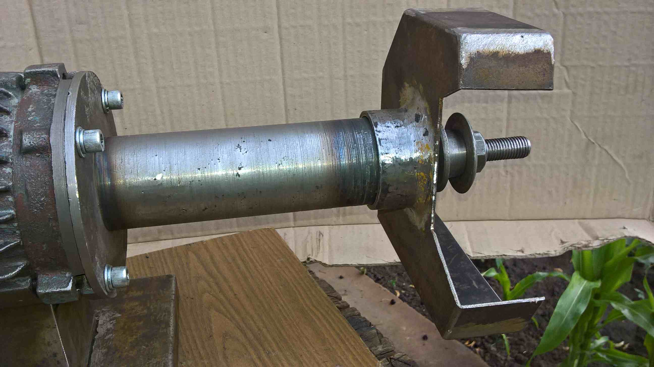

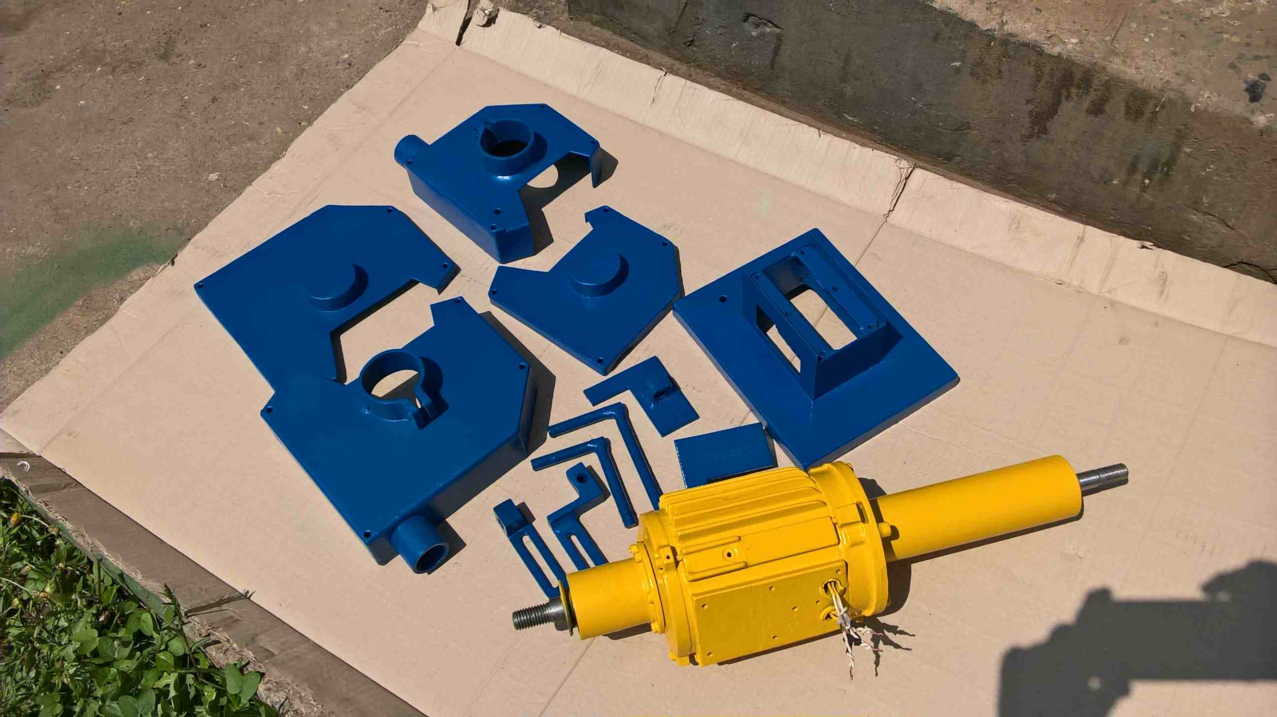

    Continuation and final.I like to do bench grinders-2_-bench-grinder-profi-_079.jpgI like to do bench grinders-2_-bench-grinder-profi-_003.jpgI like to do bench grinders-2_-bench-grinder-profi-_045.jpgI like to do bench grinders-2_-bench-grinder-profi-_022.jpgI like to do bench grinders-2_-bench-grinder-profi-_024.jpgI like to do bench grinders-2_-bench-grinder-profi-_019.jpgI like to do bench grinders-2_-bench-grinder-profi-_041.jpgI like to do bench grinders-22_-bench-grinder-profi-_027.jpgI like to do bench grinders-22_-bench-grinder-profi-_028.jpg
