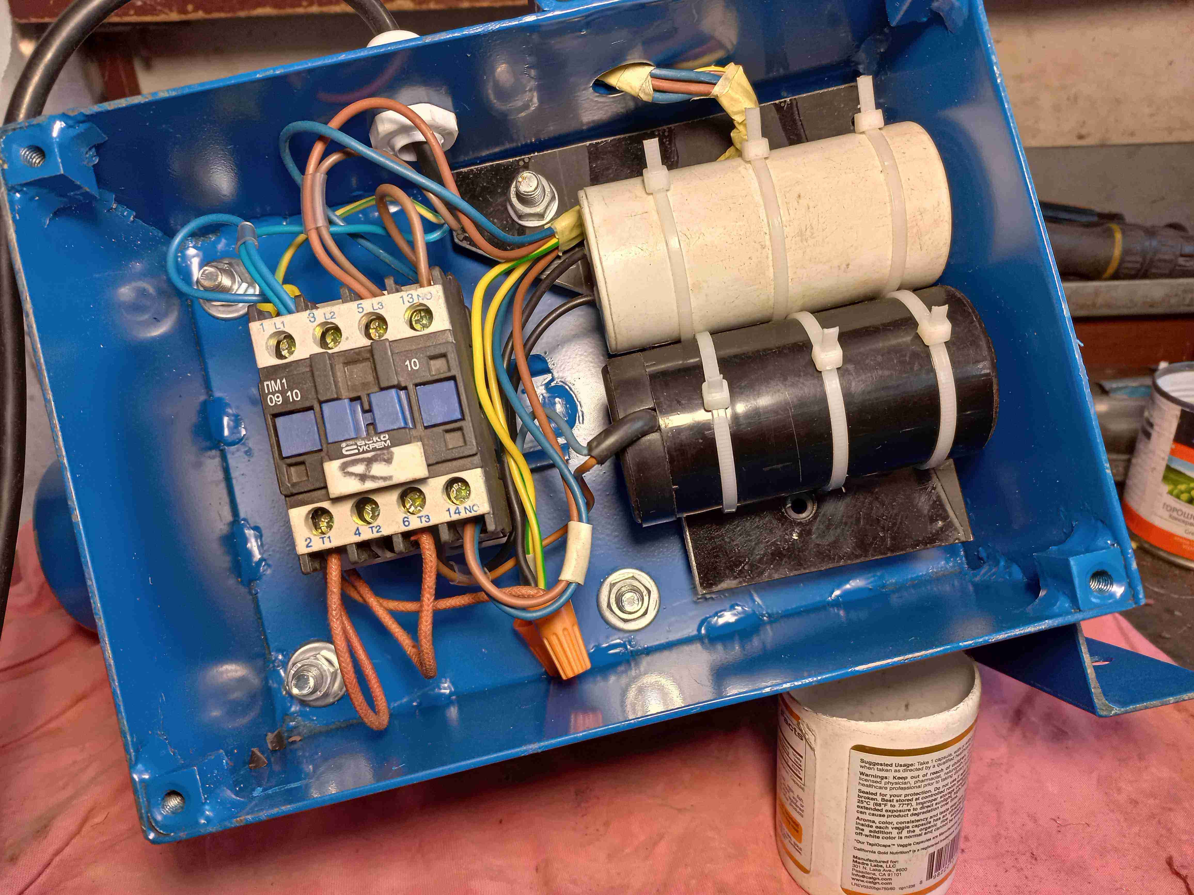

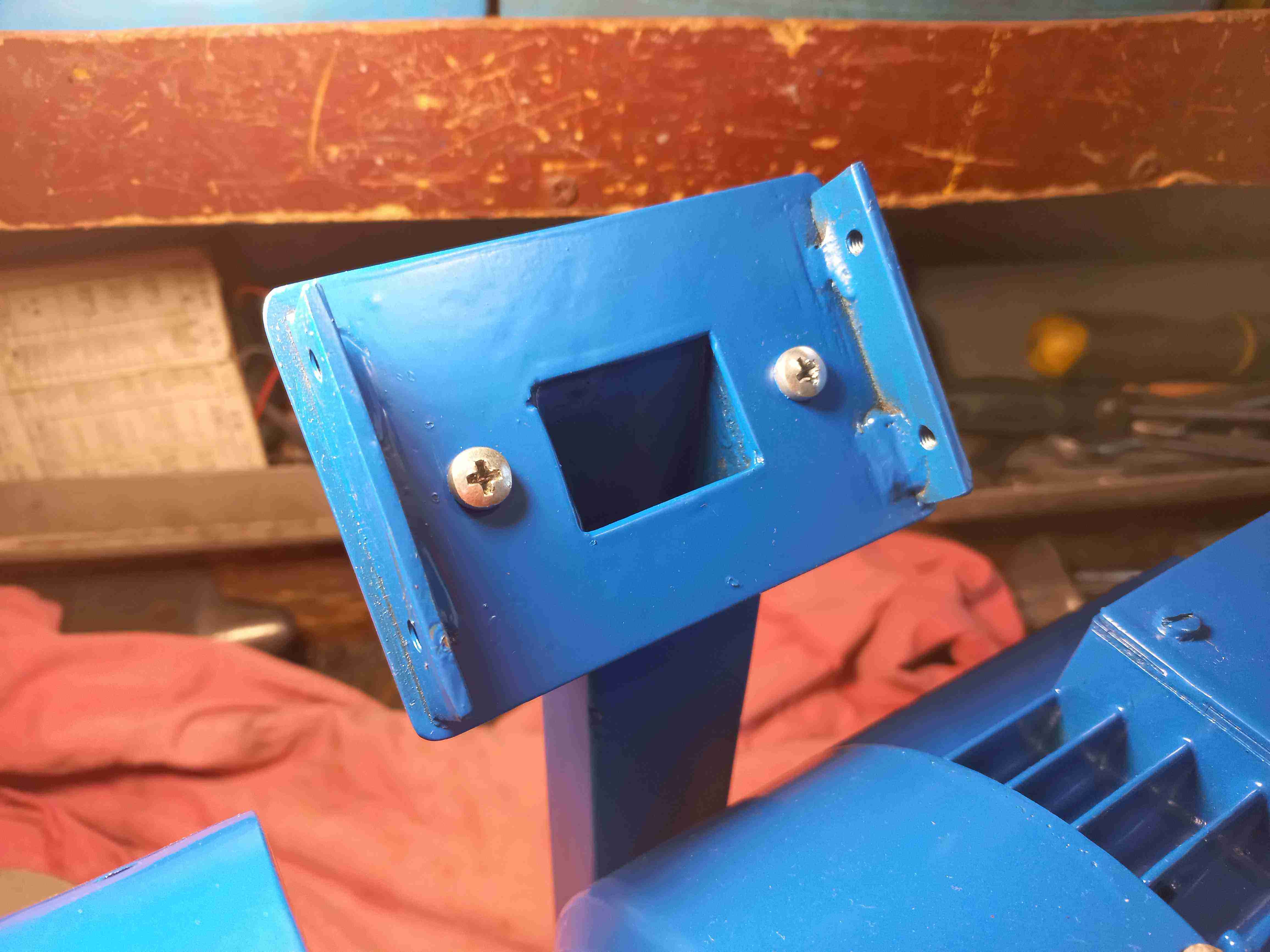

    Attached Thumbnails Attached Thumbnails I like to do bench grinders-_-foto-_-091.jpg   I like to do bench grinders-_-foto-_-135.jpg

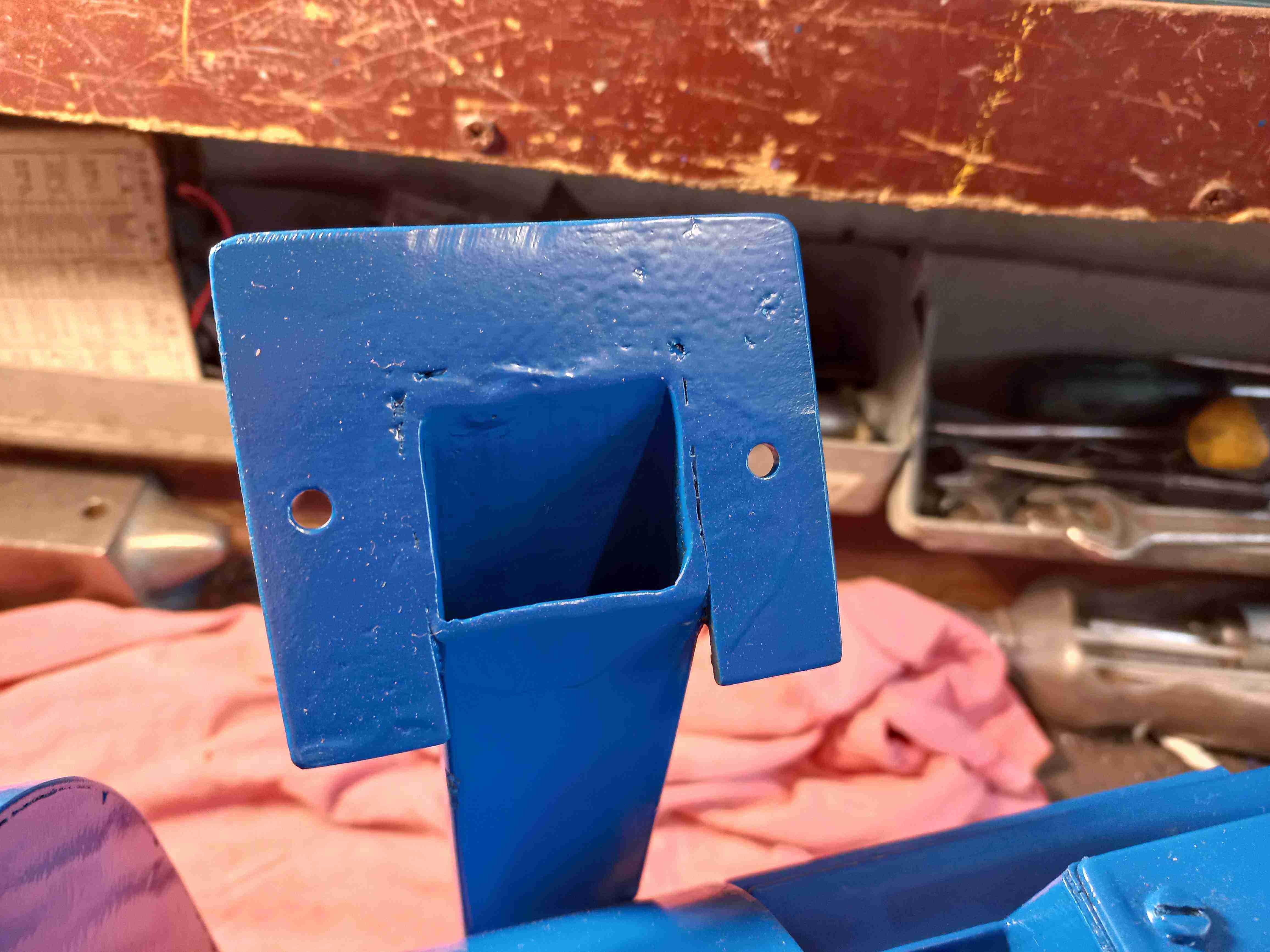

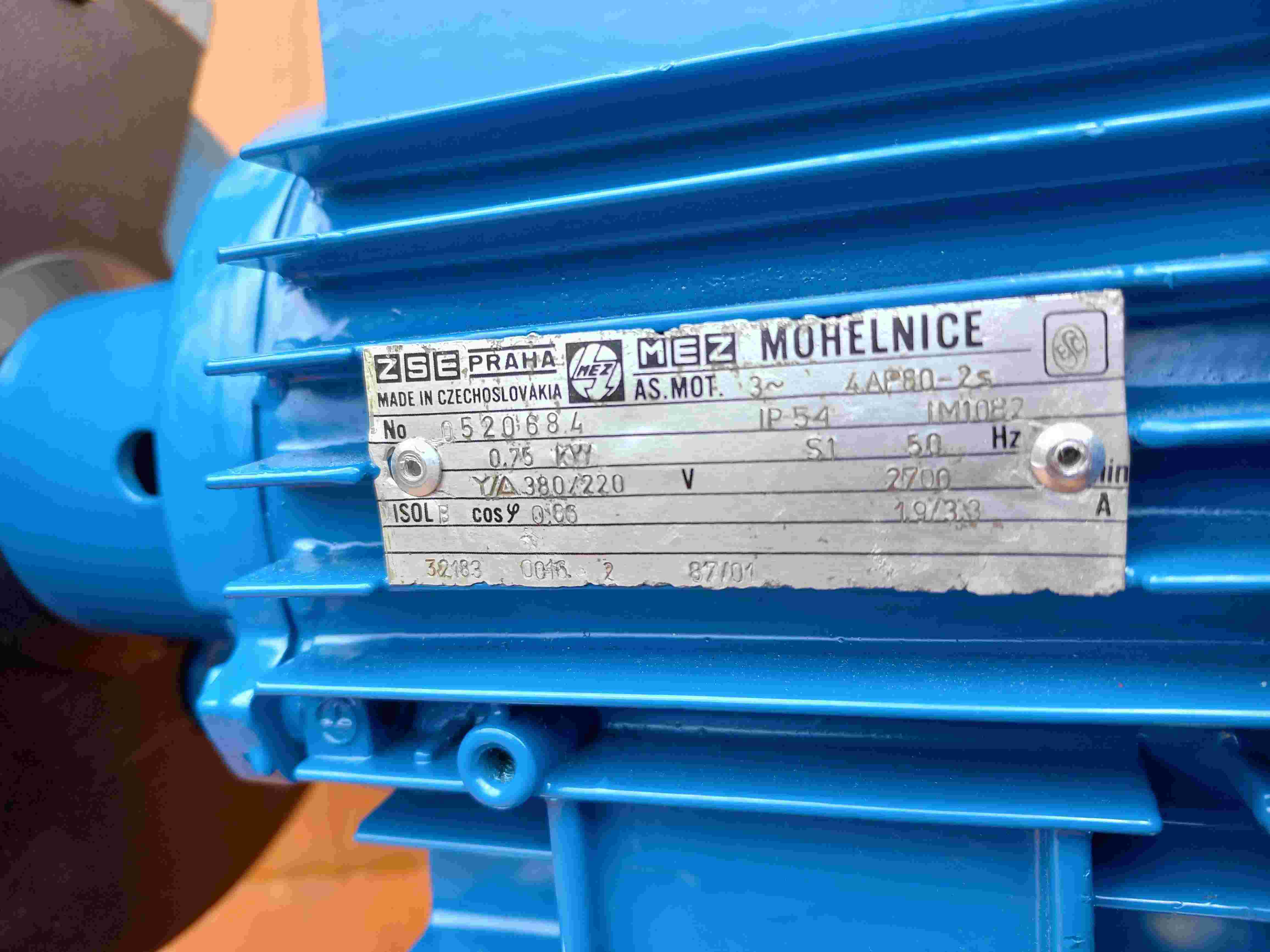

    I like to do bench grinders-2-_-021.jpgI like to do bench grinders-2-_-023.jpgI like to do bench grinders-1.jpgI like to do bench grinders-1.jpgI like to do bench grinders-1.jpgI like to do bench grinders-1.jpgI like to do bench grinders-1.jpg

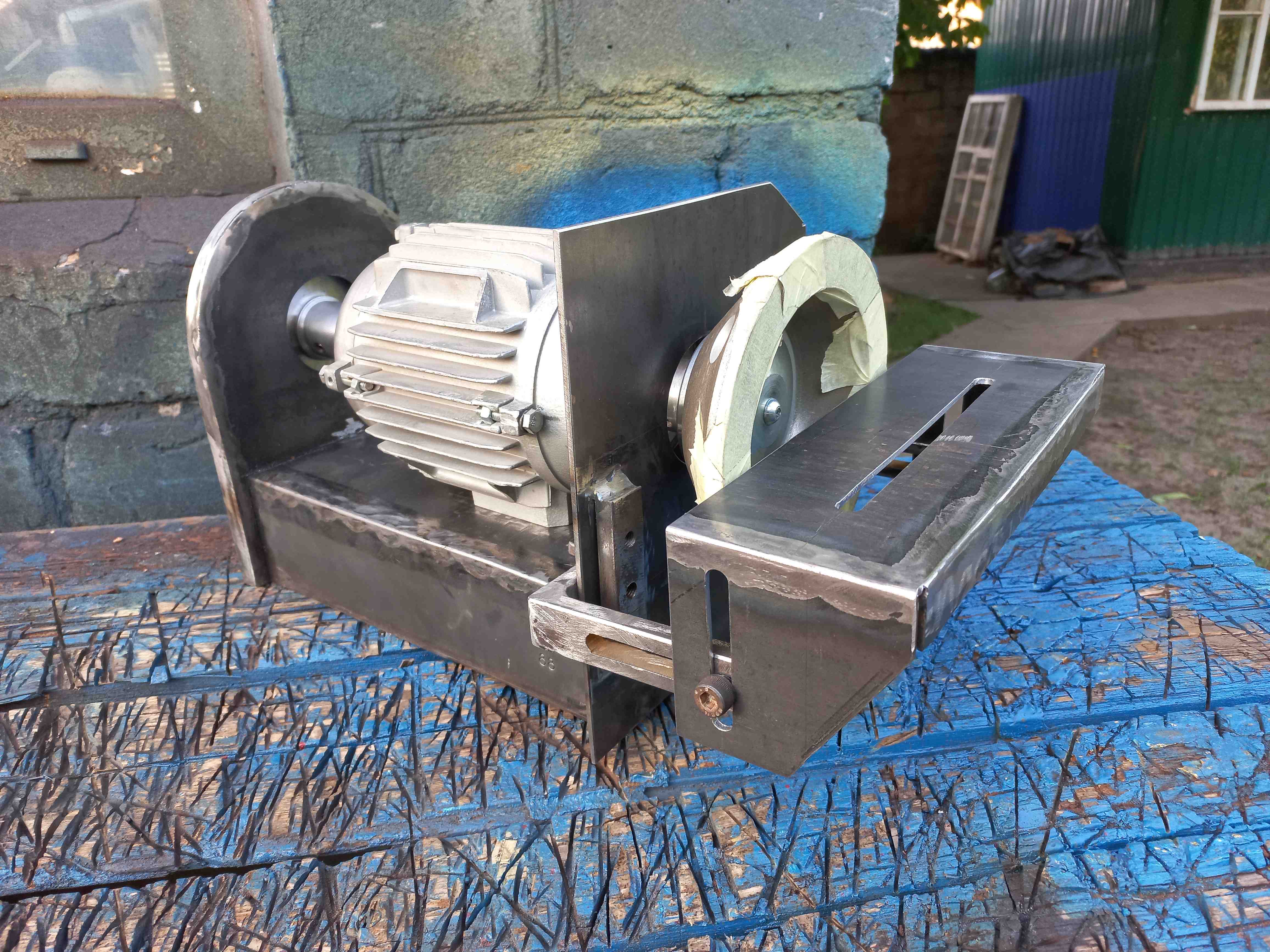

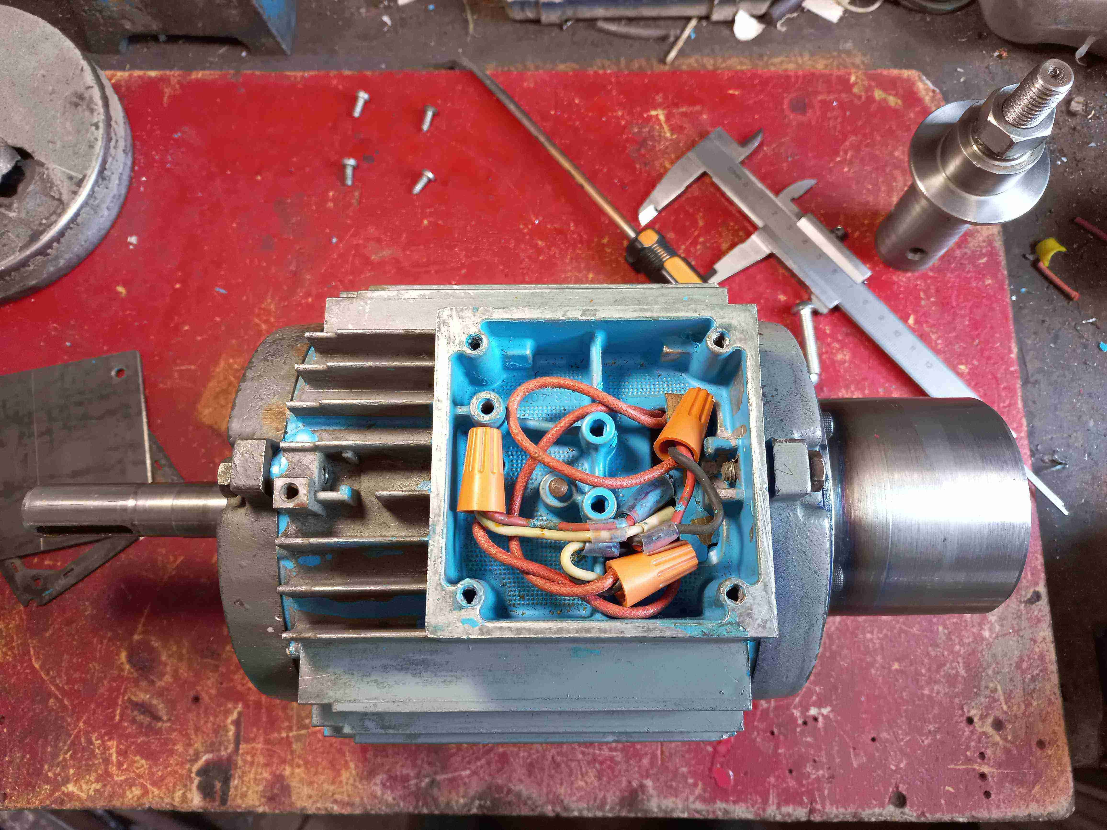

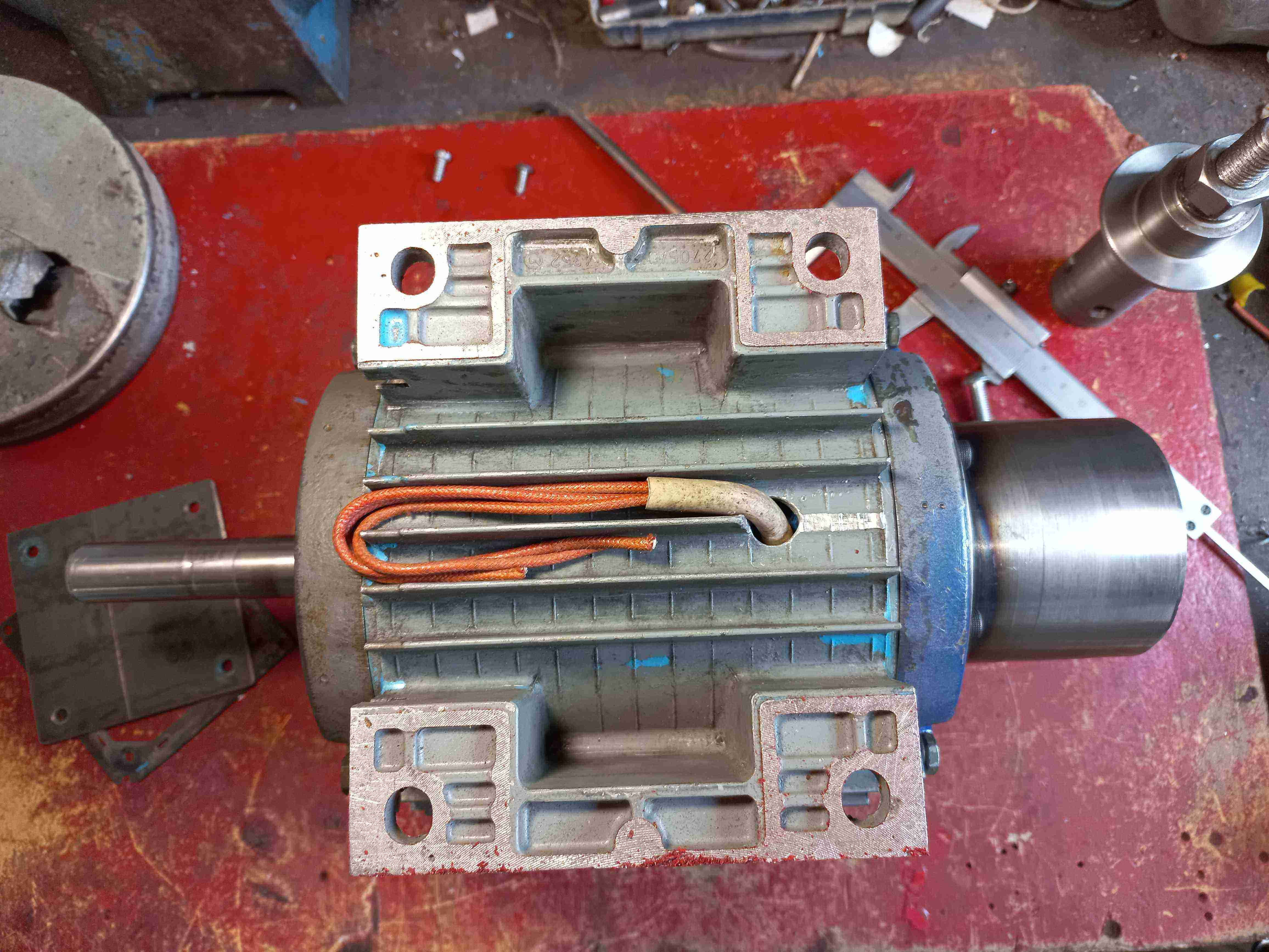

    Always impressed by the variety, which I'm guessing hangs on motor you find; single or double end. Most (all?) are footed, so making one left handed like this considers rotation. The double ended with extended shafts, still favorite, being so well balanced to run vibration free. That's serious craftsmanship.

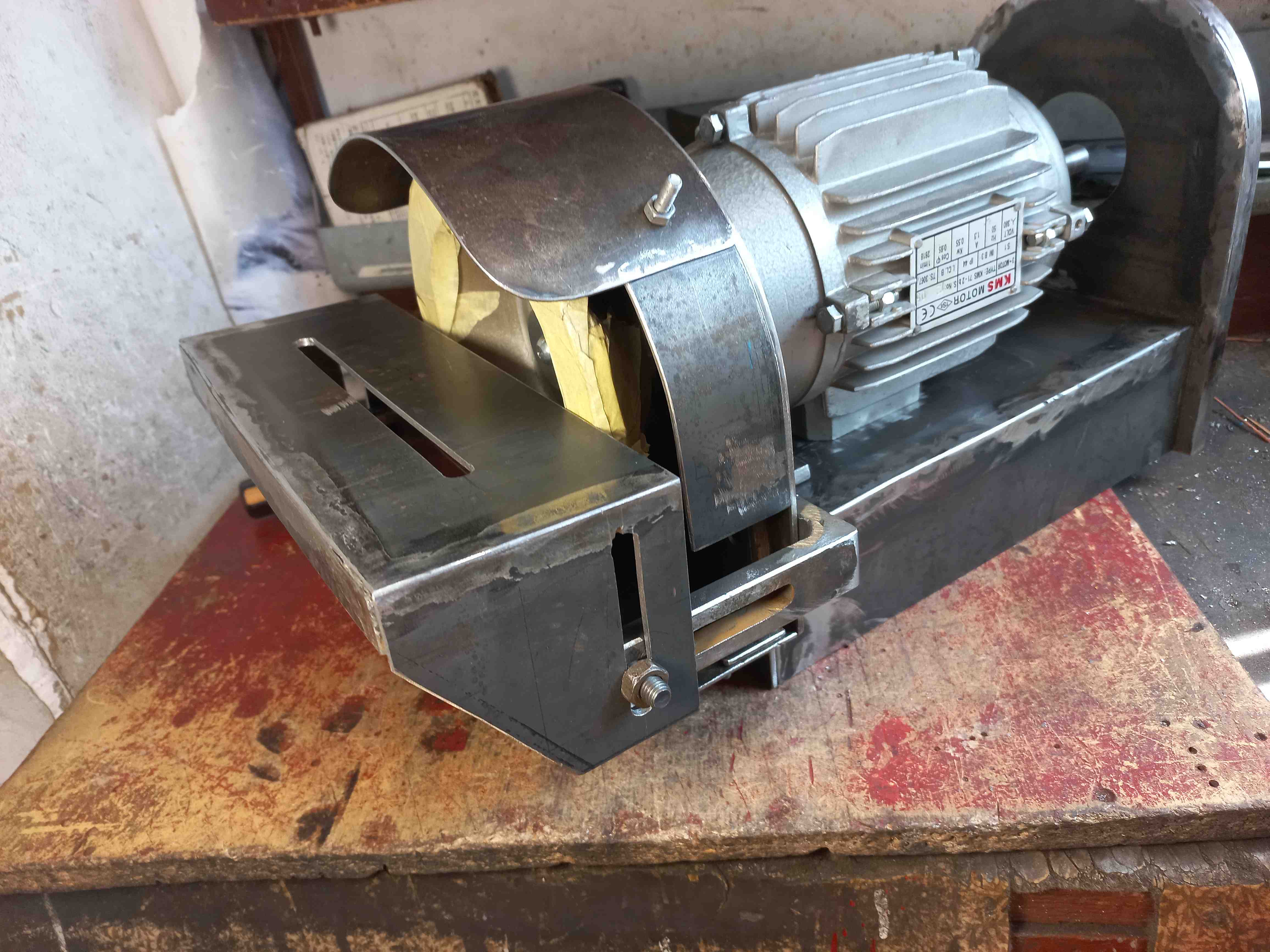

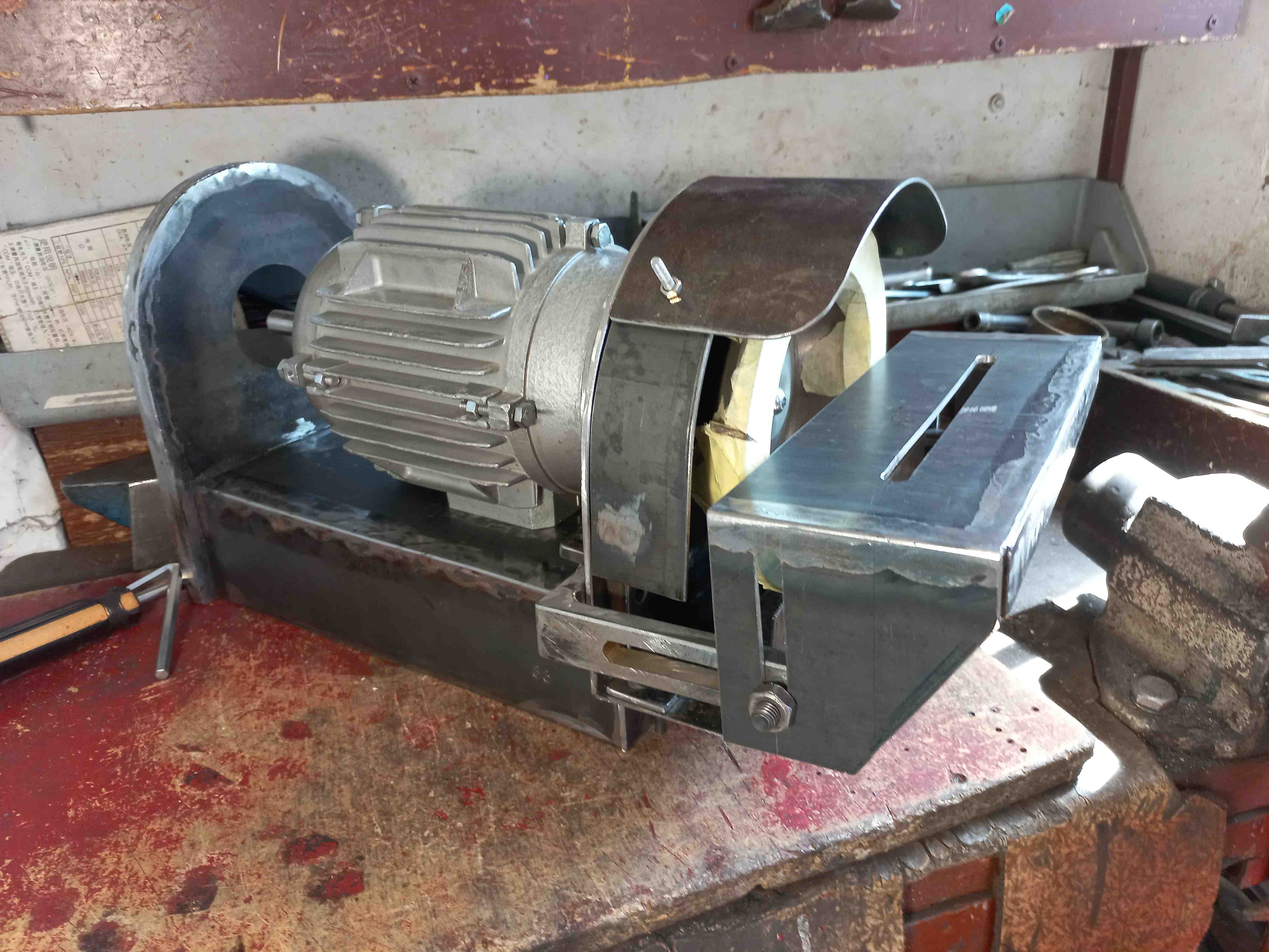

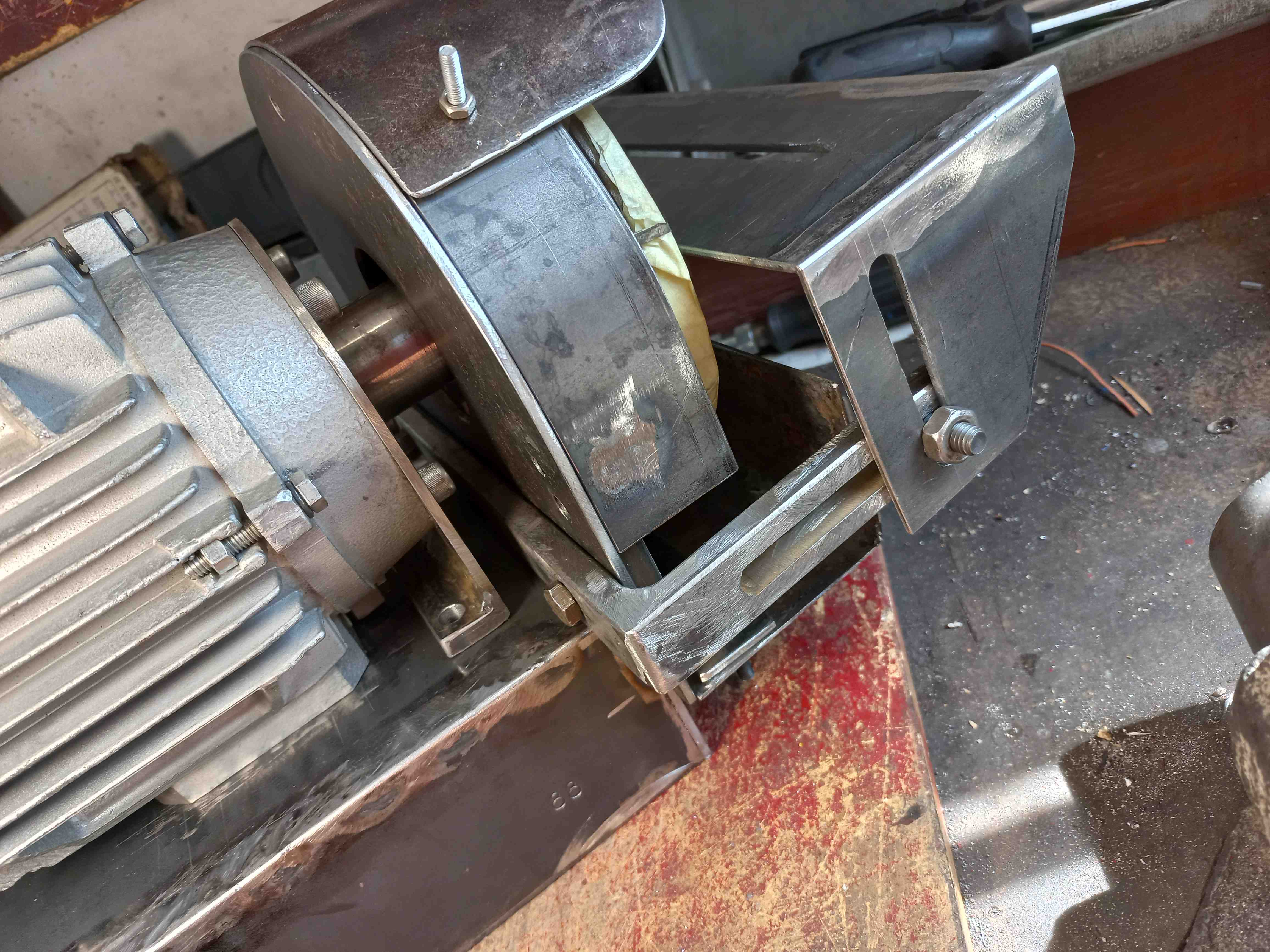

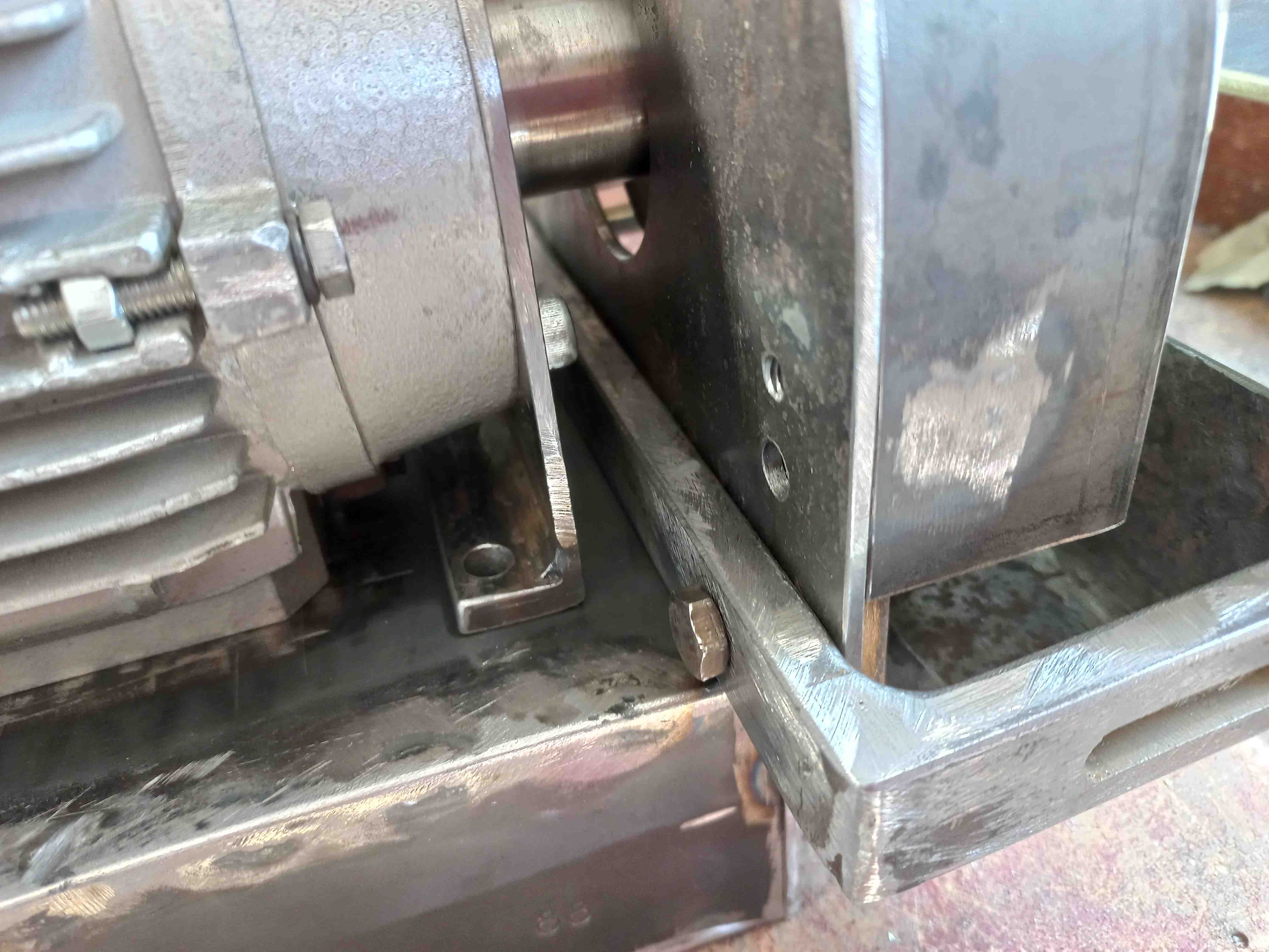

    Thank you.

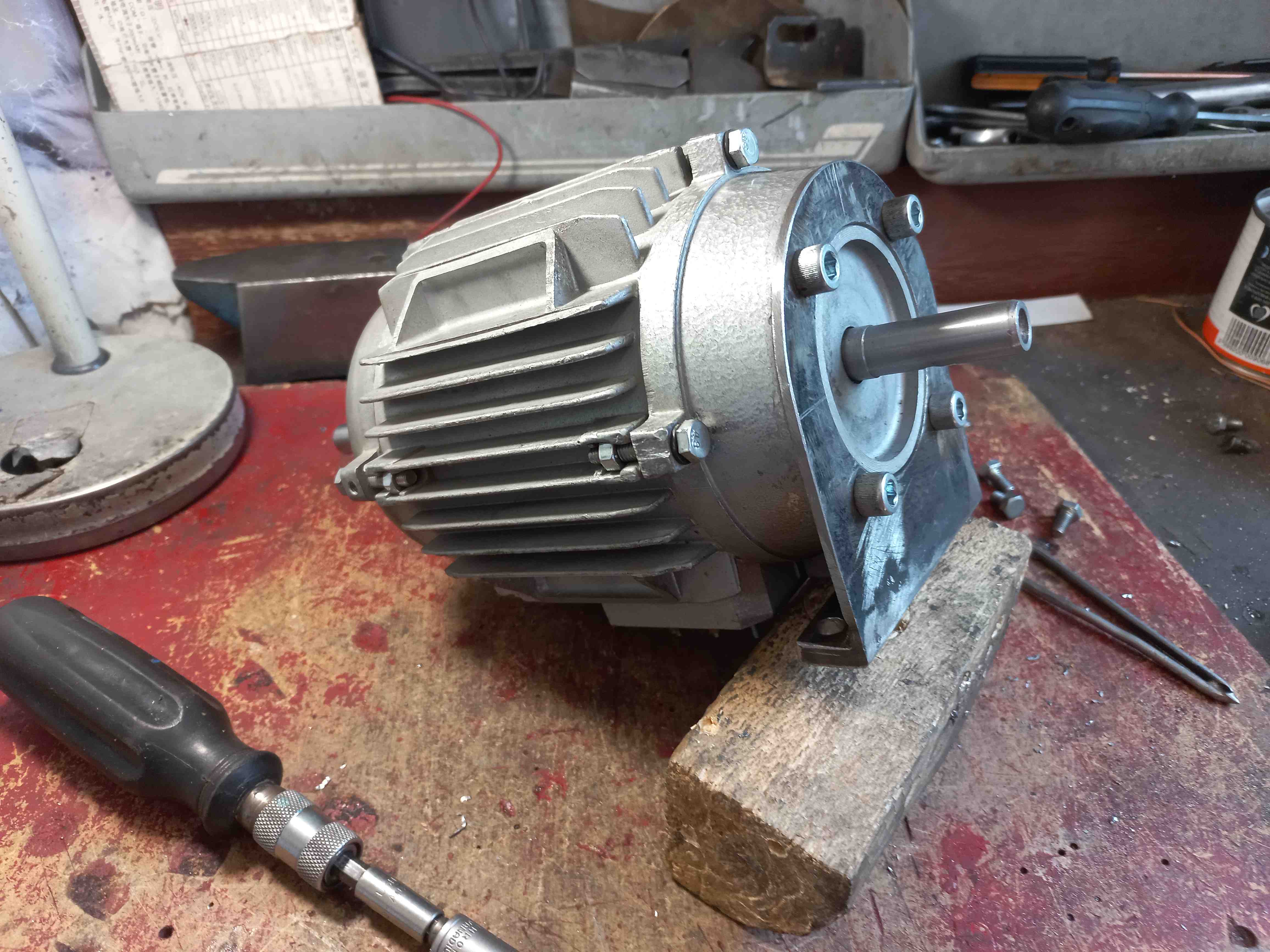

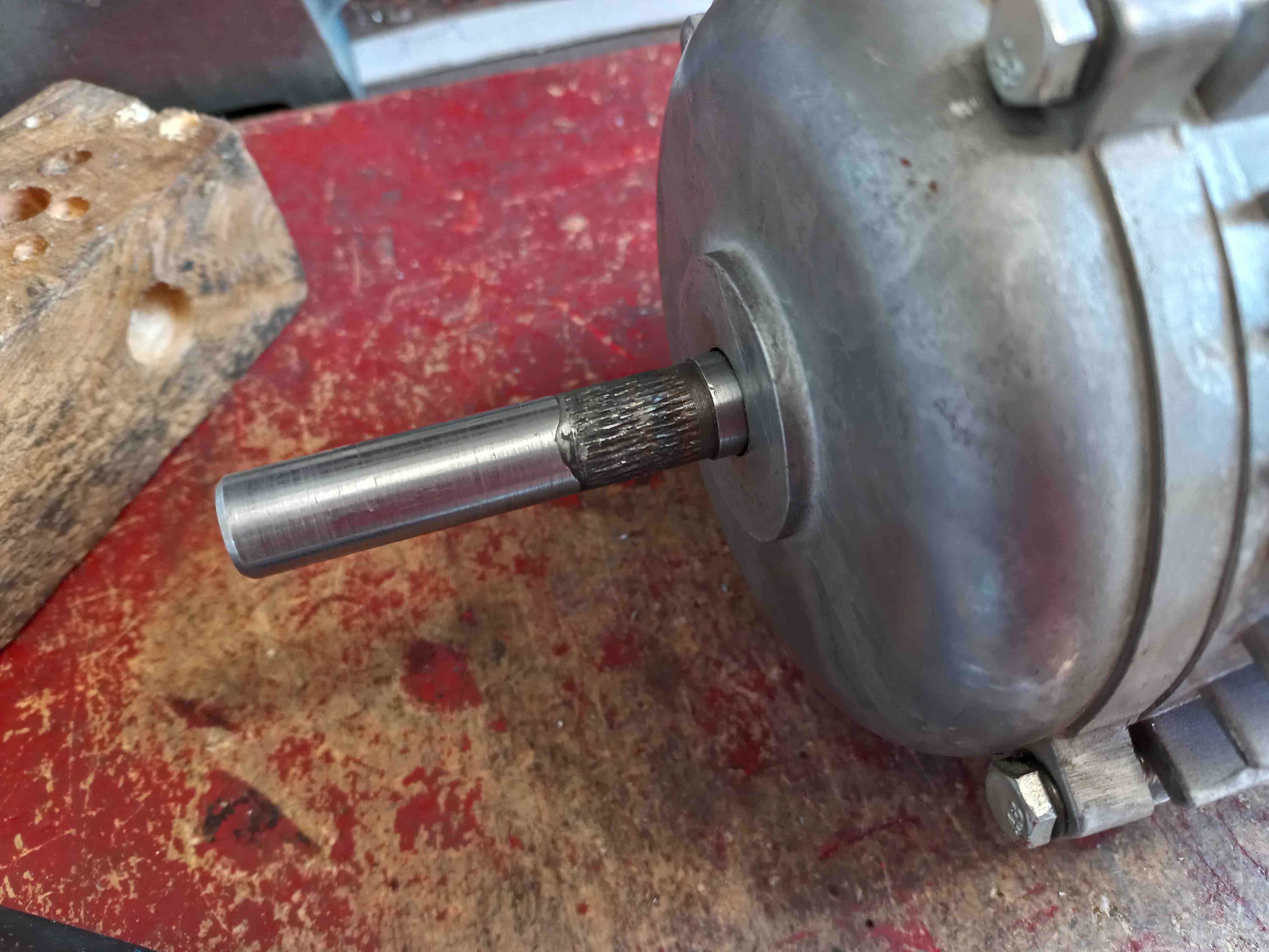

    I don’t always have electric motors with shafts on two sides. As a rule, if there is no way to extend the shaft, then I add it. We weld it with electrodes of brand 13-55 LB52U
    Then on a lathe I make it to the size I need. Soon there will be a machine for a diamond cup.
    When I do it, I'll post a photo of it here on the forum.
    That 13-55 LB52U prompted me to go look. It's in the carbonaceous low alloy range, sounds ideal for motor shafting. also found a 24 page PDF on unfamiliar rod designations at https://www.kobelco.co.jp/english/we...nd_edition.pdf
    Cup wheels are my most frequent consumables, grinding wise. That will be interesting. I'm set up to re-sharp ends and flutes of straight, tapered & ball end cutters, having one dedicated to a single operation would be advantageous.

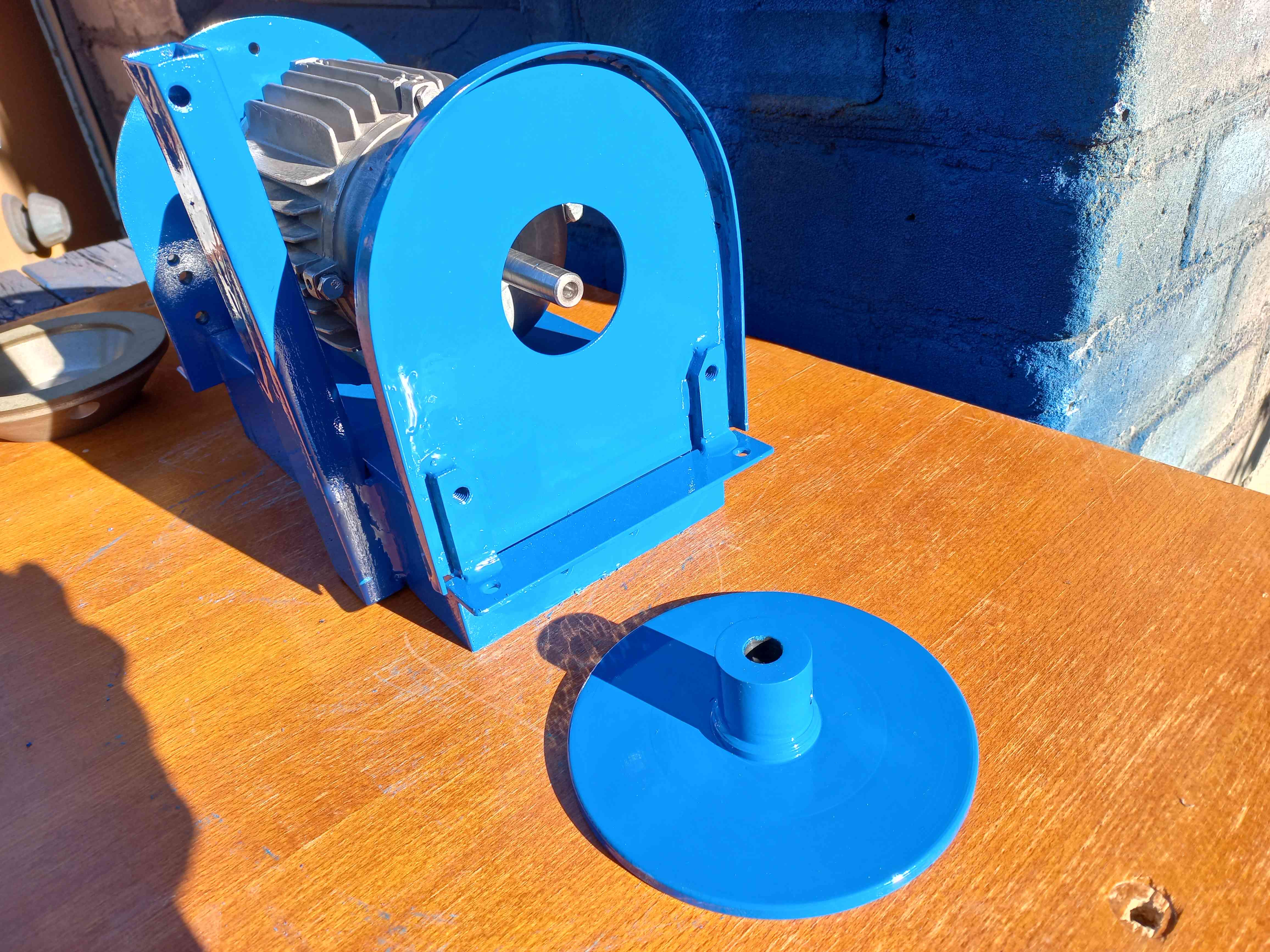

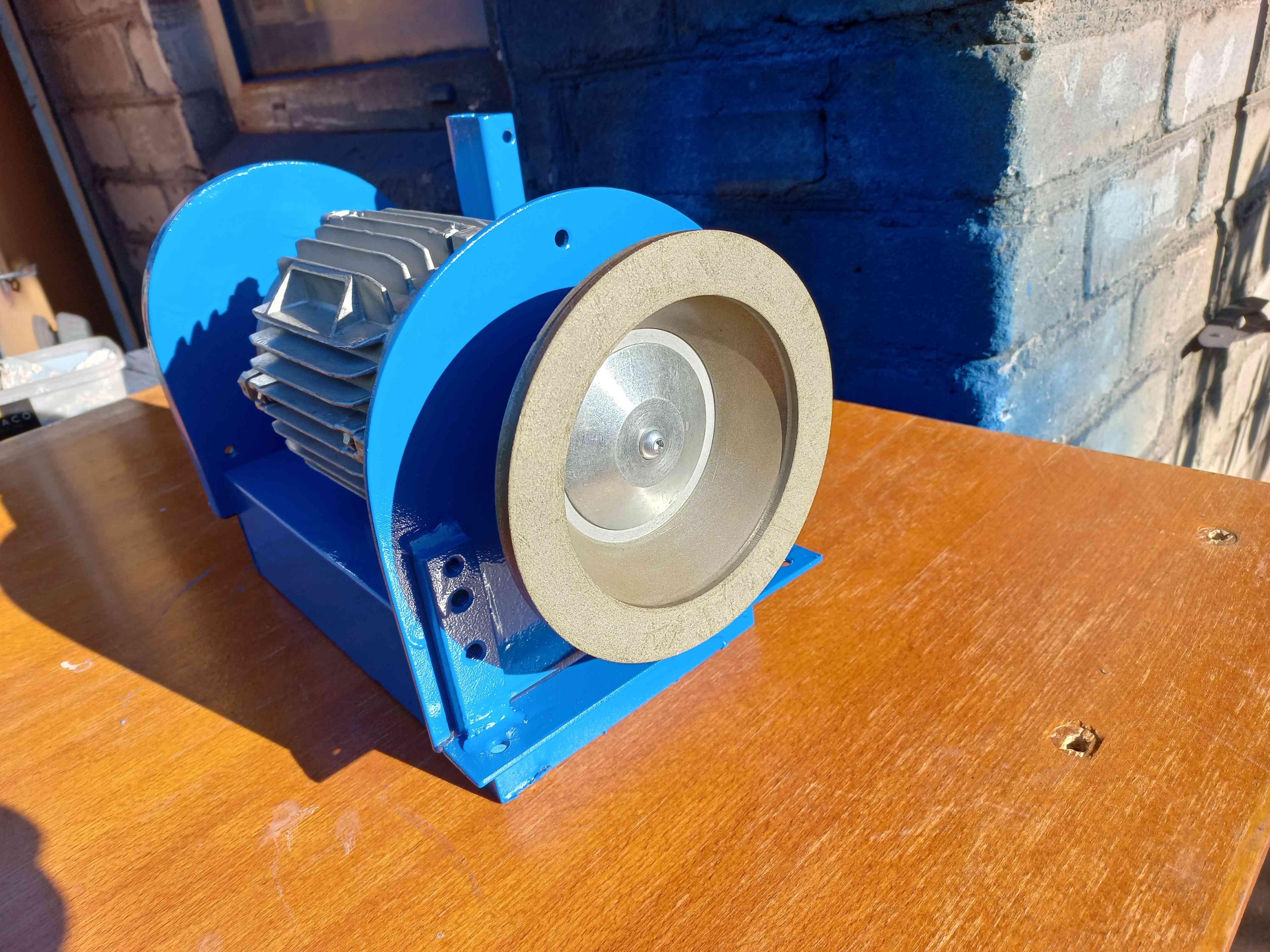

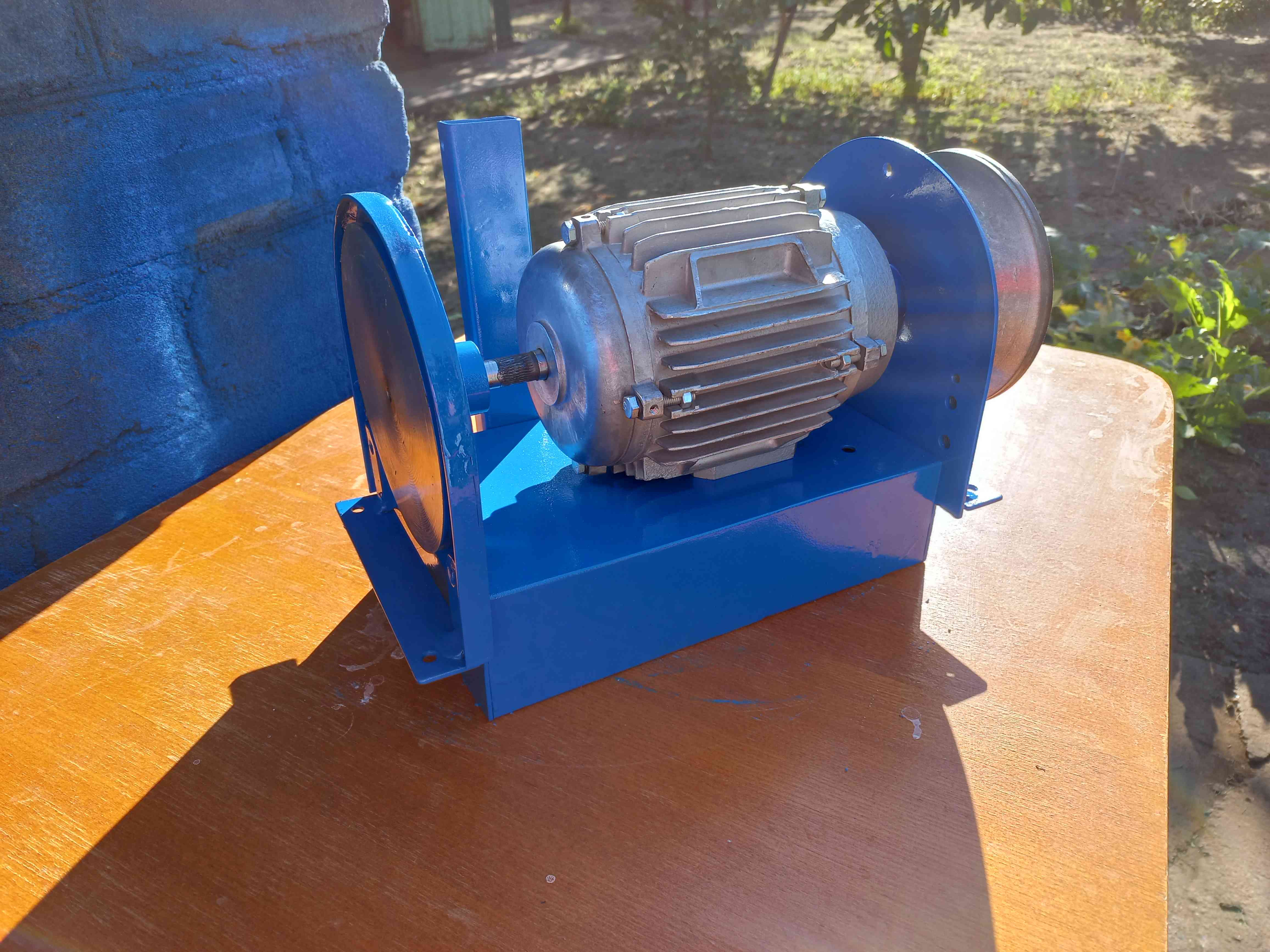

    This is a machine that I make for one person.
    I like to do bench grinders-20220823_184337.jpgI like to do bench grinders-1.jpgI like to do bench grinders-1.jpgI like to do bench grinders-1.jpgI like to do bench grinders-1.jpgI like to do bench grinders-1.jpgI like to do bench grinders-1.jpg

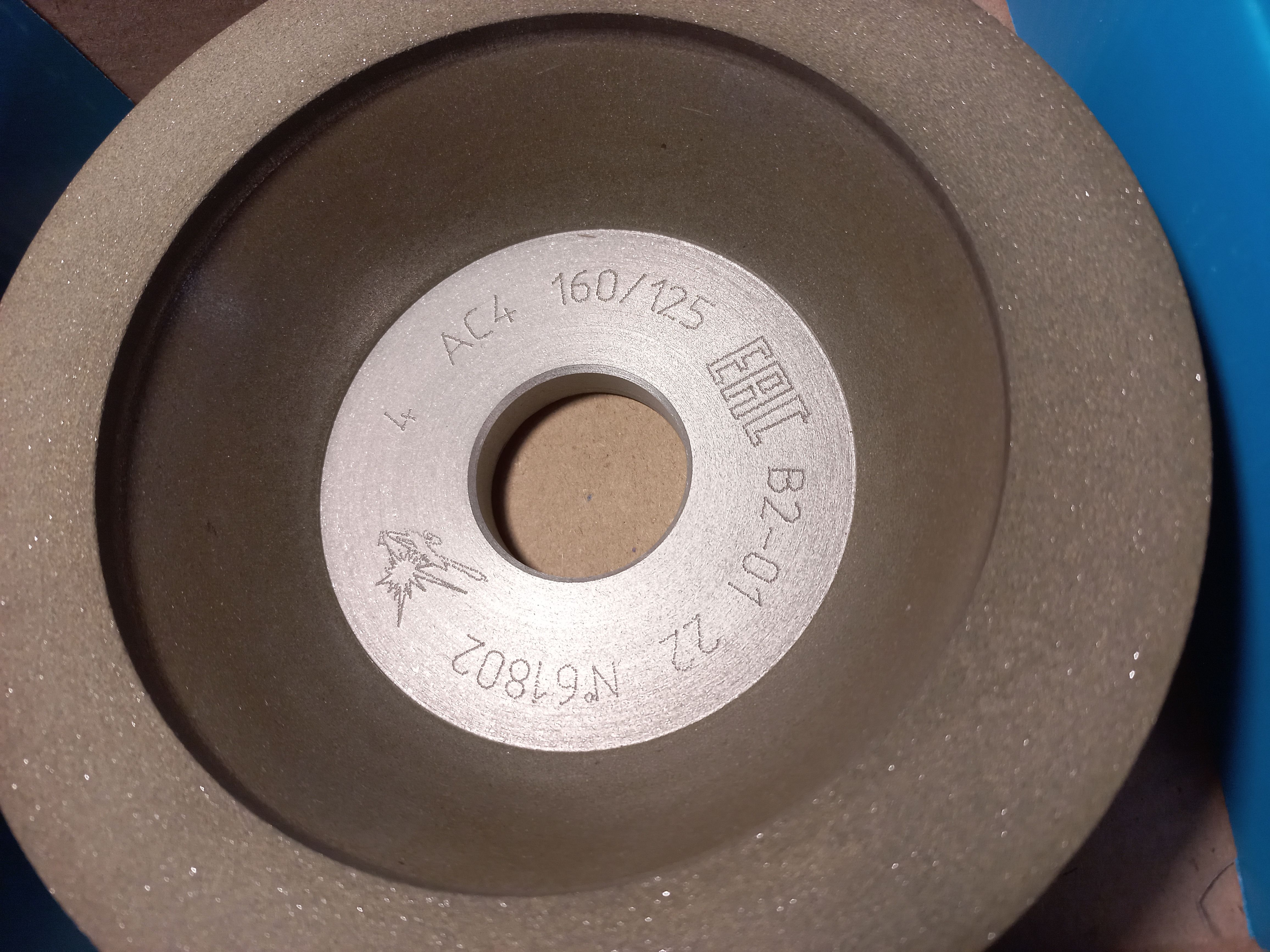

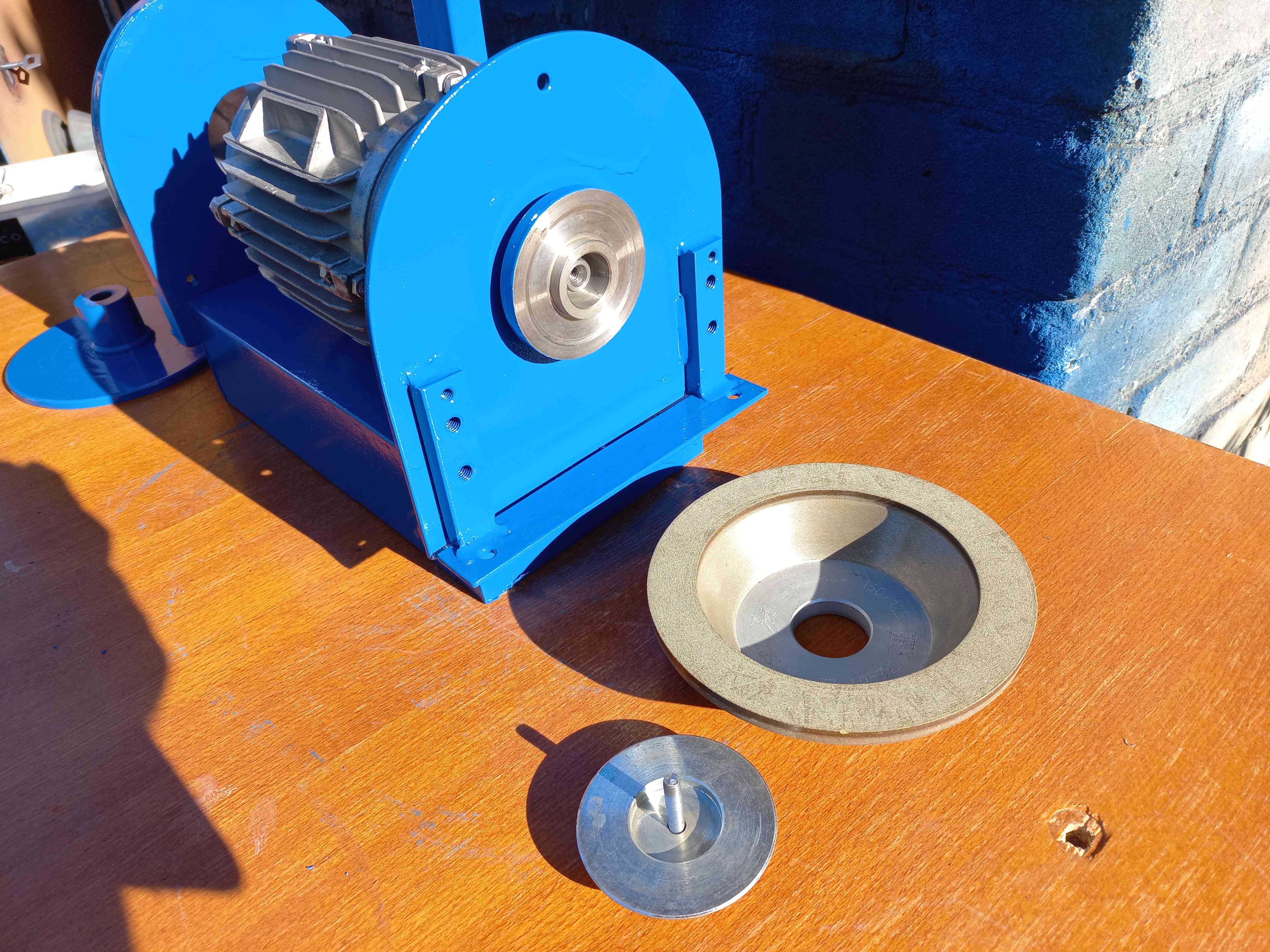

    such a diamond cup will stand on one side

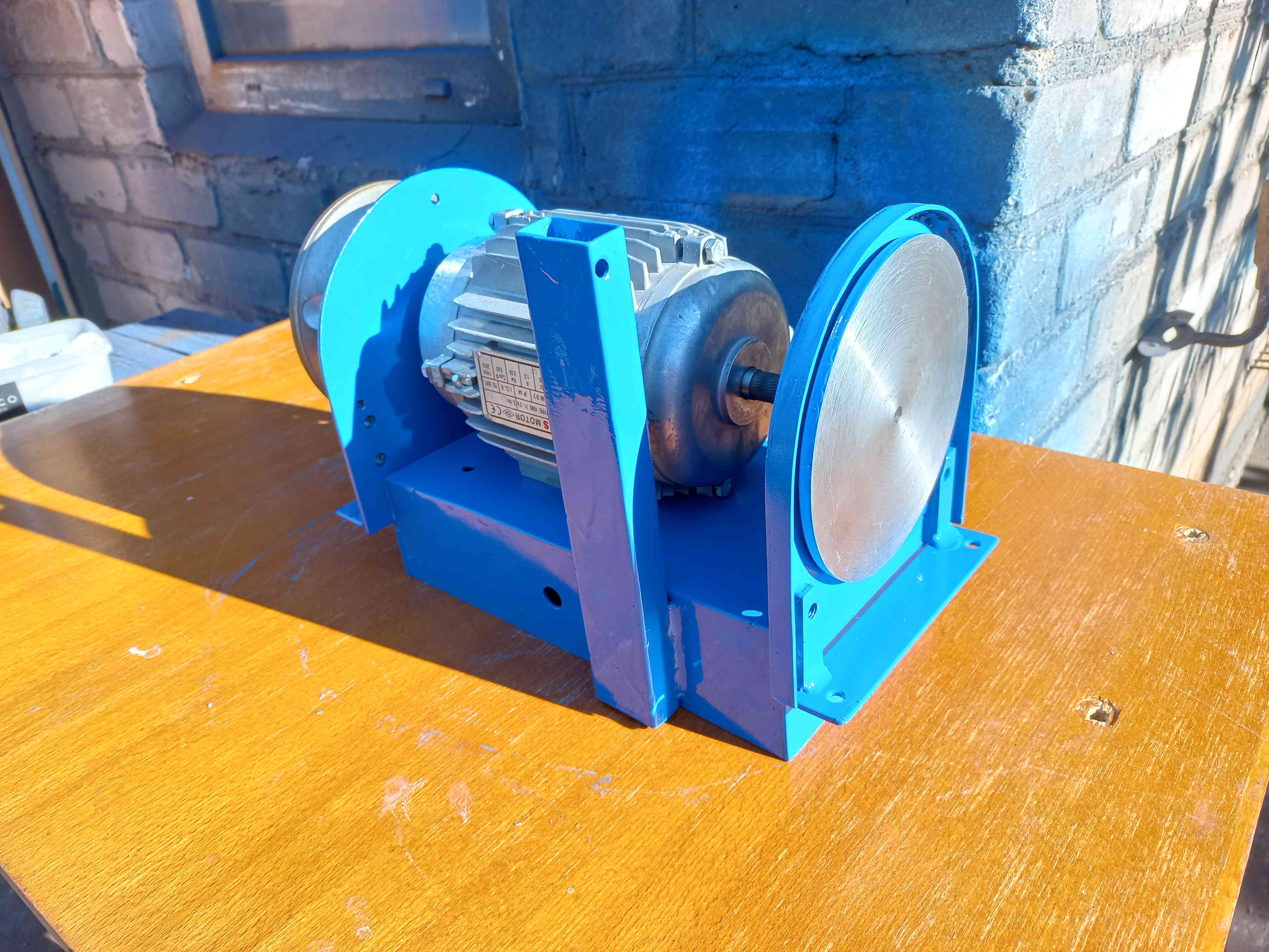

    Cup grinding wheel.
    What do you mean when you say such a wheel will stand on its side? No offense intended, but a little confused by that statement.

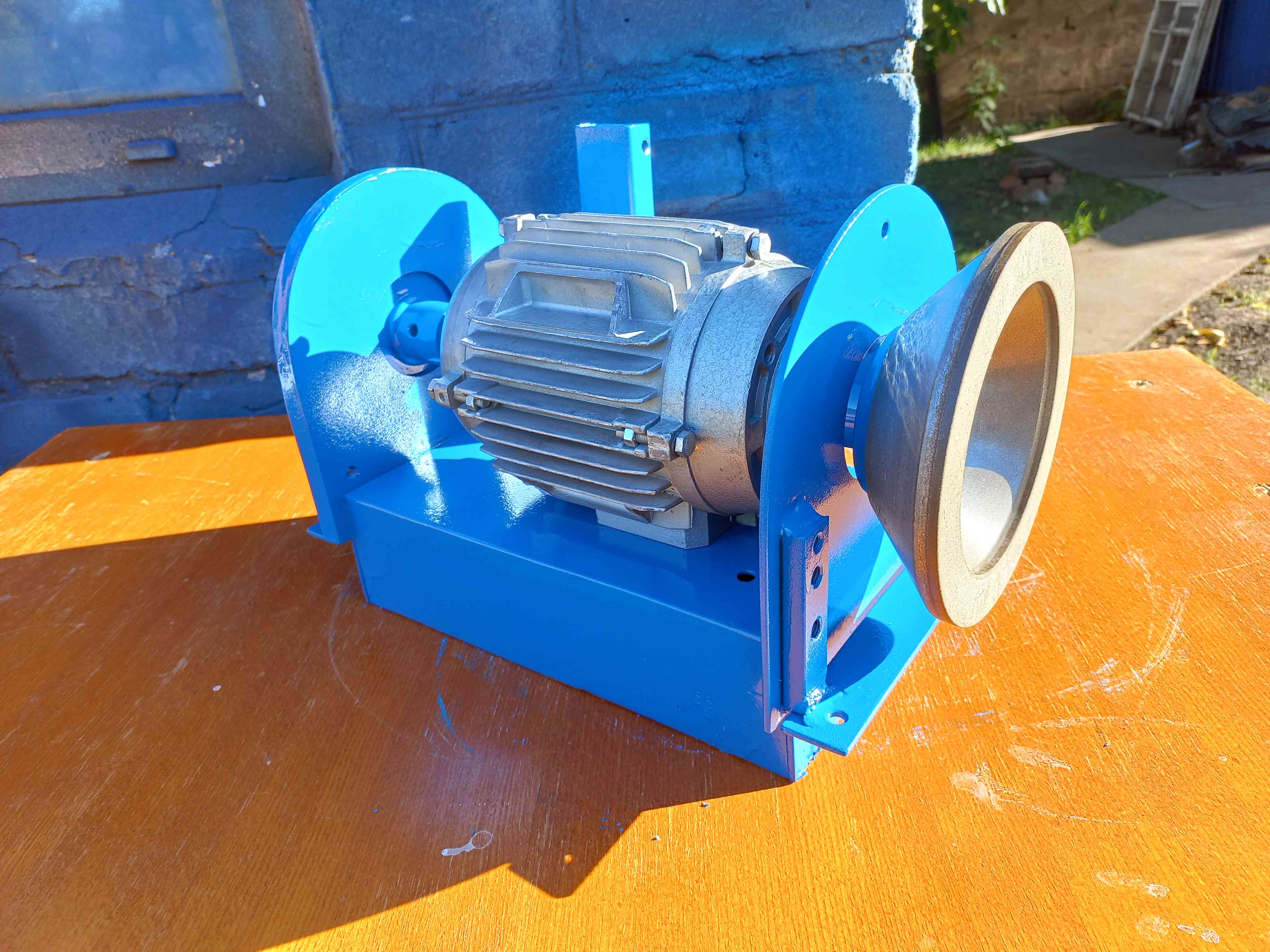

    I meant that on one side of the electric motor there will be a diamond cup and on the other side a grinding disc. How it will look look at the photo.
    I like to do bench grinders-01.jpgI like to do bench grinders-01.jpgI like to do bench grinders-00.jpgI like to do bench grinders-01.jpgI like to do bench grinders-00.jpgI like to do bench grinders-00.jpg
