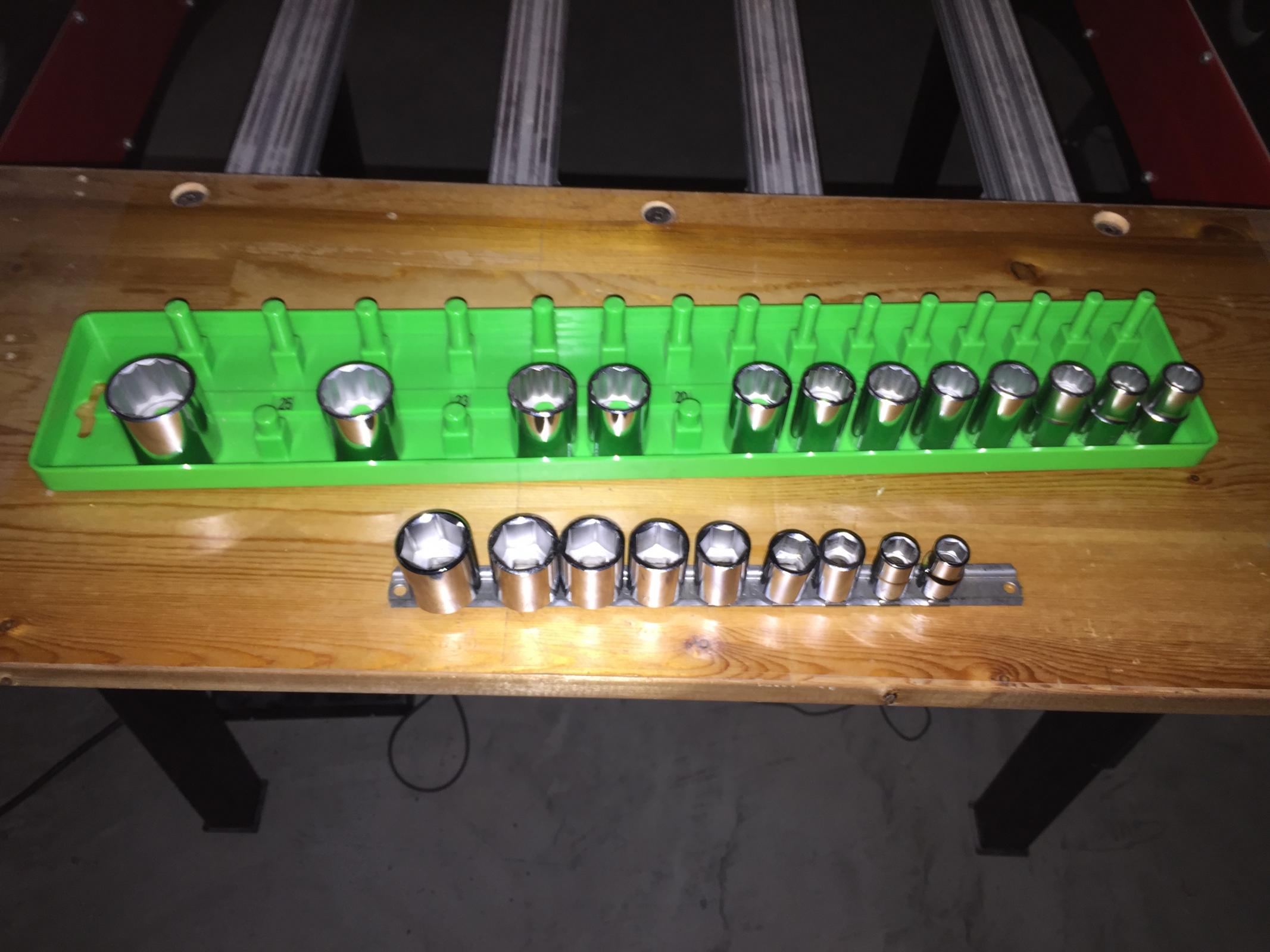

The space in most of our tool boxes is limited. Socket clips are a pain when it comes to removing sockets. Commercial socket organizers take up too much space and often have pegs for sockets we don't have or need.

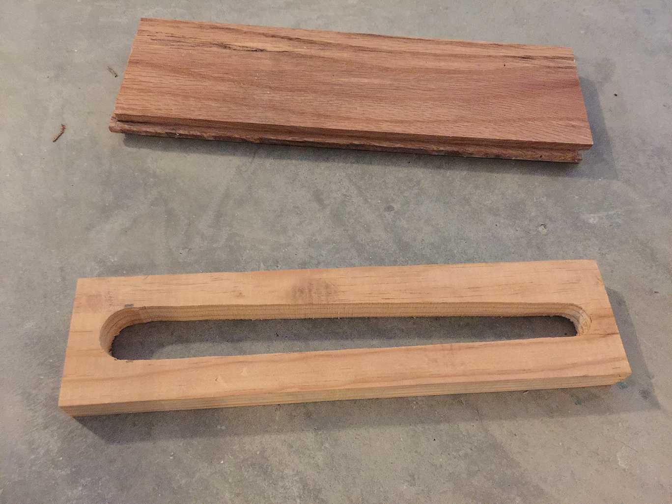

I am dealing with this problem by making my own socket organizers out of some pieces of scrap hardwood floor I have on hand. I lined up all the sockets on a bench, measured the length of the row, and measured the largest and smallest sockets. Drilled large and small holes at the ends, and cut between them with a bandsaw. Then glued the blade gap shut.

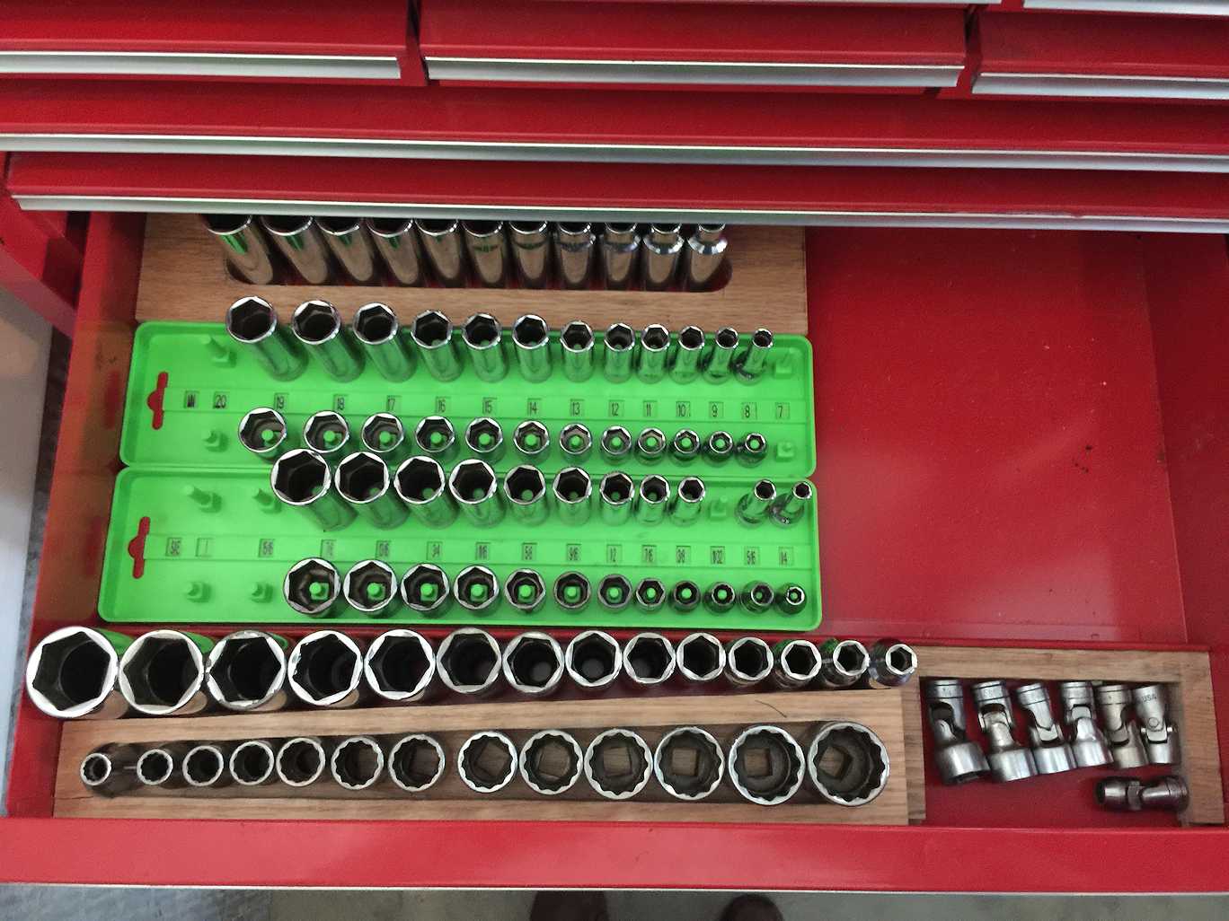

The photos show the difference in drawer space required for regular vs. home made socket organizers. Due to the drawer height, I didn't put a base under the wooden racks to lift them out, but you could.
Most of us can recognize a socket size by looking at it and don't need labels. Just use different racks for inch and metric.
