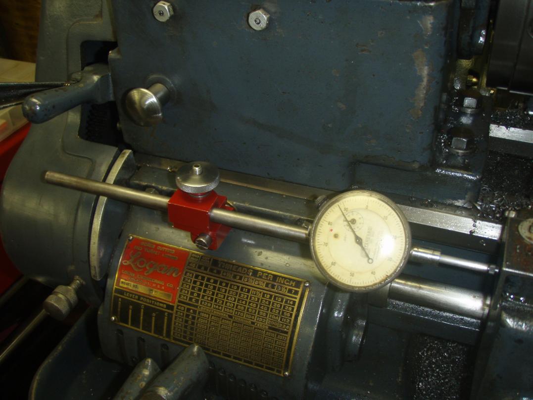

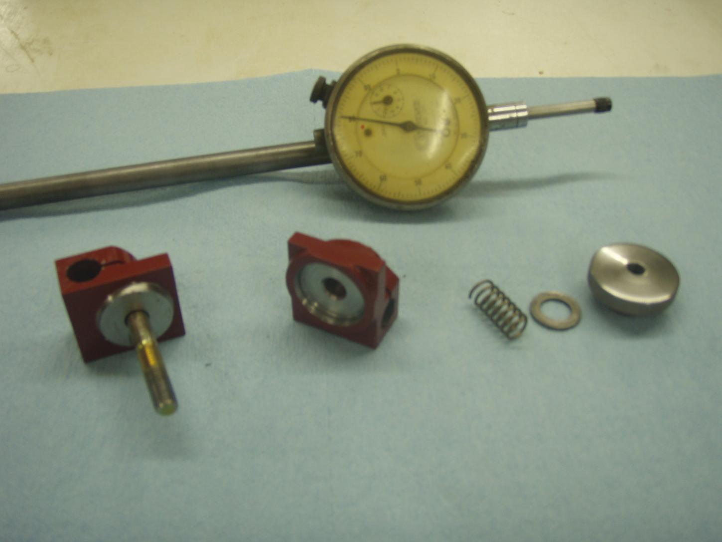

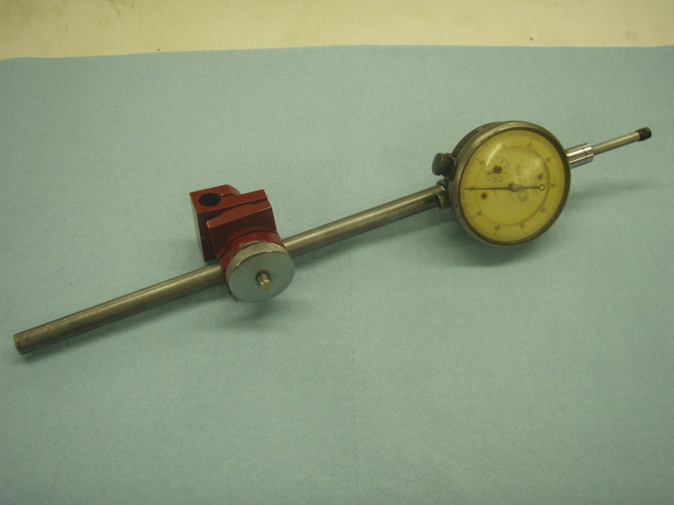

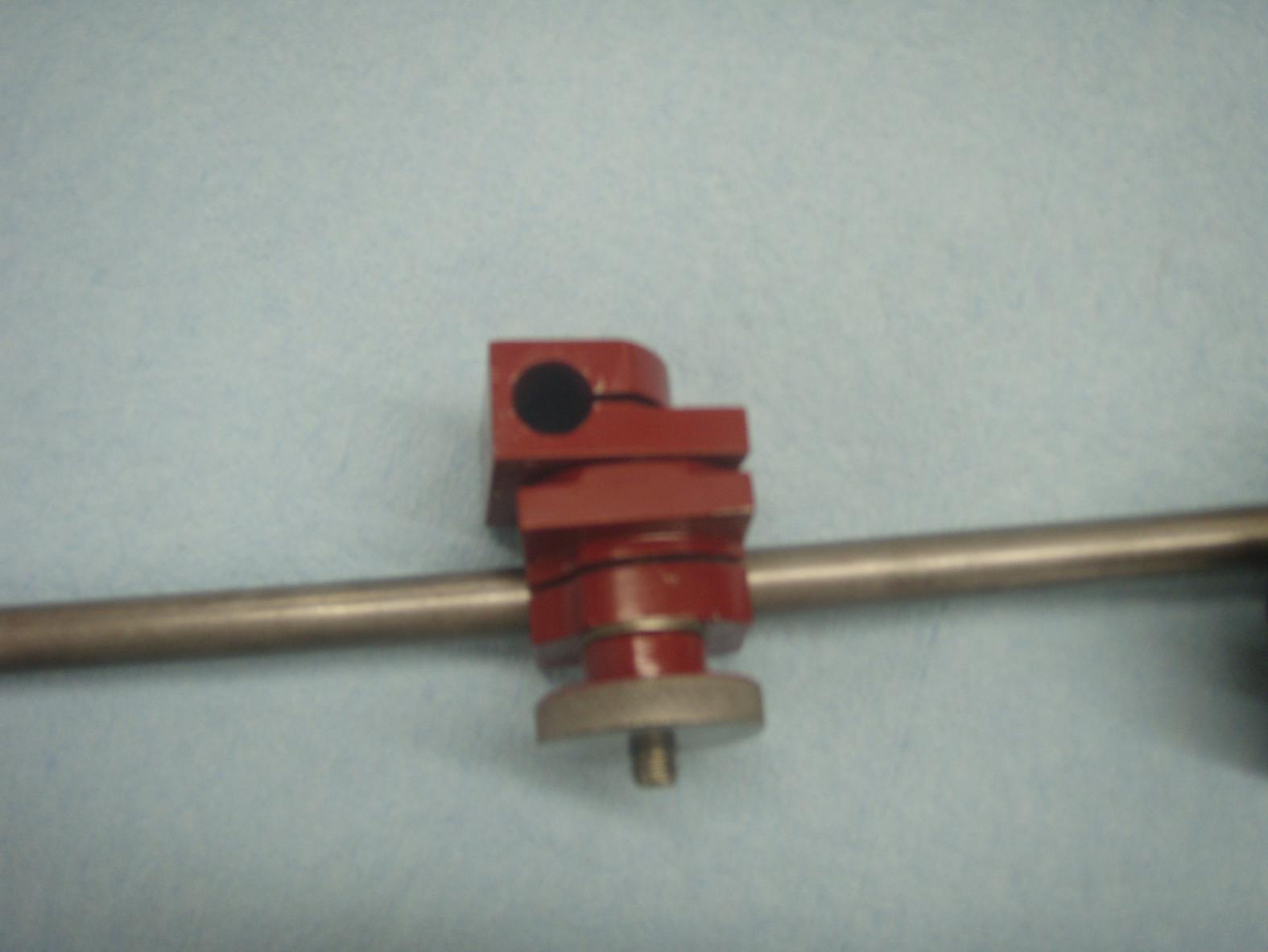

    Lathe Carriage Dial Indicator Mount
    Lathe Carriage Dial Indicator Mount. Replaced one of the speed changer mounting bolts to a threaded 3/8 extended pin. On and off easy and swings up out of the way.
