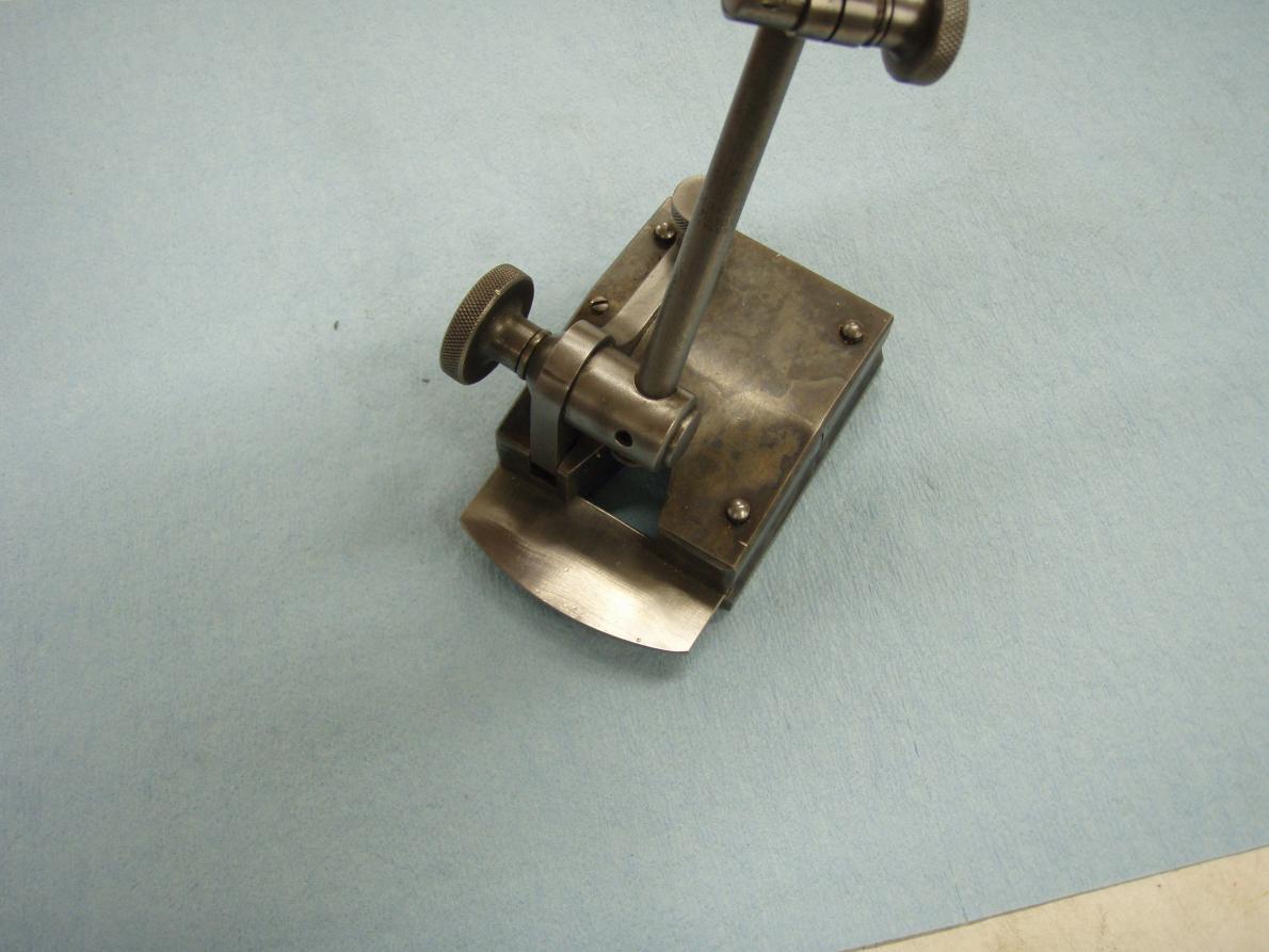

    Surface Gauge base modified for measuring pieces for squareness. Ground slot and press fitted and a piece of 0.062 thick tool steel. Ground/Sanded a smooth radius. Works great.
