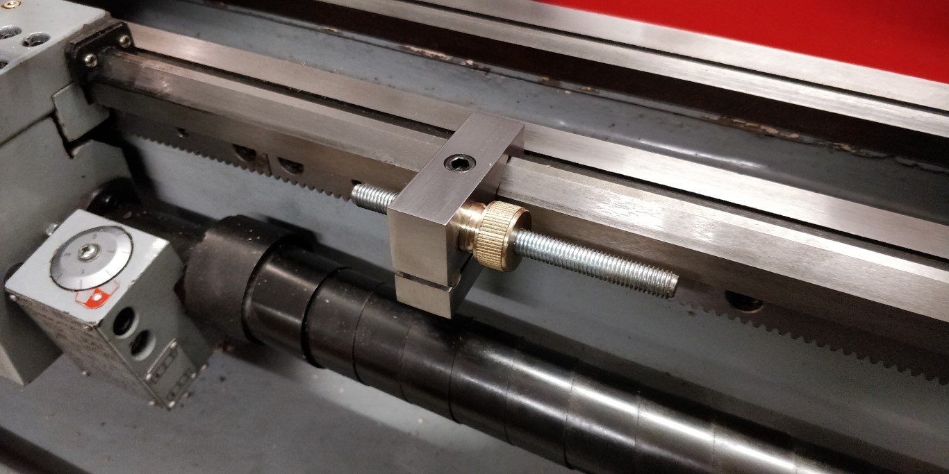

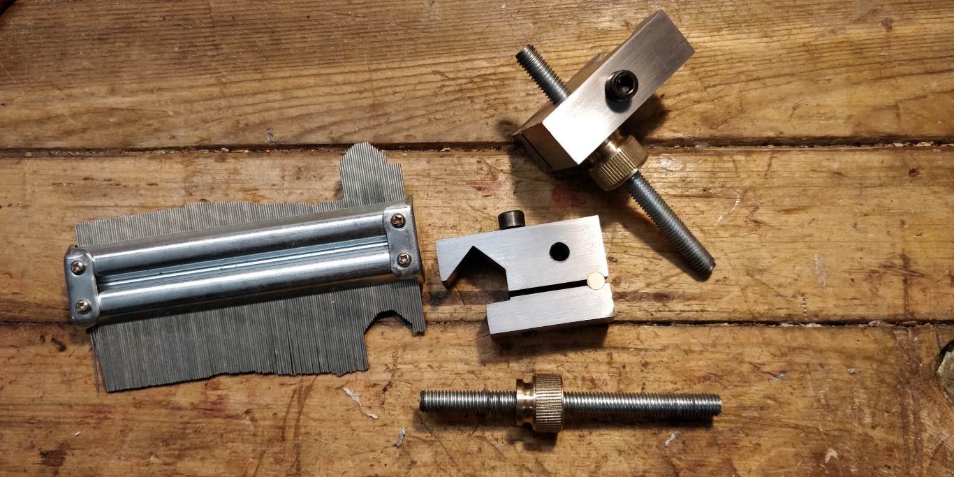

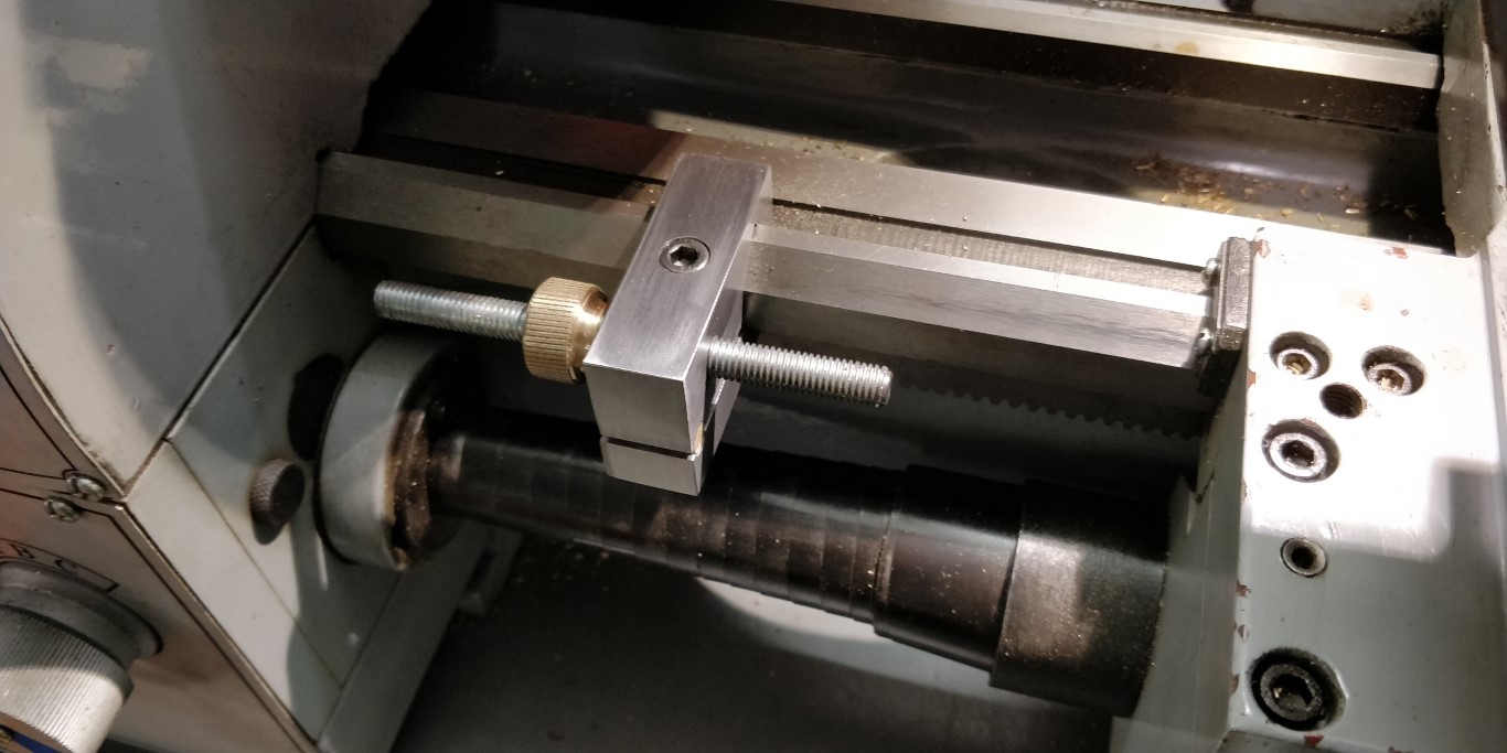

    Yet another set of Lathe carriage stops.
    Nothing special in this design, I just took the profile of my bed rail using a profile comb gauge.
    I used a brass pin as a pivot, it is simply locltite-ed to the top part just to avoid loosing it.
    I did this because it saved me some milling time compared to make a step as often seen.
    Cheers !
    Christophe
