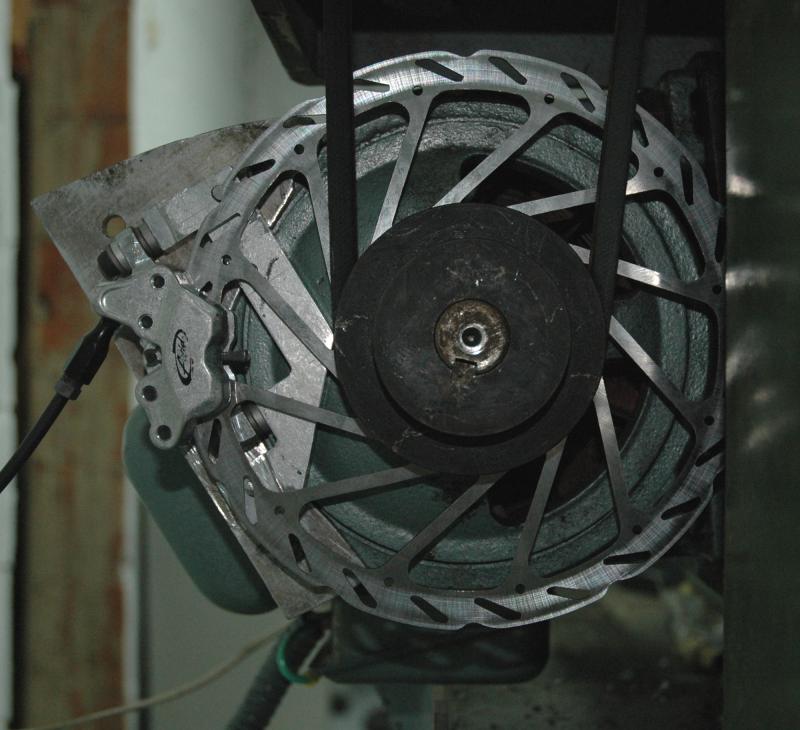

Hi LMM
Is there a specific mechanical advantage in mounting the caliper assembly near the lathe chuck or is the mounting site for convenience.
The reason I ask, is that I too have a disk brake assembly ( about 6" ) from a small motor cycle. It was my intention to install it on the input side of the lathe on the pulley for the vee belt. I would be fitted with a micr switch activated power cut out .I have seen factory fitted footbrakes (drum variety ) mounted this way.
Thanks Ozwelder

Hello Ozwelder,
Backplate of my chuck is screwed onto the spindle and I didn't want chuck to get unscrewed and fly around when stopped suddenly.
That's the main reason why I put brake disc onto the chuck.
Check here: Lathe Spindle Nose and Backplate Fittings
Also due to recess in motor pulley it would be hard (but not impossible)
to install brake disc on the pulley.
Regards
LMMM

= WARNING / Lathe Chuck Brake =
Dear all,
Please note that chuck jaws are getting loose by every sudden stopping
if there is no work tightened in self centering scroll chuck.
If you do numerous starts / stops when checking how good is your brake,
there is great possibility that jaw(s) will fly out from the chuck.
Always observe lathe rule no. 1; NEVER STAND IN FRONT OF THE CHUCK.
Regards
LMMasterMariner

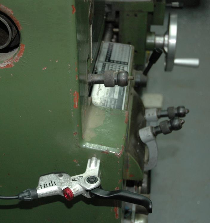

Here is another.
Attachment 47382 Attachment 47383 click for full size.
