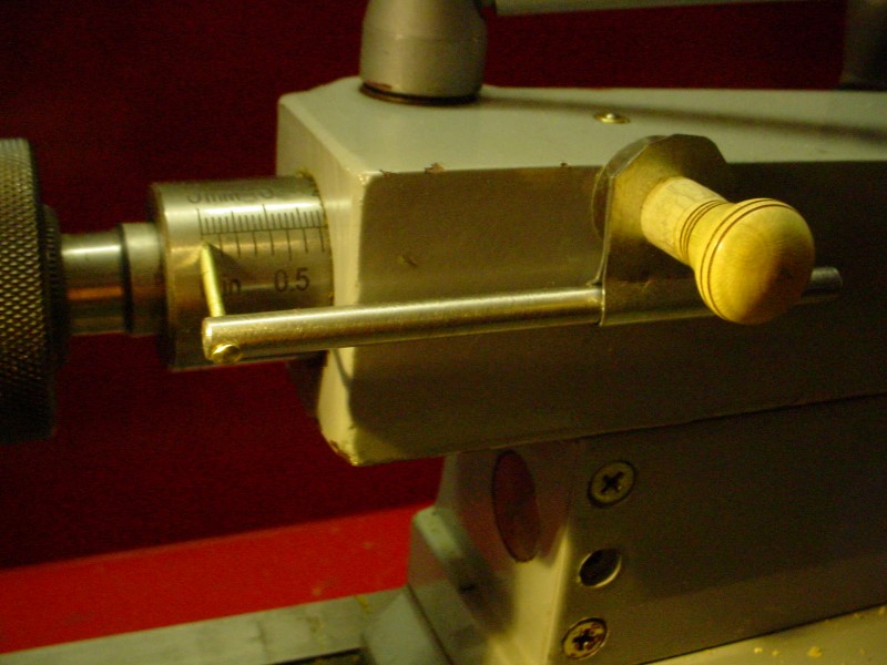

    Here is a little gizmo I quickly made to provide a reading index and zero setup for the tailstocks of my lathes.
    I know I could have made a DRO for the tailstock, with a digital caliper for instance, but both of my tailstock quills, metal lathe and wood lathe, have a graduation, so I wanted to take benefit from them, and wanted also a zero setup .
    I came up with this simple solution, mounted on a rare earth magnet, featuring a little shaft ended with a brass needle. I just need to move the magnet so that the needle is in front of the zero to control the depth of my drilling.
    Here it is on the metal lathe :
    And here , the same on the wood lathe :
    Bottom view :
    It can even be used to index the chuck angle !
    Cheers !

    Christophe,
    Great idea and solves a problem I have with my tailstock and various Morse Taper adapters. I cut down the length of a MT3 adapter for a keyless chuck I use in my 12" swing metal lathe. I also use a keyed chuck with another adapter. I had to leave an extra 0.1" to the overall length to the adapters to allow ejecting the chuck and adapter when returning the quill to below zero. However, this slightly extra length in the adapter does not allow the quill to return exactly to zero as measured at the front of the tailstock. Adding a pointer like yours will solve this problem.
    Thank you for sharing, Paul

    Hi Christophe,
    That's a handy little gadget. I'll have to make one.
    I am always amazed at the way we come up with solutions to problems in the shop.
    But I suppose, that is part of the fun.

    Hi Brendon,
    Thanks, yes, that's true, this is the kind of gadget done very quickly upon a fugitive idea.
    And suddenly came the light ...

    Hi, Ken and team,
    I'm greatly honored, thank you very much !
    It is a bit unexpected, this little gadget has been made in a hurry, without much care, and eventually, it wins an award !
    It is true that it is really useful, I think I will make a separate one for my wood lathe to avoir having to move it from one lathe to the other.
