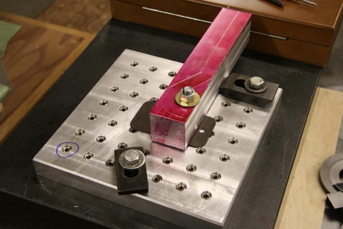

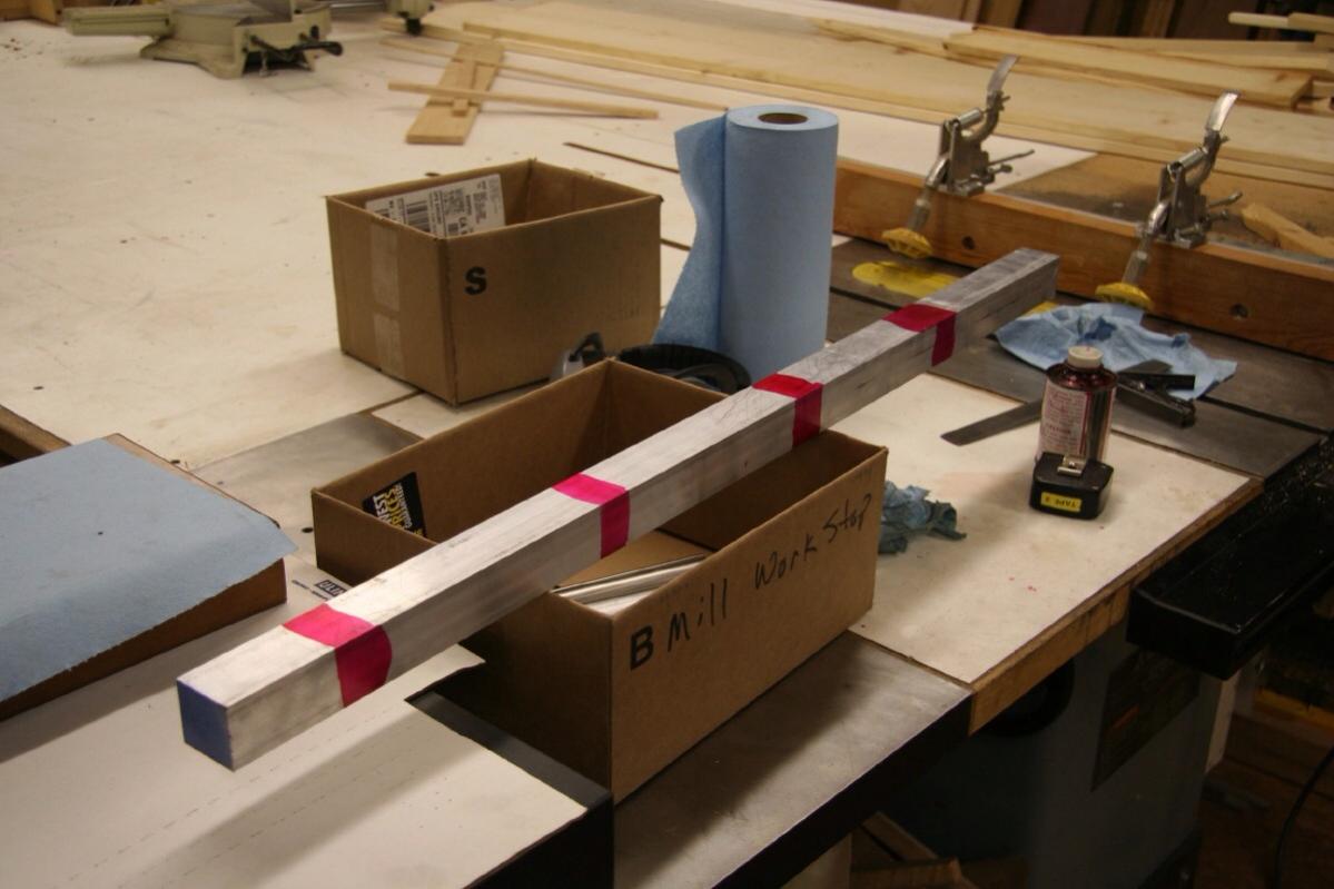

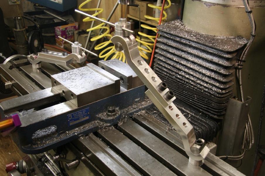

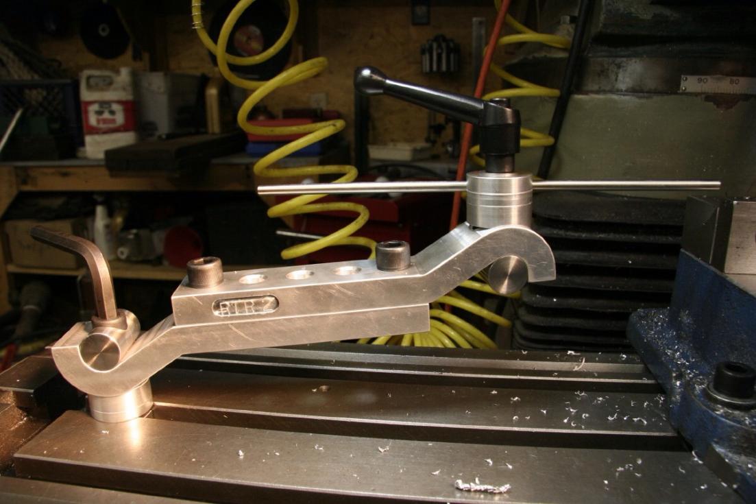

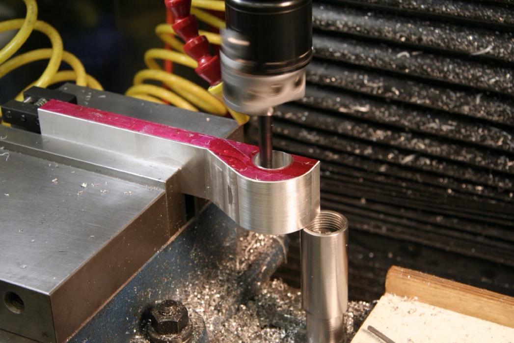

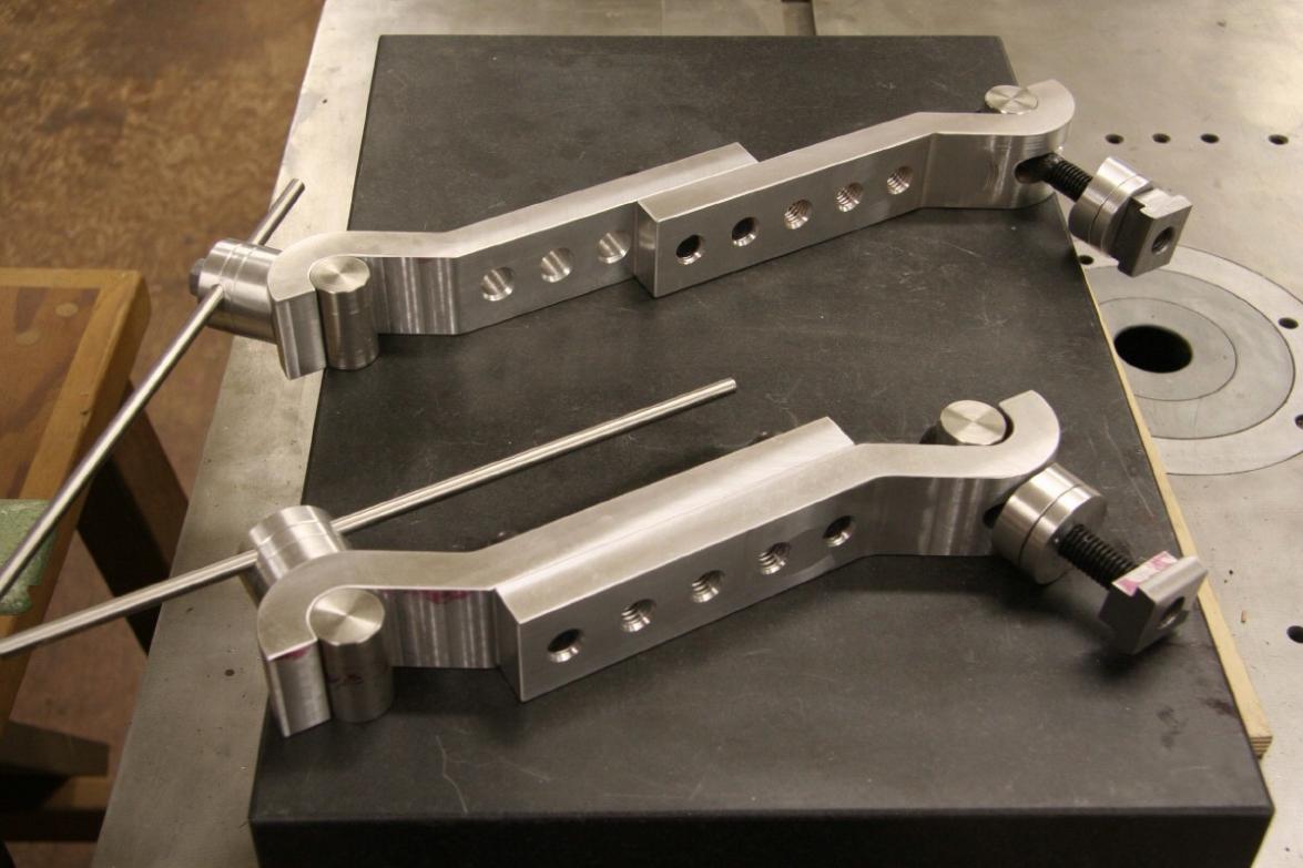

    The work stop was inspired by Tom Lipton of Oxtools. I made two of these for about $70.00, one for my son and myself for Christmas. This style of work stop is great, the best I have ever used.
    Milling Work Stop-image.jpgMilling Work Stop-image.jpgMilling Work Stop-image.jpgMilling Work Stop-image.jpgMilling Work Stop-image.jpgMilling Work Stop-image.jpgMilling Work Stop-image.jpgMilling Work Stop-image.jpgMilling Work Stop-image.jpg
    I have many more photos.

    Great work! An attractive and useful piece. What material was used?

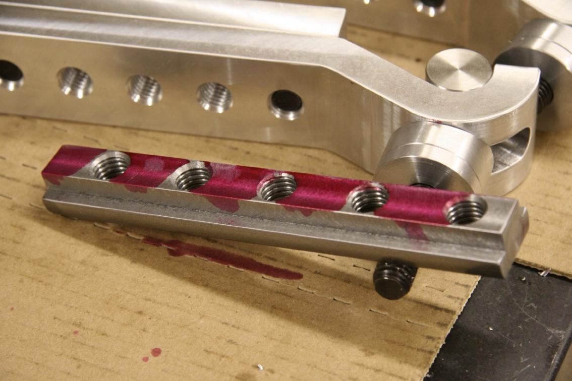

    I used 6061 alu, Stainless -Pins, top stud, position rod, 1018 steel for 'T' nuts, Steel socket head cap screws.

    Hello,

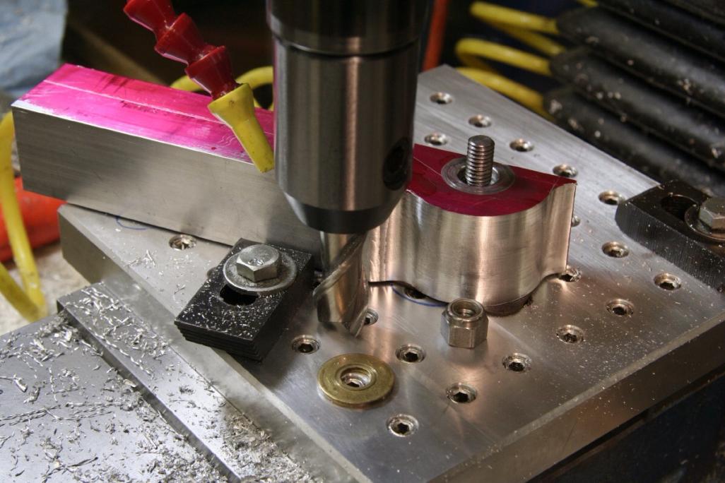

    I'm a Milling Newbie - what do you do with this thing ? Why is it a useful tool ? Does it define a repeatable reference point in 3d space that you line things up against to make 20 identical widgets ?

    Steamingbill, Yes to all. Also if you need to remove your one off widget you can then replace it in the same location.

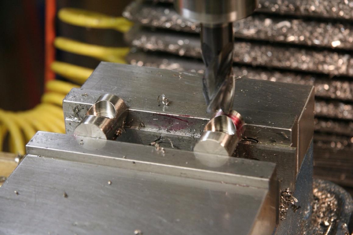

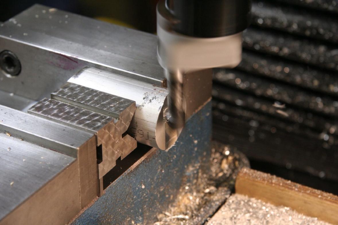

    Beautiful to look at and very useful. I like your technique for milling the curved surfaces by hand rotating the part between the two stops. I have several projects than can use this method. What depth of cut did you use for each rotation around the threaded rod until you arrived at the final depth?
