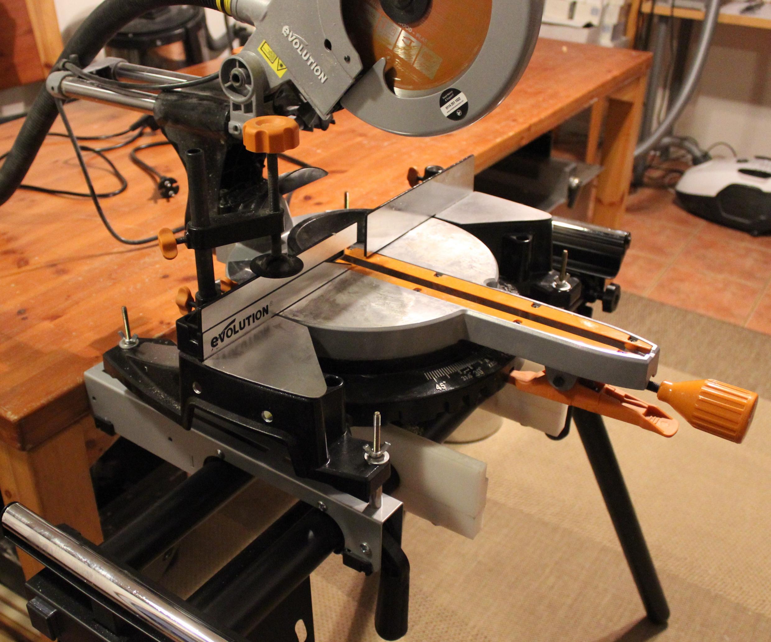

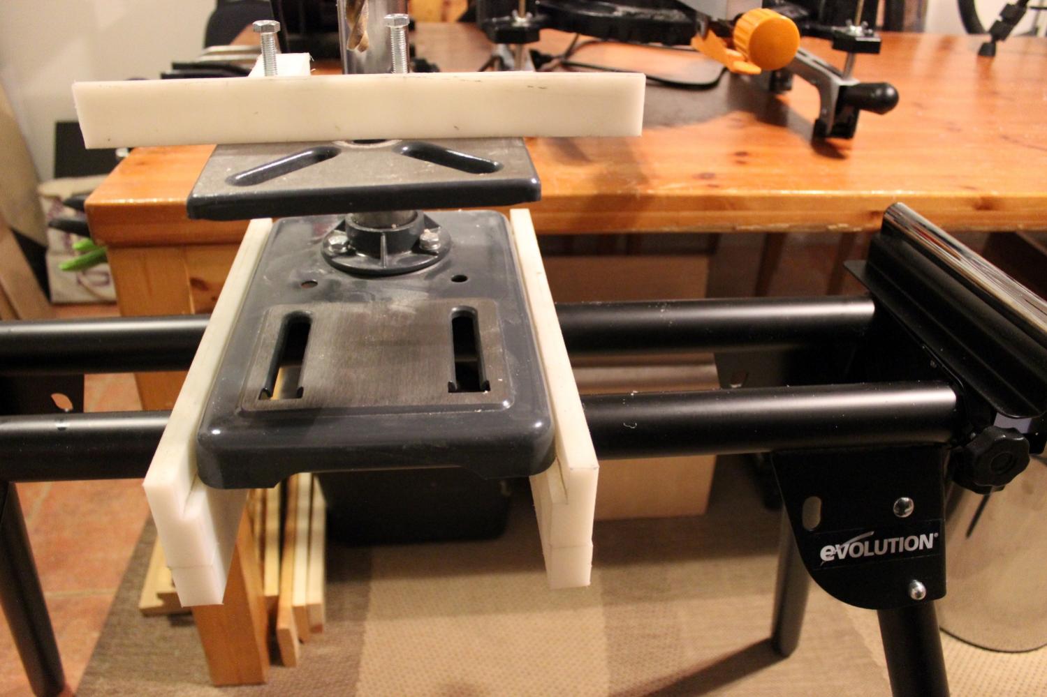

    ​I work in our basement, i have a small room there.
    Nice place tough, but to be able to use and to get fit all tools i want, i had to find my own solutions.
    This is my solution from how to get drill press verstile and be able to drill long parts with it.

    ​I made a simple add to my miter saw stand, now i can use it when i want to drill holes for the long parts.
    Material is nylon, video at the end shows the manufacturing process.

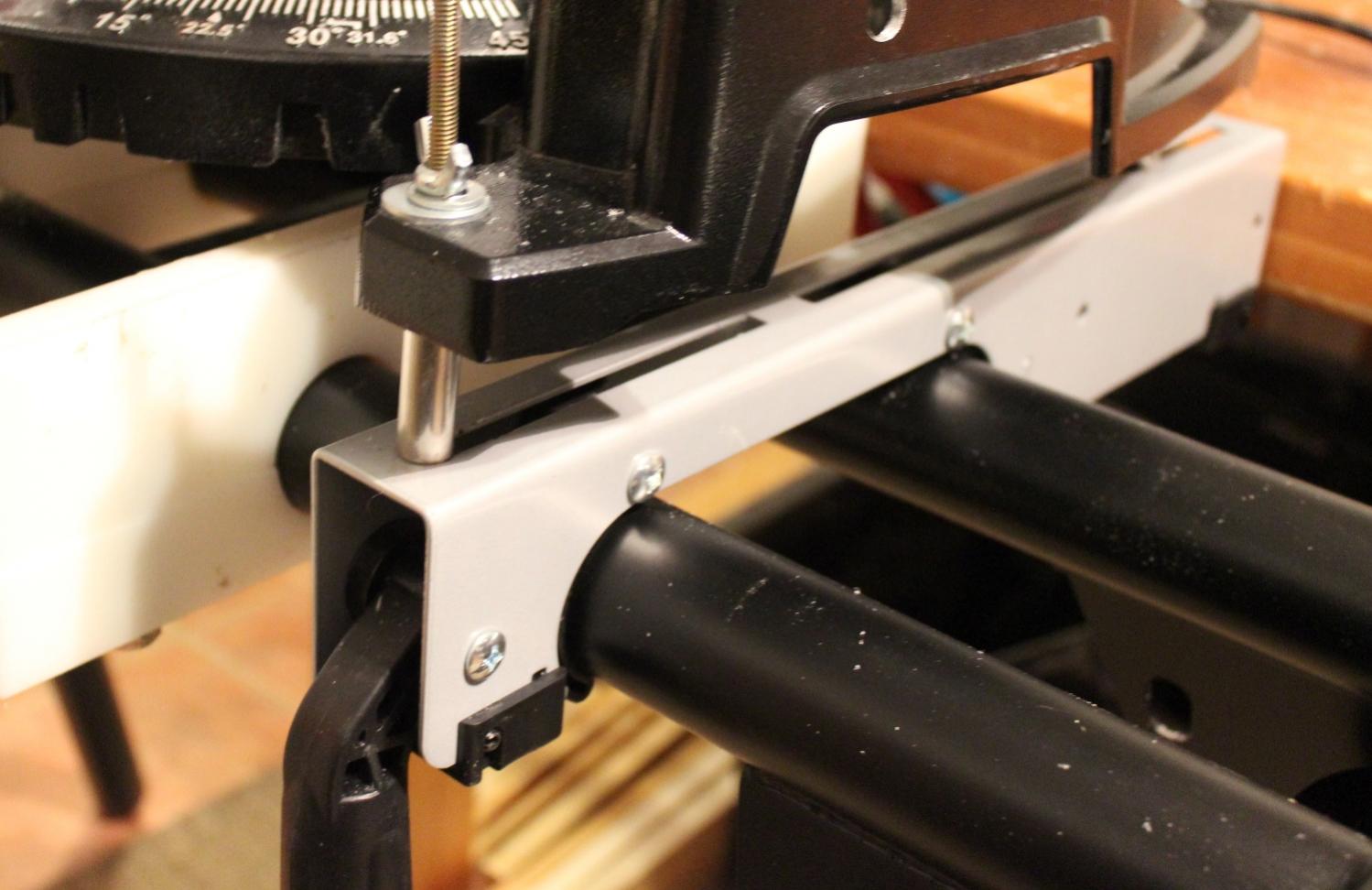

    ​Whole thing wouldn't have been so usefull if i couldn't use it with the miter saw too.
    I raised the miter saw with 40mm long pipes to get my "drill attachment" to fit under the miter saw.
    Now i don't need to remove or store anything, i can simply lift miter saw away, and place drill to its place,
    and after drilling, just lift the miter saw back on its place.
