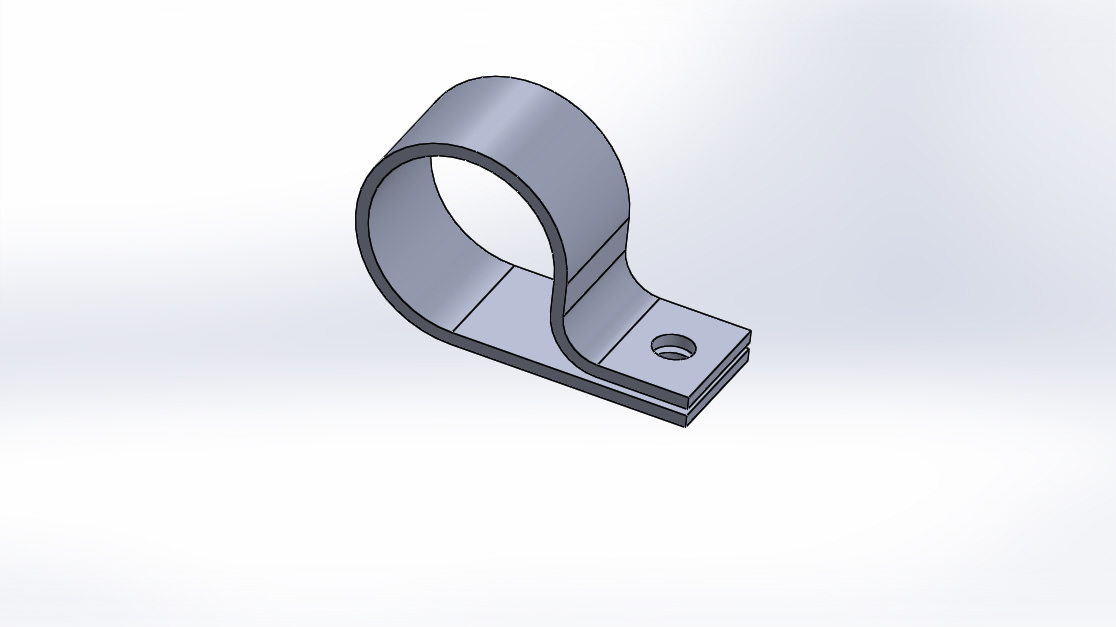

    Here is something I've done many times
    cut a 1/2 or 3/4" wide piece off a thin wall PVC, plex poly, or most amy other plastic tubing or pipe then split it and make a flat strip out if it the heat and bend one end about 1/2 to 3/4" as needed to a 90° bend then heat ten remaining body and wrap it around whatever diameter piece you need to make a clamp out of it bringing the 2 ends together forming a flat which you then drill a hole in it for a bolt

    Frank,
    I made one of your straps and it worked perfectly. Thanks for the great idea. It is now in the article.
