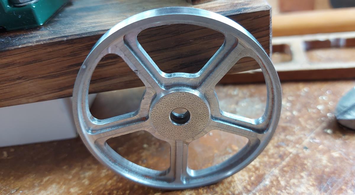

    I've been making wheels to create a trolley for the Whippet
    Made from 1/4" thick mild steel. Hopefully they look like an old cast wheel that you might find on a stationary engine trolley - thoughts?
    The texture of casting might be imparted by etching or shot blasting. Blast might edge out for appearance, it'll blend every tool mark evenly. There might be a way to texture paint or add a 'contaminant' instead. But they are beautiful raw.
    When I needed a super finish on narrow surfaces, the trick was stoning one flute off a two flute end mill, making it a fly cutter, but makes clean corners tedious.
    thanks, I did tumble them in ceramic beads for a few hours, but this probably needed to run for hours and I got fed up of the noise in the workshop...
    The modified two flute mill is a good tip, will have a go, Thanks, Nigel
