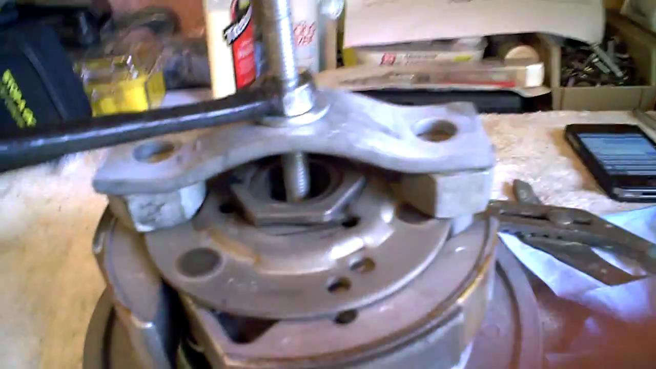

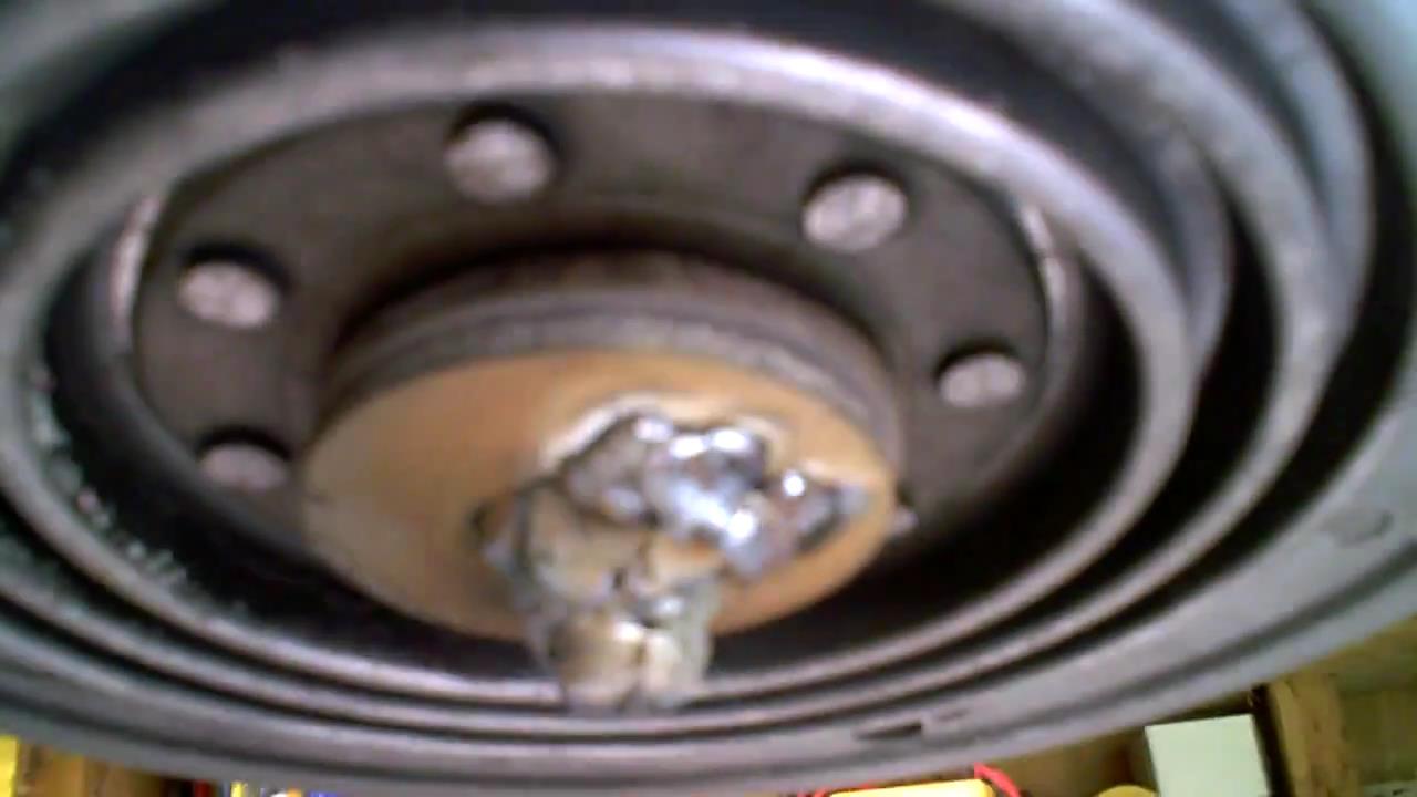

This is a tool I made up so I could service my CVT clutch. You can buy one at $90.00 but whats the fun in that. Here are a couple of pictures;
It consists of a all thread rod with some heavy duty fender washers welded to a nut at one end. The top side is just a really heavy duty U-Bolt clamp (used for tower work) and a couple of spacers so that you can get to the large 47mm nut. This is used to compress the spring back down to allow the large nut install.
Attachment 1271
Attachment 1272
