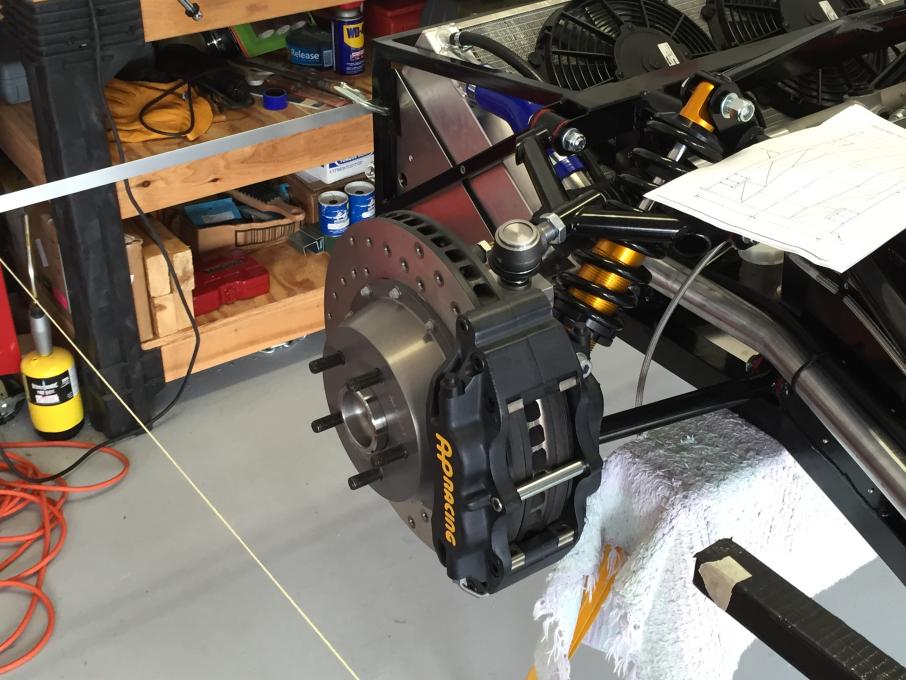

    kbalch's Avatar
    Jun 2012
    Clermont, FL
    5,034
    2,275
    Thanks Christophe! I've added your Engraver's Bowl Vise to our Vises and Woodworking categories, as well as to your builder page: Christophe Mineau's Homemade Tools. Your receipt:
    Regarding the brake, while I appreciate the thought (and love the design!), I'll be sticking with this:

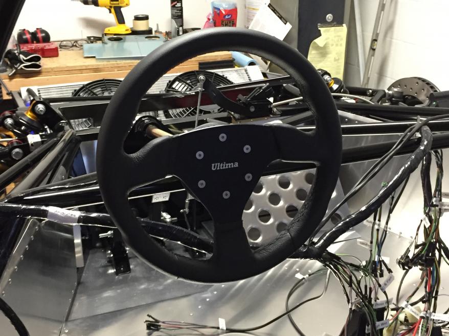

    kbalch's Avatar
    Jun 2012
    Clermont, FL
    5,034
    2,275
    Nope, I've got a Momo:
