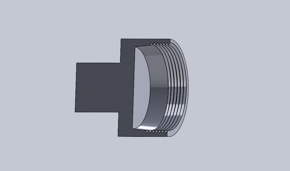

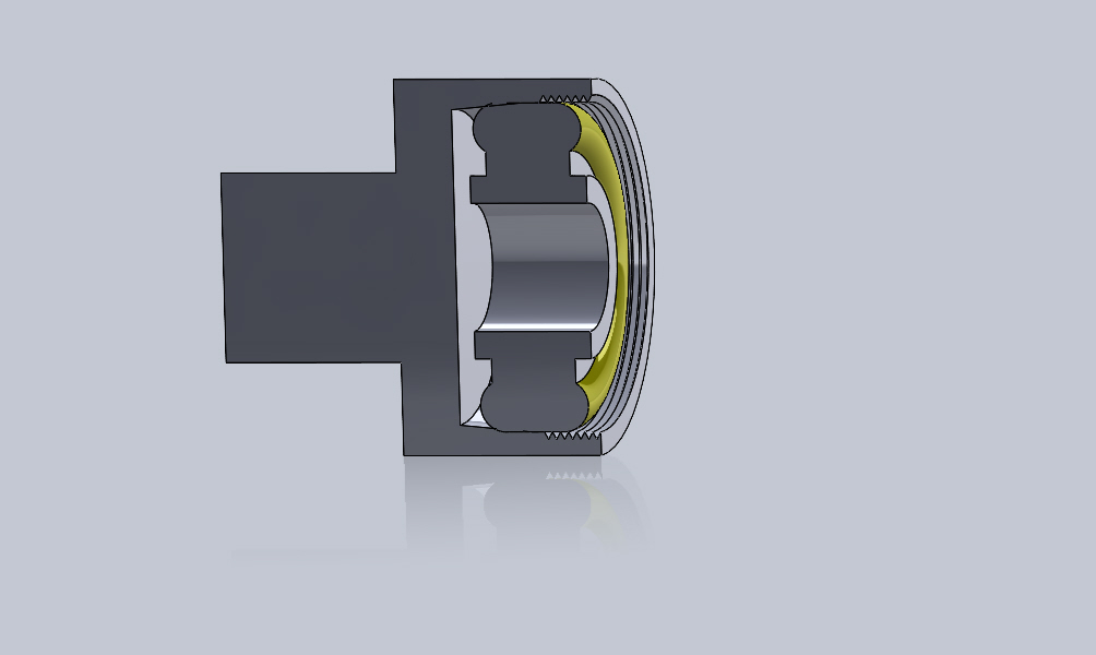

    Make you a holder for your wheels that the wheel will fit in but the bore of the hollow arbor has a few degrees taper thread the inside of the straight part of the bore and an internal nut with a large enough bore to allow your boring bar to bore the center of the wheel
    the arbor would look something like this then you could use your 3 jaw if you wanted to because you never touch the chuck just remove the nut and insert another wheel
    You would have to make one for each size but if you have more than a very few it is worth the time Just find a piece of pipe weld a back plate to it weld a shaft or if your chuck is large enough chuck on the perimeter without the need
    for a stub shaft You may even find a pipe nipple and cap near the size you require then just bore to suit . The threads on the fixture need not be internal but then it would rewuire a cap nut and spacer to tighten on the wheel's sides

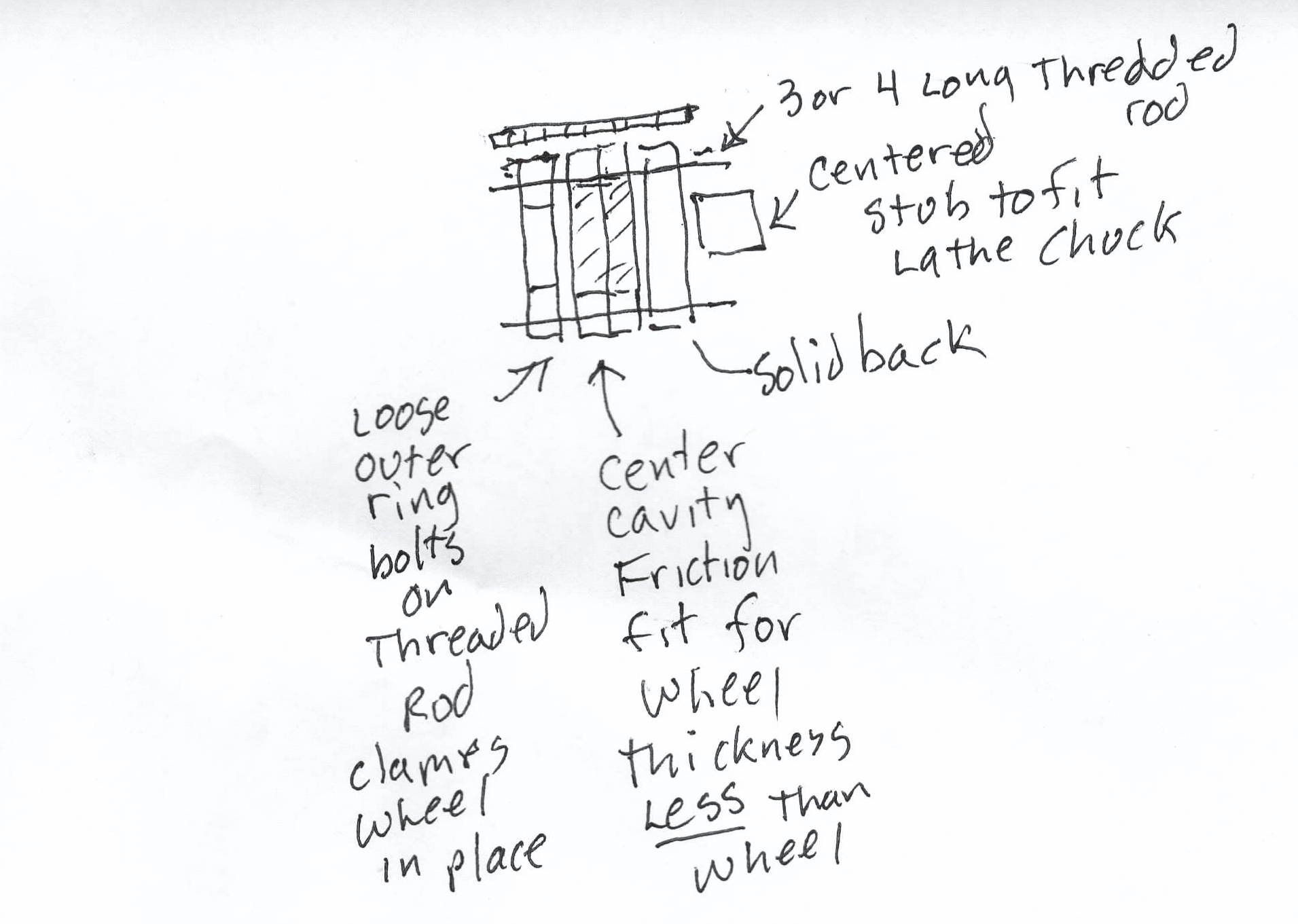

    I would make a wooden (MDF would work well for this) 'chuck' for each sized wheel.
    Basically a stack of a stub for the lathe chuck to hold glued and screwed to a circular plate comfortably larger than the outer diamerter of the wheel
    Glued to that is a ring with the same outside diameter and an inside diameter sized to a tight fit with the wheel. This ring should be just a little thinner than the width of the wheel. (depending on the thickness of the MDF, you might have to glue up a couple thicknesses)
    Finally there is a separate ring with a inner diameter that allows access to the center for boring, but is smaller than the wheels diameter. This is a separate piece.
    This whole thing can be cut out of the sheet with a jigsaw, then assembled and trued to final diameters inside and out on the lathe to center it.
    In use, the wheel to be bored is stuck inside the glued-up rings, then the loose ring bolted down to hold the wheel tightly in place. Bore out the hub, unbolt the retainer ring, pull out the wheel and go to the next one.
    Attached is a badly drawn sketch of the assembly from the side.
