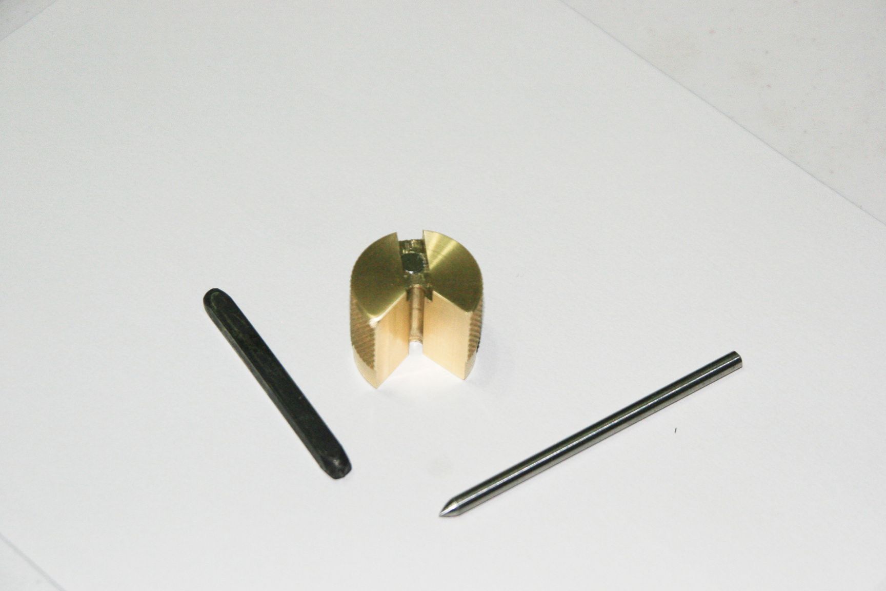

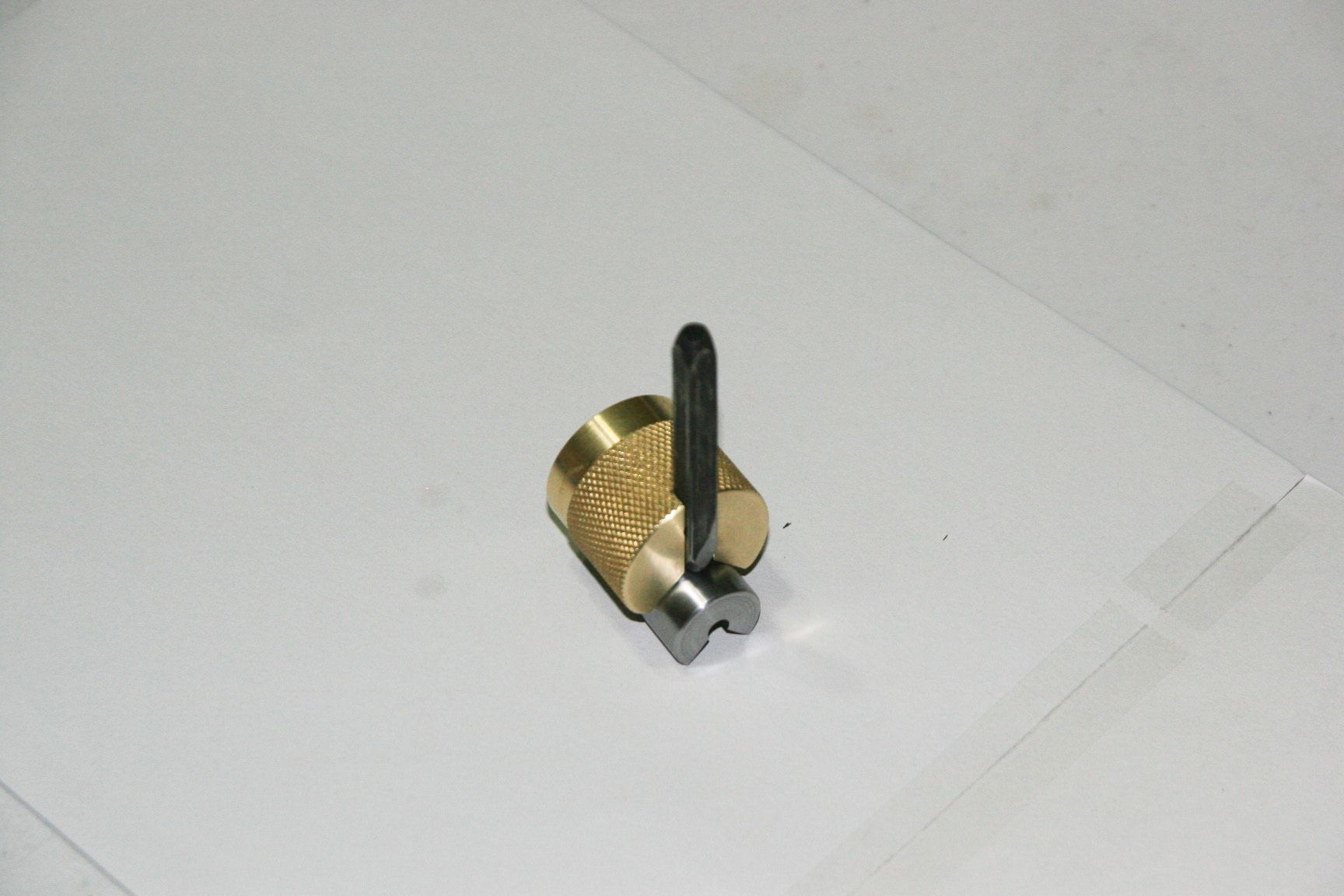

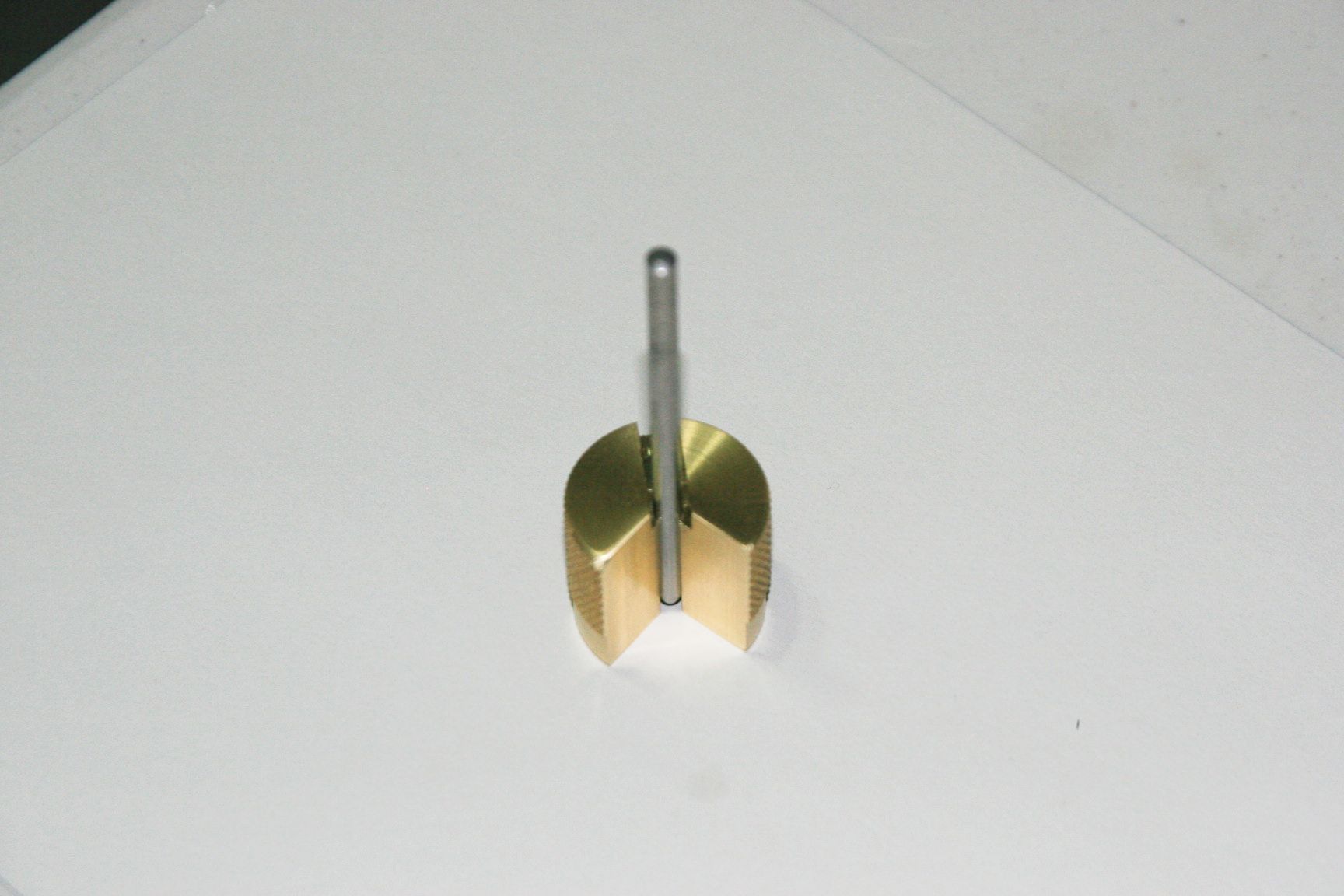

    Three uses for one tool
    Ok, I just had to try one of these for myself and was happy to see how well it works for center punching.
    Not bad for corner finding as well like Marv pointed out in this link:
    http://www.homemadetools.net/forum/o...two-uses-27184
    Now make that three uses with my new version that combines Marv's type with RR (Randy Richards) stamp aid
    and you get this:

    Quote Originally Posted by garage nut View Post
    what are the approximate sizes there?
    Oops, I forgot to put in the dimensions.
    The largest is the brass one. It is made from 1.25" diameter brass stock and is 1.2" long. Center hole was made for a sliding fit with a .177" piece of drill blank.
    Slot is a slide fit for my stamps which came to .242" wide and about .175" deep so the stamp is proud of the top of the brass.
    Under that slot is a hole made with a 1/4" drill bit for the magnet. The two milling cuts were made to the center of the hole on both the x and y axis.
    The knurled steel guide is 3/4" in diameter and 1.500 inches long.
    The straight steel guide is 1.250" long and 3.4" in diameter.
    Same punch is used in all of them.
    Cheers, JR
