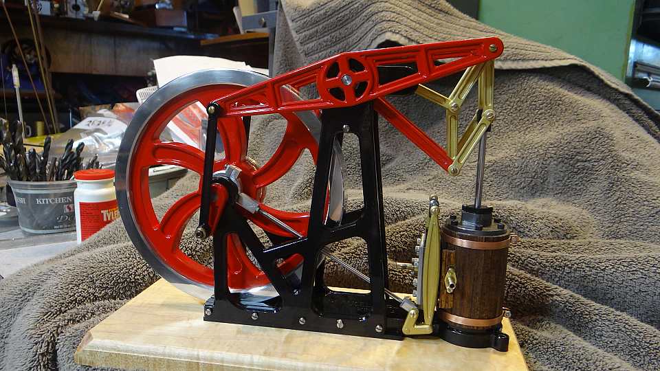

    The linkage was typically used with early beam engines before the development of crossheads that would allow the piston connecting rod to always move linearly while directly driving the crankshaft.
    The photo shows the vertically oriented cylinder driving the end of the beam (which moves in an arc) via a Peaucellier linkage. The other end of the beam then drives a rotary power takeoff shaft via a conventional crank.
    These engines were operated at low speeds and the linkage helped extend their useful life to many decades at the expense of complexity and increased frictional losses.

    Yes the piston rod moves linearly. However, it drives a slider in the crosshead which also moves linearly. The link driving the rotating wheels connects to the slider, not the piston rod. The forces perpendicular to the motion of the piston are absorbed by the slider pushing against the crosshead. There is essentially no perpendicular force on the piston rod.
    It was the invention of the crosshead that allowed the piston to drive the crankshaft/loco wheel directly that eliminated the need for the overhead beam and the various linkages, Peaucellier included.
